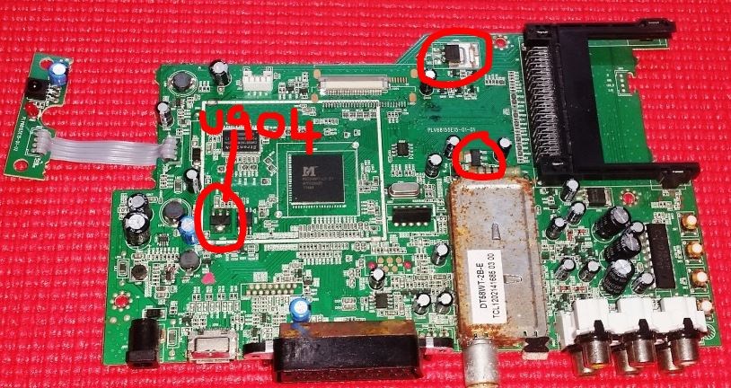

    Afternoon Guys,
    This isn't the usual Me asking for help, Just want to Pay back some of the advice i have been given over the years and post a fix for the Above TV...
    Background to this was that a friend of a friend brought me this 15.6" TV that he used for his CCTV system in his shop....
    Someone had already had a go at fixing it but told him it wasnt fixable....
    To me that is a challenge....
    Symptoms were that the TV would power on to a steady red light... No blinks, no flashes just dead...
    My first thought was being a poloroid that a Diode had died on the Vestel board like usual.... But i had not seen one of these all in one 12V boards before....
    So after a few hours of scratching my head and shaking my head at the dodgy soldering done by the previous trier.... I got out my multi meter and started testing Voltage regulators thanks to the help from the V Reg Testing thread i could figure out that one of the following could have been the issue.
    U904
    1117SADJ
    Pin1 - 0.67V
    Pin2 - 0.53V
    Pin3 - 4.27V
    U903
    1117-S33
    Pin1 - 0.00V
    Pin2 - 3.29V
    Pin3 - 4.89V
    U908
    1117-S33
    Pin1 - 0.00V
    Pin2 - 3.02V
    Pin3 - 4.89V
    I surmised that the possibility was that either U904 was at fault or something around it was faulty....
    After Testing the voltages and tracing where the components went to... i replaced the U904 Regulator and plugged in for a first test...
    Boooo Ya.... The TV powered straight up...
    Hope this helps someone, although i know that the 15.6 inch TV's are quite rare these days... a V Reg could be at fault on other TV's Like the Supermarket cheaper brands....

    Whooo awesome work thanks for the thread Have you an image of the board please ?
    • steved271
      • Jan 2014
      • 29
      • England
      Re: Poloroid PLV68155S67 - PLV68155E15-01-01 15.6"
      Cheers Reece, As i was writing it i did think that someone would ask for a pic.... I dont fancy taking the thing apart again but can get one off The net and Circle the Regs if you like?
      This is not the board that i repaired But one that is the same on ebay.... Although i wouldnt buy it with all that corrosion....
      I have marked U904 and circled the other 2 that i tested
