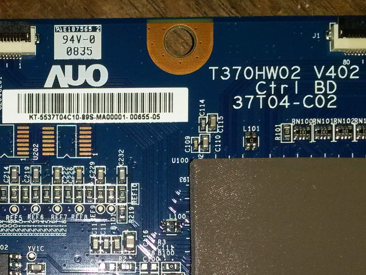

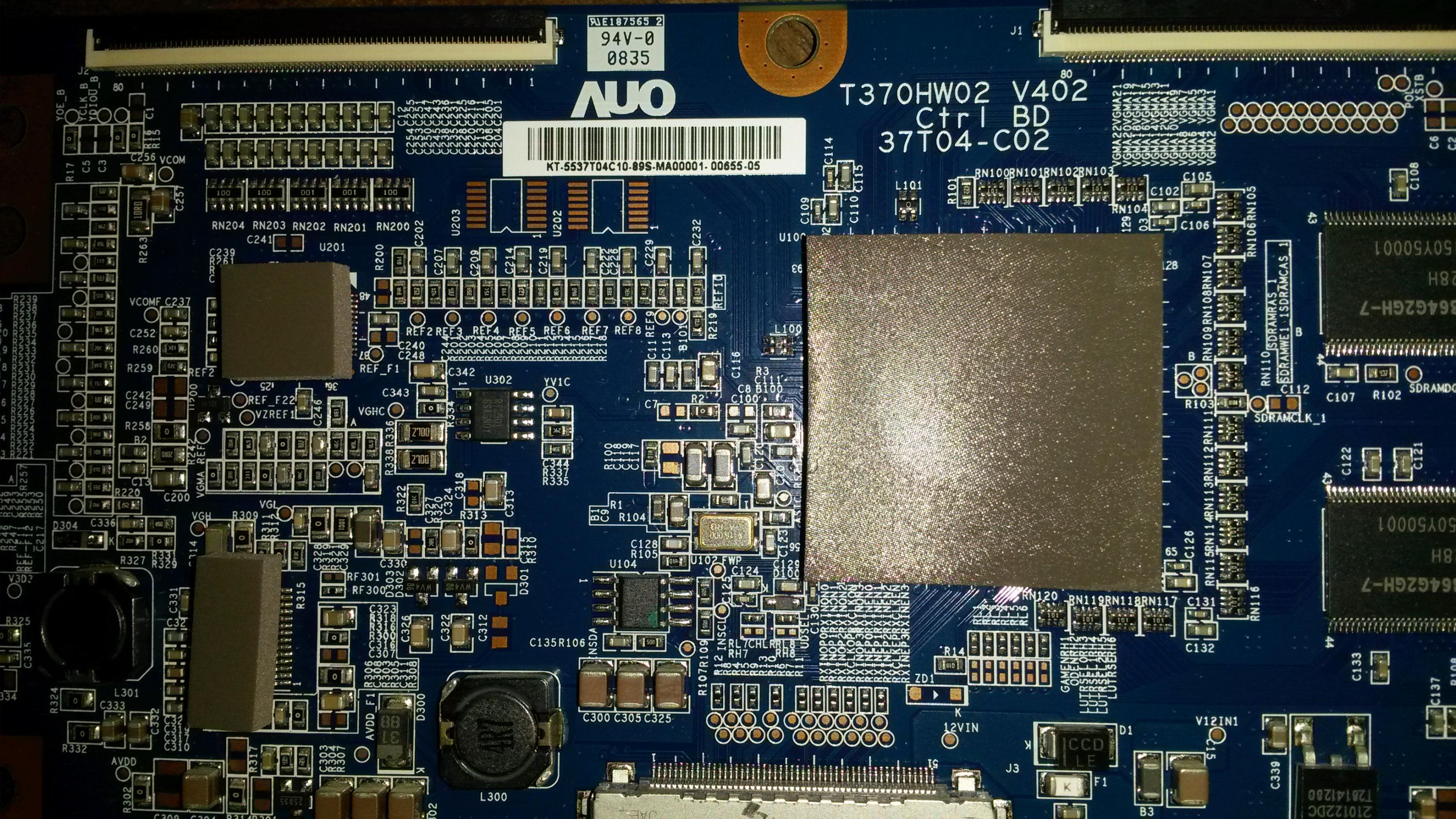

    I have solarization and most of my googling points toward the T-con board. My question is, how much of the part number has to match. The part number on the original board is
    T370HW02 V402
    Ctrl BD
    37T04-C02
    Thanks,
    Chris
    Re: Matching Part number for Samsung LN37A550P3FXZA
    Can we see the pictures of the board?
    That 'T370HW02 V402' is the blank circuit board (PCB) without parts installed.
    You need to look at the barcode sticker for the PCBA (Printed Circuit Board Assembly) which are the boards that are stuffed with parts for particular requirement for particular LCD panel.
    Look at SJ here how he shows how to read the P/N of the PCBA for your AUOPTO LCD panel and the cross reference if there are any:
      Sure. I hope these are good enough.
        Your board part number is 5537T04.C10 and any replacement will need to match this. I see shopjimmy only offer a repair service or the IC to replace yourself. check out eBay for T.Con or repair also
