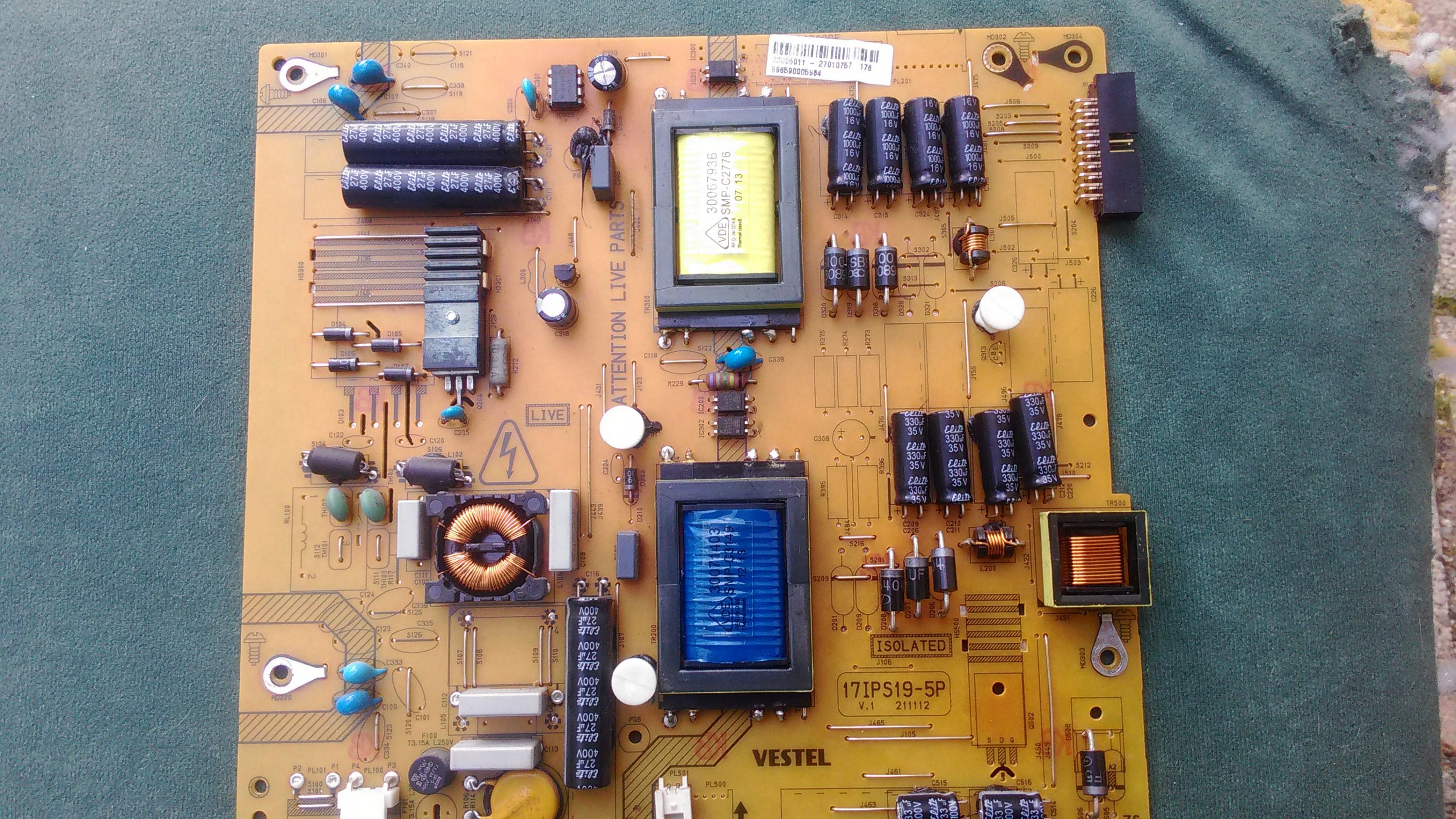

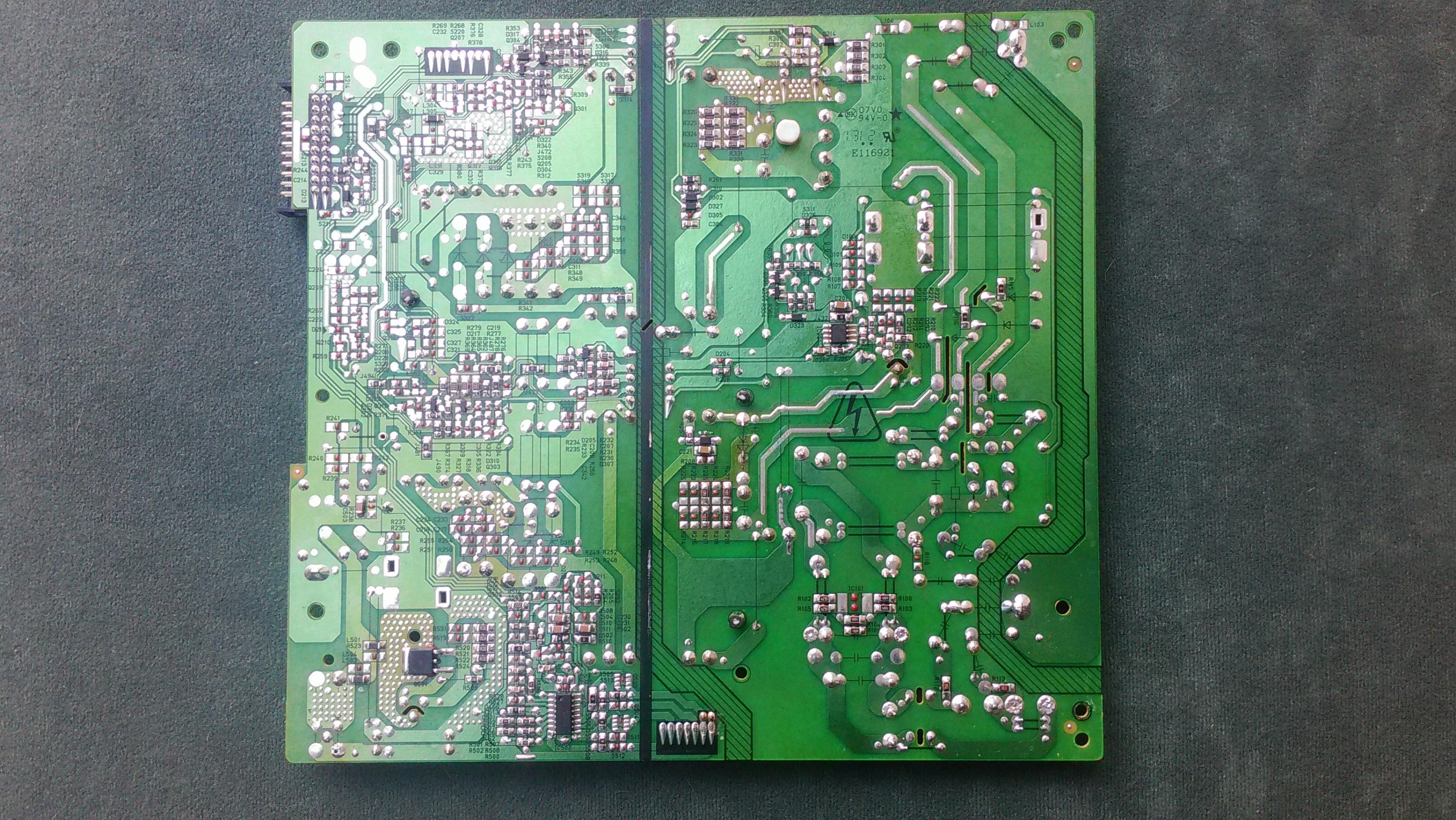

    Hello guys i need some help regarding Vestel PSU 17IPS-5S.
    There is no backlight.
    I think this is schematic for similar psu...
    How many volts there needs to be on the P501?
    What should i do?
    Thx.

    Hello please watch my video which shows how to test this Psu and Leds:

        Awesome keep us updated on what you find. If the driver starts then collapses to 24v you have a bad led but if you have no boosted voltage-60v-then the driver is failed.

          I have a nice round 0 on the red wire from the start and black drops to 23V... What should i do now?

            What you mean 0 at the start ?

              When i boot it from standby and measure red wire i get no voltage but if i test black wire when i boot it from standby i get around 70 and it lowers to 24.

                Ohh you mistyped and put 0 so it confused me lol. If you watched the video that means you have a bad Led.

                  When you tested RED wire it started High and falled to low but i have no voltage on startup.
                  Black acts like in the video starts high and falls low.

                    Yep its one of the leds where can i find one and what kind am i looking for?
