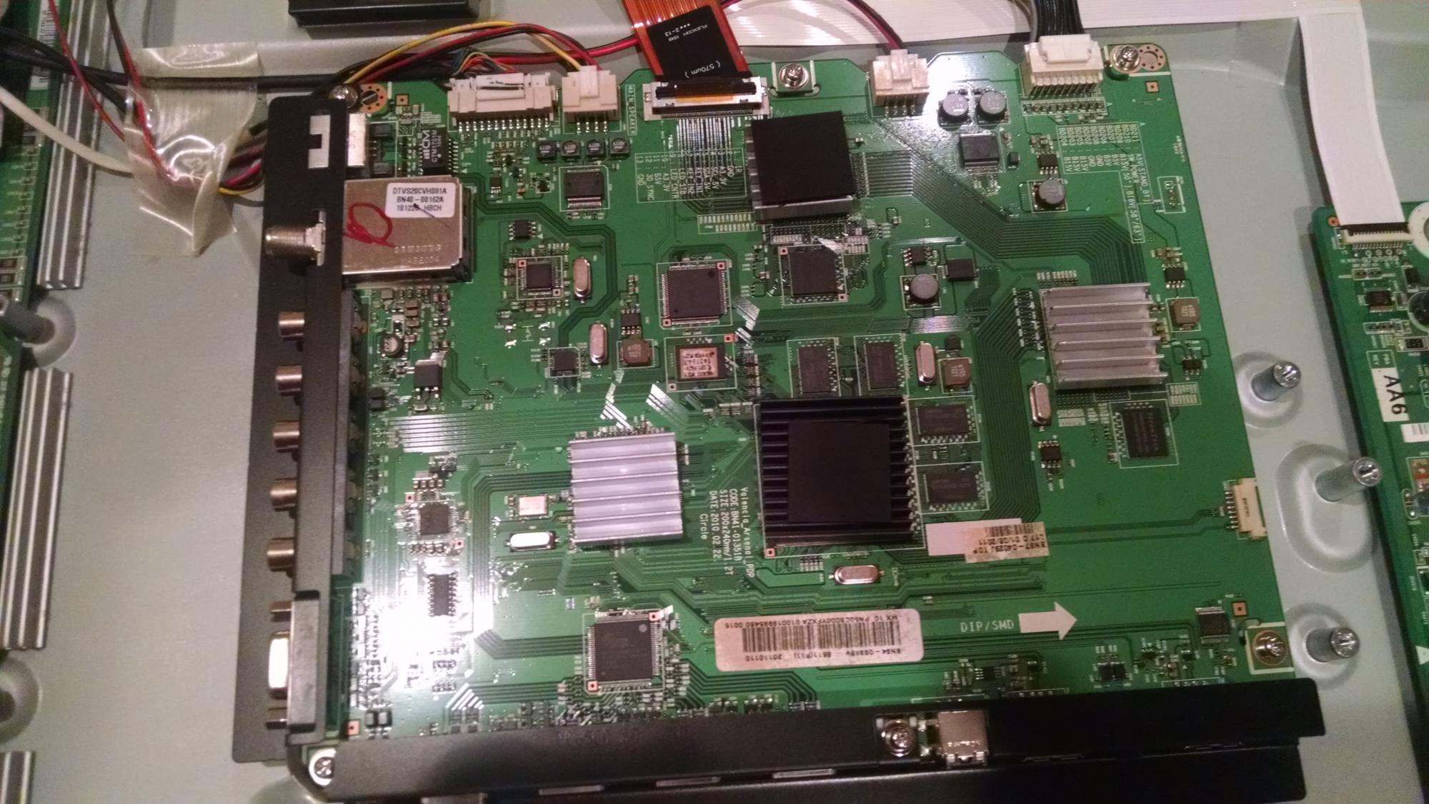

I have a Samsung PN50C8000 plasma TV. I have looked through several forums and thread to try to identify the problem, but I am not quite able to do so. Some help would be greatly appreciated.
Here's the problem: When I turn the TV on, I get normal picture and sound. After less than 5 minutes, the picture goes completely black - not just the dark grey you get when the display is working but there is no signal. The picture does not come back. However, if I turn the TV off and on again, the picture and sound are both fine for a few minutes before I lose the picture again. Sometimes, just before the picture goes out, I will get odd repeating patterns on the display for a few seconds, e.g., random blue and pink bars. This does not always happen and it is not always the same when it does happen.
Here's what I've done so far:
1) I tried multiple inputs - all of the HDMI inputs and the component inputs. The problem is the same regardless of the input I use.
2) I tried multiple sources - a cable box and a DVD player. The problem is the same.

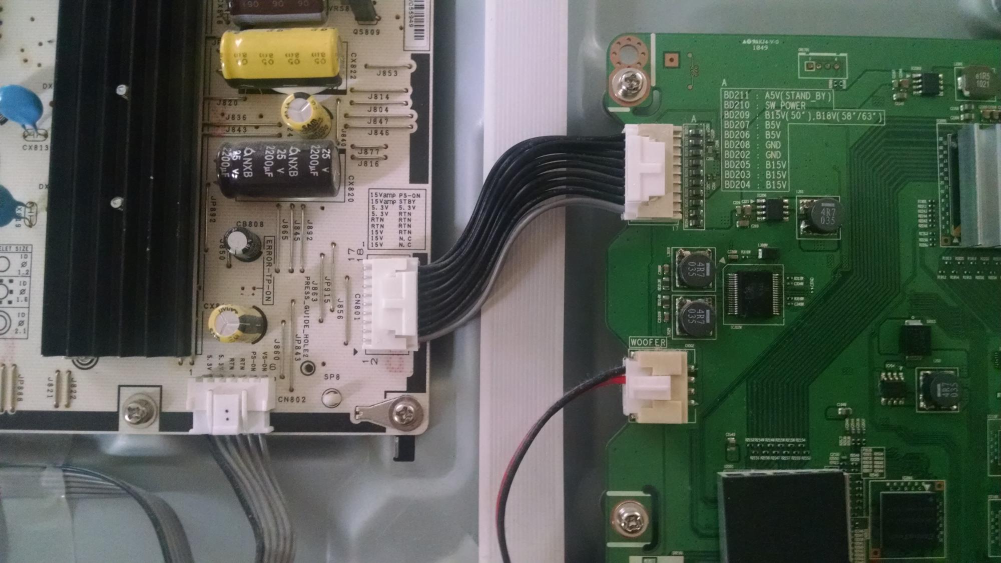

3) I opened up the TV and checked the key voltages - Vs, Va, Ve, and Vscan. They are all normal both before and after I lose the picture.

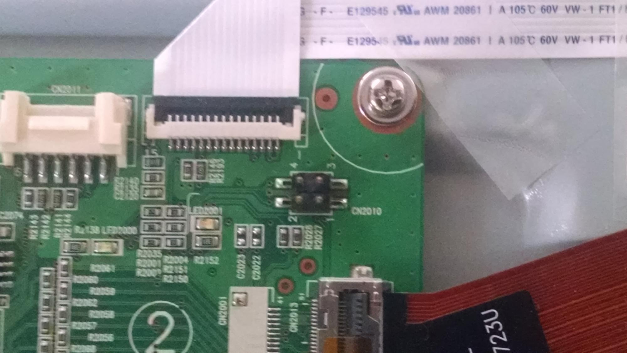

4) I checked the green LED on the Logic Board. When I have a picture, it flashes once a second. When I do not have a picture, it typically flashes once a second. However, sometimes, when I lose the picture, the green LED stays on and does not flash. I am not sure why it behaves differently different times.
5) I went into service mode and checked the patterns. When the picture goes out, I do not get any FBE (main board) or Logic Board patterns. Nor does the volume or the menu display (I can however adjust the volume). When I have a picture, I get the Logic Board patterns. If I have an input signal, I also get the FBE patterns. If I do not have an input signal, I do not get the FBE patterns.
6) I noticed while I was in service mode, that the T-Con checksum showed an error. It seems from forums that I have read, that this can happen and the TV can still work completely fine. I am not sure if this means anything.
7) I also checked the voltages from the Main Board to the Y sustain and the X sustain boards. Here's what I got to the Y sustain board both before and after I lose the picture:
Va - 55
RTN - 0
Vg - 15
Rtn - 0
Vs - 203
Vs - 203
To the X sustain board, from left to right, both before and after I lose the picture, I got:
15
0
0
0
203
203
8) Checked the fuses on the Y sustain and X sustain boards. Both seemed fine - 0 ohms.
My best guess: I suspect that my Main Board and my Logic Board are fine. I suspect the issue is with my Y sustain, Y buffer, X sustain, or X buffer. Assuming this is correct (I think it is, but I am not sure), I do not know how to narrow it down to one of these 4 components. I have also seen posts that say if you replace either the Y sustain or the X sustain, you should replace both. I have also seen posts that say if you replace the Y sustain, you should replace the Y buffer and the same for the X sustain.
Sorry for the long post. Any advice would be much appreciated!!
