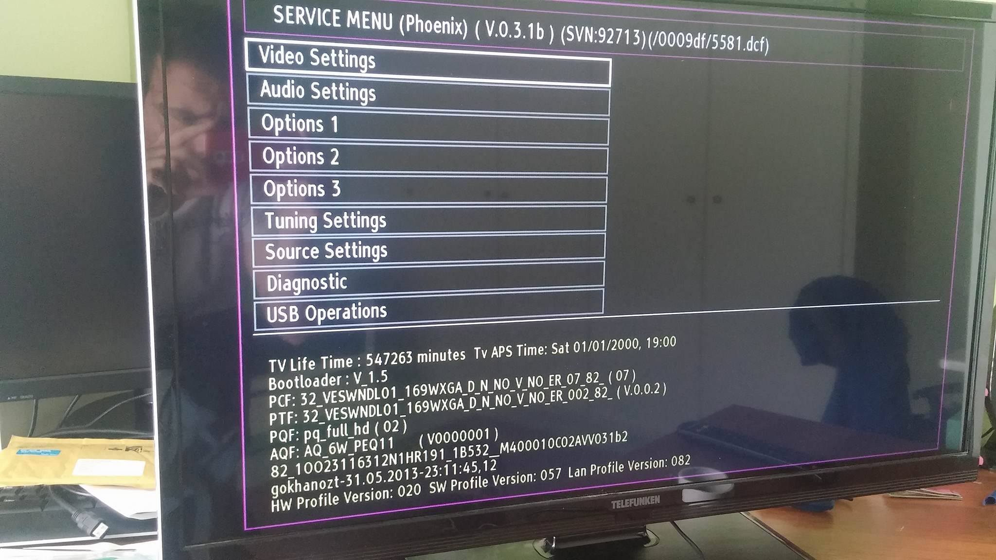

    Hello Guys,
    I own this TV for the last 2,5 years (~380 days uptime).
    The TV refuses to turn on and returns an infinite blinking LED.
    It only boots up by itself when the power cord is reconnected to the power source repeatedly, while the antenna cord is removed.

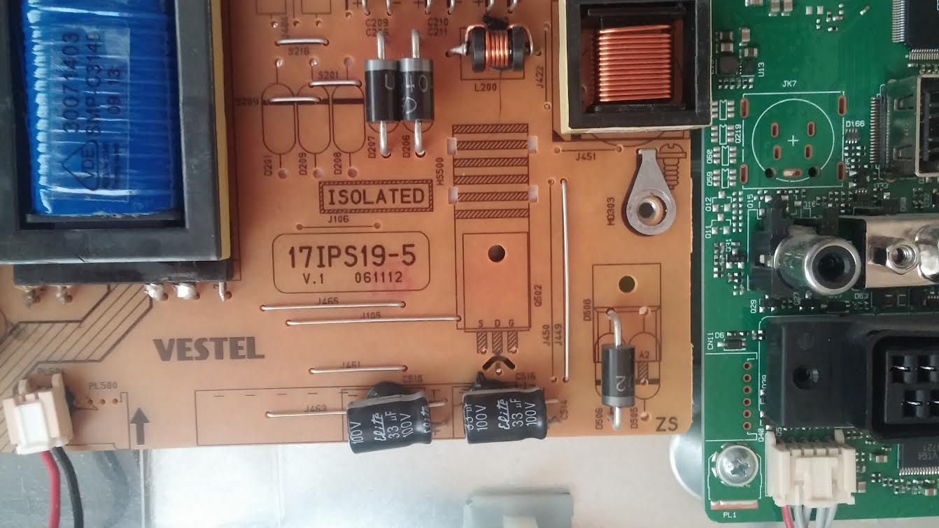

    After watching MrReeceyburger123's troubleshooting videos on YT, I checked the Power Supply (Vestel 17IPS19-5) for shorted Diodes, but none off them gives a beep sound to the multi-meter..
    I also tried to Reset the TV via the service menu but no luck.
    The TV Works fine for hours, if a successful boot happens. but a power off causes blinking LED and no power on..
    Is there anything i should investigate more?
    Looking forward your advice..

    Re: Telefunken T32TX182DLBP NO Turn on - Blinking LED
    Hello did you watch my video on how to repair the 17mb82 firmware ? Might need the firmware to be reflashed, if not I will link it.

                            The TV works AGAIN! Thanks for the support!
                            I want to ask you something else:
                            I got some replacement diodes on Saturday from a local store because i was in a hurry.
                            Is it OK to replace the 5404 x2 and 1x 5402 with some 5408's? (The shop owner told me that i won't have a problem..he didn't have 5404/5402 available).
                            Is there anything else to change on the PSU, in order to protect the tv from failing again?

                              Awesomeness glad to hear it worked Also yes they will work fine they have a higher current and reverse voltage so they might actually hold out for longer. Also nothing else really to change on these apart from the diodes
