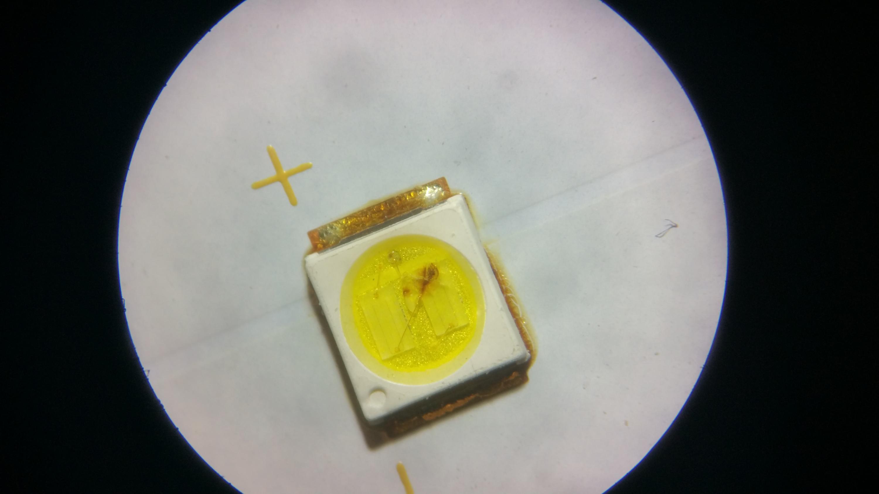

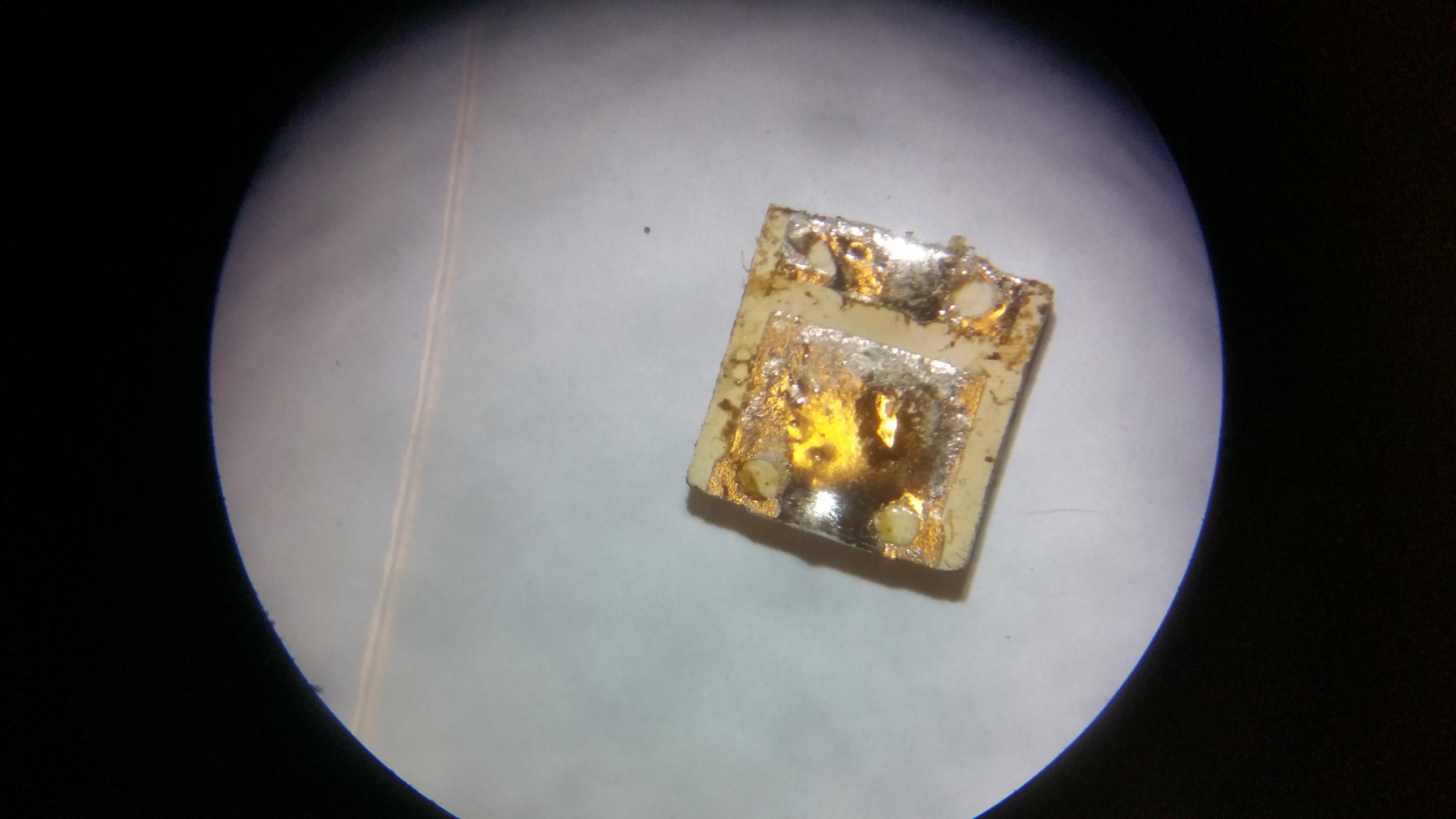

        I took it all the way apart to find an array of back light LEDS.
        There are 32 individual LEDS divided up on 8 strips with 4 LEDs on each strip.
        Out of the 32 LEDs two of them are not functioning. They are obviously burnt.
        I would like to replace these two faulty LEDs. Anyone know what package these are? And is there any way to tell what wattage they are?

            Re: Insignia NS-50D40SNA14 backlight only stays on for a few minutes.
            They are 0.5w 3.5v 400ma Smt Leds. Finding replacements is hard and using 1w IMO makes the display look splotchy as they are too bright. I will link my method of repair which normally works out good.
