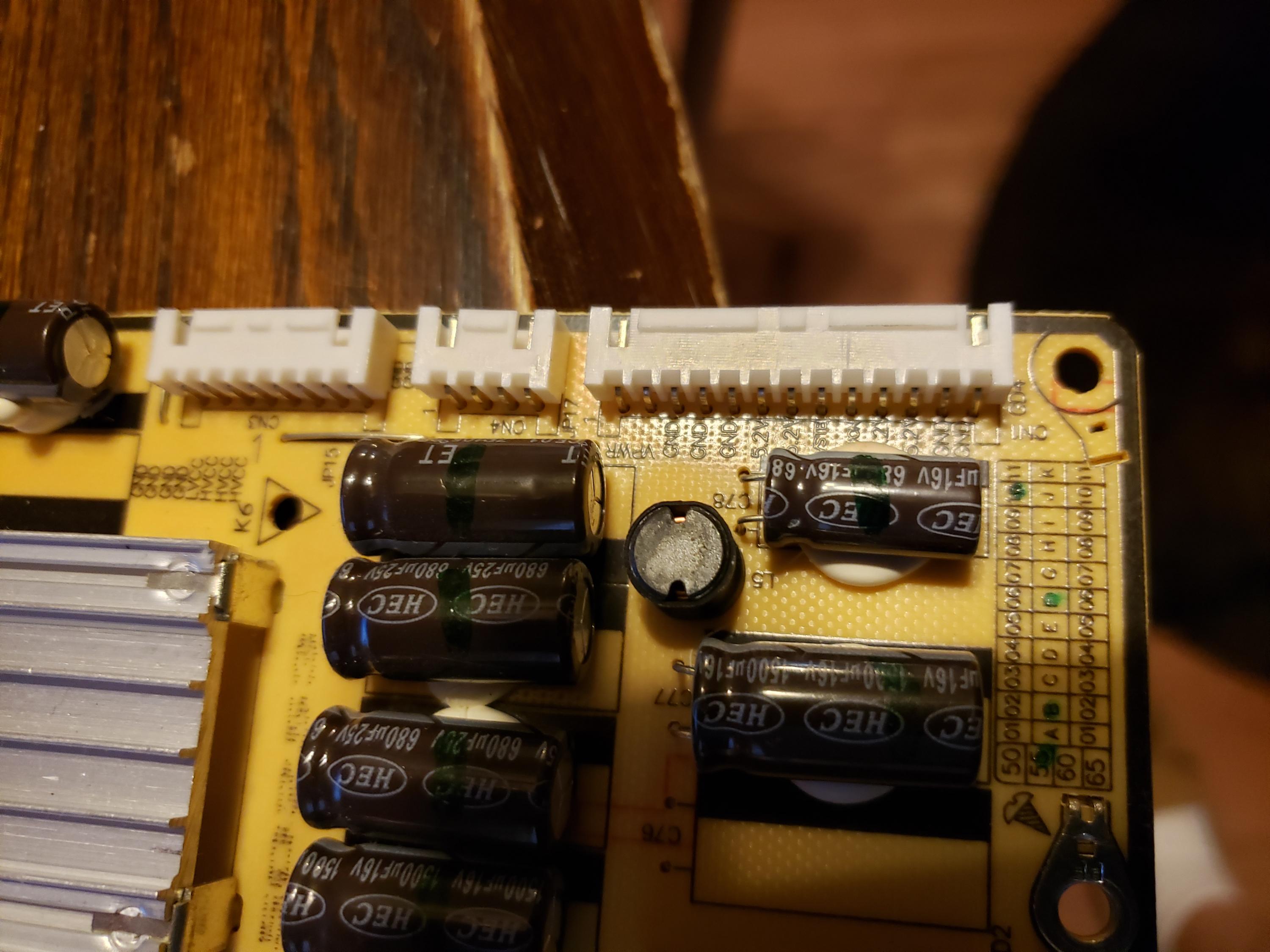

    You said same symptoms as thread starter, does that mean you have sound but no image?
    • nomoresonys
      • Jan 2013
      • 12323
      • U.S.
      #42
      Re: Sanyo fw65d25t no picture; good sound

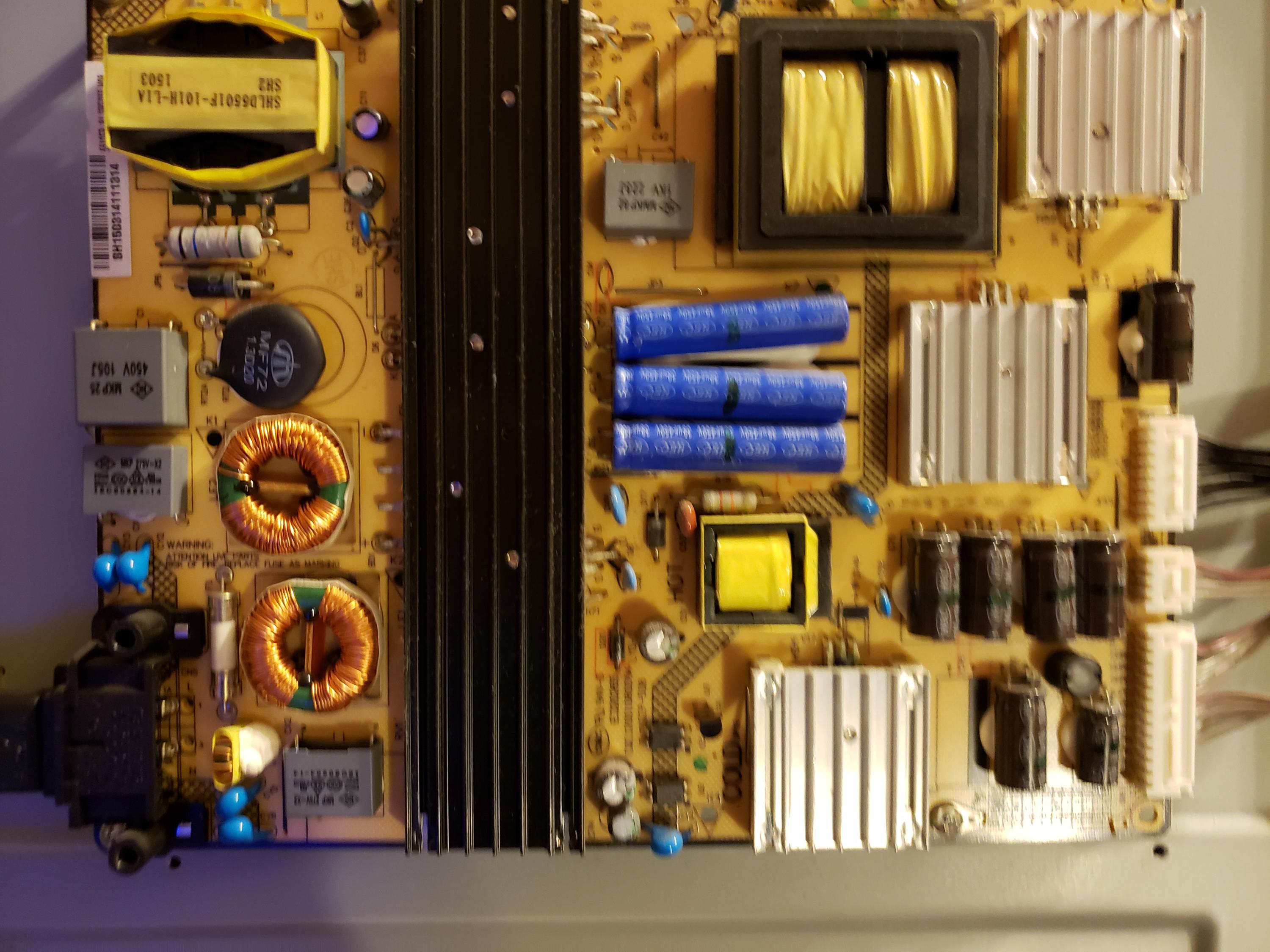

      See the white sticker on the powerboard? what is the set of numbers to the right? or just write them all here.
      • dcsharpsr
        • Nov 2013
        • 28
        #43
        Here they are...
        • dcsharpsr
          • Nov 2013
          • 28
          #44
          White label is..
          SH150314111314
          5510FB 81-PBE055-H08
          I don't have any audio as I can't select an input other than turning it on and off by either the remote or buttons on set.

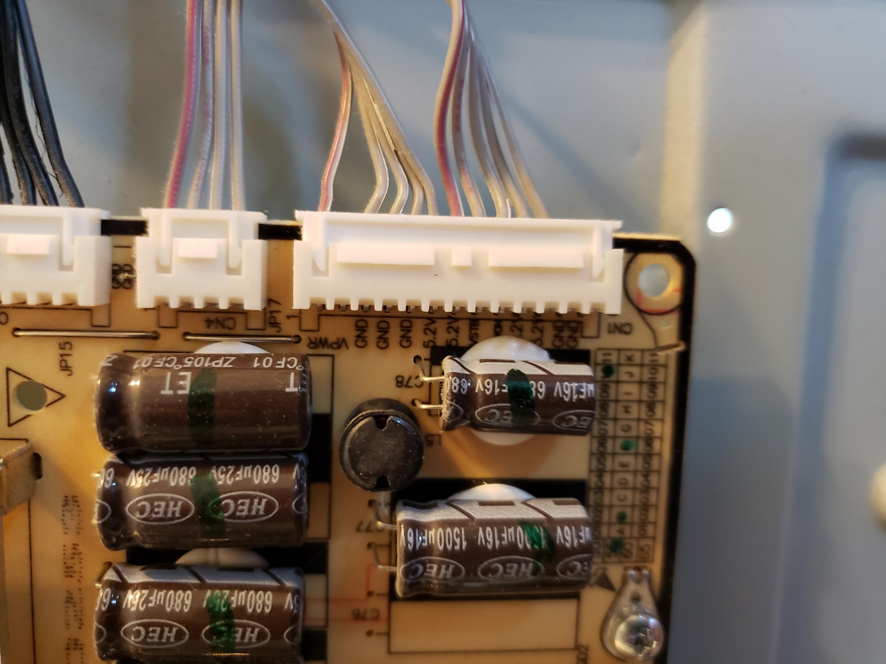

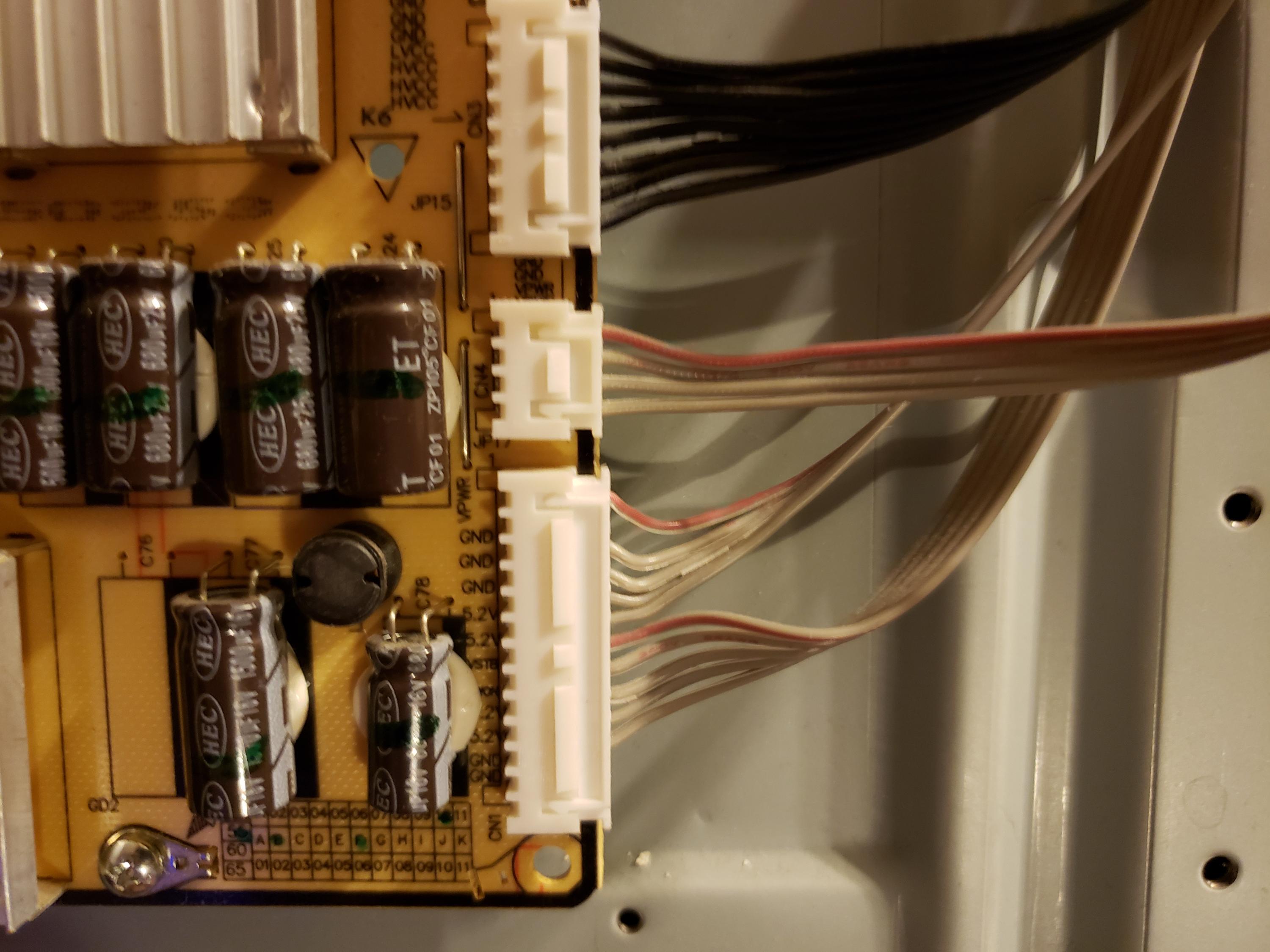

                  Sorry for the delay
                  Voltages on the connector pins are all 5.3
                  Voltages on the capacitors read 5.3, 12.3 and 56.6
                  • dcsharpsr
                    • Nov 2013
                    • 28
                    #49
                    CN3 Voltages
                    1-4=0V
                    5 12.3V
                    6-8 = 56.6
                    CN2 Voltages
                    1-2 Ov
                    3-4 12.3

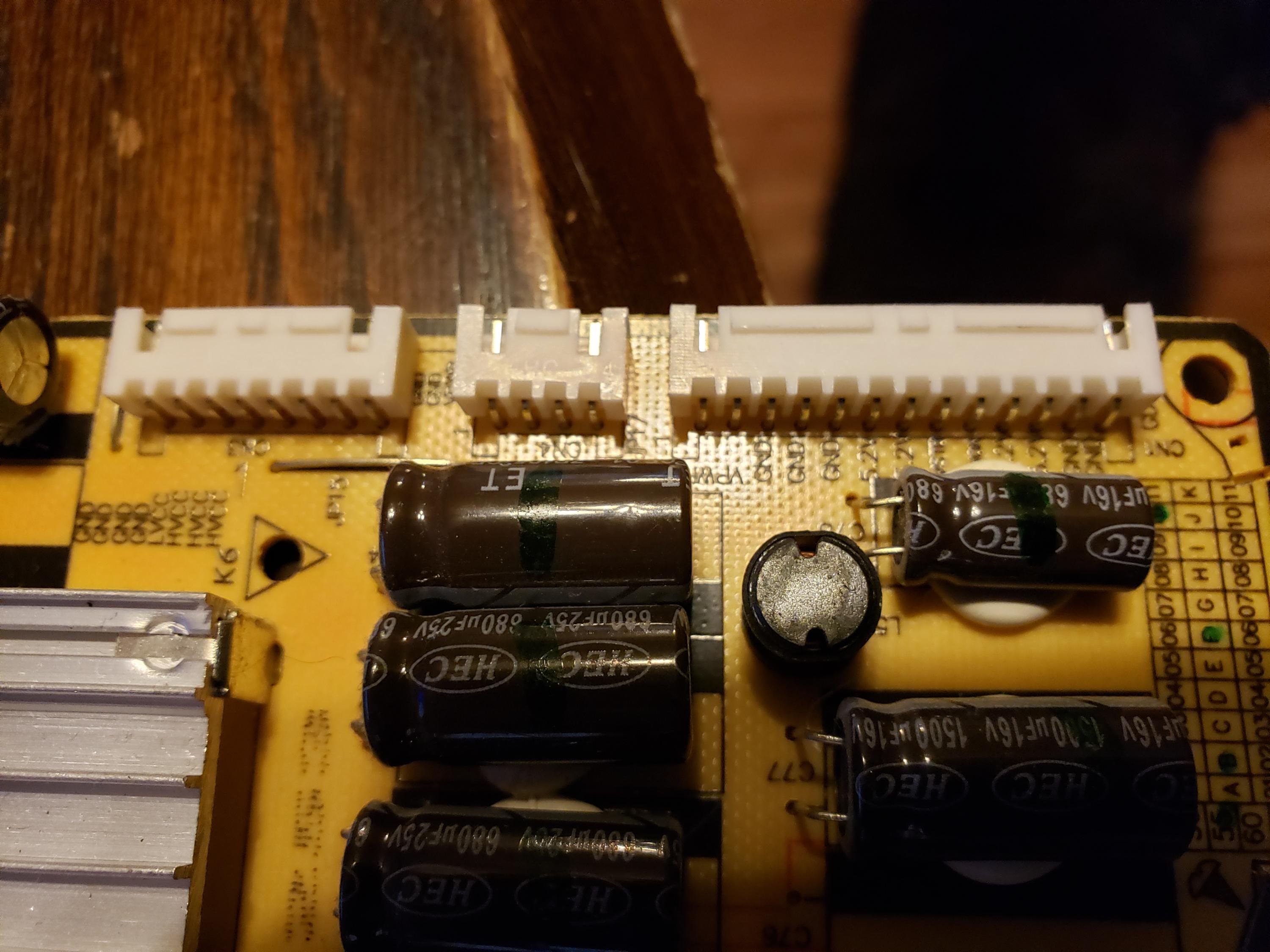

                      If there's a problem with one of your readings I don't see it, hook all the boards back up, turn tv on, on the ld driver board, connector PD1, check the voltage on pin 3, that's with the cable on, so you need to contact the metal part of the top of the connector, report the voltage.
                      • nomoresonys
                        • Jan 2013
                        • 12323
                        • U.S.
                        #51
                        Might be getting something wrong here, you said you have backlight but no image right?
                        • dcsharpsr
                          • Nov 2013
                          • 28
                          #52
                          Voltage in pin 3 of that connector seems to be floating around from 3.0 to 5.2 volts...not stable at all.
                          • nomoresonys
                            • Jan 2013
                            • 12323
                            • U.S.
                            #53
                            And you have steady backlight?
