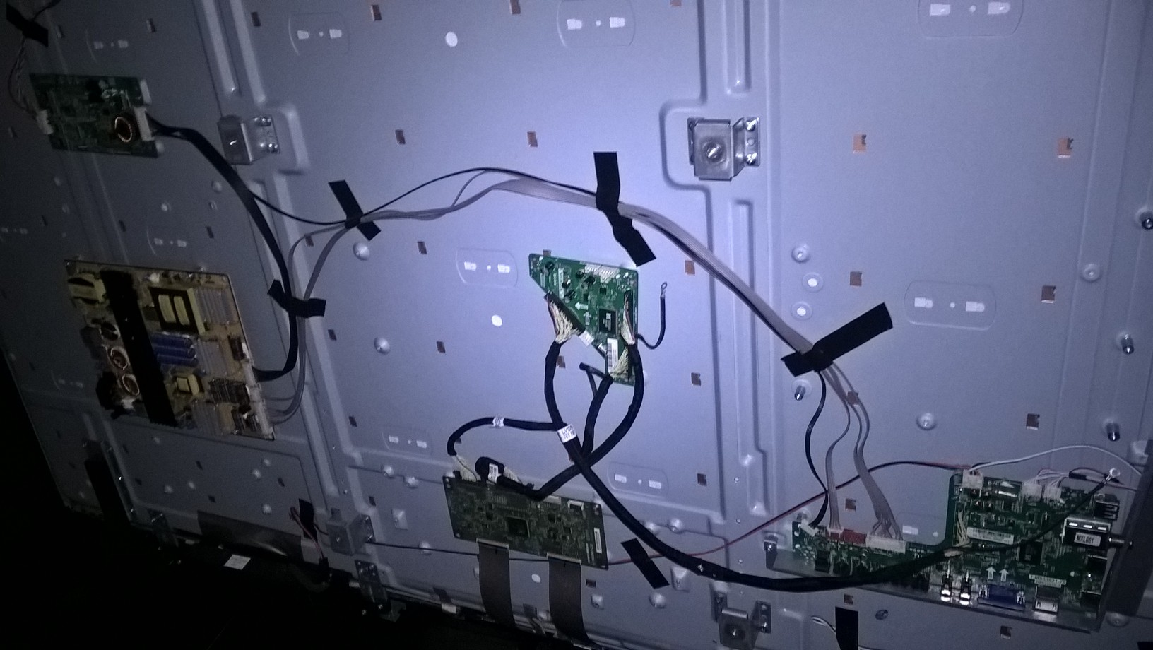

        Here are a few pics. The last two are what the tcon ribbons connect too.
        Tv has red standby. Pressing power makes red standby blink 6-7 times and tv only shows bluish screen, no inputs, logos, etc. I can hear sound just fine through hdmi. From behind, while powered on, the backlights are bright through the screw holes. Every board was replaced except the power board, but Buda said I could rule that out.
        So im thinking those two long strips the tcon ribbon hooks to or led strips inside. Both of which are probably beyond my repair level.
        Would those ground cables on the ldvs need to be screwed onto the chassis to make the boards work?

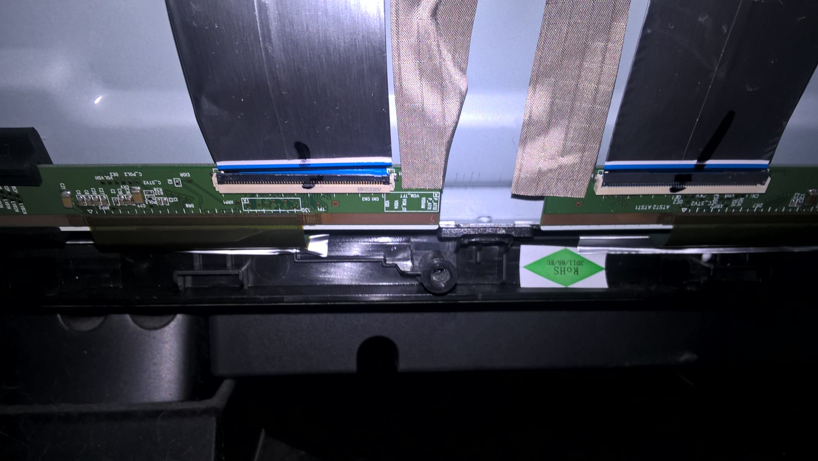

          Re: Sanyo fw65d25t no picture; good sound
          https://www.badcaps.net/forum/attach...2&d=1464398046
          Did you remove the left cabel? It is not seated right at all.
          Some one worked on this TV before?
            I was told that it just died. And no attempts had been made to fix it.
            I am reseating those cables right now. I just noticed that in the pics. However I have checked those cables before. And replaced them

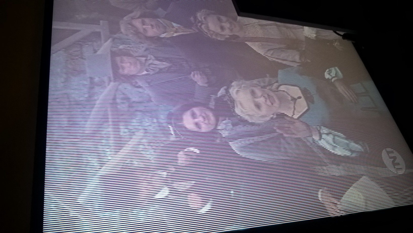

              Now I have this
                Ok picture is back and good. Weird though, it seems to be going back to the bluish/sound but no picture when I turn it off. Repeated turning off/on seems to "fix" it. Any idea what that could be?
