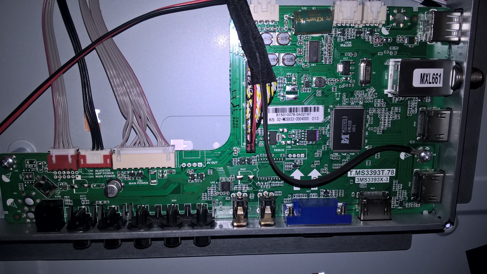

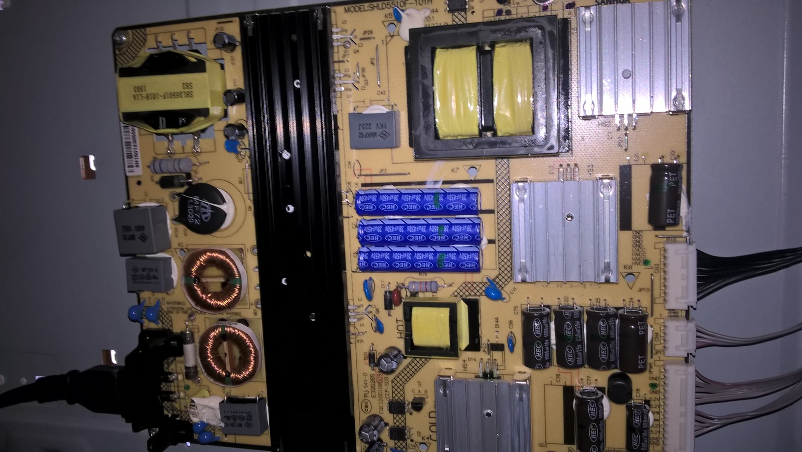

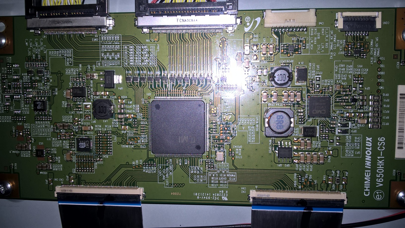

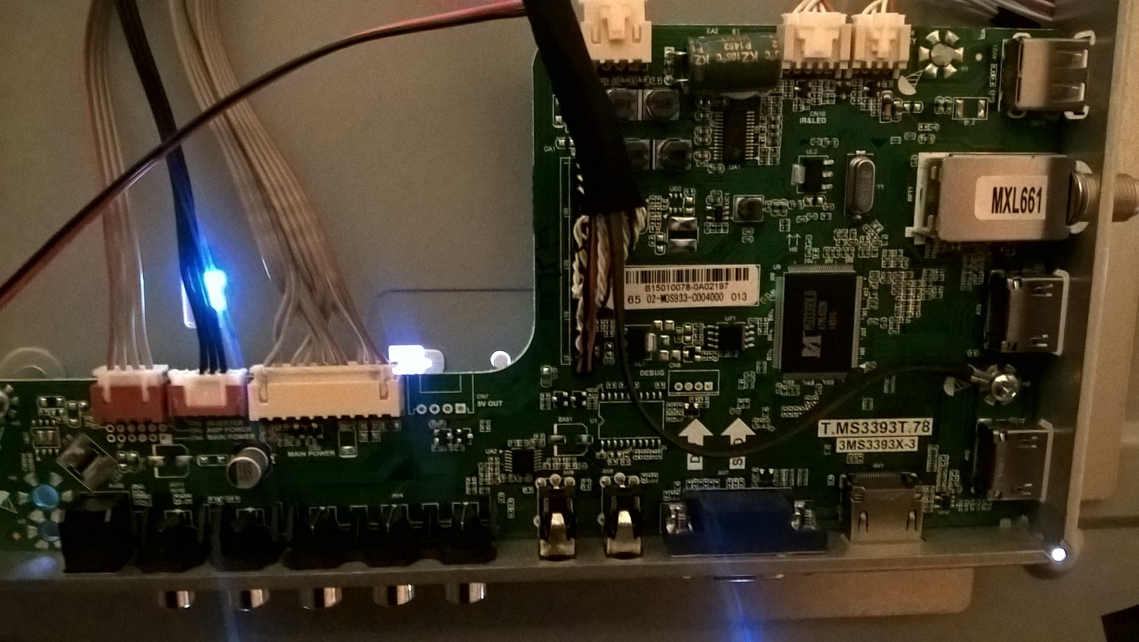

          Re: Sanyo fw65d25t no picture; good sound
          Tested the tcon fuse. Has 11.89 on each side.
          Here are some pics of the boards
          Any help is greatly appreciated

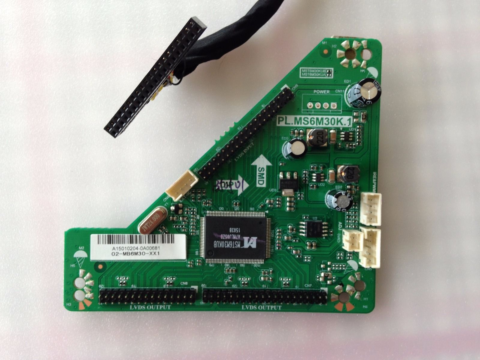

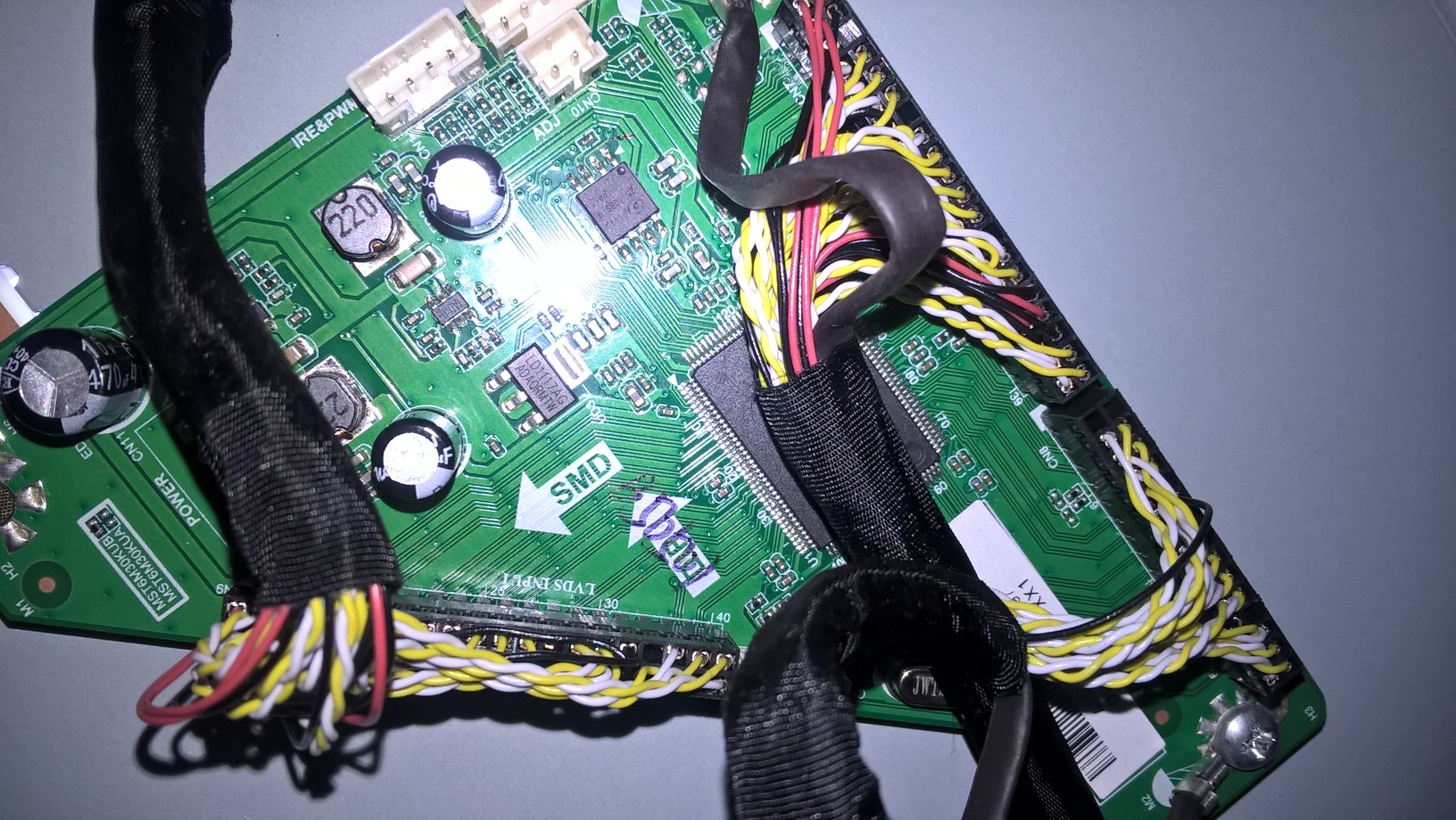

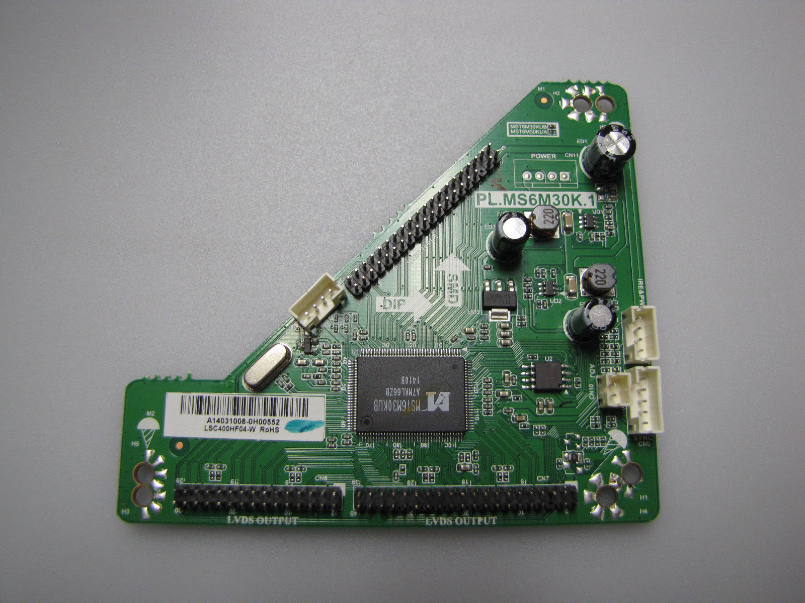

            OK, the TV also has FRC (Frame Rate Conversion) board:
            https://www.badcaps.net/forum/attach...9&d=1460166522, the board between the T-CON and the Main board.
            I see at least one 1117 LDO Voltage regulator IC and some inductors for the SMPS on that board, the wires are in the way to see what else are on that board.
            Please take the DCV reading of all pin of the 1117 with ref to GND to see what you have on that 1117.
              From top to bottom
              .43
              1.68
              3.20
              Using the ground screw on that board for black probe
                It is good.
                Right now I cannot tell which board is bad, the Main board, the FRC board, or the T-CON board.

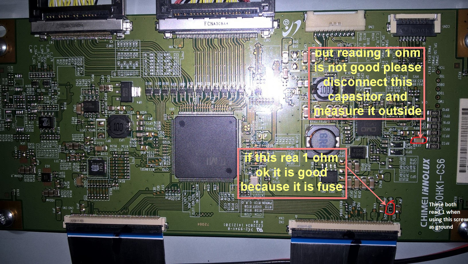

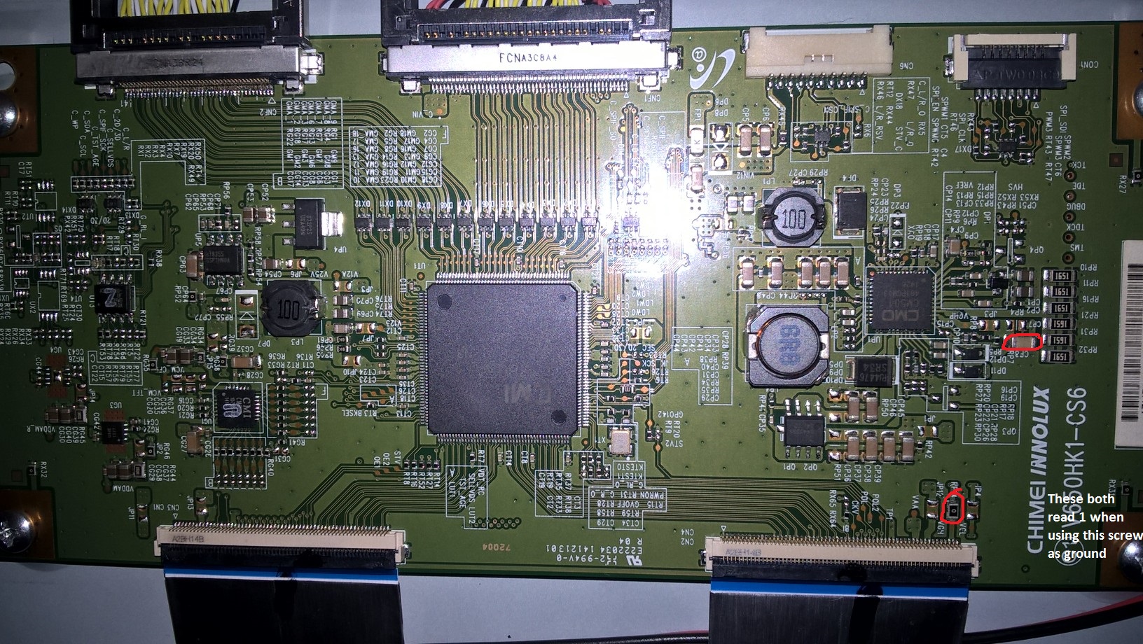

                    These two circled in red read 1 on meter. Doesnt seem to coincide with anything else on the board.
                          again be sure of this reading and look at the pic it explain its self .
                          thanck you
                              It is showing as 1Ohm on the meter or as '1' as in over range?
                                        Ive been looking for replacement parts. The kit I was going to get is out of stock so I am trying to locate the frc, main, t-con, and led driver boards. My question is, I have seen parts that are identical except for numbers. Could these work as well?
                                        Example:
                                        I have attached two frc boards. One is for fw65d25t, the other states its for a proscan. They both have FRC-PL.MS6M36K.1 printed on them. The only difference I see is the chip numbers are not all the same.
