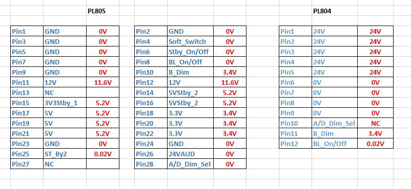

      PL805 connector to main board all voltages seem to be ok 12v @11, 5v @17 19 21 etc.
      If you don't give all the voltages for every pin then the fault could be missed.

          do you want every pin reading

                Re: Techwood 32884HD flashing blue orange
                PL805 conector to mainboard
                pin 11 11.6v, 15 5.2v, 17 5.2v, 19 5.2v, 21 5.2v
                pin 10 3.4v, 12 11.6v, 14 5.2v, 16 5.2v, 18 3.4v, 20 3.4v, 22 3.4v
                if that makes sense other pins showing no voltages grounds etc.
                  PL804 pins 10,11 & 12
                  PL805 pins 4,6,8,25,26 & 28?

                    #29
                    PL804
                    pin 10 empty
                    pin 11 3.4v
                    pin 12 0.02v

                      #30
                      PL805
                      pin 4 0v
                      pin 6 0.01v
                      pin 8 0.02v
                      pin 25 0.02v
                      pin 26 0v
                      pin 28 0v
                        Here are you readings. It looks as though the backlights are not coming on since all the other supplies appear to be as expected.
                        Can you lift Pin 8 of PL805 out of the connector and connect a 1K resistor from pin 8 to pin 17 and see if they come on.

                          #32
                          Main board firmware fault. Try running the core update folder Via usb see if it fixes it.

                                #35
                                think i am doing this right but cant see backlights coming on
