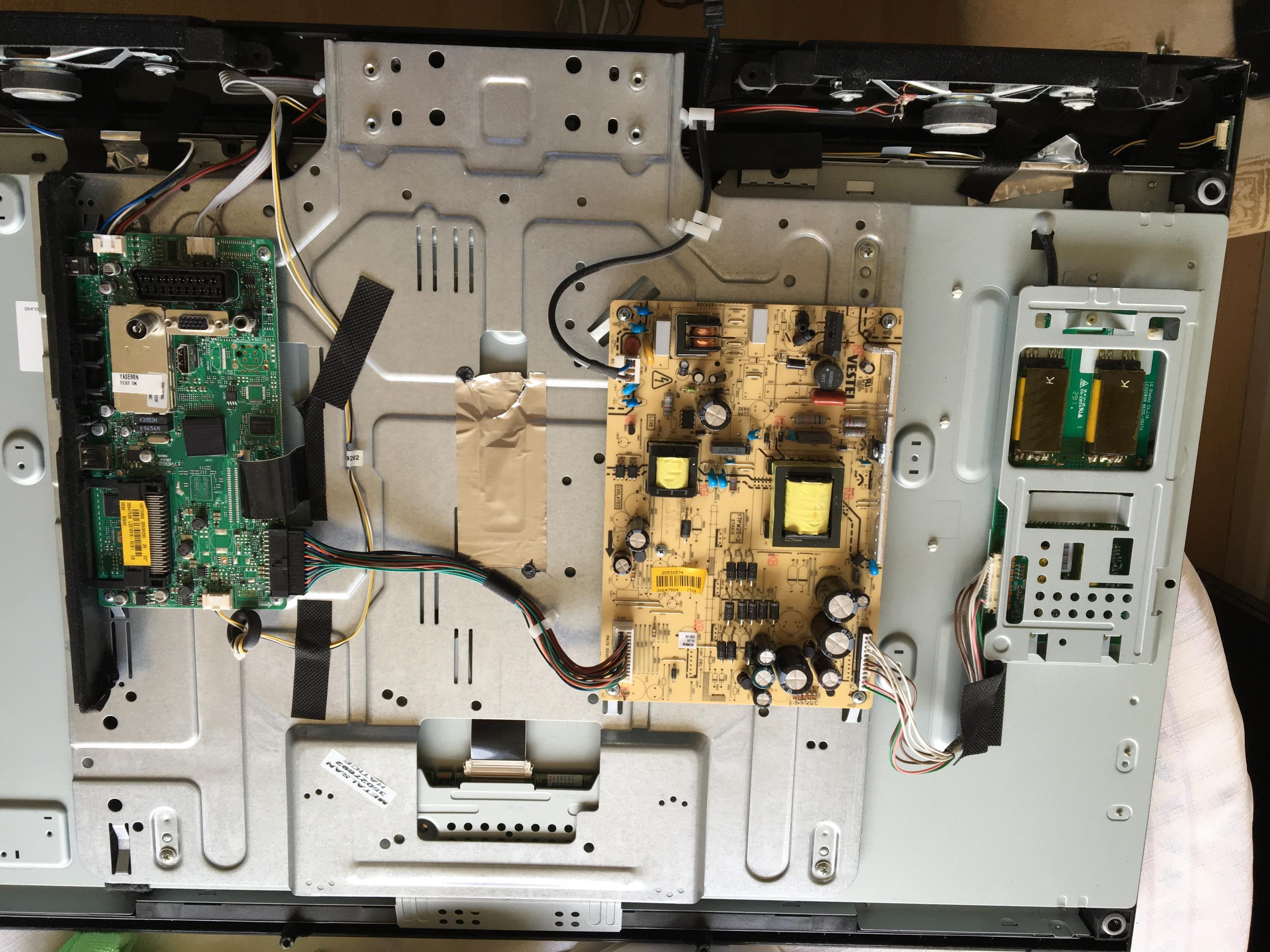

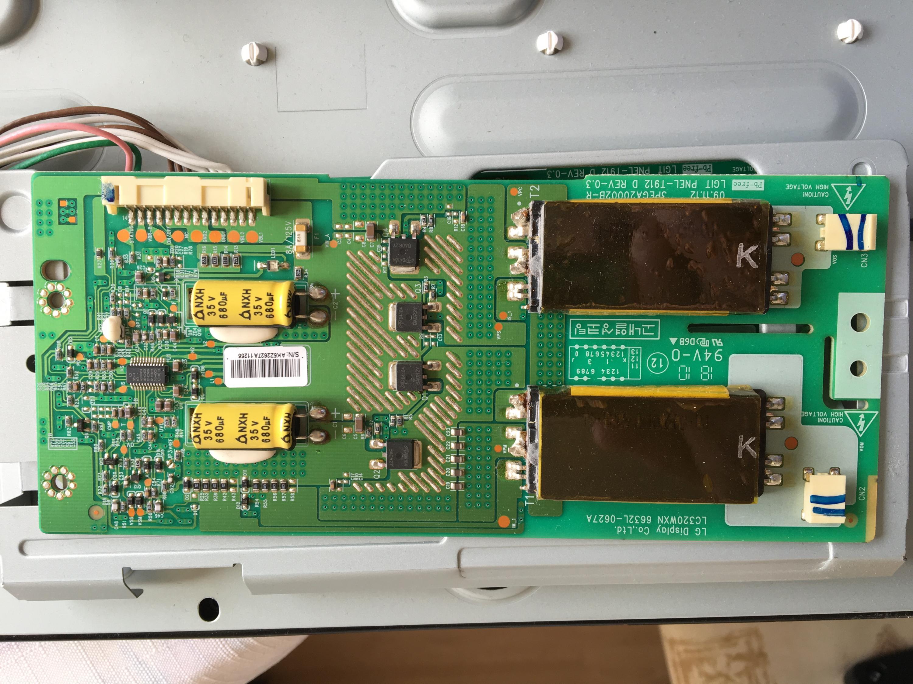

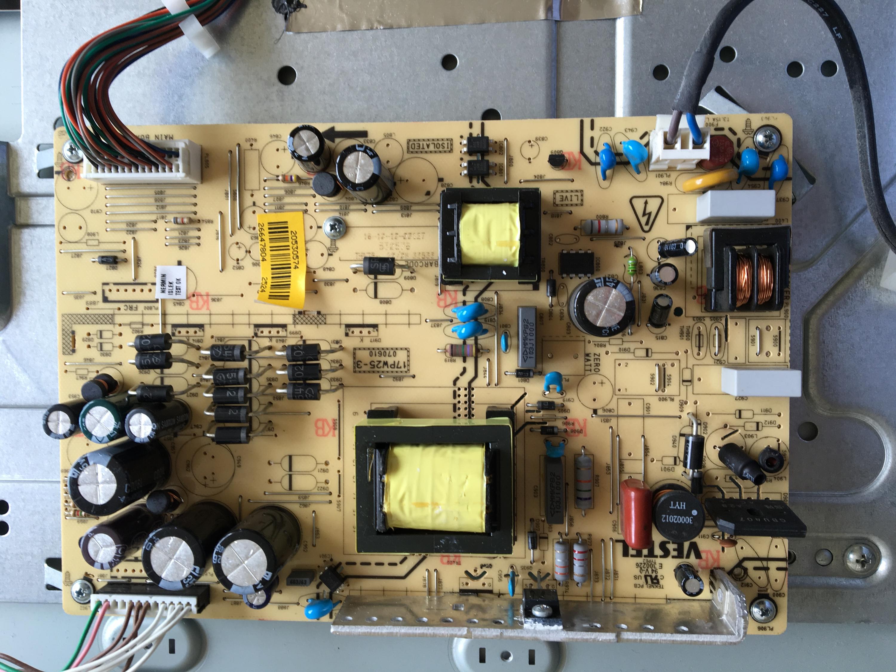

    Hi again looking for some help with this tv
    Techwood 32884HD which will not start up just flashes blue and orange leds on the front panel
    when i first looked at it with no testing i changed the power board Vestel 17PW25-3 thinking that would be the problem, however same no power up, i have just now changed the inverter board, still the same flashing blue/orange.
    Anyone give me an idea now where to start looking, maybe software or mainboard faulty
    thanks in anticipation

    Re: Techwood 32884HD flashing blue orange
    pics
    • dick_barton
      • Aug 2015
      • 6643
      • Wales
      There isn't a lot left to change. As london-freddie says some nice sharp pictures of each circuit board showing the connectors and voltage labels alongside are always a good start when seeking help.

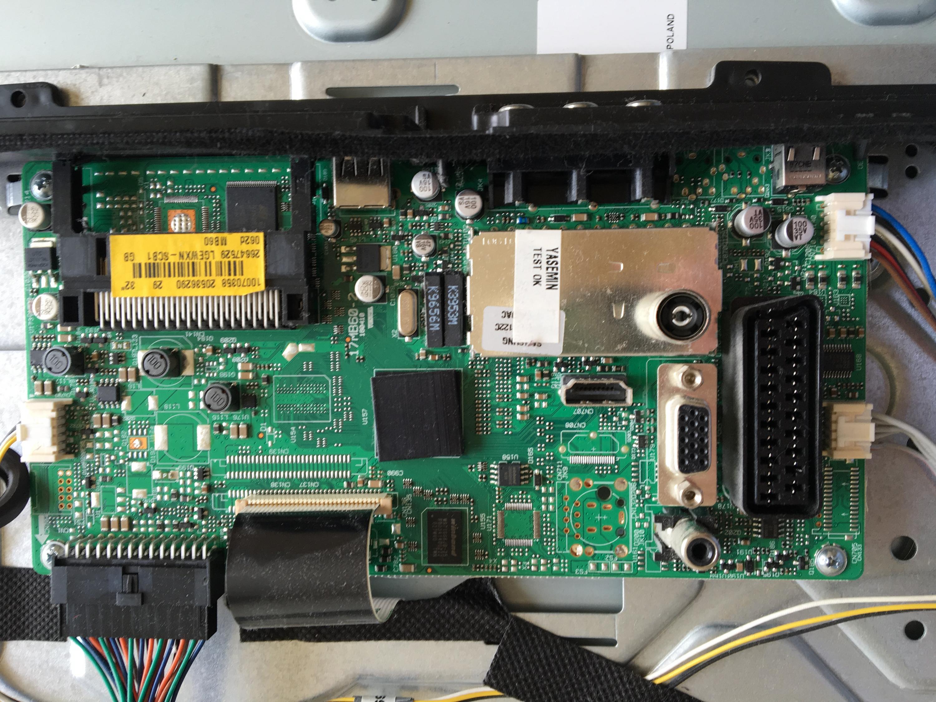

            One of your pictures is showing so far what the mainboard part number used in this set and as post 3 some good clear pictures of the connectors etc will help us.
              hope these help

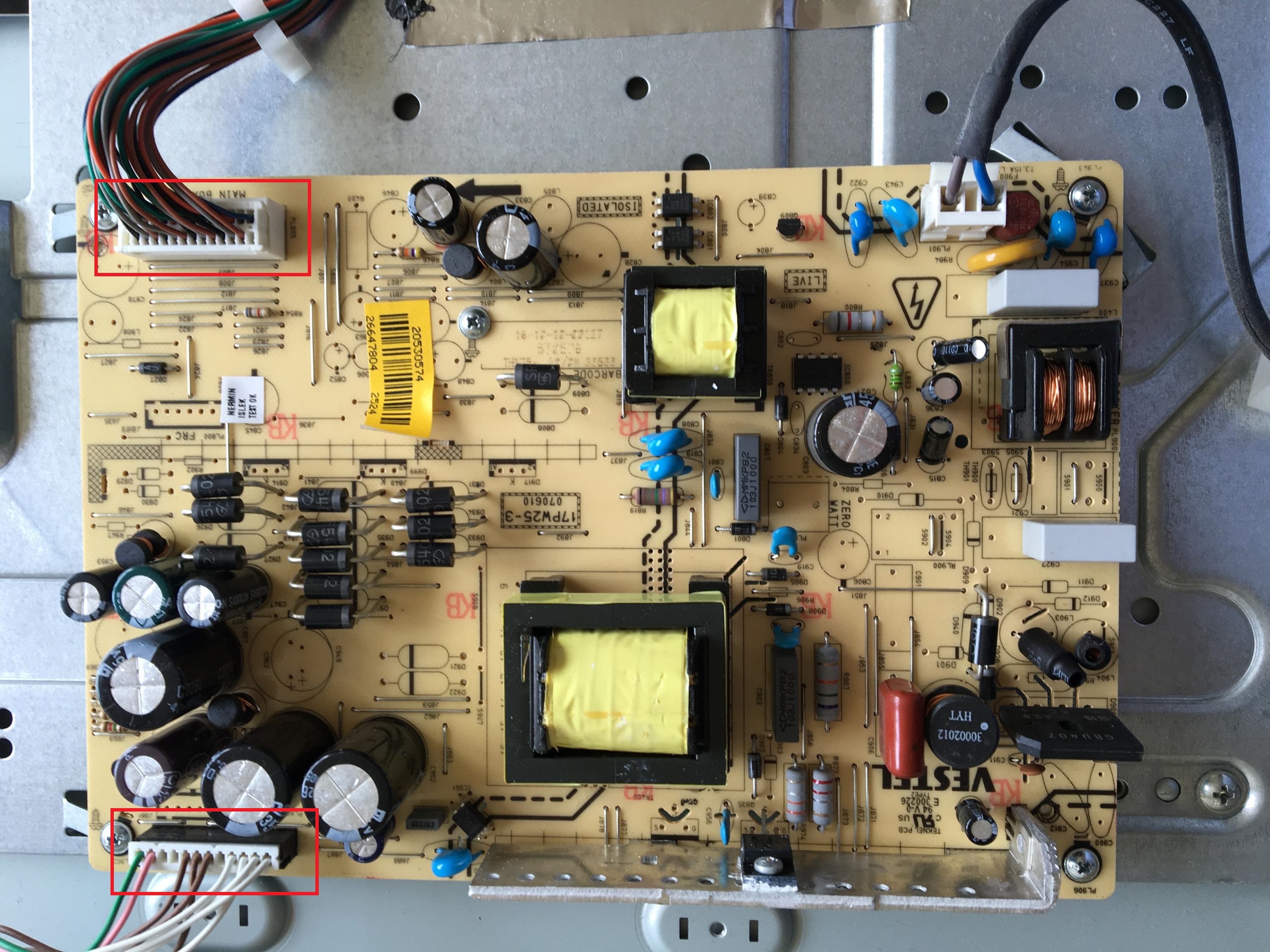

                      In the attached photo what is the printed legend alongside the connectors. It may be printed on the underside of the circuit board
                      For example
                      CON 100
                      Pin 1 = 5VSTY
                      Pin 2 = GND
                      etc

                          hi there is nothing printed alongside the connectors top or bottom of board except pl805 and pl804, no voltages or grounds etc.

                              anyone know the pinouts on PL804 and PL805 on this Vestel 17PW25-3
                                Measure the voltages on the two connectors marked in a red box and check against the service manual attached to see what is missing.
                                • london-freddie
                                  • May 2015
                                  • 472
                                  PL804 inverter connector has 25v at pins 1-5
                                  • dick_barton
                                    • Aug 2015
                                    • 6643
                                    • Wales
                                    There's also pins 10,11,12 on that connector.
                                    PL803 Pins 1 - 10 ?
                                    PL805 Pins 1 - 28 ?
                                    PL800 Pins 1 - 6 ?
                                        PL805 connector to main board all voltages seem to be ok 12v @11, 5v @17 19 21 etc.
