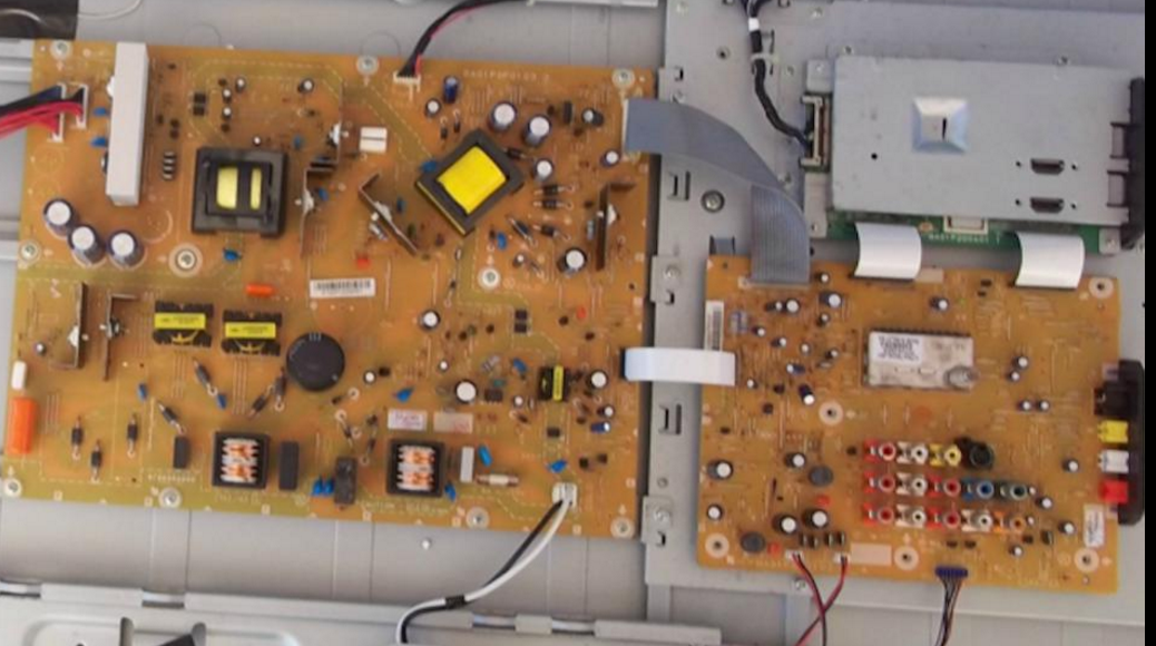

    Here is a bit more information:
    The PSU board is labeled as BA01P0F0103 2 and the part number is: A01Q0MPW-001. There are small but important differences between the 40" PSU board and the 46".
    Attached is a pic of the diodes currently in question near the transformer that is making the problematic squealing/hissing sound.

      Take a good look at diode D670,it looks like it is cracked?
      When you plug in the tuner board,it is then that the power supply gets activated hence no squeeling till then. The squeeling is often a shorted diode suppressing the transformer mostly secondary side but some times primary side.

        Thanks for your reply. I took another close look at D670, as per your suggestion, by visually inspecting/touching it on the board itself and you are exactly right. It is definitely cracked. Great eye!
        In your experience, could this account for the trouble I am experiencing with the SMPS and with the picture/sound in general?
        Yes, it is when I plug in either of the two boards on the right-hand side of the PSU that the sound in the transformer occurs. Not until then.
        I didn't focus on this particular D670 before because when I did the readings against the 40" PSU I have on hand, the 46" D670 actually read a bit higher (182) than the 40" D670 (which read 166). Whereas the opposite was true with Diode # 662 (175 on the 40" and only 153 on the 46"). So, that's why I purchased the D662 only from Digi-Key.
        I think I will desolder the D670 from my 40" unit today and replace the cracked one on the 46". They are both labeled as the following:

            Here is a pic of all the boards involved:

                            I'm back to work on the Philips 46" again, having received the numerous capacitors I ordered and the diode (662) in the mail. But, I want to check with the forum here before proceeding on replacing all of these caps and/or the singular diode.
                            Note: None of the caps look damaged in any way and the diode, while testing a bit lower than the rest at a reading of 155, actually tests with the same number reading as the new diode I received in the mail as I tested it straight out of the package. So, I have a feeling that the PSU might not be the root of the problem here.
                            The primary reason for my hesitation is that I am not getting the buzzing/hissing/clicking sound from the SMPS transformer UNTIL I connect it with the Digital Main Board. So, I'm wondering if the Digital Main could be the source of such a problem with the buzzing transformer (i.e., the problem itself).
                            Here is the sequence of the testing I did: (please refer to the pics attached below)
                            1. I disconnected the white ribbon cable from the Tuner Board to the Power Supply. Result was that the buzzing would not start up. Complete quiet.
                            2. Buzzing started immediately when I replaced this ribbon between Tuner Board and Power Supply. Initially I thought, then, that there might be a problem with the Tuner Board, but .........
                            3. I "backed that up" one more step and disconnected the two ribbons between the Digital Main and the Tuner Board, while leaving the ribbon between Tuner Board and PSU in. Result was that there was no buzzing at all. Complete quiet. This led me to believe that the Tuner Board itself was not the source of any problem related to the buzzing transformer. I then reconnected only one of these two ribbons (did the left first, and then the right in order to test them both) between the Digital Main and Tuner Board, and no buzzing. It wasn't until I connected that 2nd white ribbon between Digital Main and Tuner that the buzzing came back.
                            4. I repeated all of the same steps with the other two boards that rest above the PSU disconnected, and therefore taken out of the picture, with the same results. This appears to have isolated the Digital Main.
                            So, all of this led me to one of two conclusions:
                            Either the Digital Main has a defect that is causing the PSU transformer to malfunction ......
                            Or, the transformer is malfunctioning due to a cap or diode (probably close in proximity to the transformer), and that those caps or diodes are simply not being activated and "put into play" until the physical connection from Digital Main through Tuner Board to the PSU is made.
                            Can anyone help answer this question. Which one is more likely to be the case, and is it even possible for another board to be responsible for the transformer malfunction?

                                Re: Philips 46PFL3705D/F7 ~ No picture or sound / transformer buzzing
                                If you look at the psu,study the little jumper wires you see all over the board,some will have markings on them,especially around the cables running to the tuner board etc. You will find markings saying 5volt stby,35 volt et.etc.
                                Those are your test points,red lead on the jumper,black on the chassis of tv,dmm in dcvolts.
                                With tuner unplugged,psu doesn't squeel(bd spelling,lol)could make sense:
                                -either your right and the tuner bosrd is shorting the psu
                                -tuner is trying to activate psu,hence making it squeel.
                                Maybe test the 5volt standby without the tuner,then with the tuner,repeat for the 35 volts and other voltages you find,see if one gets pushed down when tuner gets plugged in?(you prob wont have the 35 volts till tuner gets plugged in,still good to see if 35 is indeed 35)
                                35 volt to ground means:with power off,dmm in ohm,red lead on 35 jumper,black on chassis,read ohms.
                                fets you can measure in the ohm setting,power off,red lead and black lead on all combinations,1-2,1-3,2-3 see if you get a short on any of them. (unlikely but you never know)

                                  Hello martino, et. al. ~
                                  Below are the initial voltage measurements I just took with all of the cables and ribbons hooked up throughout the entire set. Then, I did the same tests with only the PSU in play and all of the other boards disconnected from it.
                                  Note: Every time the AC is applied, the set buzzes for a total of about 15 seconds before shutdown. This has been true from the very start. So, the information below is timed out over that 15 second span.
                                  WITH EVERYTHING CONNECTED:
                                  35V+Tuner = Started out at 34.5, then over the course of the 15 seconds it rose to and past 35 (took about 8 seconds to do so) and then stopped at about 36.8 just before the system shut down.
                                  3.3v = Rose immediately to 3.4 and stayed until shutdown
                                  3.5v = Initial rise to 3.2, then quickly to 3.3 and then hung at 3.4 until about the 10 second mark. It then finally climbed up to 3.5 but no higher and that only lasted the final two or three seconds of the 15 seconds before the ritual shutdown.
                                  5v = Rises to 5.1 immediately, gets to 5.2, and holds there until shutdown
                                  24v = Rose immediately to 25.5, then continued to rise until 26.7 and stayed there until shutdown.
                                  WITH ONLY THE PSU IN PLAY
                                  Important Note:
                                  During this set of tests, all of the other boards were disconnected from the PSU in various ways and manners, including the Tuner Board and the Digital Main. It did not matter which boards were disconnected, how many were disconnected, or in what order. The result was always the same:
                                  35+Tuner = 0.00
                                  12v = 0.00
                                  3.3v = 0.00
                                  3.5v = 1.2
                                  and
                                  24v = 0.00
                                  Also, I measured the connectors in the upper-left hand corner of the PSU that lead to the inverter boards, and while several of those pins on the bottom half of each connector read 1.4, none of them ever read higher than that when the other 4 boards were disconnected from the PSU.
                                  Retest: 2nd try with all ribbons and cables reconnected to the PSU once again
                                  All of the readings above came back as expected and as follows (just as before):
                                  Given all of this, it does appear that the PSU is indeed not activated until the ribbons and cables are connected from the PSU to the other boards, and in particular from the Digital Main board (through the Tuner Board) to the PSU.
                                  Is that normal in an LCD tv? I have only worked on plasmas for the last couple of months. Or, is this particular to Philips or this model?
                                  Either way, I still don't think it answers my question if the caps/diode are bad on the PSU surrounding the SMPS transformer ...... or if the Digital Main Board is bad. I took the Digital Main out and got the Part # off of it in case I need to order one. They run about $25.
                                  Would you just replace the caps and diode at this point and see if that fixes or alters things? And then replace the Digital Main Board if necessary?
                                  One other note:
                                  I measured the 35v to ground that you asked for, martino, and that came up as a reading of 43.5 when I put the DMM setting to 200k in the Ohm range.
                                  Or, is there a better approach for me to take based on the voltage data above?
                                  Do some of those initial readings in the first few seconds of the 15 second time span matter in that they are not getting up to the expected values immediately? In particular, the 35v line only gets to 34.5 and takes about 8 seconds to reach 35 and above. However, the squeal from the transformer always starts right away as soon as AC is applied and doesn't stop until the set shuts down.
                                  I really don't want to replace the caps and diode right now if the only problem is the Digital Main board. How can I tell for sure?
                                    What happens if you have everything plugged in except the inverter board?
                                      Hadn't tried that before.
                                      Just tried it now, and got the same results as before. Namely:
                                      I really think if there is a fault outside of the PSU itself, it lies in the Digital Main board based on what happens when I disconnect it. No squealing occurs until that Digital Main is put into play.
                                        There is a small ripple on one of the two ribbons coming out of the Digital Main and into the Tuner Board. It's not quite a slit, but it is definitely pronounced. Based on my prior testing, I didn't think it the cause of the trouble.
                                        But, in your experience (anyone), is this enough to cause the transformer to malfunction?
                                        I don't seem to have a perfect match on hand with any of the other tv's I'm working on in order to do a swap/test.
