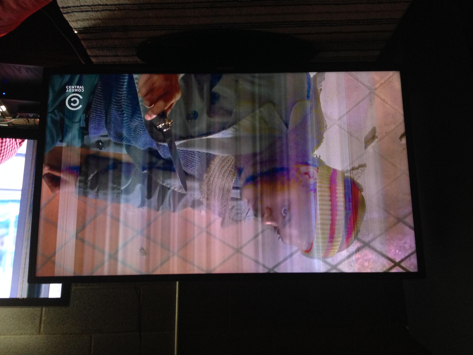

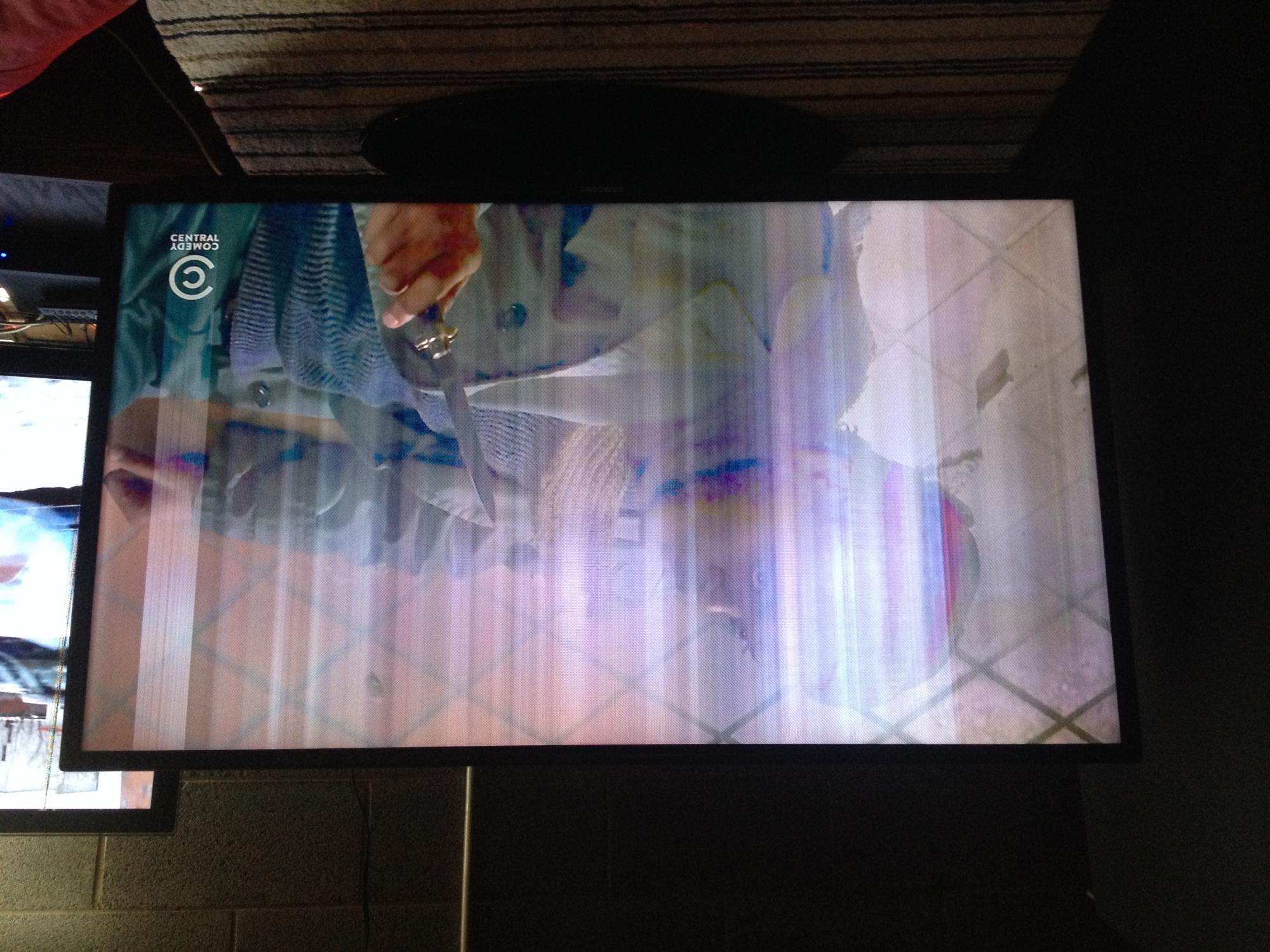

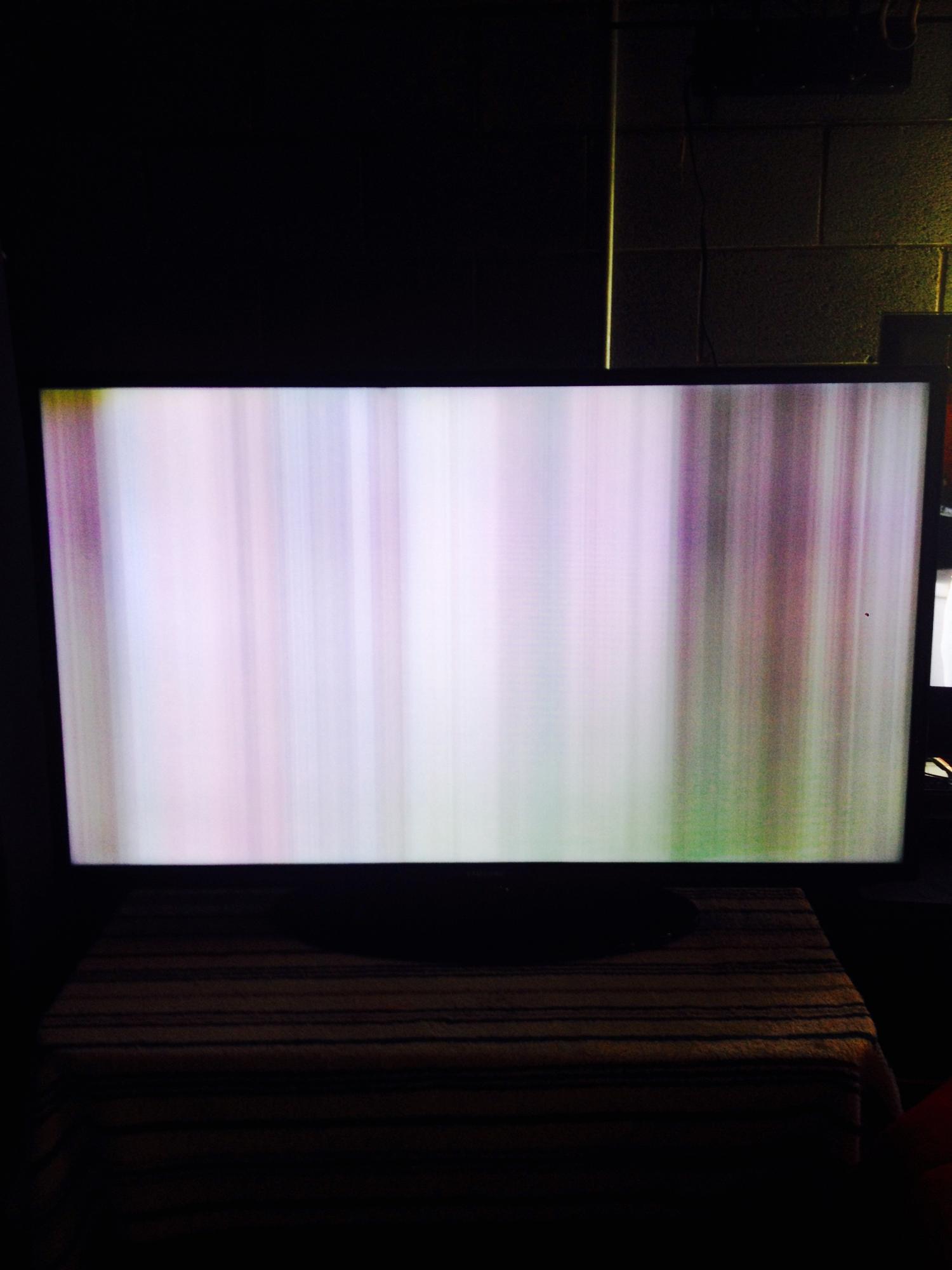

    I'm troubleshooting a Samsung UN46EH5300F that plays fine for about 5-10min then starts to ghost and white out. The image seems to freeze as well. Any ideas to what might cause this? Is the t-con or the panel? Any advice or ideas to try on it is appreciated.

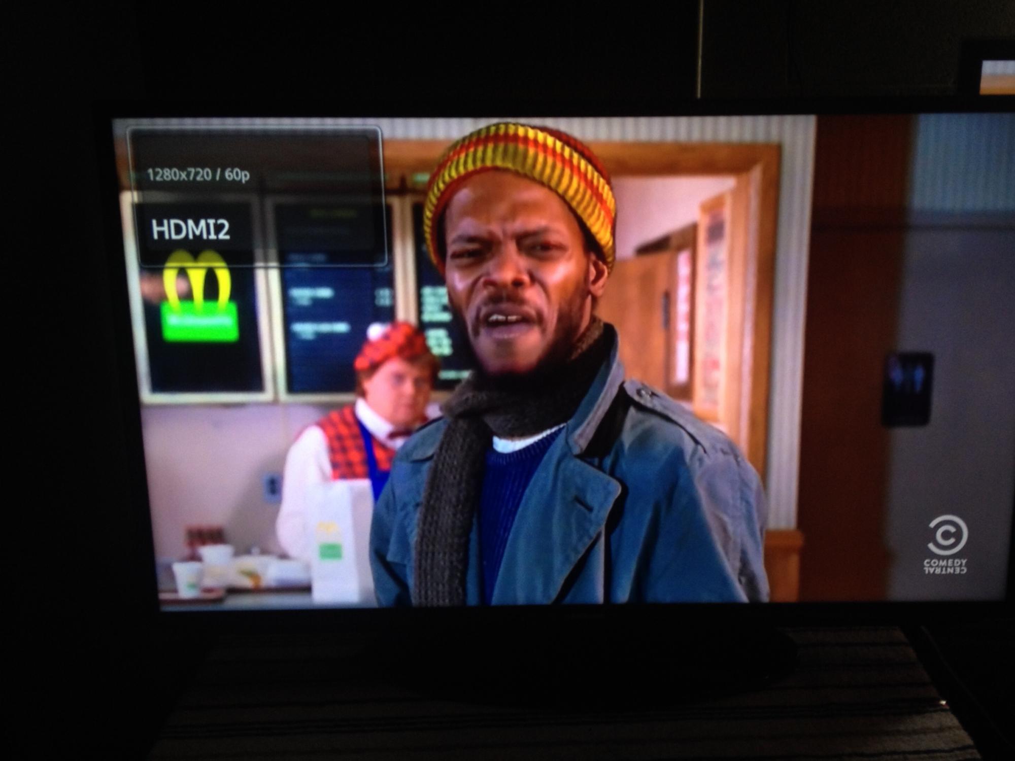

    does Menu show ?
      Re: Samsung UN46EH5300F Screen Ghosting? t-conn or panel?
      Yes sir it has a perfect image for like 4-5 min, then just starts fading away.

            Problem solved! Turns out the t-con was getting in a bind while the TV was on the stand. Fixed the flex problem with some leftover thermal tape from and old LG plasma!
