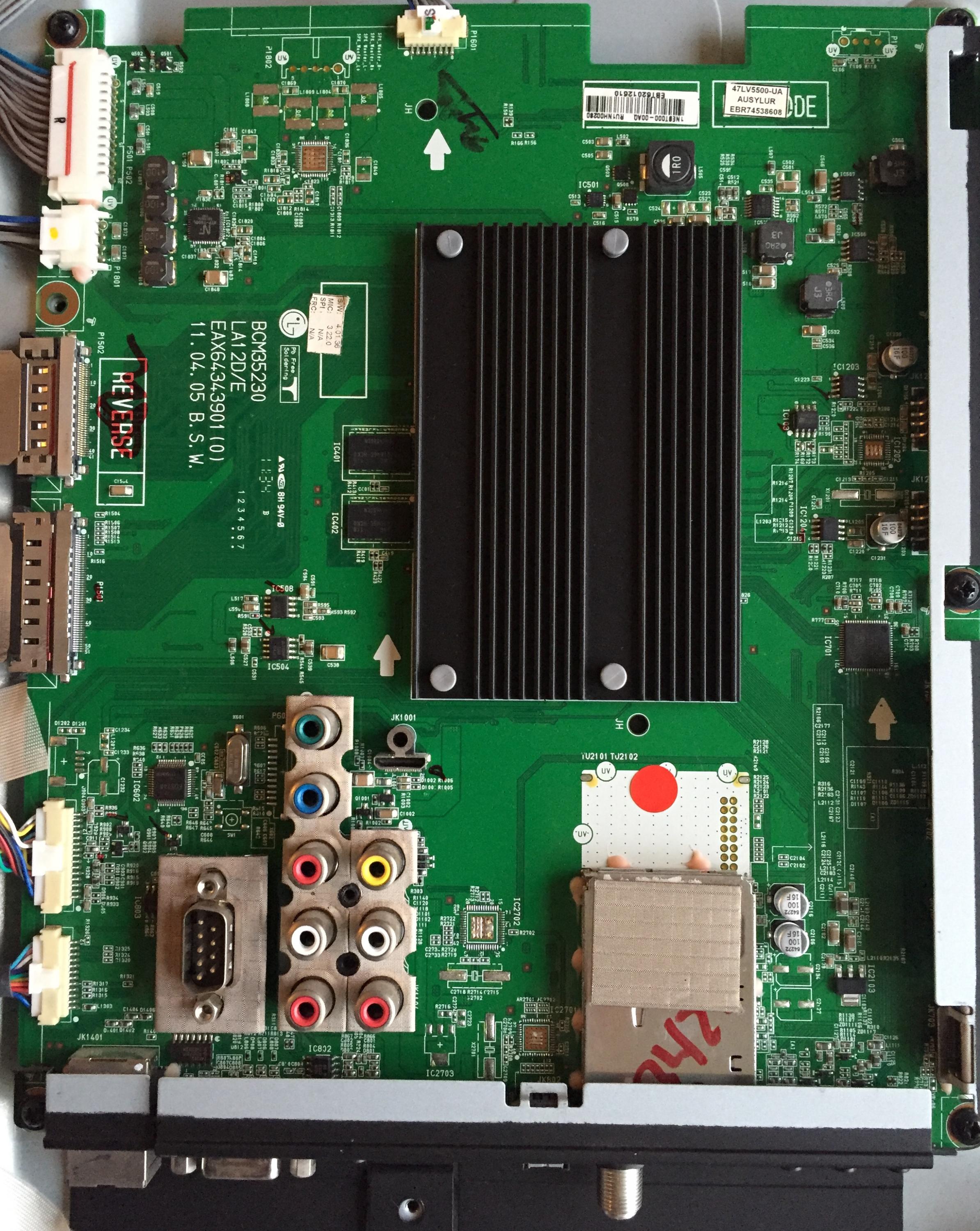

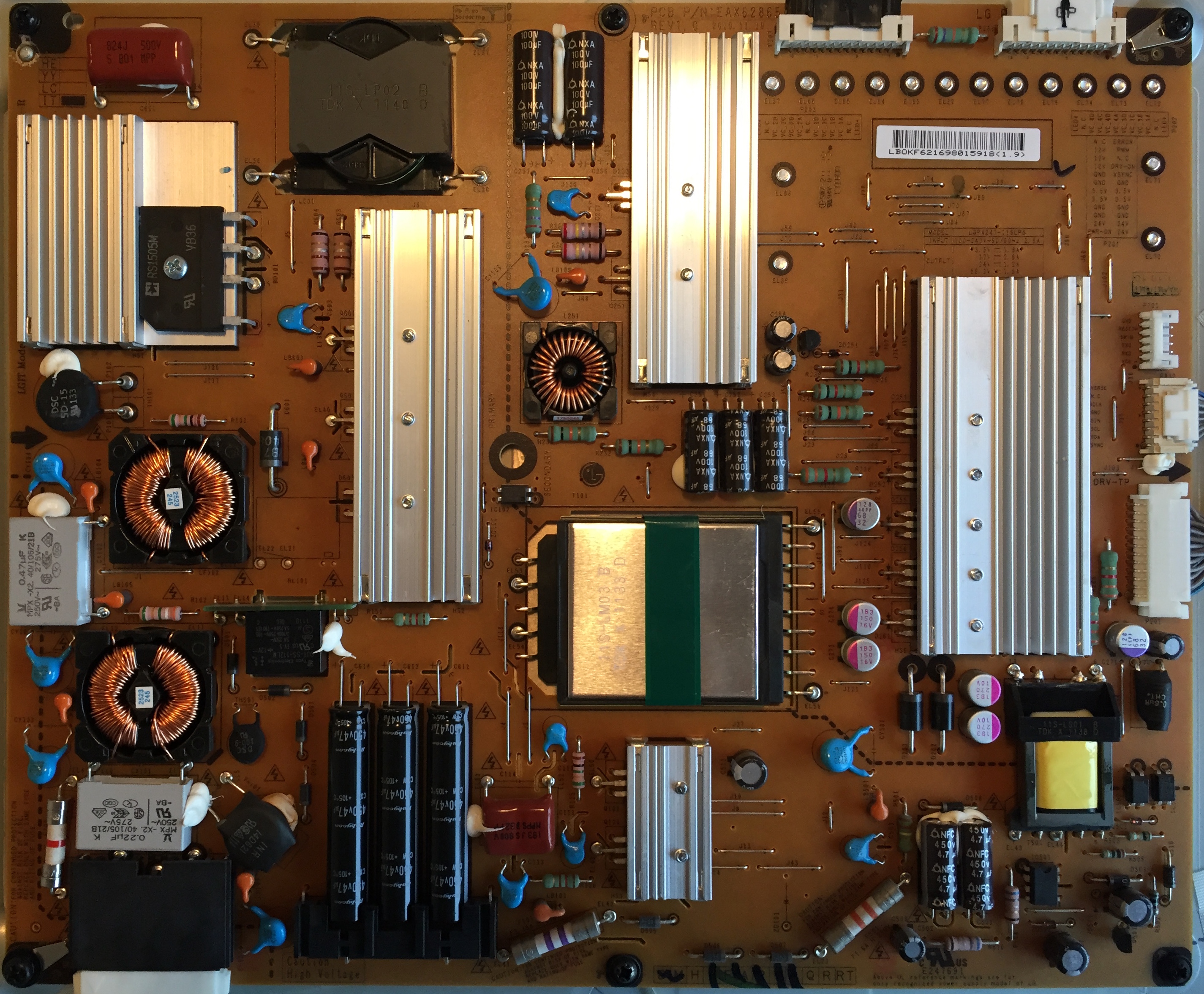

      Re: LG 47LV5500 - No picture, no back light, no sound, powers on.
      Here are the photos...
        I am not sure if this power supply /LED driver board has built-in pull up resistors or, so try disconnecting the cables between the main board and the power supply board and then plug the TV into the outlet to see if you get backlights or not, also check the DCV between the two legs of the main filter caps (those 3 caps laying the side) in the primary side to see if you have close to 400VDC or not.
        • Diah
          • Feb 2013
          • 6341
          your diagnose of main board correct, its mini LVDS, repair cant not, only replace or try chance of 30% to heat ( packing )your main board.
            I disconnected the PSU from the main board. Once done, the power LED no longer turns red when TV is plugged in and on/off toggle seems to have no effect. Backlights did not come on.
            I am not sure which are the main filter caps...
              By "heat packing" do you mean putting the board in the oven at 385F for 10 minutes?
                No, you will not see power indicator because we are trying to do the power supply-LED driver board self test.
                There are 3 black caps laying on their sides right next to each other and close to the AC inlet, so just use the meter to measure DC between the legs of each cap.
                You must be careful since you are working in the primary deadly side of the circuits.

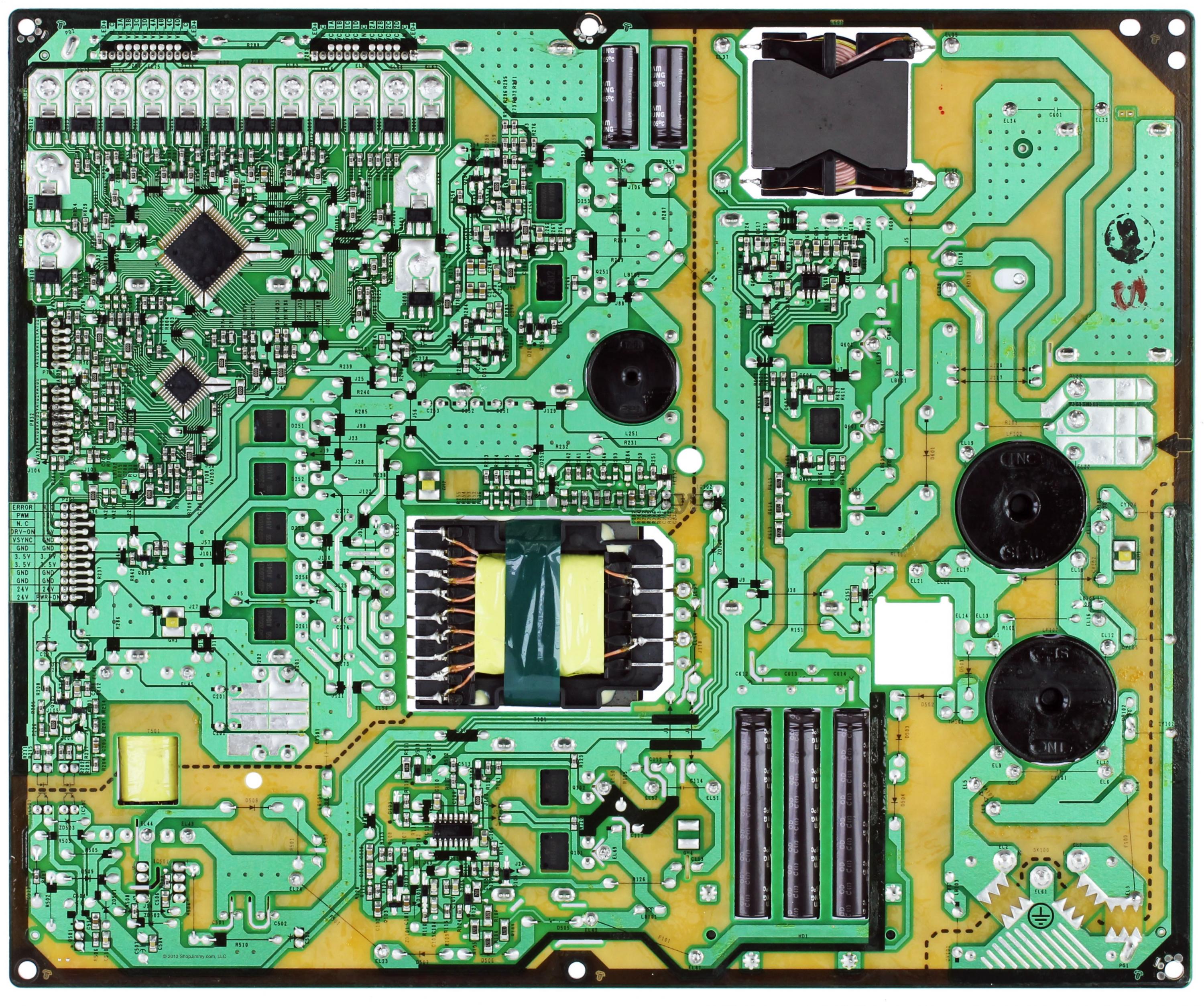

                      http://www.shopjimmy.com/catalogsear...?q=LG+47LV5500
                      Is this the exact match of your board based on P/N from SJ?
                      http://www.shopjimmy.com/lg-eay62169...upply-unit.htm
                      LG EAY62169801 (EAX62865401/8) Power Supply 47LV5500 47LV5400 42LW5300
                      Ans also when you have all the cables connected you need to find out if you have >2.5VDC on PWR-ON pin and DRV-ON pin of the connector P201. We want to at least narrow down to see where the problem is first since main board is not cheap.
                      Pictures provided by shopjimmy.
                          Sorry for going MIA after you all responded so quickly to me - it's just been one of those busy periods.
                          Anyway, yesterday, out of sheer reckless curiosity, I decided to throw the main board in the oven @385F for 10 minutes and let it cool for an hour. This is an absurd thing to do that has nothing to do with the thorough and methodical methods I came to this board to learn about. But, it worked... I put the main board back in and the TV works fine now - all inputs are working.
                          I have read enough about "reflowing" motherboards etc that I get why it worked, but it still just strikes me as just silly. And, while I am thrilled to have the TV working, I now need a new project where I will actually learn something!
