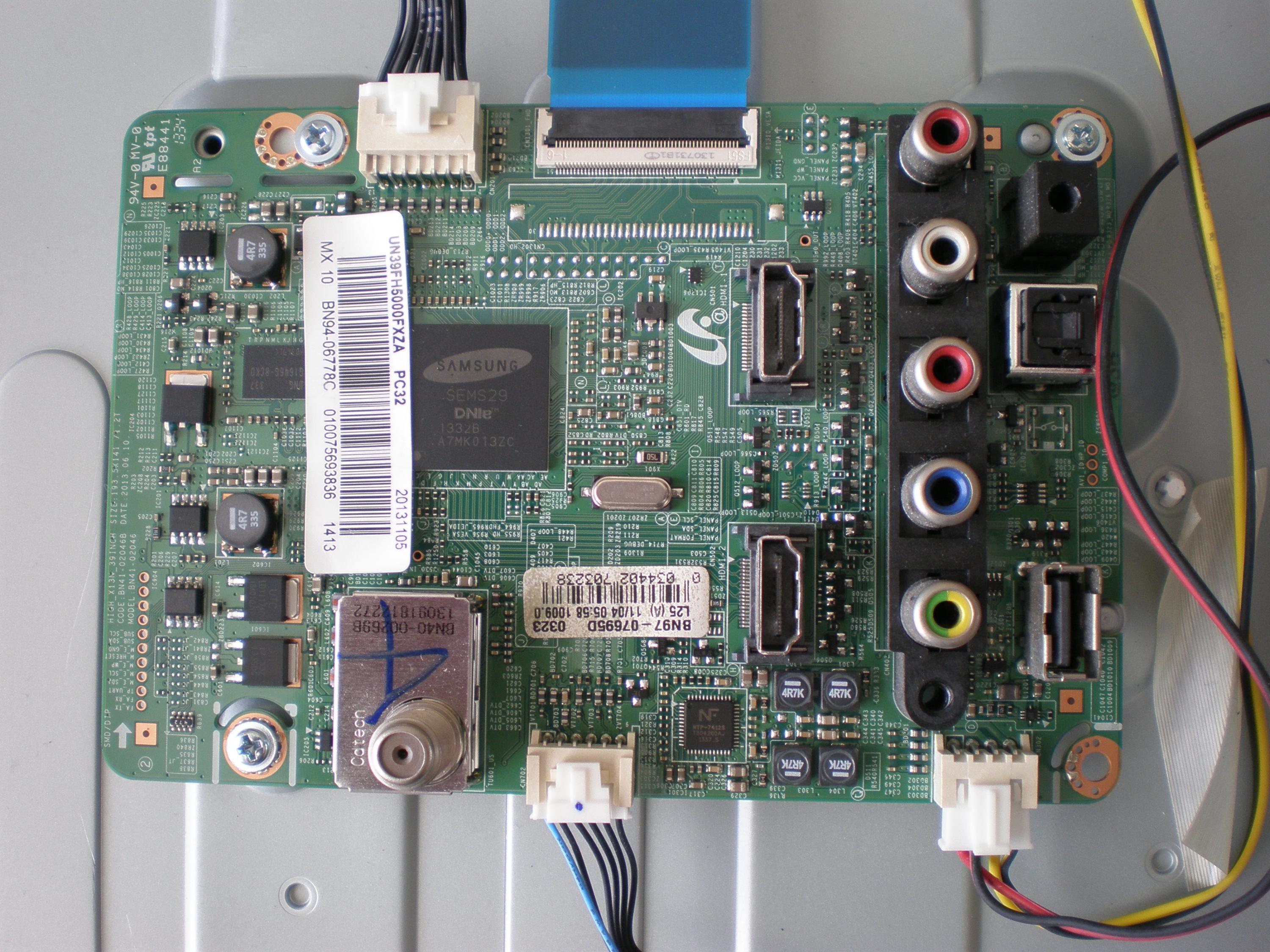

    Main Board - BN94-06778C / BN97-07695D - 2 separate stickers Manuf/Vendor

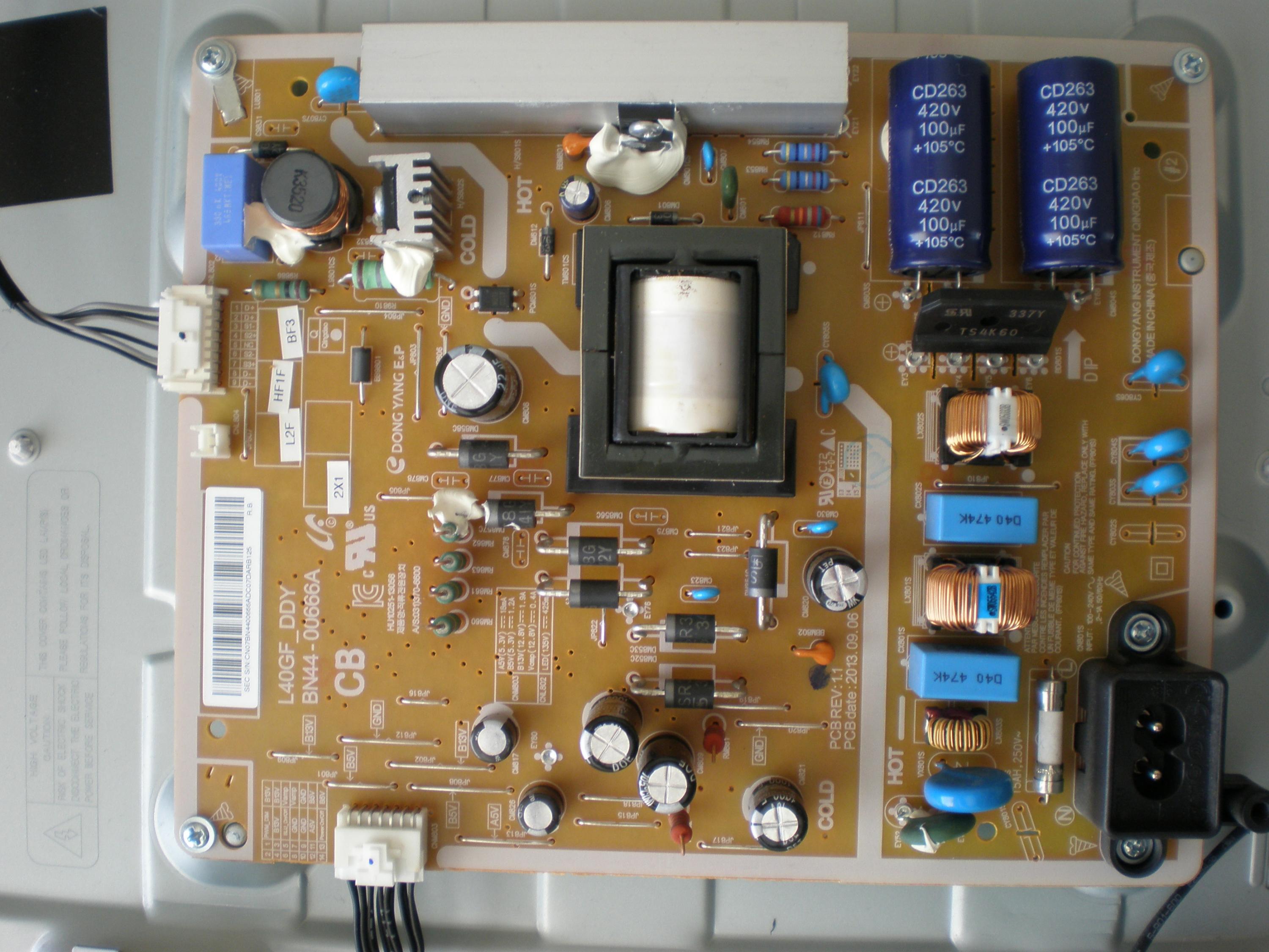

    PS Board - BN44-00666A

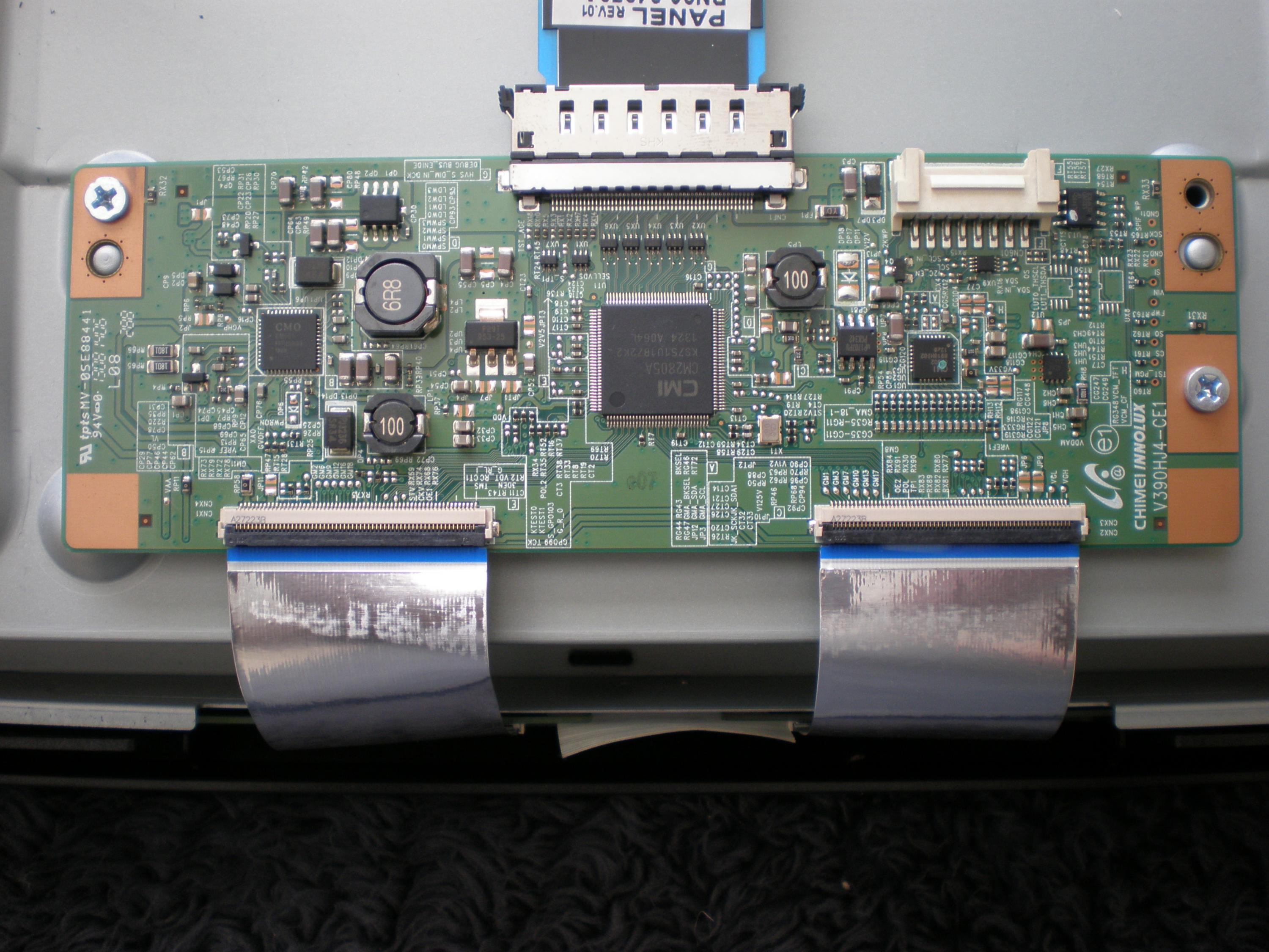

    T-COM Board – V390HJ4-CE1
    I like to know if there is some additional troubleshooting steps I need to perform to hone into the problem.
    I already examined the PS board for swell capacitors and there doesn't appear to be any.
    I located the PS connector that connects from the Main Board to the PC.

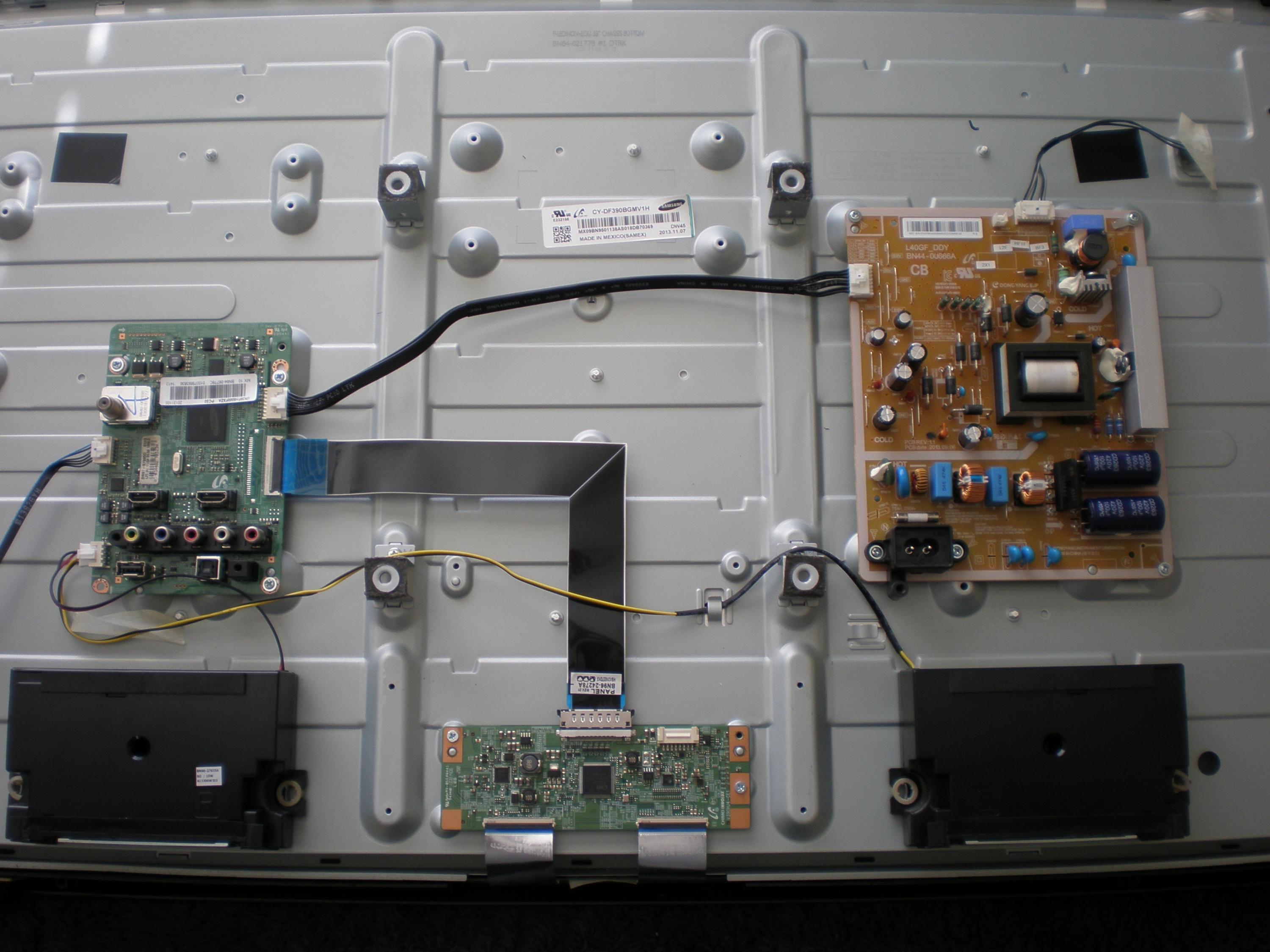

    Can we see the pictures of the whole backside of the TV so we can see all the boards and how the boards are connected together?
    Do you get backlights and backlights will stay on when you remove the cable between the power supply and the main board? If you do then you have main board problem or something is telling the main board not to send commands signals to the power supply board, right now the power supply board is getting the PS-ON becuse you are getting the switched 5VB, and switched 13VB, need to find out if you are getting the BL-ON signal or not.
    These are your boards, right?
    http://www.shopjimmy.com/catalogsear...?q=BN44-00666A

      Here are the pictures you requested and yes they are of the ones you provided from the link.
      In the normal configuration, as described in my troubleshooting steps, there is no backlight appearance.
      However, per your instructions, i did disconnect the cable from the main board to the PS board and YES, I have backlight!!
      So this does in fact point to a Main Board problem?

        Yes, it is pointed to the main board not sending out the BL-ON to turn on the backlights, so put all the cable back in place and then disconnect the cable between the main board and the T-CON (the big flat black cable) and see if you can turn on the TV with backlights but no pictures on the screen.
        BTW, this power supply board has pull-up resistors to allow you to test the power supply board function to help narrowing down the problem which is what we just did.

            The main board is the one that sends the BL-ON signal to turn on the backlights circuit, but right now the main board is not doing that, the BL-ON is probably stuck low right now due to the main board problem.
            You can disconnect just the BL-ON control wire going to the power supply board (everything else hoked back up), if all other functions of the TV are OK, then you should see the pictures, sound, and all the functions should be working, if not then you have more than just BL-ON control signal problem.

                      As I was removing one of the mounting screws on the Main Board, it appears it was under mechanical preload. The board has a slight warp to it which can indicate after heat and Ambient cycles (ON/OFF) components could lose connection.
