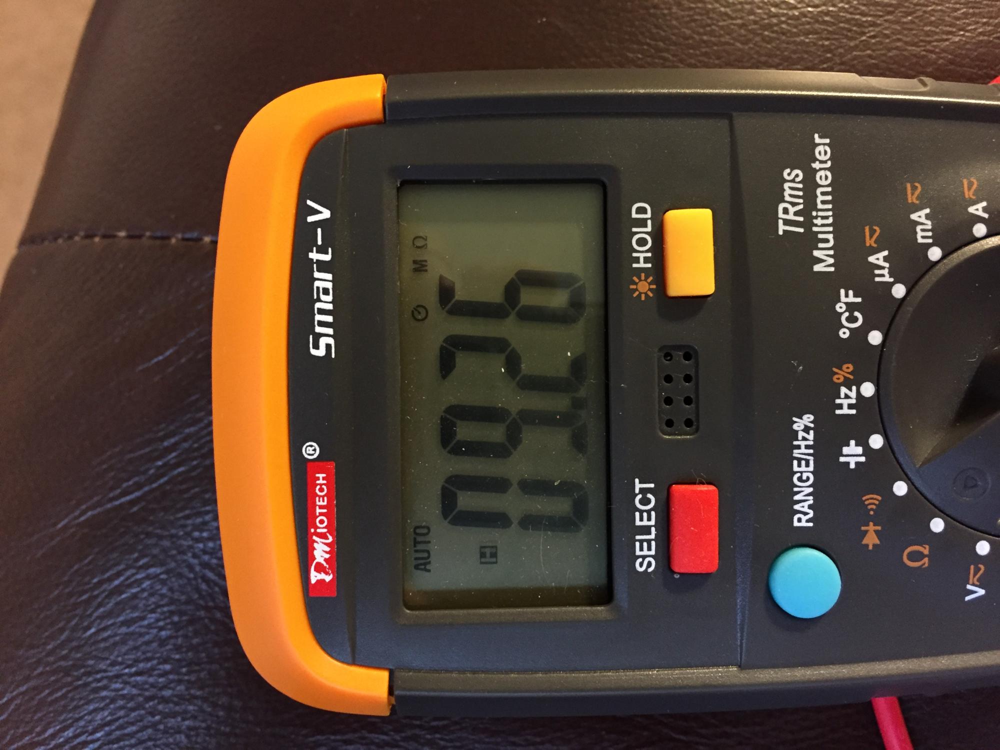

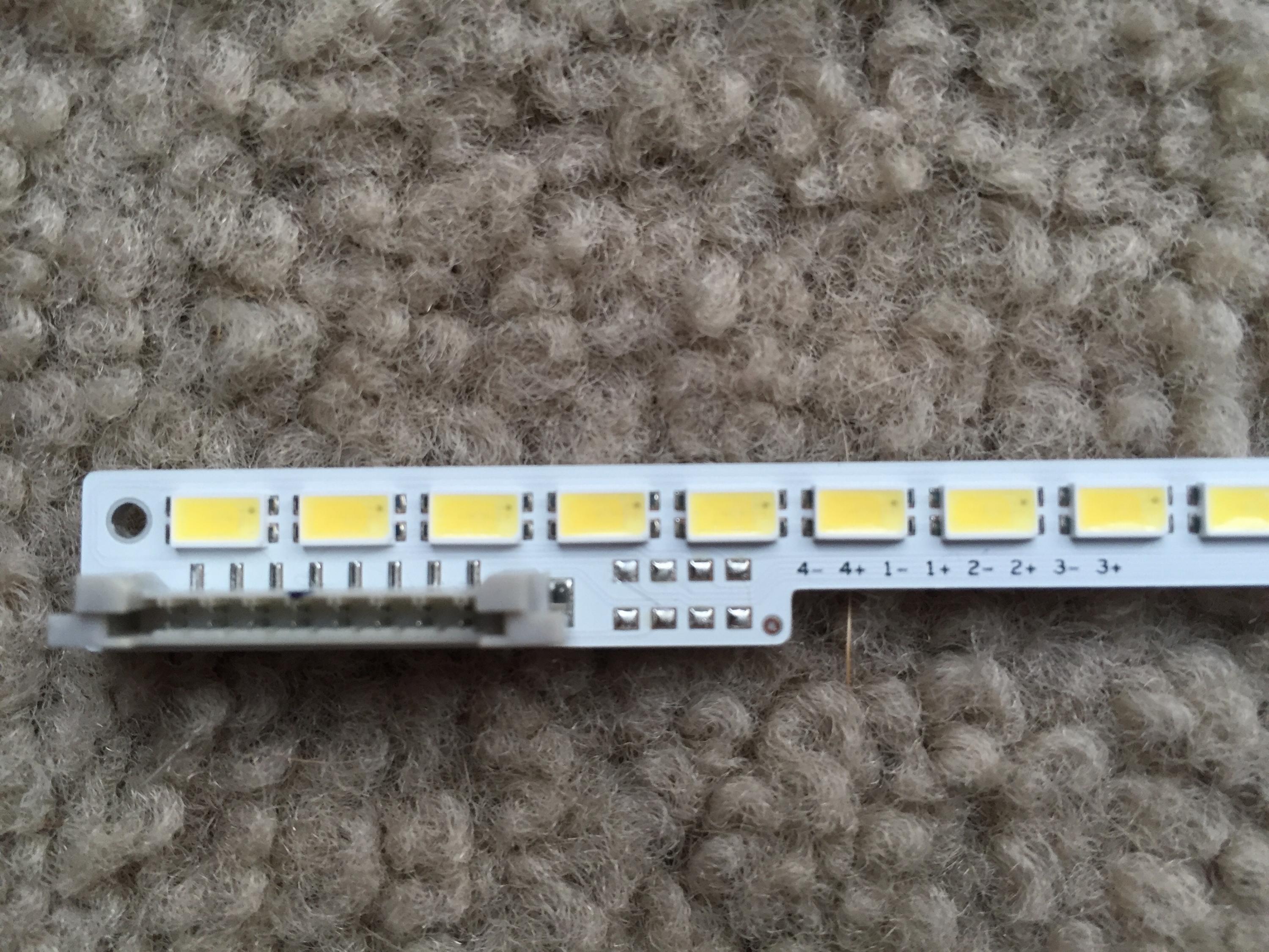

    OK I did not know if that the reading of just one +pin or all 4 +pins.
    The result is telling us that when all connectors are in the place, the one with reading of 325V is not seeing the load so the Voltage is same with and without the connectors (Loads) in place, as you can see when the loads (connectors removed) are not connected to the other 3 output Voltage of all three went up high.

        It confirms that the fault is with the leds and not led driver circuit.

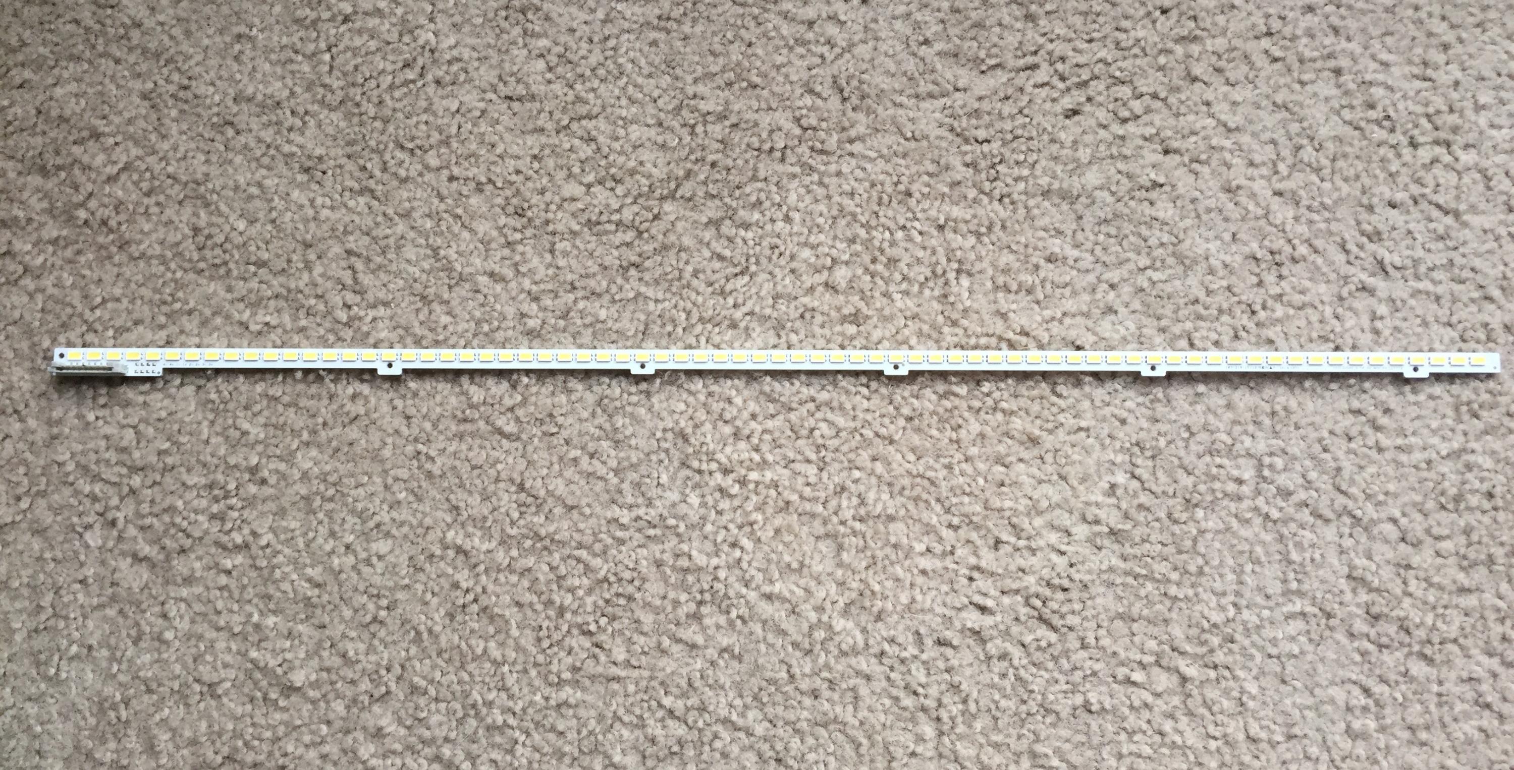

            if i am in your place would not buy strips, just replace dead LEDs,
            CH1 bad from the test you did, follow it wiring to side strips and check Leds on
            you have 72 Leds on side, / 2 make 36 on CH1, and CH1 had 3 groups mean 36/3 make 12, from this 12 you have one Open or more. they are not hard to replace at all.

              • Malachi

                  • Dec 2015

                    No, you have screw first to move , then the Strip should pushed to outside forward to the socket direction, the Alu of the strip had an hole being in pin of the base, by pushing it to the direction of socket the hole and the pin will be in center to left it out

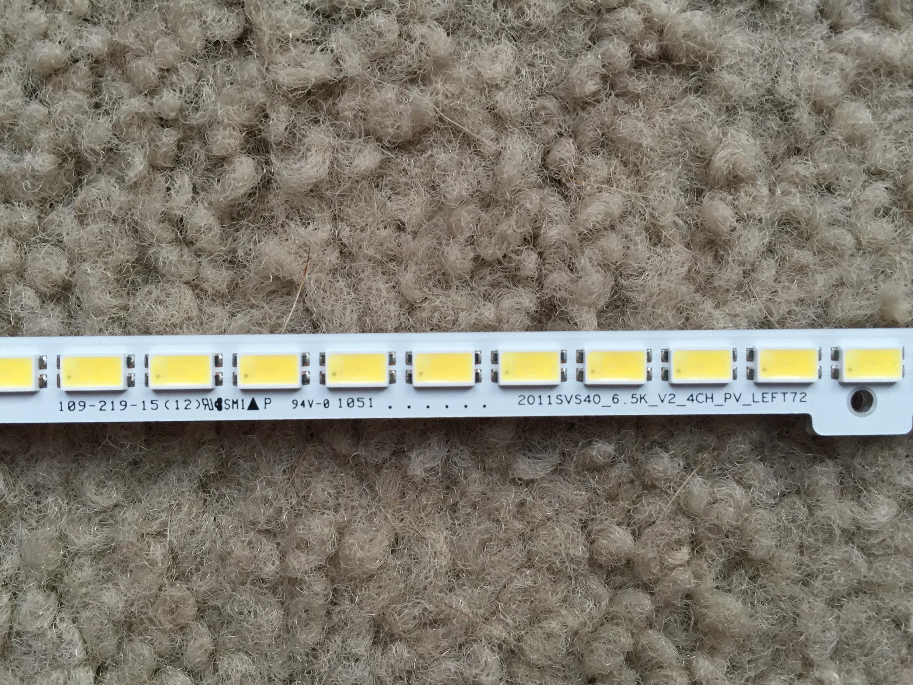

                        I see the screws but I searched for the LEDs by the number on the led strip themselves. The only ones I found are in that link.

                          i wrote to you.. they are 7030 6 volts, https://www.badcaps.net/forum/showthread.php?t=52847
