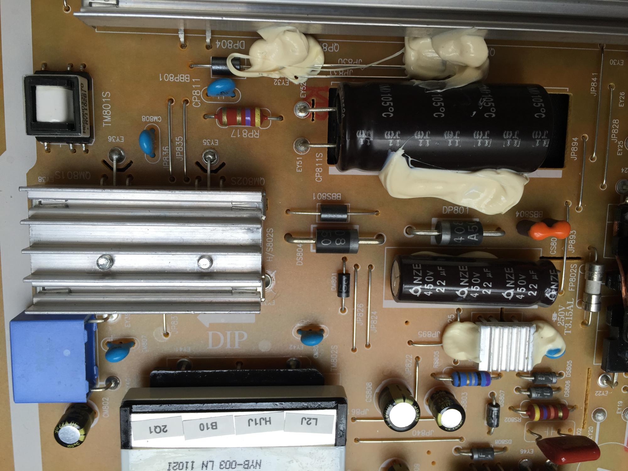

      With my meter in diode mode this, I assume, diode beeps everyone I test it. It's on the board but none of the others beep.

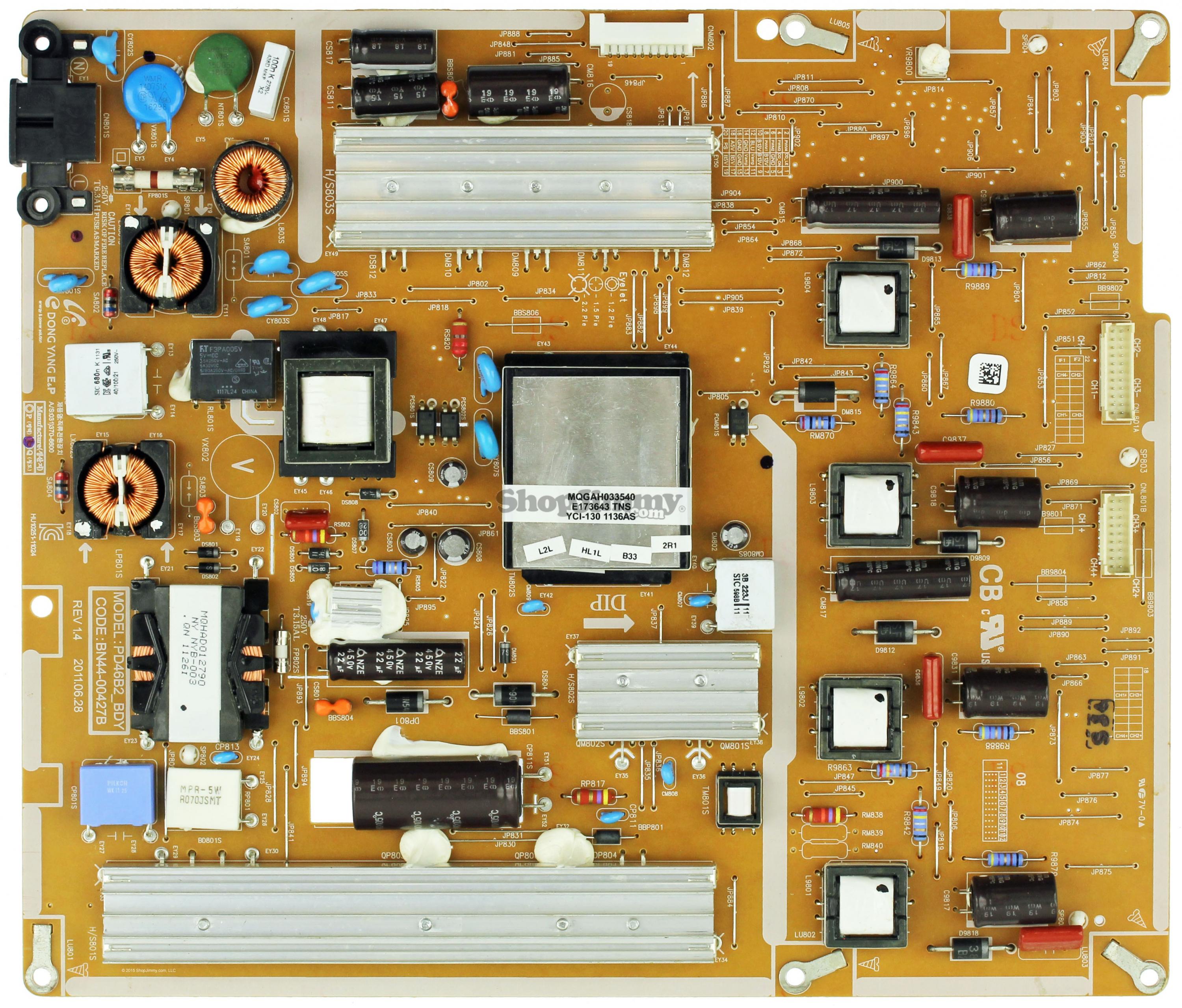

          Re: Samsung UN40D6400 led problem
          Your board is Samsung BN44-00427B (PD46B2_BDY) Power Supply / LED Board?
          http://www.shopjimmy.com/samsung-bn4...upply-unit.htm

            Also bbs801 beeps but I don't think it's a diode.
            Also another one like it labeled bbp801 beeps.

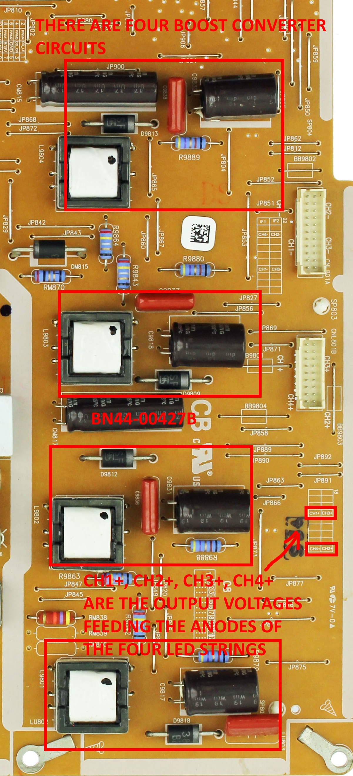

                      Check the CH1+, 2+, 3+, and 4+ (Anodes Voltage feeding pins) one at time by leaving the probe on one pin at a time and see how high the Voltage goes up too and then drops down, do that on all 4 + pins, Black probe on the chassis.
                      The drivers has 4 boost converter circuits to feed 4 stings of LEDs.
