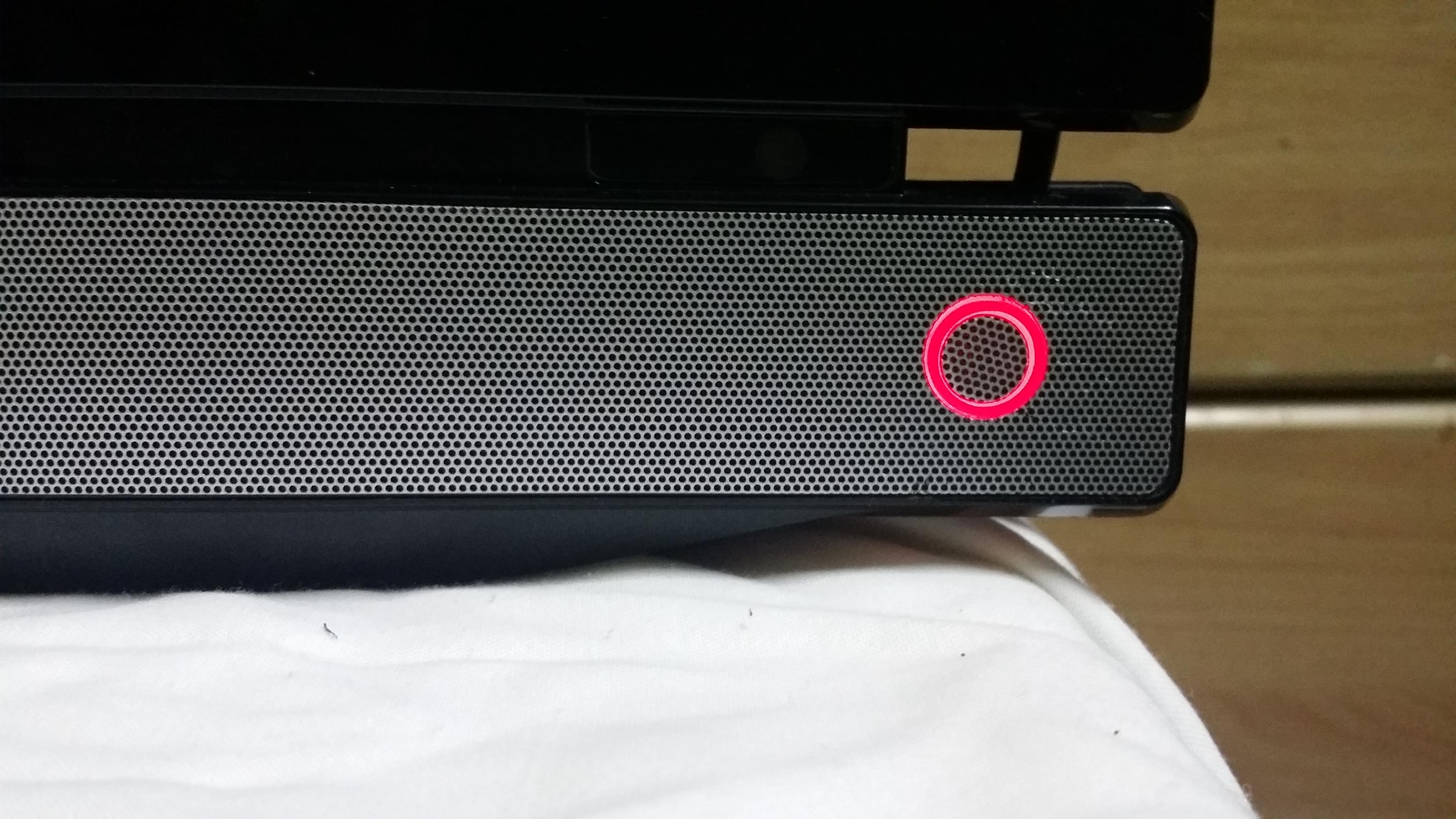

    Good day guy's
    I'm would like to ask a help for this unit.
    It's almost a year ago when it purchase this tv,
    3 days it won't turn on even if using the manual boton. But there's a solid red standby light indicator show. When a check the standby voltage is get 5v
    In my tester. Could you give me some advice what
    I'm need to do to solved the problem of my tv.
    Thanks in advance.

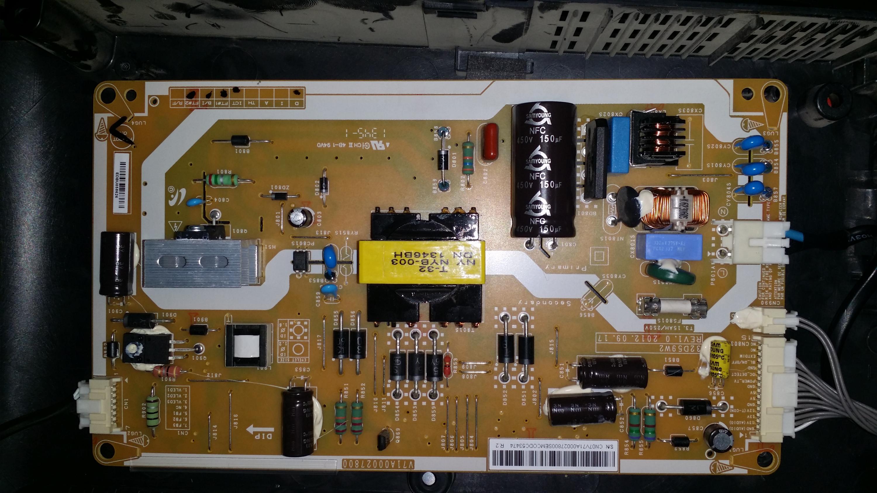

      Re: Toshiba led tv 32P2305EE won't turn on
      check for shorted diodes
      maybe post pictures of the boards nice and clear please

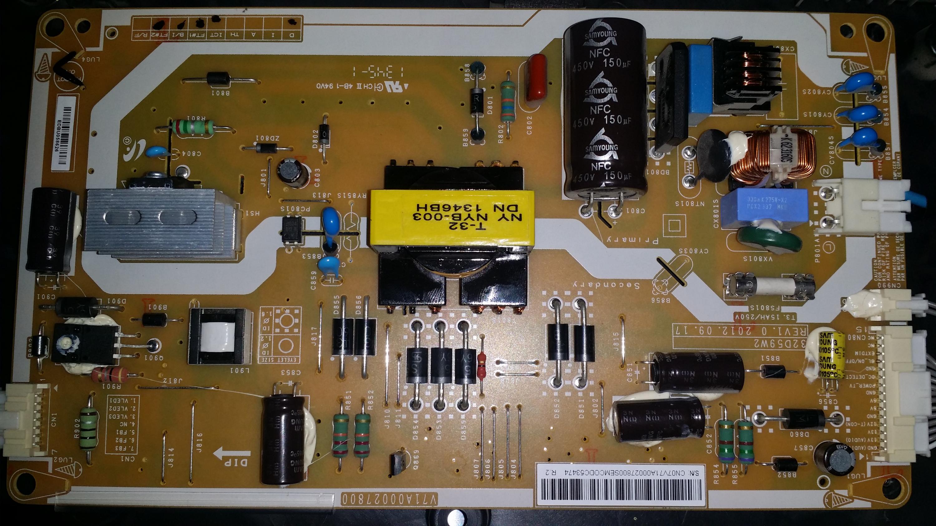

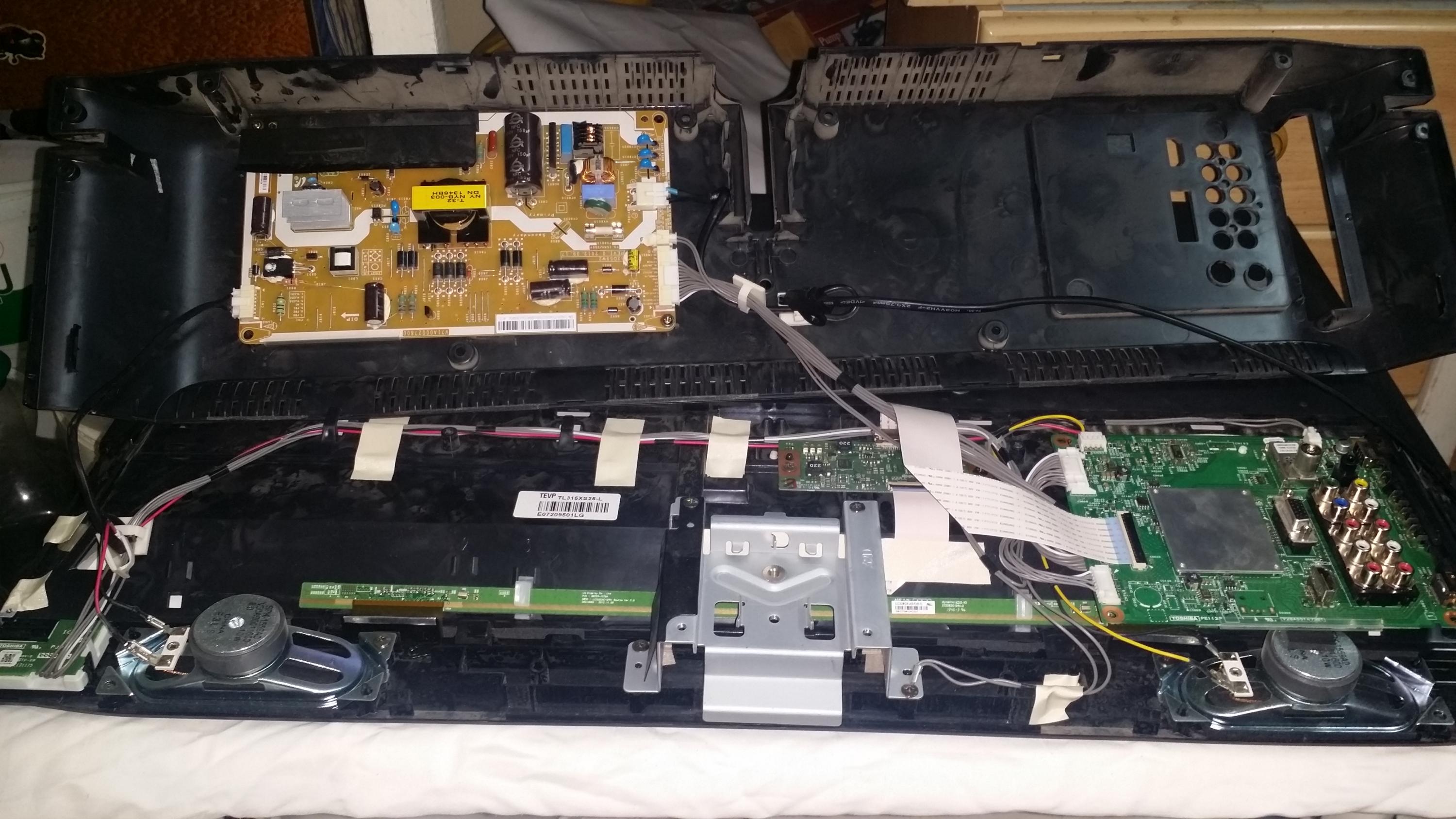

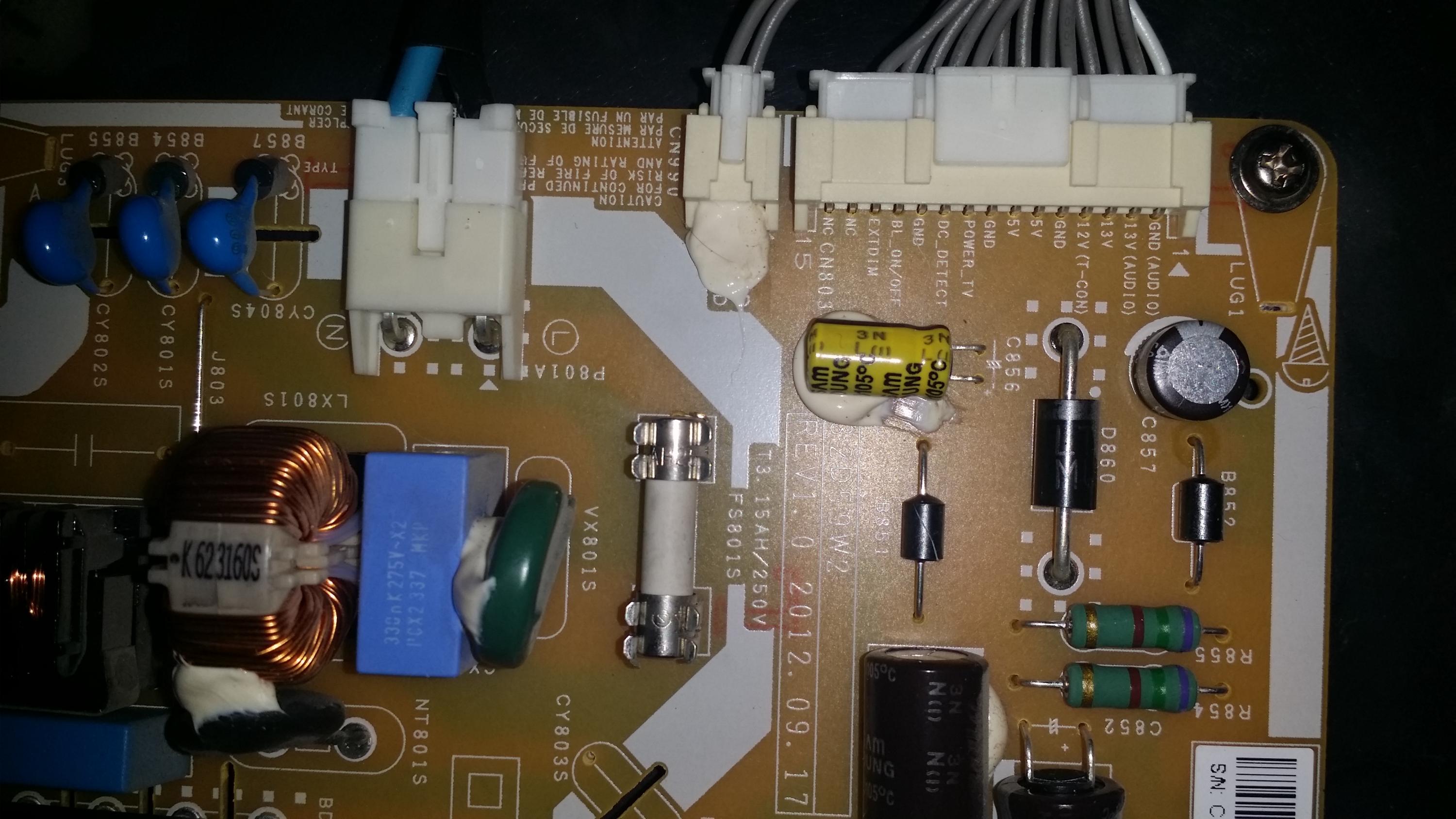

          This is now the clear copy of psu board ang also the symptoms.
          Thanks .

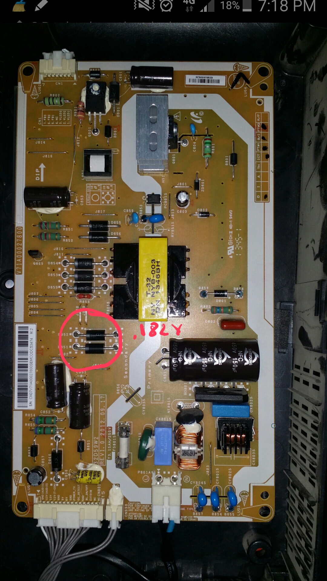

            I found 2 diode supplying 5v was already. 1v
            When I test in digital tester. But when you check
            The standby voltage still giving 5vdc
