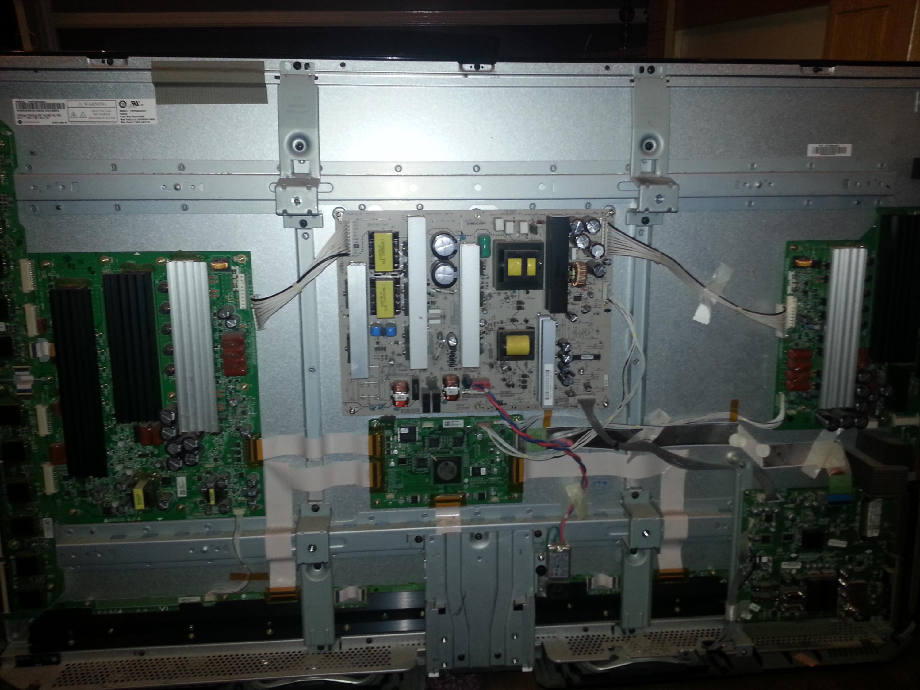

    Got an lg50ps3000. When i turn it on light goes blue as if ok to go. But no pic or sound. When i unplug ysus board get sound but no pic. If i plug that back in and unplug zsus board i get picture and sound (colour not right, but good pic) simple question. Y sus failure or z sus failure. Or both? Or something else lol.any help is much appreciated. Thanks
    Re: Lg 50ps3000
    Can you post some pictures please of the issue and the whole back side of the tv showing all the boards

      Re: Lg 50ps3000
      definitely Z sus failure,no doubt at all on that description.

            yes,there are no backlights-it's a plasma.with the zsus unplugged,you usually get a dark,red orientated picture...It will have a short circuit when connected causing the psu to trip!
              Re: Lg 50ps3000
              Luckily,z sus panels are rather cheap on ebay,so you should be up and running in no time.Beware of repair kits-they don't always cover everything that can fail,and need considerable skill and knowledge,quite often,to fit,if not experienced with this kind of thing..yes,let us know how it goes!

                  finally got board this morning. fitted and working and sold! .thank you very much stevie.
