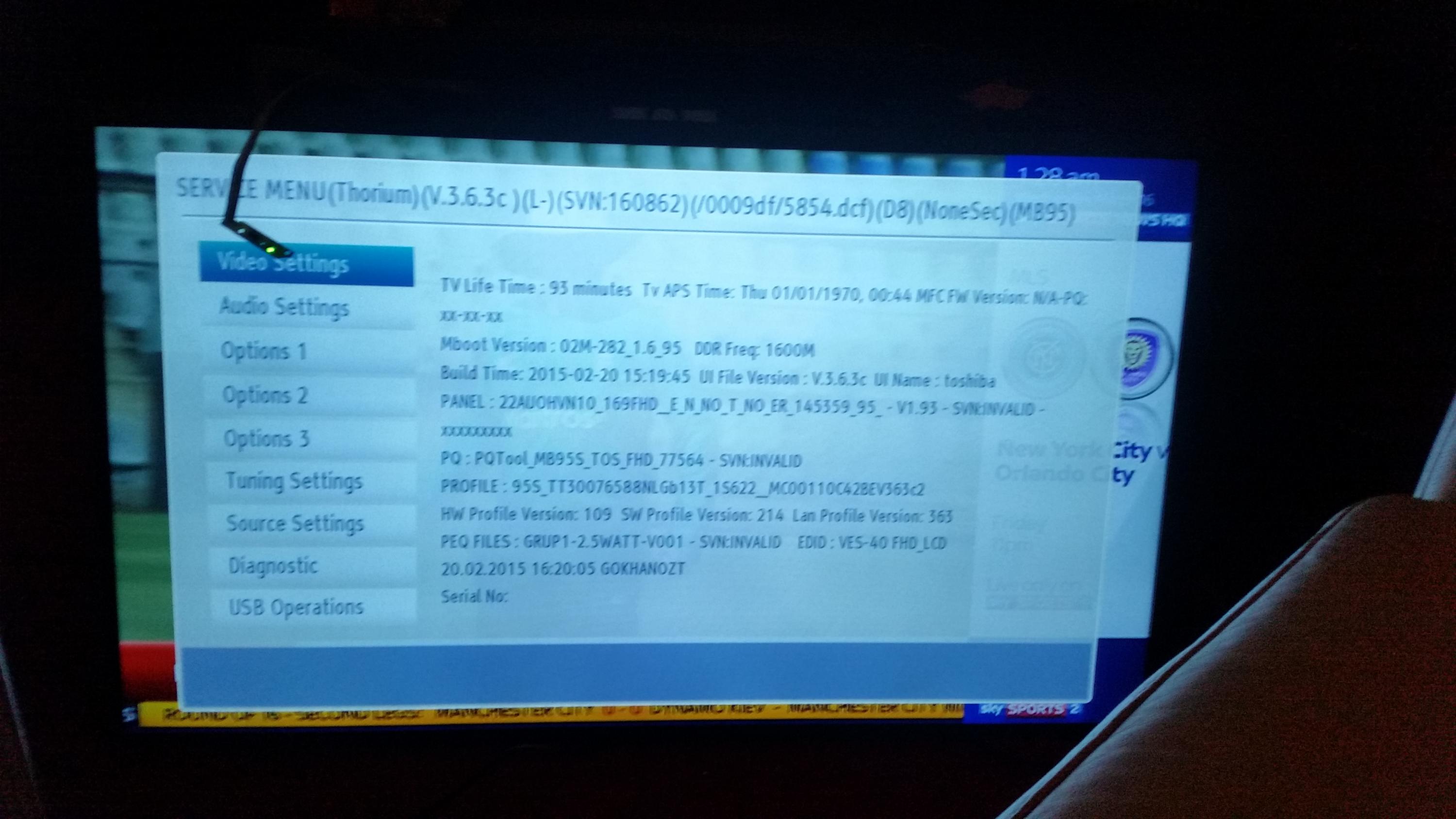

                            Re: toshiba 40L1333b 17MB95s-1
                            Managed to get into the service menu so took a photo for you all to have a look at and to me it looks like the firmware on it is from 22" screen and the tv is 40" any way i hope this helps
                                Its upside down because you have it set to the VES400 panel which uses a LSC400HM08 screen, your model of Tv uses a LTA400HM23 screen so you need to get the software for that screen not the one its set up for now.

                                  • russellhearn69
                                    • Mar 2016
                                    • 16
                                    • Northern Ireland
                                    Re: toshiba 40L1333b 17MB95s-1 (Solved)
                                    Ok I folks after being up all night i managed to find the proper software for the tv, i have attached the files that i found, hope this helps others who had the same problem.
