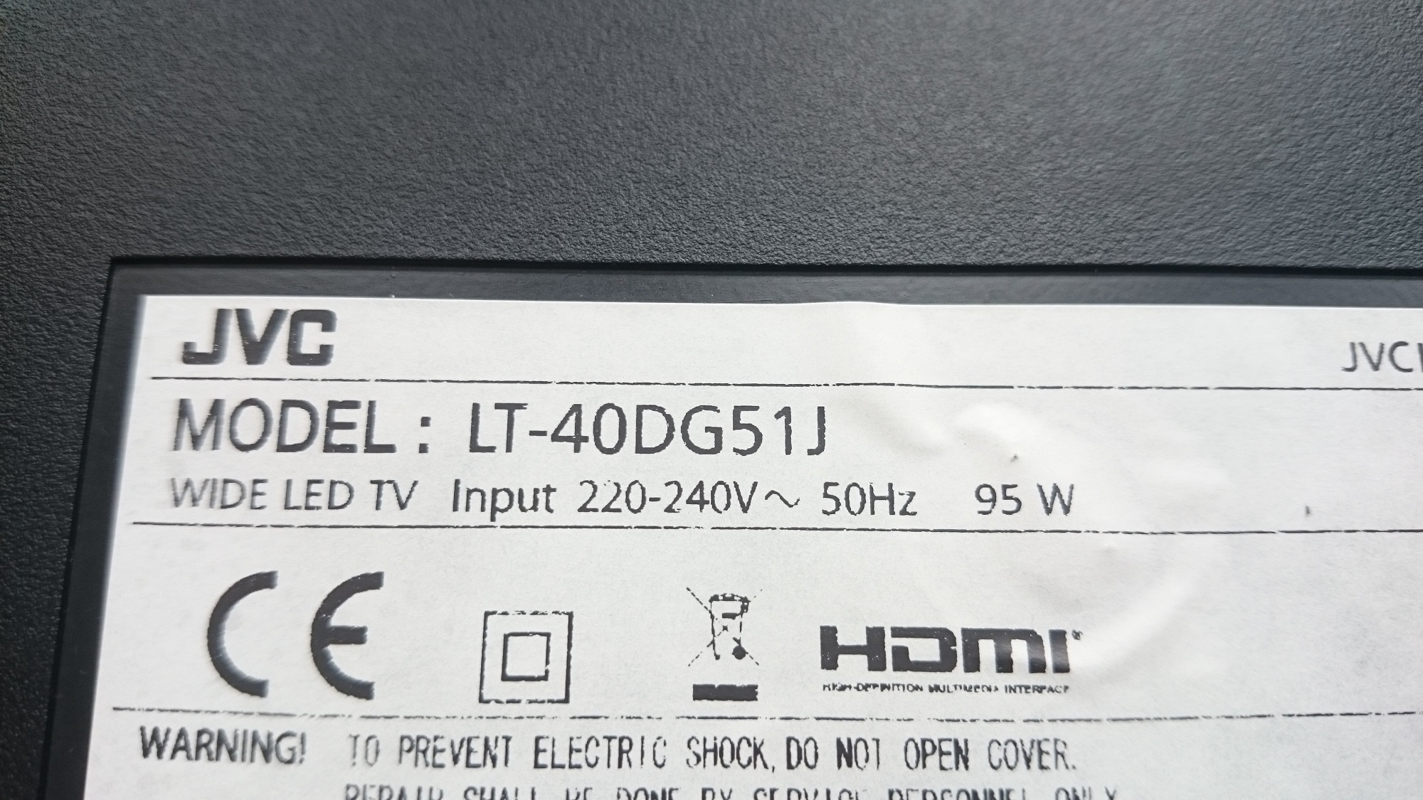

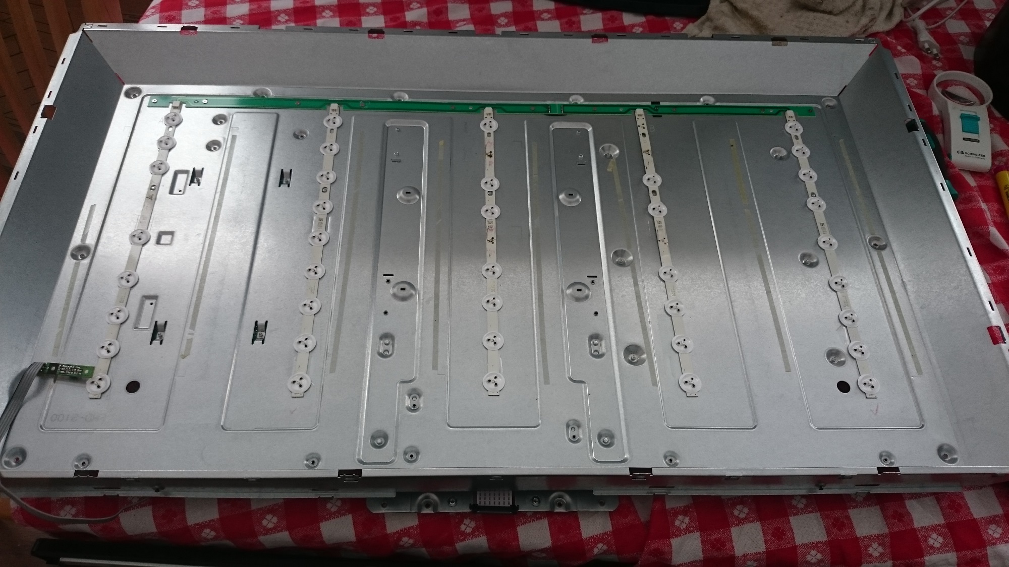

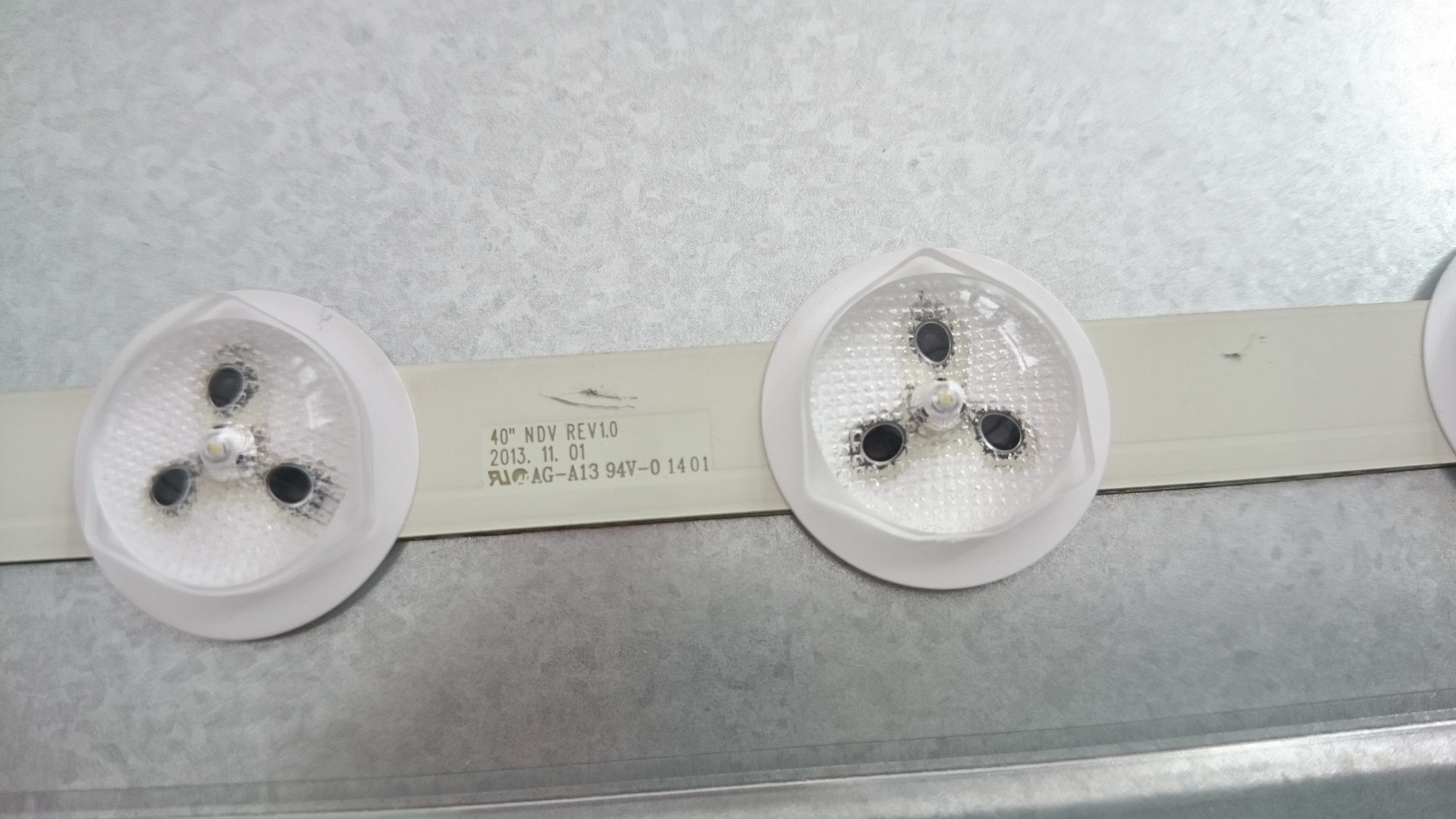

    Hello,I have this JVC led tv and the fault is with the LED'S not working .After I checked them found 5 pcs led was blown .

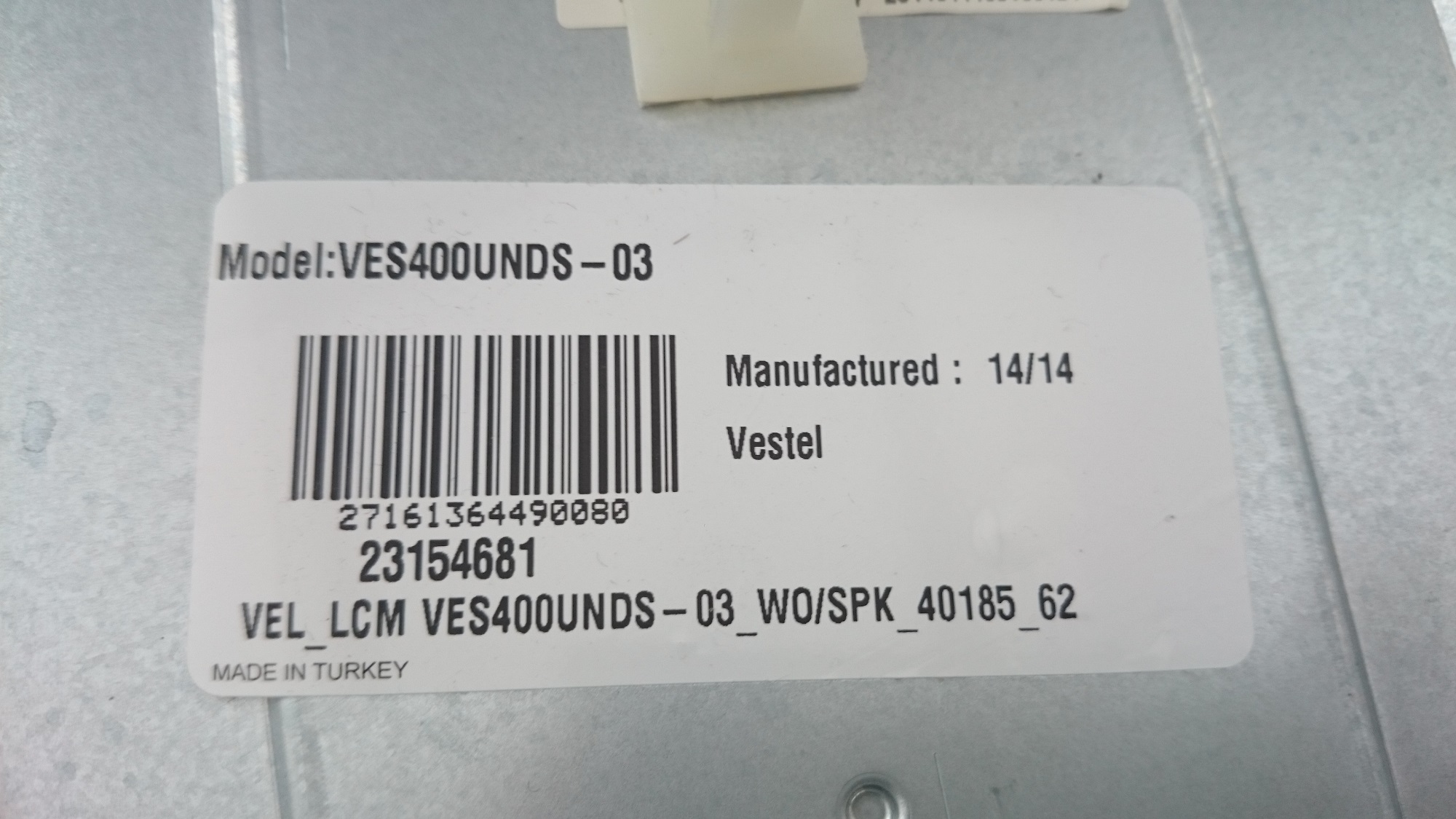

    The make of screen is VES400UNDS-03
    Anybody could tell me the voltage rating this led have and size?

    Hello they are 3.5v 0.5w rated. Here is a link to my video its easier than trying to find replacement lamps just to salvage the strips from smashed Tv's:
    https://www.badcaps.net/forum/showthread.php?t=52928

        You can chose just to replace them or you you can do the method shown in the vid and then keep the rest as spares incase if breaks down again. Also when its fixed make sure to out the backlight to low. Keep us updated.
