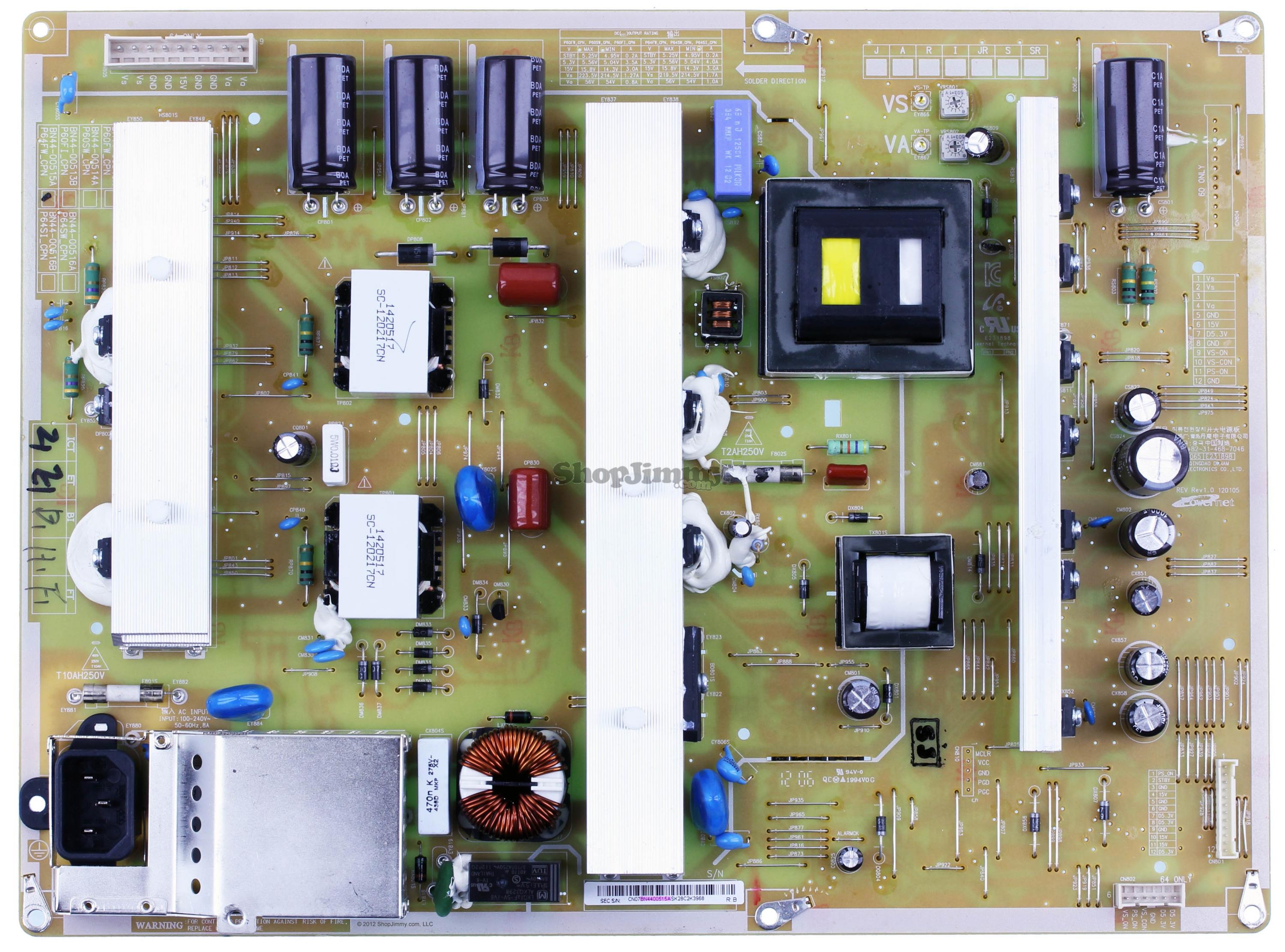

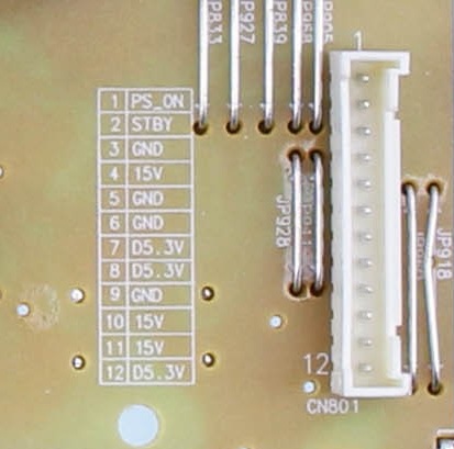

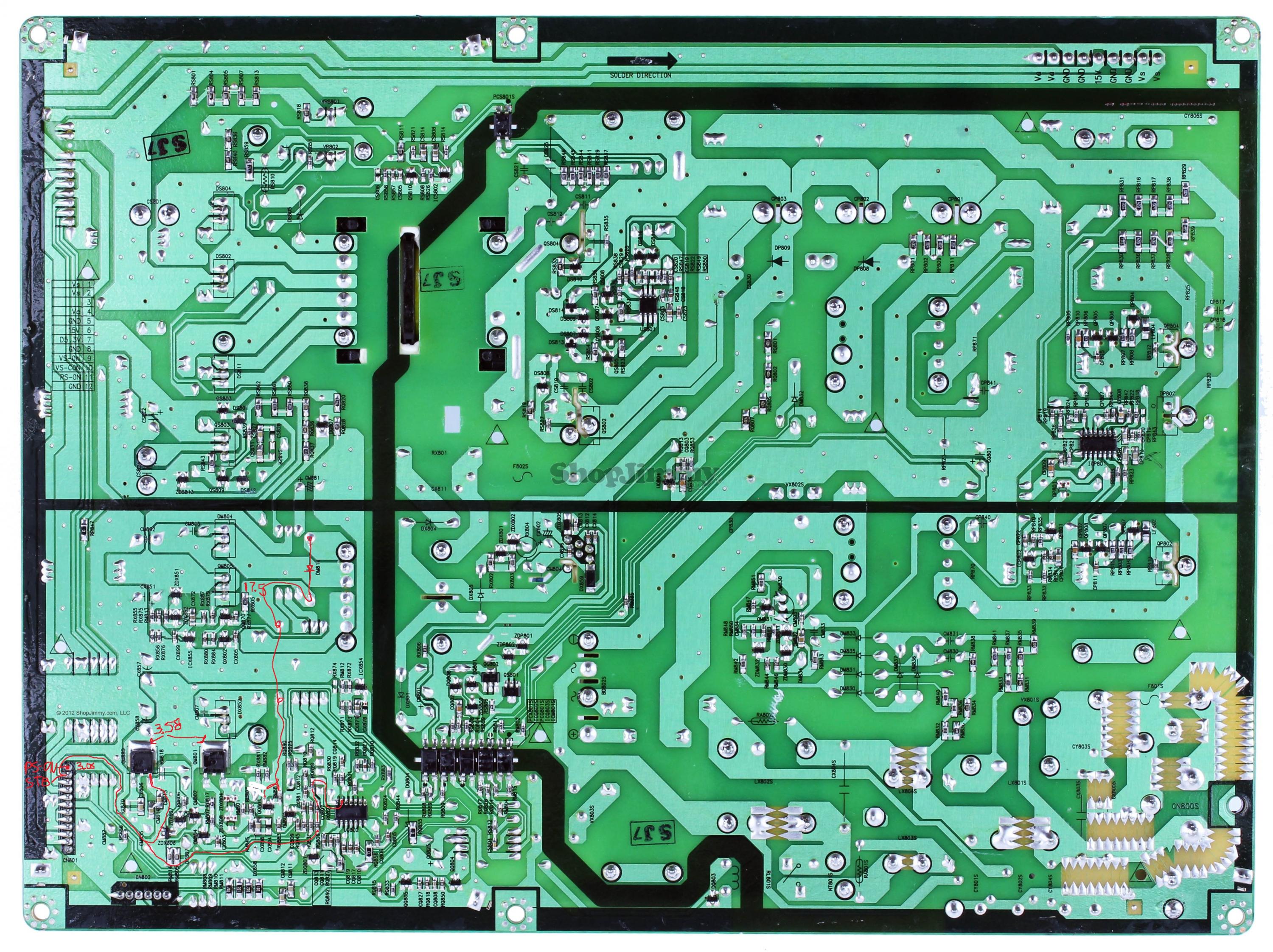

    TV is dead,no standby voltage,do however have 3.06volt on PS-ON.
    This one is kicking me and was hoping to get some help from the experts.
    I made a drawing on pic#2 of what I thought was relevant.
    Power supply is a BN44-00515A.
    I did buy this kit and have replaced the majority of it:
    http://www.shopjimmy.com/samsung-bn4...repair-kit.htm

      Measured again,
      pin#1=PS-ON=3.06volt
      pin#2=STBY=0.0 volt
      I measured resistance between the STBY pin and GND=135K ohlm.
      I too thought ps-on came from the stby voltage,but this thing is proving me I'm wrong,lol

        What do the pins that go to the connector that leads to the signal board--what is each of them called ?ONE of them HAS to be supplying voltage to it---for the signal board to THEN give a PS on voltage to the PWB.
        • martino
          Not so "senior"
          • Aug 2013
          • 997
          • canada
          Re: samsung PN64E550 no standby voltage
          see pic
          pin#1= 3.06volt,the rest is all zero.

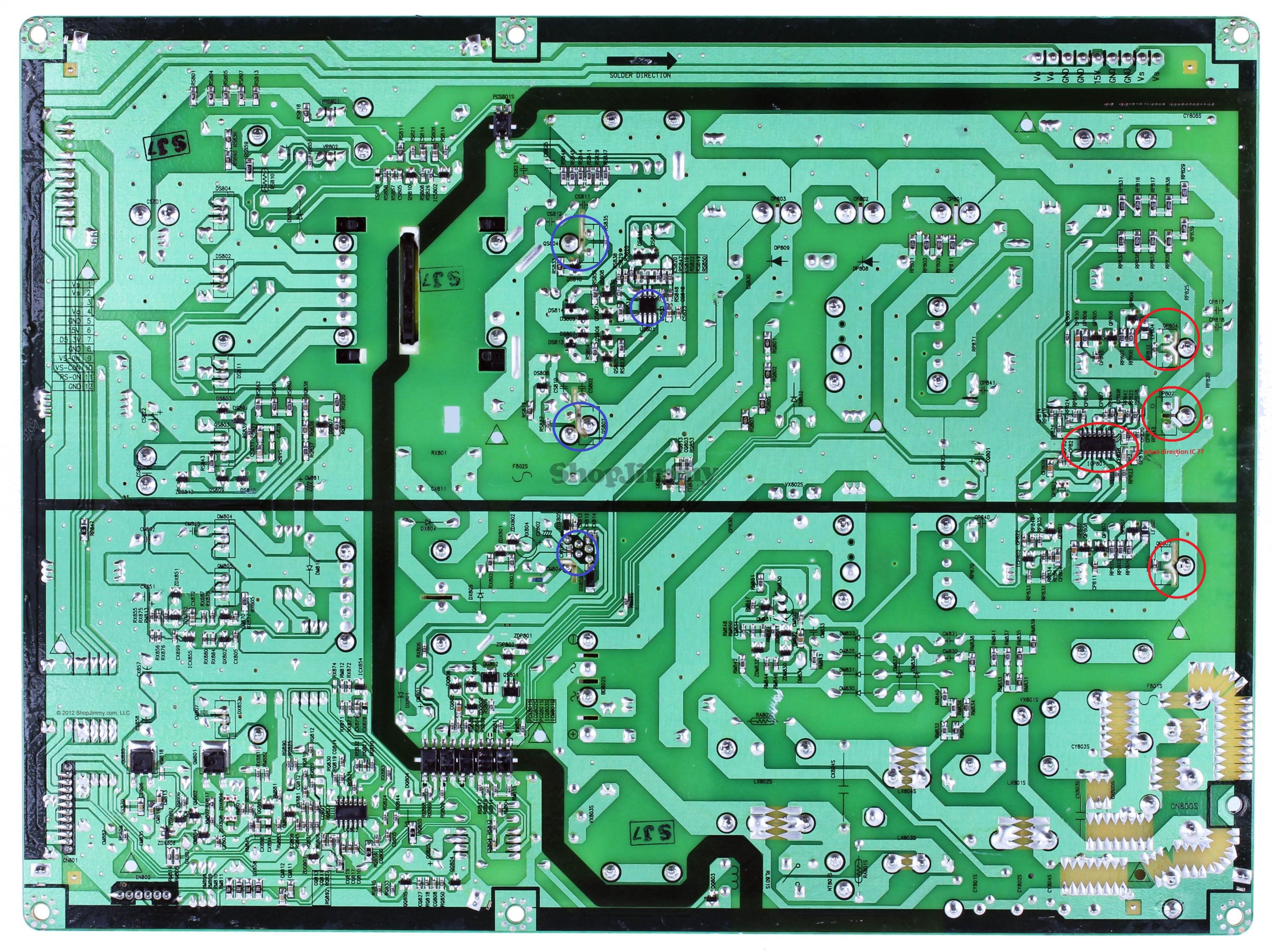

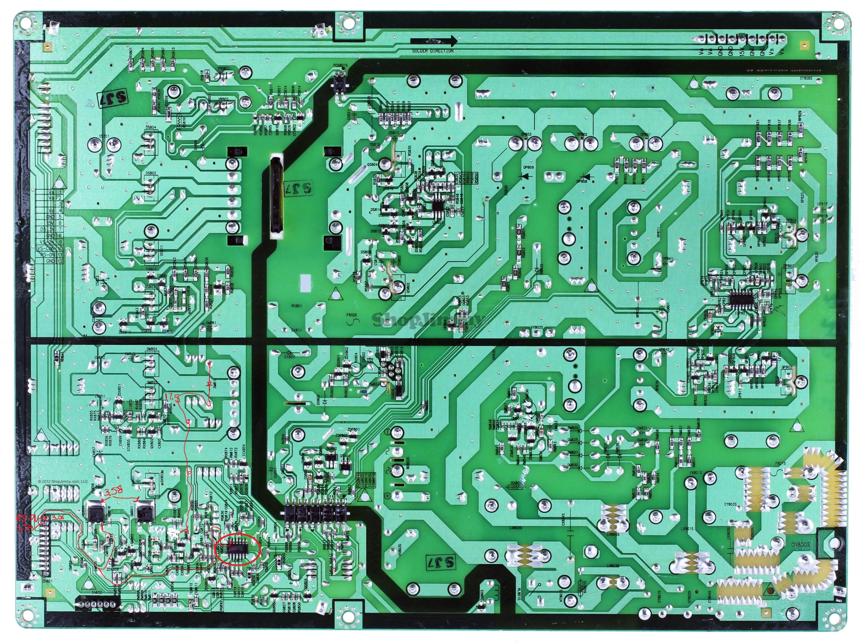

            After reading MANY posts here,I found a guy that had the same issue.
            He,just like I did,had replaced the IC UC802(circled in pic) and had no STBY and a voltage on PS-ON.
            He put the old chip back on and his STBY returned.
            Going to do that right now and report back if STBY returns.
            If it does I will have to let shopjimmy know that that chip is defective.

                Update:soldered the old chip back in,could not read the p/n,sry,and sure enough the STBY is back,5.3v.
                PS-ON is now at 4.3v.
                Soldering a 470 ohm resistor from ps-on to gnd sadly does NOT turn on the powersupply Unless I need to activate VS-ON as well to get the 15v etc?
                Voltage on main caps remains 164v and no 15volt etc.
                Took a pic of board with chip removed for future tracing for somebody.

                    So,onto the remainders of the parts in the SJ kit.
                    In pic I circled the parts I did replace before already in blue.
                    Now working on the parts in red circle,but the IC on board doesnt show what direction it is in.The new IC has a grey stripe.

                        I measured around,found that most components in that kit to be blown(shorted) on mine and opted to get the kit.
                        It sucks I cant read the p/n on those IC's,for directional position and also to find spec's on them..
                        The components in red circle,are they responsible to turn psu on full?
                        PS-ON via optic coupler to hot side? Or is there more suspects on the cold side?

                          From what I can tell...the red circled parts are in the BOOST CONVERTER section. This is a ckt. to raise the raw B+ to nearly 400V dc...in the "run" mode...ONLY. it is turned on by an optocoupler from the COLD side....again ONLY...when the Ps is in the run mode.
                          Can you tell where the PS-on line goes to on the PS? I wish I had a schematic of this PS to help you with. I recently had a PS that had a bad driver chip on the hot side...not really identifiable, numbers rubbed off. Thankfully though..I found a complete PS cheap on the 'bay...

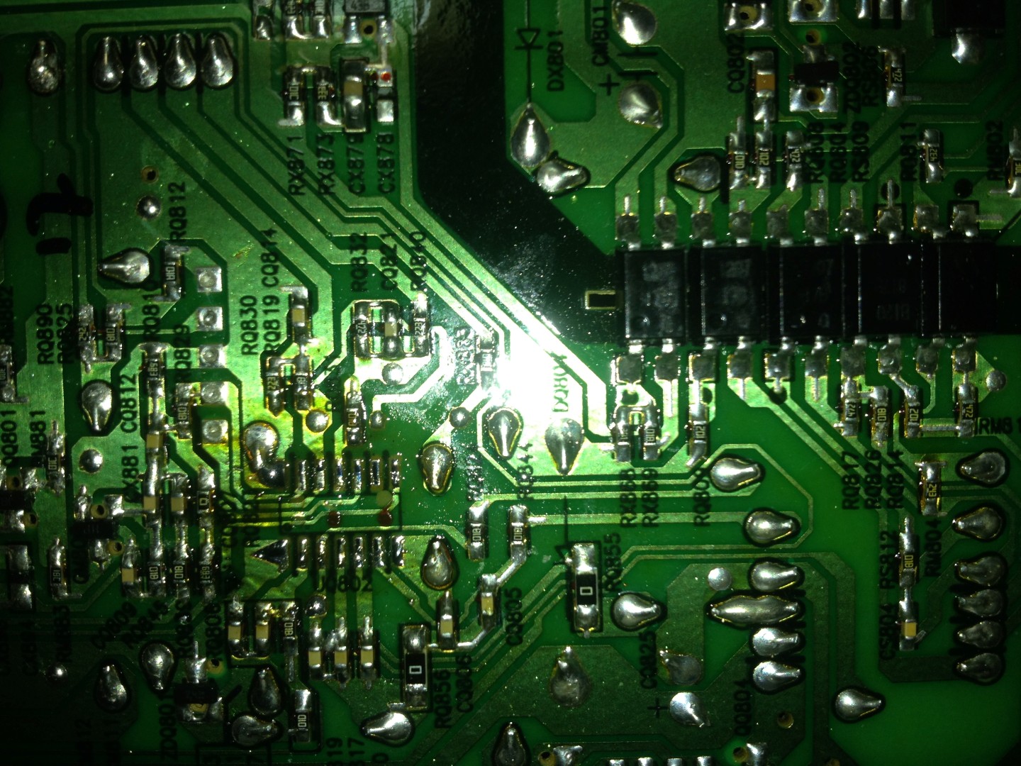

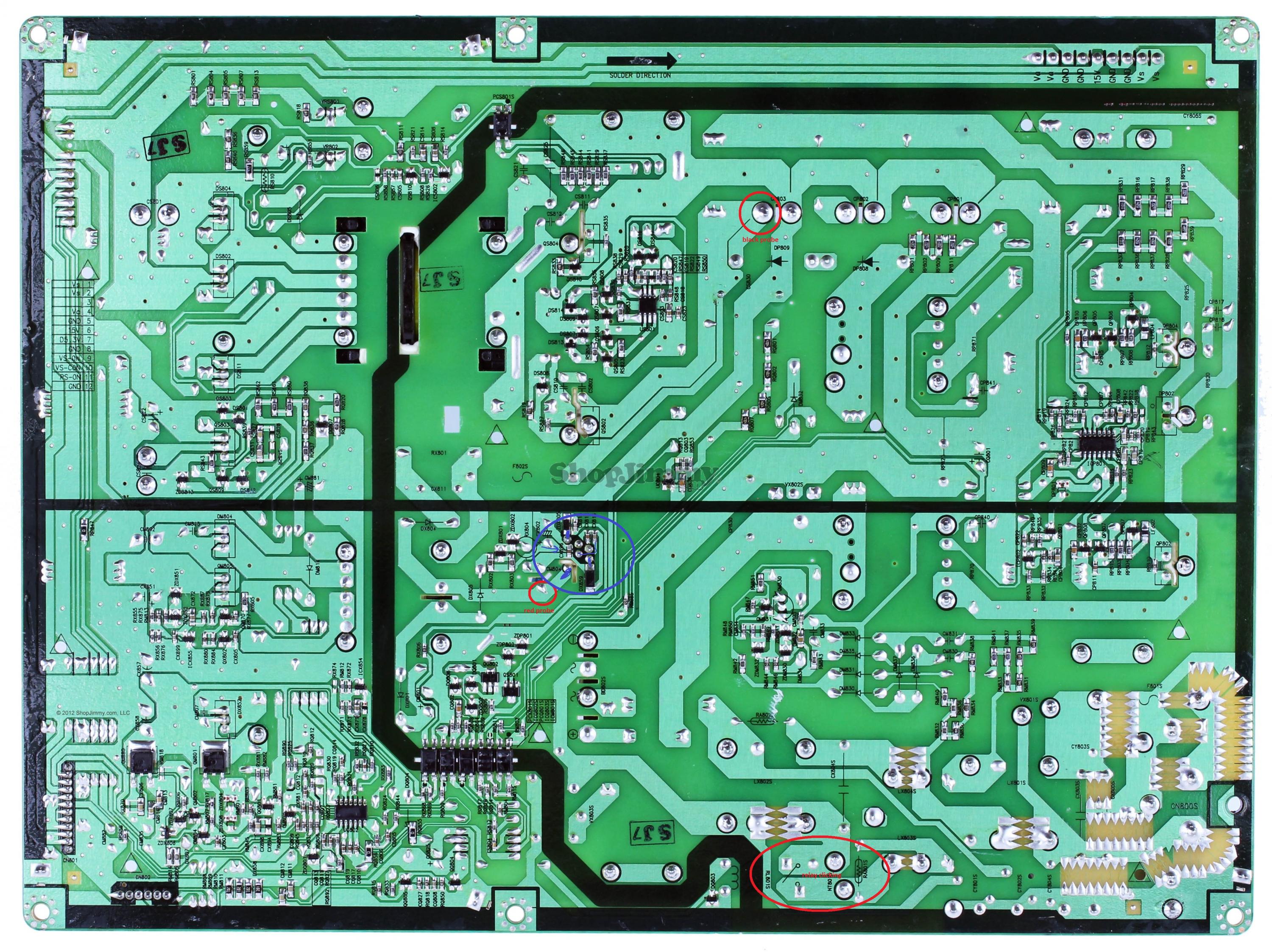

                            New(not so good) developement
                            I marked pic with problem area etc.
                            psu rigged to be forced on.maincaps 164volts. Measured around in hot side,from negative leg of main caps.
                            AS SOON as I touch the spot I marked as "red probe" with my probe,while black being neg leg maincap,the relay starts clicking on/off in 0.5 sec intervals.(and keeps doing that even with probe removed)It's not pressure sensitive,it's the fact probe touches it.
                            Voltage on main caps spike to about 400 volts,then drop off to about 210 before it spikes back to 400 in about 15 seconds.
                            Ok,still in mind that the one IC was defective out of the box,I decided to desolder the voltage regulator to measure out of circuit(was getting low ohm readings)................when I buggered it all up.......sigh.......
                            I damaged the traced in the area I circled blue and now cant trace out what connects to what.Again,NEVER do solder work at 3am,it will bite ya.
                            Anyone happen to be working on one of these that can trace it out for me? I been searching for hrs and cant find a schematic for it.
                            Even bought the service manual for it for $25,but they don't do schematic drawings and board prints anymore. grrrr...
