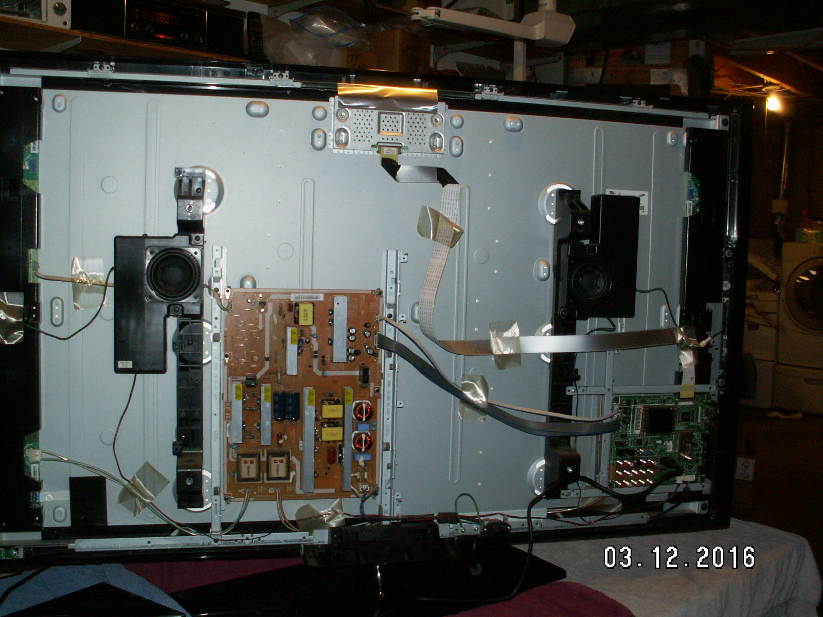

                      Replaced several caps on the power supply board, ran the set for several hours without problems. I replaced the back and the set won't work (no backlights). I got momentary picture and audio that then goes to black. The going to black initially took several seconds and at one point I hit a "Picture Reset" option in the menu--thereafter I get a click and start-up tone but no picture or audio.
                      Look at the power supply to see if I had left a bad solder etc., but there's nothing obvious.

                                    Did a replacement service for the main board. This to correct the typical issue, but apparently not mine. All I get is clicking when trying to turn the set on. Screen remains black, no back light.
                                      Re: Samsung LN52A580P6F, 4 blinks Question
                                      Still problematic. I've bought & installed replacement boards on e-Bay (both guaranteed working) for both power supply and main board. Still get a black screen; this after it worked for several hours after I got it and before replacement boards. Any suggestions about a next step? T-Con board or are the inverters problematic? Thanks
