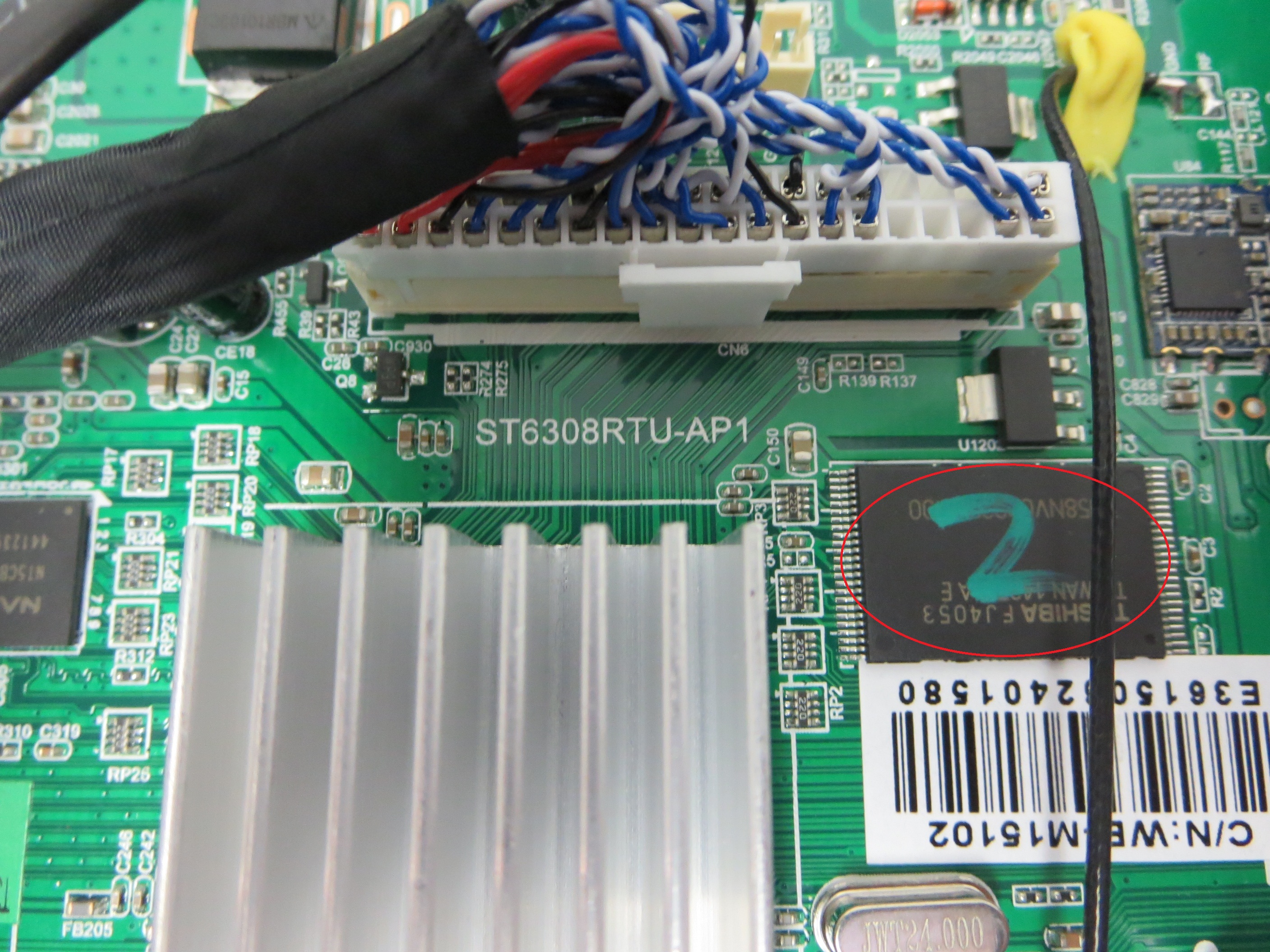

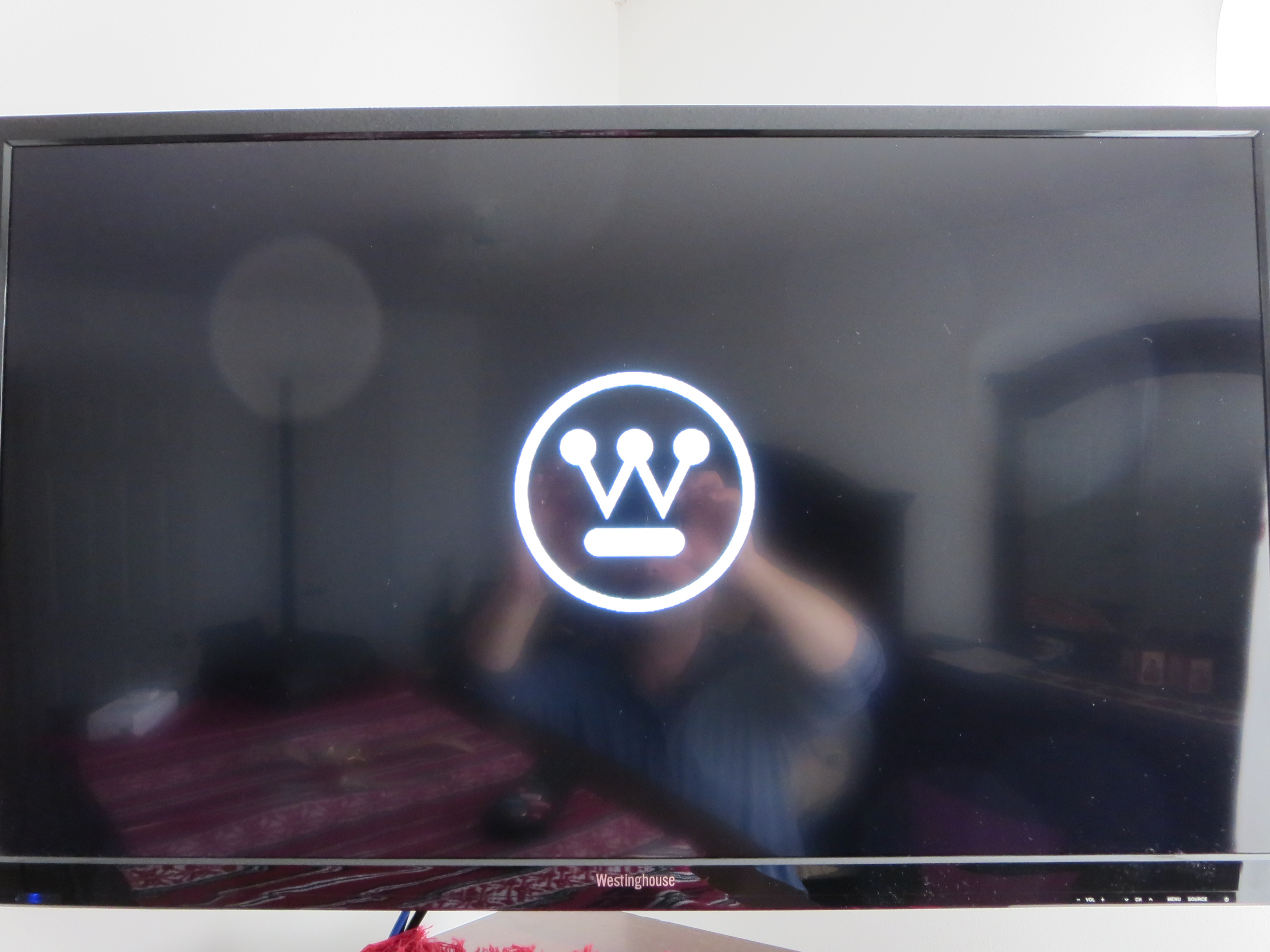

    Hi there,
    This smart tv, Westinghouse 32" power up and stuck with "W" logo. The tv buttons and remote will not respond... for turning off it has to be unplug.
    So unplug it for 24 hrs. nothing same result.
    Google this type of defect just find out similar problem with Vizio and LG tvs...basically the EEPROM chip is corrupt or the main processor require reflow for a better connection with the mainboard. OK remove the back cover and tried to find out any bad components ...nothing ...everything looks fine... info from the main board, close to the processor there is "ST6308RTU-AP1" printed. This generic part number seems to be used in different tv as Element and Seiki... Regardless, Westinghouse website is useless for firmware upgrades or technical support. Any suggestions?

      Thanks for your reply...I tried to reset the tv by unplug the mains and while pressing power button plug it back...no change!
      I did check all the connector from mainboard...nothing loose!
      In order to do a firmare upgrade, the tv has to boot and pass the W logo screen, go to the meniu and select "upgrade firmware...

          If you suspect the eeprom, try heating it up with a hairdryer to see if it makes any difference.
          • suiramix
            • Mar 2011
            • 131
            Re: Westinghouse LED TV 32 inch WD32FC2240
            Hi Jetadm,
            Usually the EEPROM chip is 8 pin (small) IC, but I could not find any...so I guess the Toshiba TH58NVG2S3 (CMOS NAND EEPROM) TSOP-48 is the one I have to reflow (see attached photo). Thanks!
