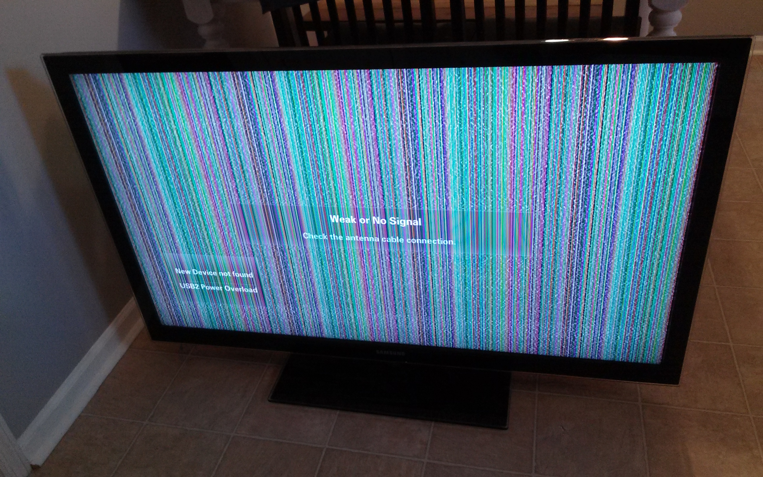

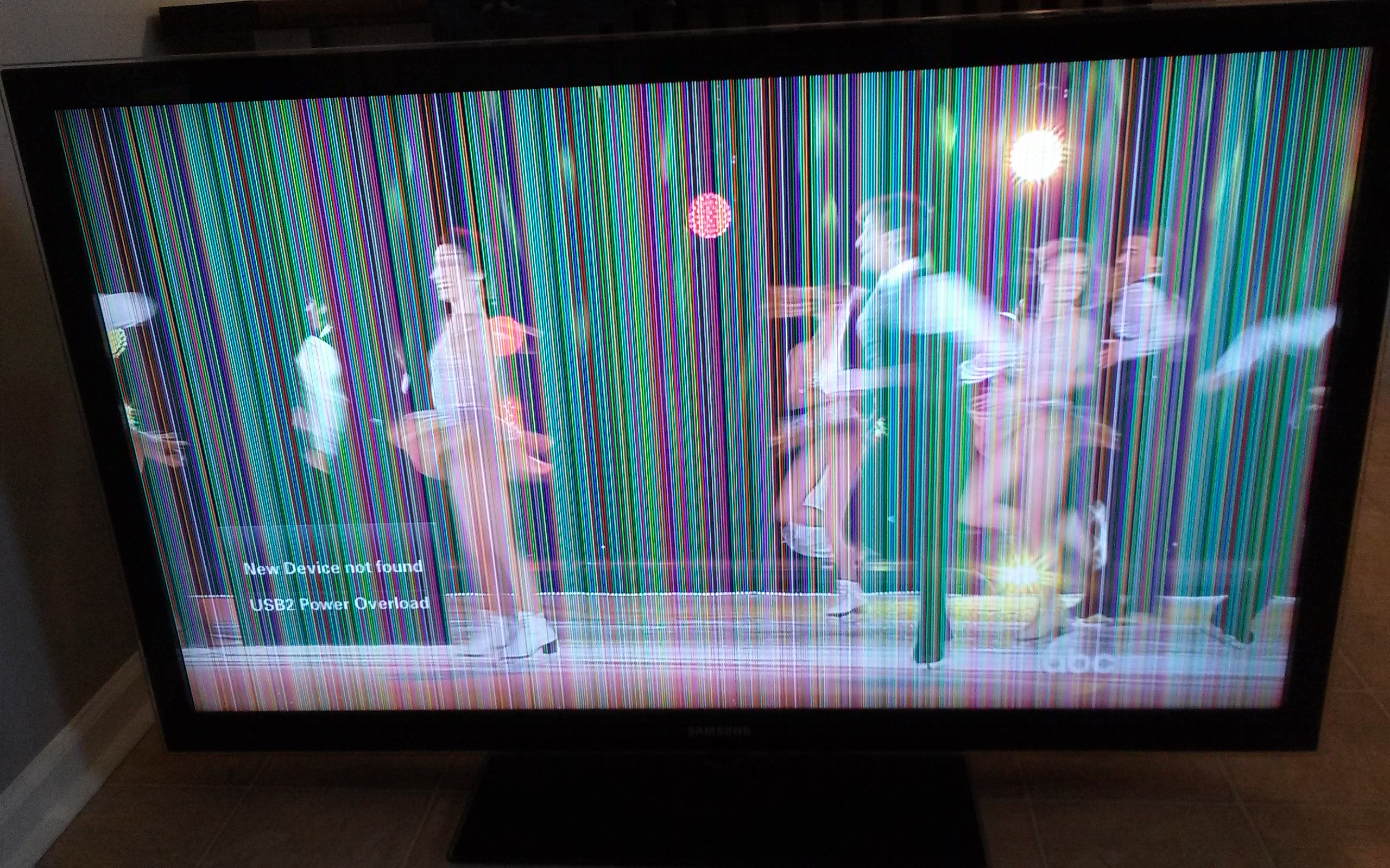

Samsung ln55c630 rainbow lines vertically on whole screen
  • snake91876
    • Feb 2013
    • 236
    What would cause this , I'm thinking tcon but not sure I notice usb error also in box on bottom left. Sound works fine. And picture is present. Would firware update help when I go in current firmware boxes are blank.

    Re: Samsung ln55c630 rainbow lines vertically on whole screen
    Mainboard fault
      check under light all USB PORTS IF THERE ONE BROKEN AND MAKE SHORT CONTACT
        Flexed and tapped main board at lvds connector and screen clears up to a perfect picture any ideas to get it to stay, need u.s. fix also
          LVDS connector had nothing to do with usb error, it may when you taped the eeprom lost connection got tight.
            It still is not fixed but when I put pressure on lives cable at main board it fixes. How can I make lives connection tighter its the flip close connection. Seems like I seen a scotch tape trick before.will firmware update fix usb problem or should I try to get another mainboard
