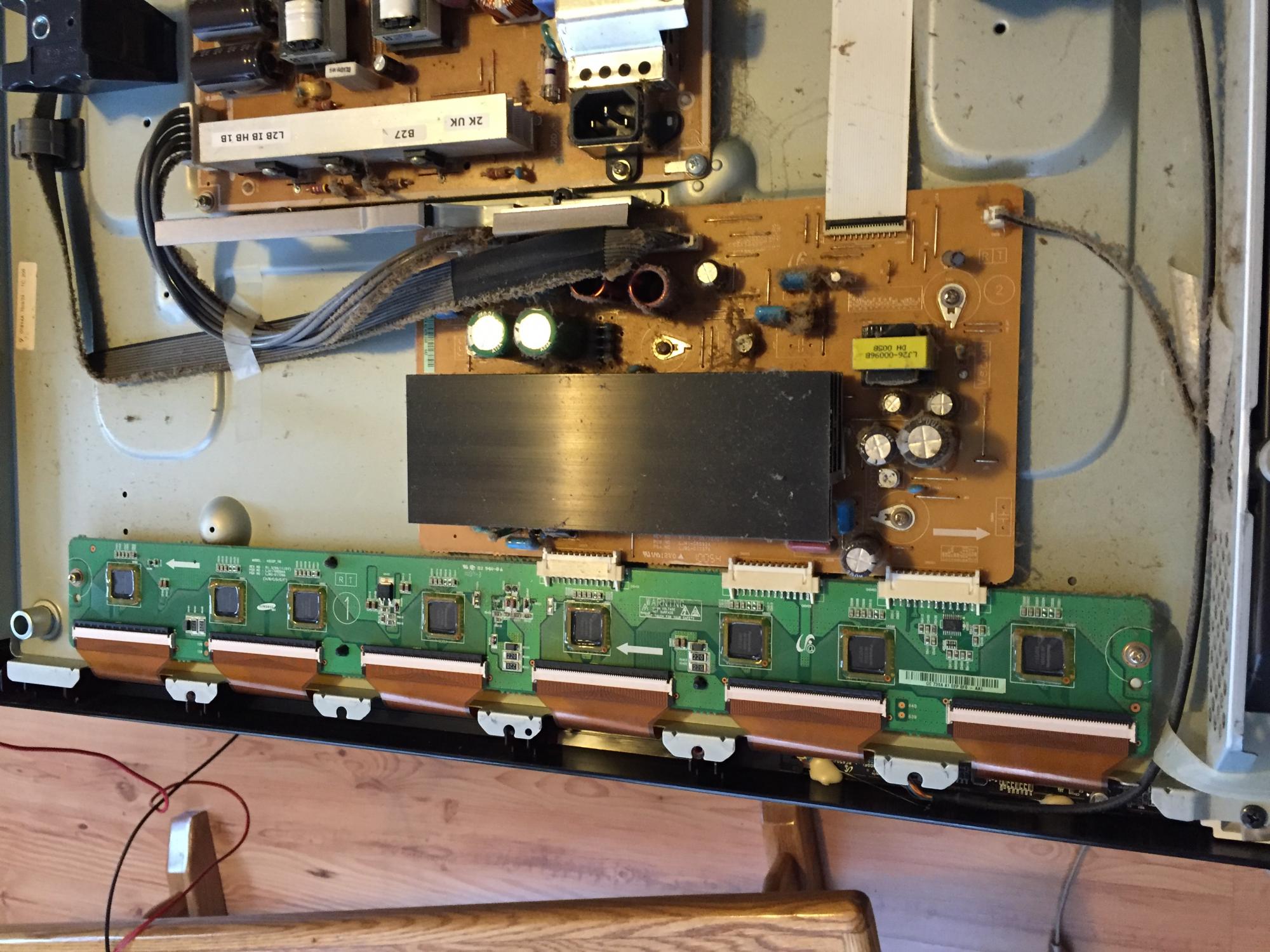

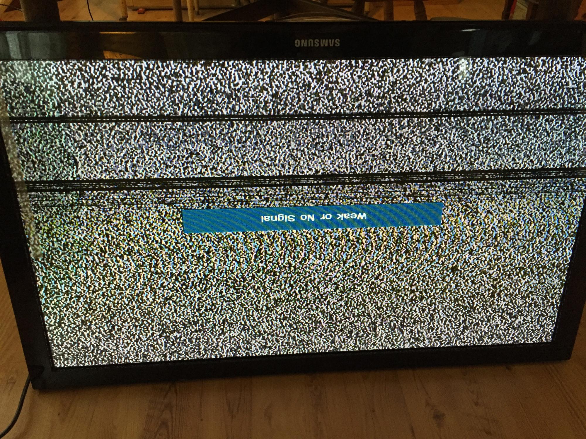

Samsung PN42C450B1D, horizontal black lines, buffer test good
  • johnboy1313
    • Nov 2012
    • 1959
    I'm guessing bad panel. I followed Tom's YouTube video on testing the buffer (LJ92-01739A) and found no shorts.

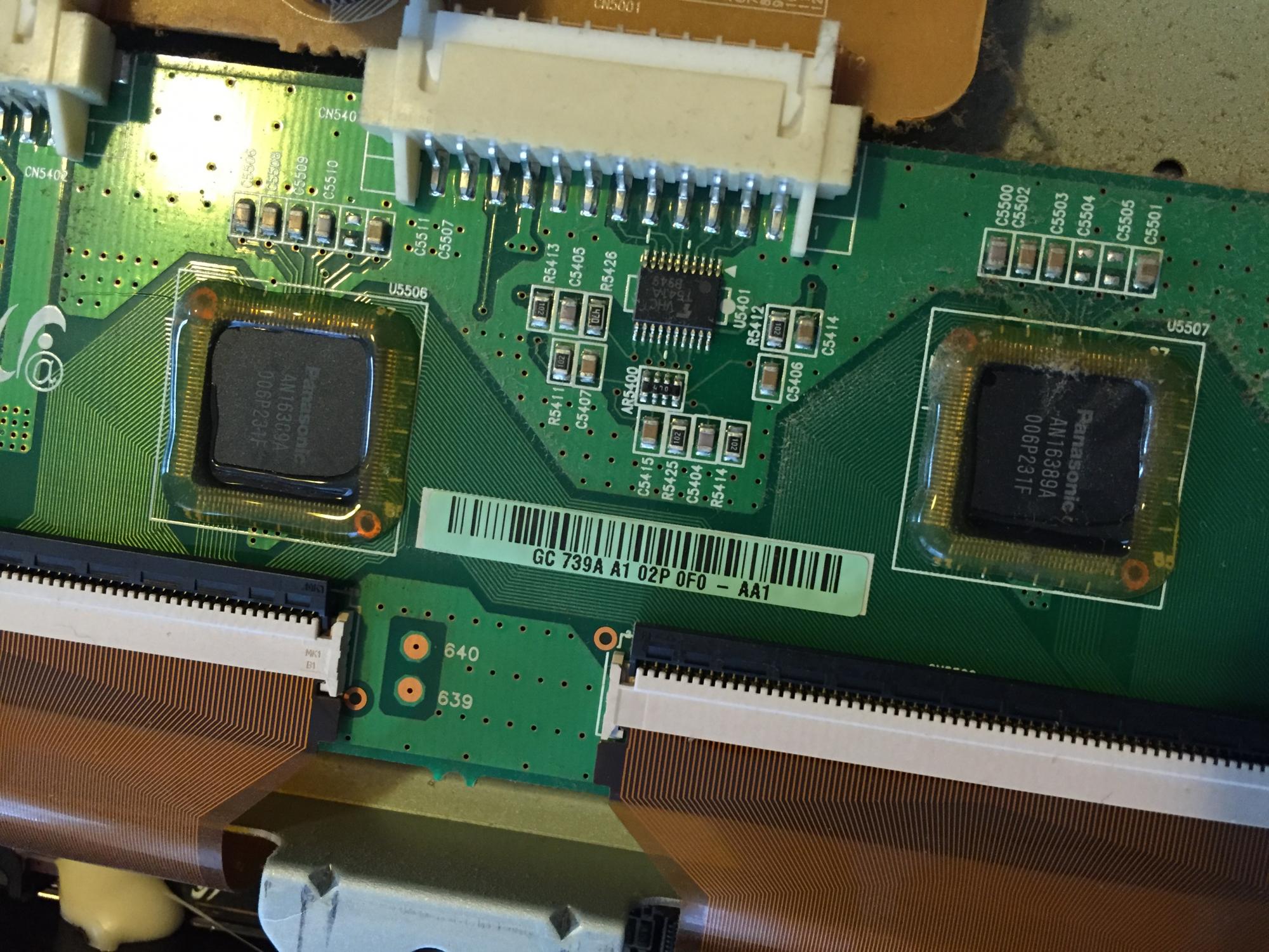

    Re: Samsung PN42C450B1D, horizontal black lines, buffer test good
    Buffer board shows no blown ICs.
      I can only post one picture at a time from my phone.
        Bad panel not fixable sorry, common on them Tv's The Y electrodes in the panel break down and crack over time and when they do it means the row cant be scanned any more so its completely black.
          Just as I suspected. Thanks man.
