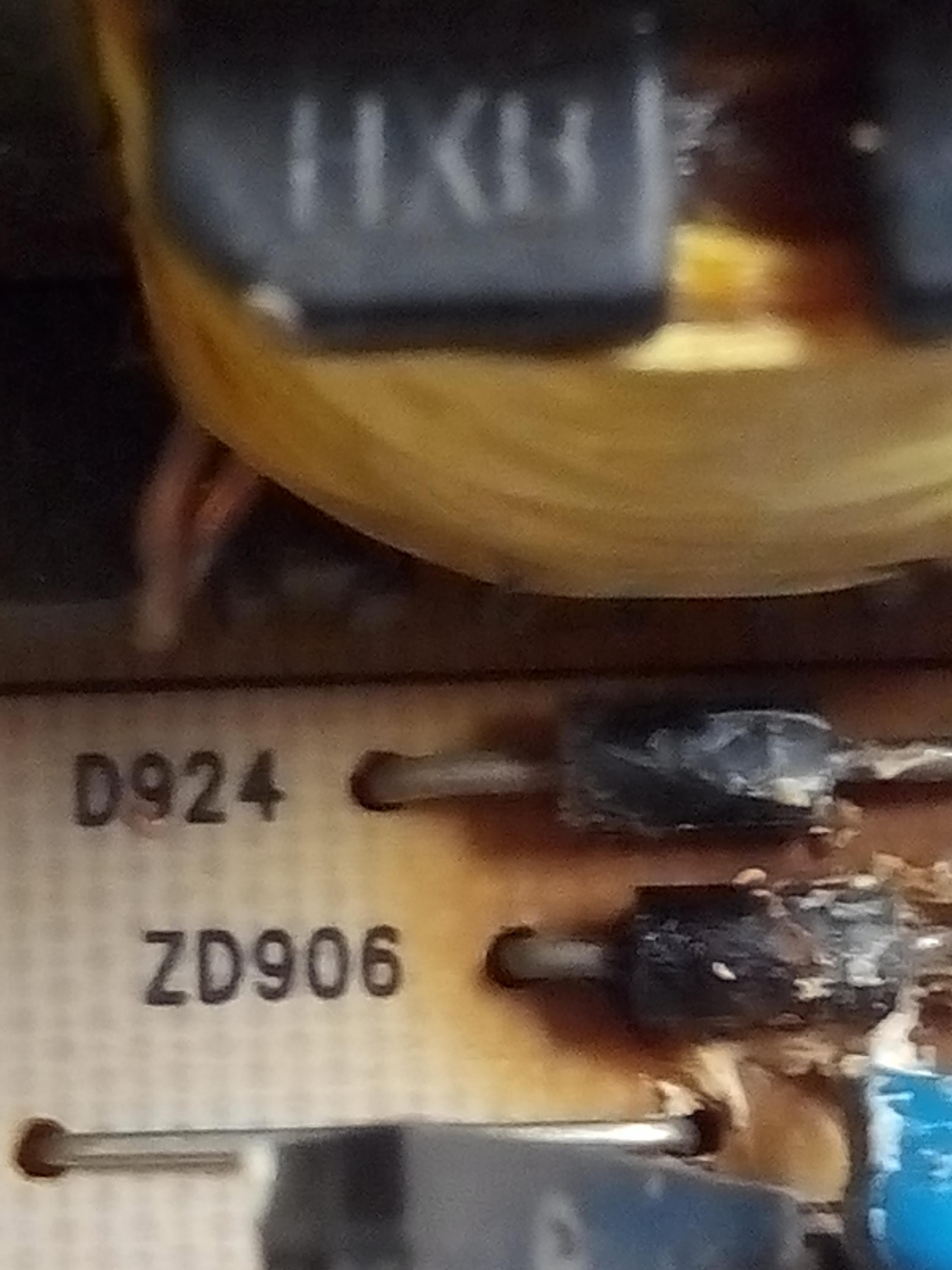

    The transformer on the power supply board of my magnavox 37mf337B/37 is making a chirping sound. There are 4 bad capacitors and two charred diodes under the transformer. the numbers on the board beside the two bad diodes are ZD906 and D906. I don't know the part name or number for those two diodes to order replacements. Any help is appreciated.

    hard to say without the exact PSU part number. However SJ is having repair kits for these available.
      Re: magnavox 37mf337B/37 wont power on
      How about the Pictures of the whole board?
      Post 11:
      https://www.badcaps.net/forum/showth...ighlight=ZD906
      You should remove the diode and clean the off the glue so you can read the P/N on the diodes.
