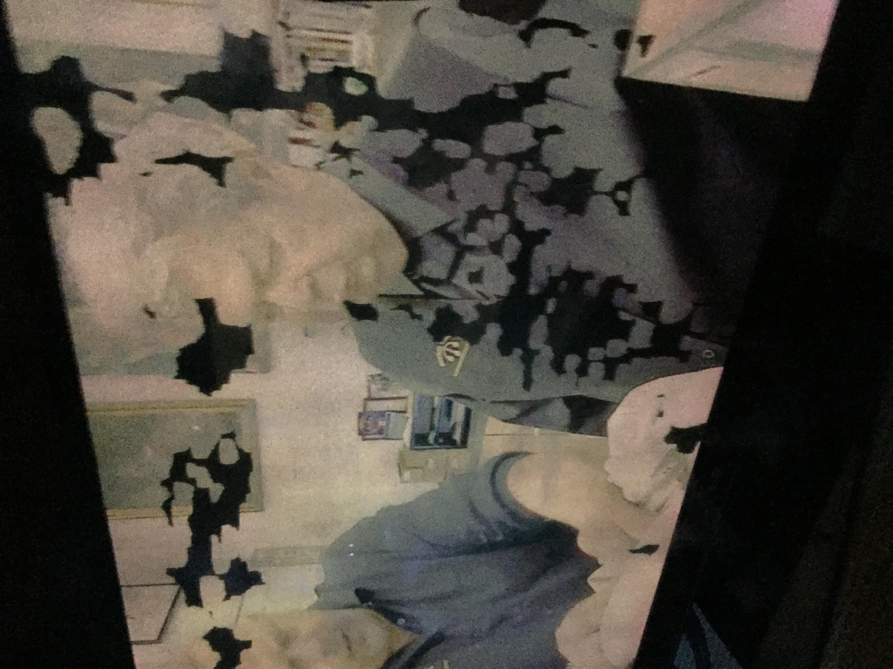

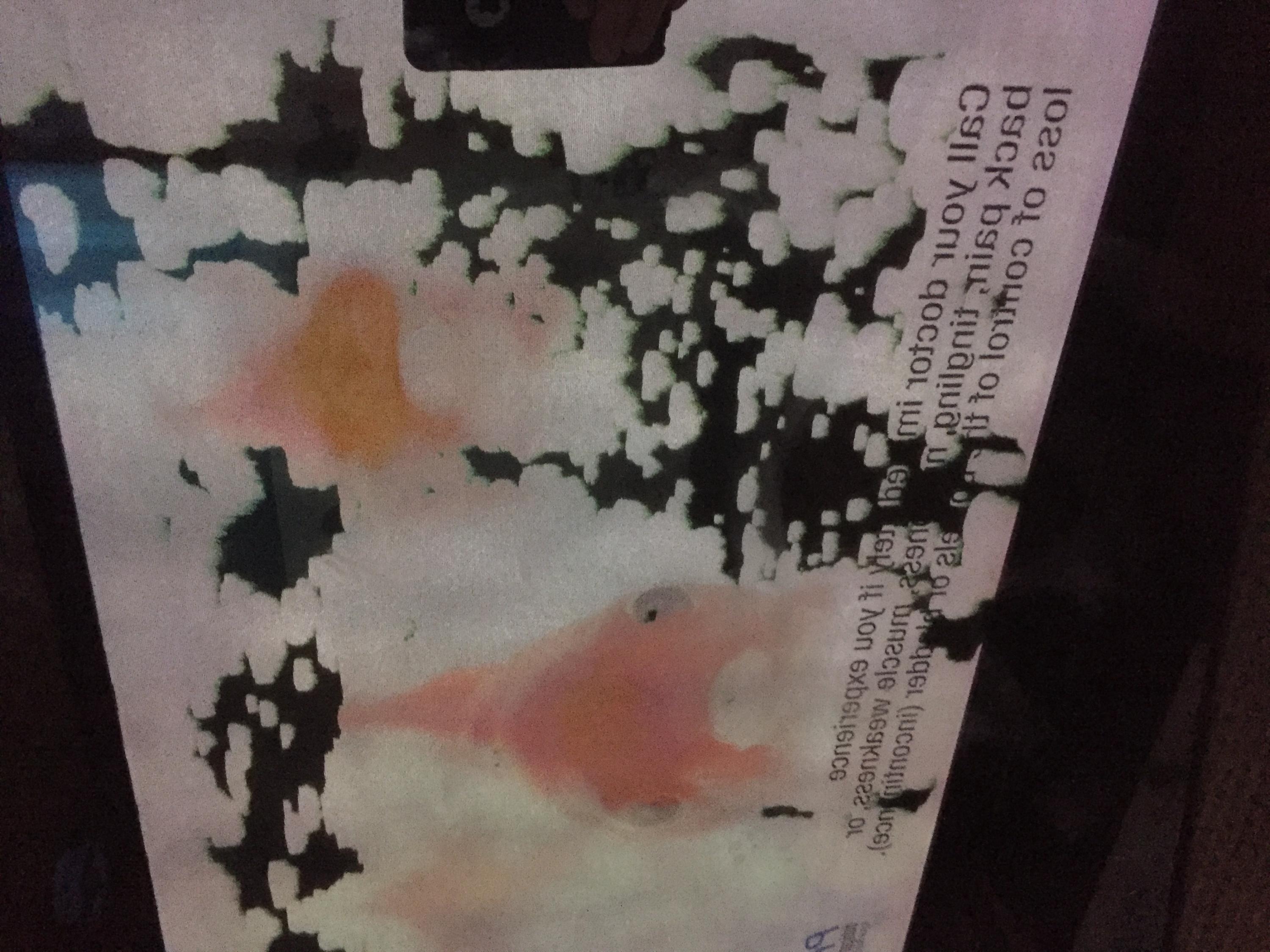

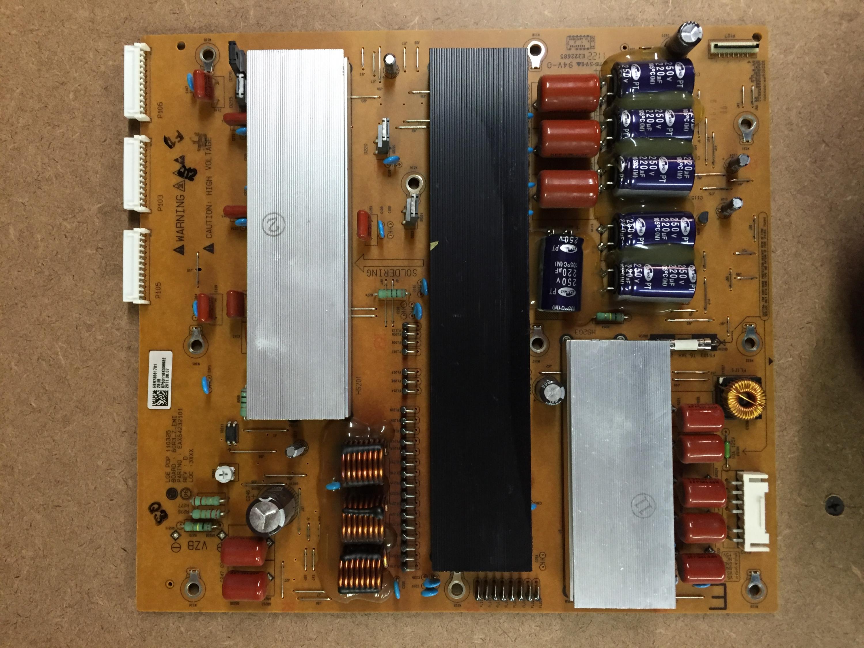

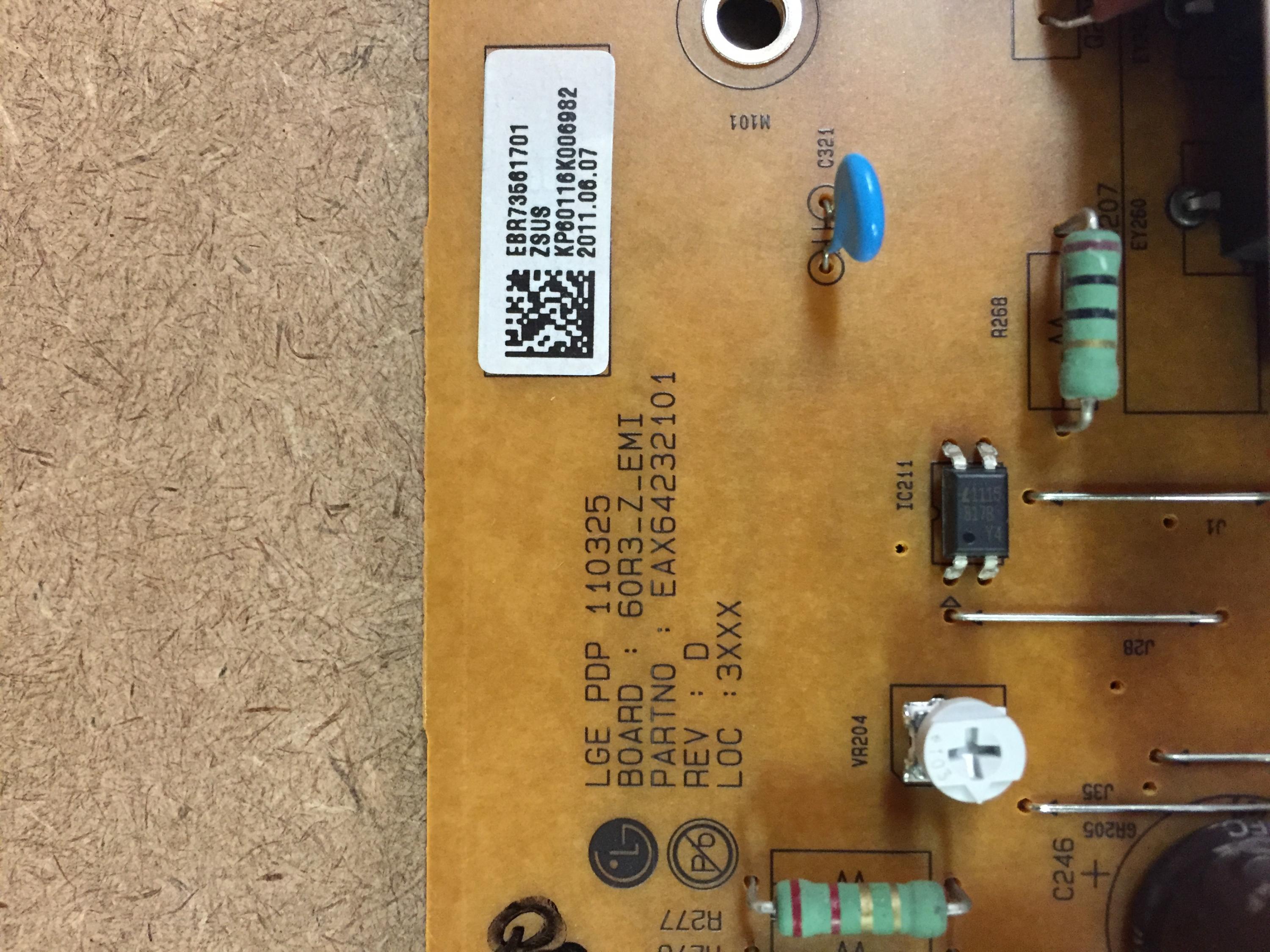

I recently picked up a LG 60" plasma. It had a blown power fuse on the ZSUS or E board. After I replace the fuse I decided to check the circuit to try to see why the fuse blew. I found a ground on the VS pins. Both VS pins are grounded as is both sides of the fuse. I can't seem to find the component thats causing the circuit to be grounded. Also after disconnecting the 6 lead power cable coming over from the PS board. I turn it on and saw these crazy looking black splotches. Have to admit I've never seen this before. I am thinking about buying the repair kit that Shop Jimmy sells for this board but don't want to waste the money if the panel may be bad. Any input is appreciated.
