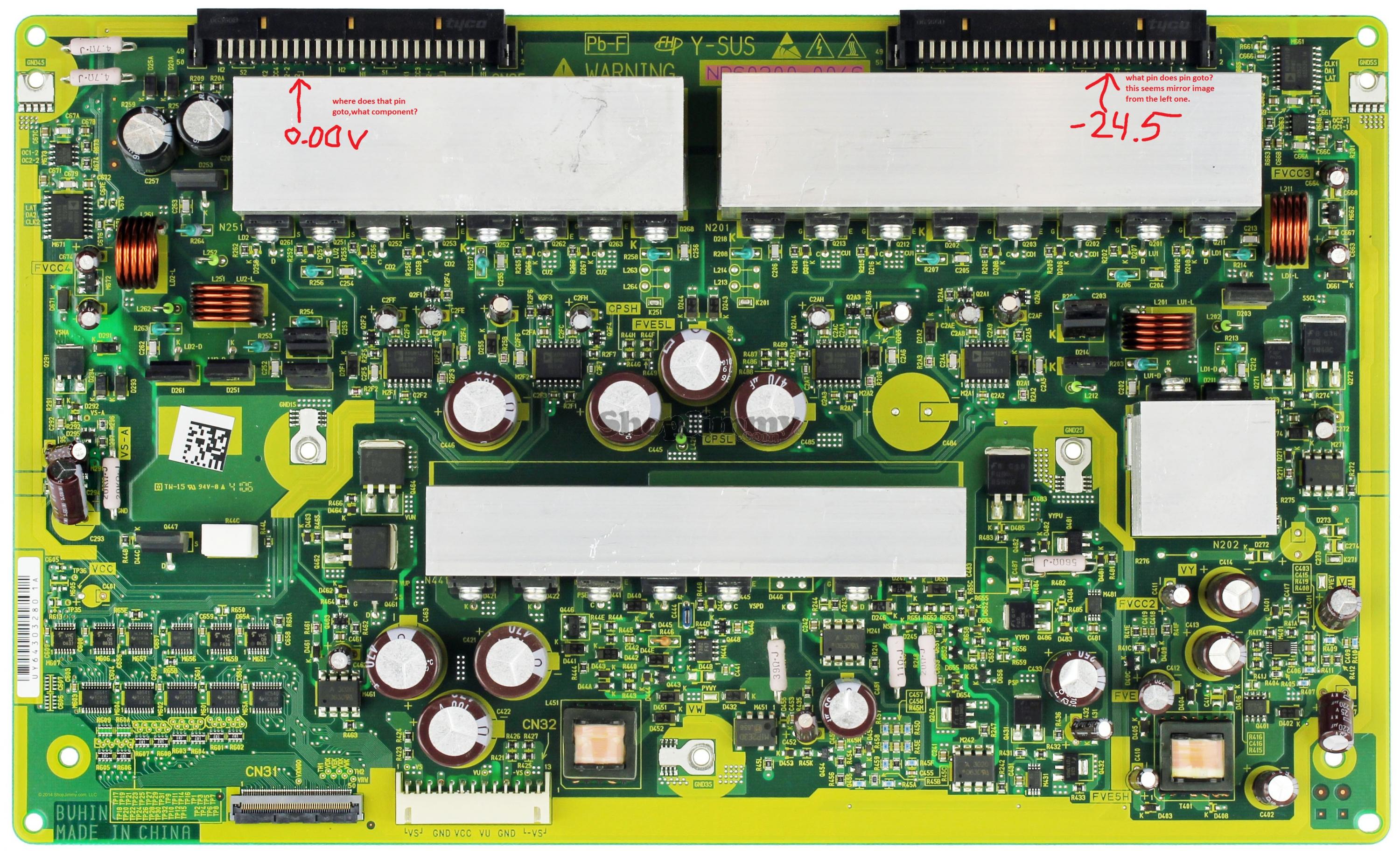

    Here is my current scenario:
    1) The two 3300uf caps were swollen, so I replaced them both.
    2) The two SDR boards (U and D) were both clearly damaged.
    3) I disconnected both SDR's and connected a video source. It now goes from red to solid blue on the front panel and stays that way. The sound is perfectly fine, but there is (of course) no picture as the SDR's are unconnected to the YSUS board.
    4) I can change channels (as evidenced by the sound of various channels changing) with the DirecTV remote and can change the volume with the Hitachi remote.
    I have checked, double, and triple-checked all of the voltages involved.
    PSU is fine.
    PSU to XSUS is fine (via connector CN23)
    XSUS to YSUS is fine (via connector CN22)
    YSUS from XSUS is fine (via connector CN32)
    My focus is now on the YSUS Board (and, in particular, the two connectors that lead out from the left side to the SDR's):
    THIS is the current crux of the matter. I tested all 25 pins on the lower left connector that comes out of the YSUS board (and ultimately leads into the SDR-D), and ALSO the 25 pins on the YSUS upper left connector (that leads, ultimately, to the SDR-U).
    I assumed that I would find exact voltage matches because both of these connectors are labeled exactly the same on the circuit board itself. That turned out to be the case, the voltages do match, EXCEPT for pin #8 and pin #21 (counting up from the bottom) on the LOWER LEFT CONNECTOR ONLY. Those two read 0.00
    All of the upper left connector pins had readable voltages, including its pin #8 (-24.5v) and pin #21 (-51.8v).
    Note: On both the lower and upper, pin #8 is labeled as DA2 on the circuit board, and pin #21 is labeled as DA1.
    All of this leads to a rather simple question I hope can be answered. Does the fact that I get the two 0.00 readings on the lower left connector mean that this particular YSUS board is entirely defective and must be replaced?
    {Or, can I repair it in some way? Or, as is my hope, these two 0.00 readings will NOT prevent the SDR-D board, or the tv in general, from working properly when I connect it?}
    It seems very odd to me that the upper left YSUS connector has readings at pins #8 and #21 and the lower left YSUS one does not.
    Please feel free to reply in as detailed and as exacting manner as you'd like. I am into this pretty deep, as you can see, and I want to get it right before risking $120+ on the SDR U and D's.
    Thanks in advance for your replies.

      Follow-up to Post #1 above:
      Help needed. Still trying to determine if my YSUS is defective or not.
      Here are the full voltage readings from taken from both the Upper and Lower connectors (25 pins on each) that come off the left side of the YSUS and head into the SDR's themselves.
      Question is:
      Are these voltages indicative of a properly functioning YSUS board in this Hitachi P50H401 I am working on, or do the two 0.00 readings that are highlighted below proof of a short that will damage one or both SDR's? The only positive values in the list are marked in green.

                I see what you are trying to get at.
                Now,I'm no plasma expert,that up front
                Made a few notes on the picture,to me it seems that lower connector is pretty much a mirror image from the upper connector.
                If that statement is true,common sense would then dictate you need to see voltage on pin 8 and 21 on lower connector as seen on upper connector.
                Did you take a resistance reading on pin 8 and 21 to ground,to see if it's shorted?
                I would trace those pins back to the component they are connected too.Is it the same component on both upper and lower?
                If so,does mystery components both read the same or is one(lower) defective?
                Also,RB123 stated ripple from defective caps can blow up the buffers,I would ask him to point out what caps they are and maybe replace those?
                Also,did you measure the new buffers for shorts? Wouldn't be the first time to receive shorted buffer,claiming to be good.

                    Also, martino, I don't think the upper and lower connector pins are mirror images as much as they are corresponding parts. In other words, pin #8 on the upper (counting up from the bottom) is a direct match for pin #8 on the lower (also counting from the bottom of that connector). Both of these pin # 8's are labeled DA2. Pin #21 (still counting from the bottom up) on both connectors is labeled DA1.
                    Same is true for all of the 23 pins involved, I just used #8 and #21 as examples to show the corresponding nature of lower and upper.
                    This image, when zoomed, helps one to see what I mean:

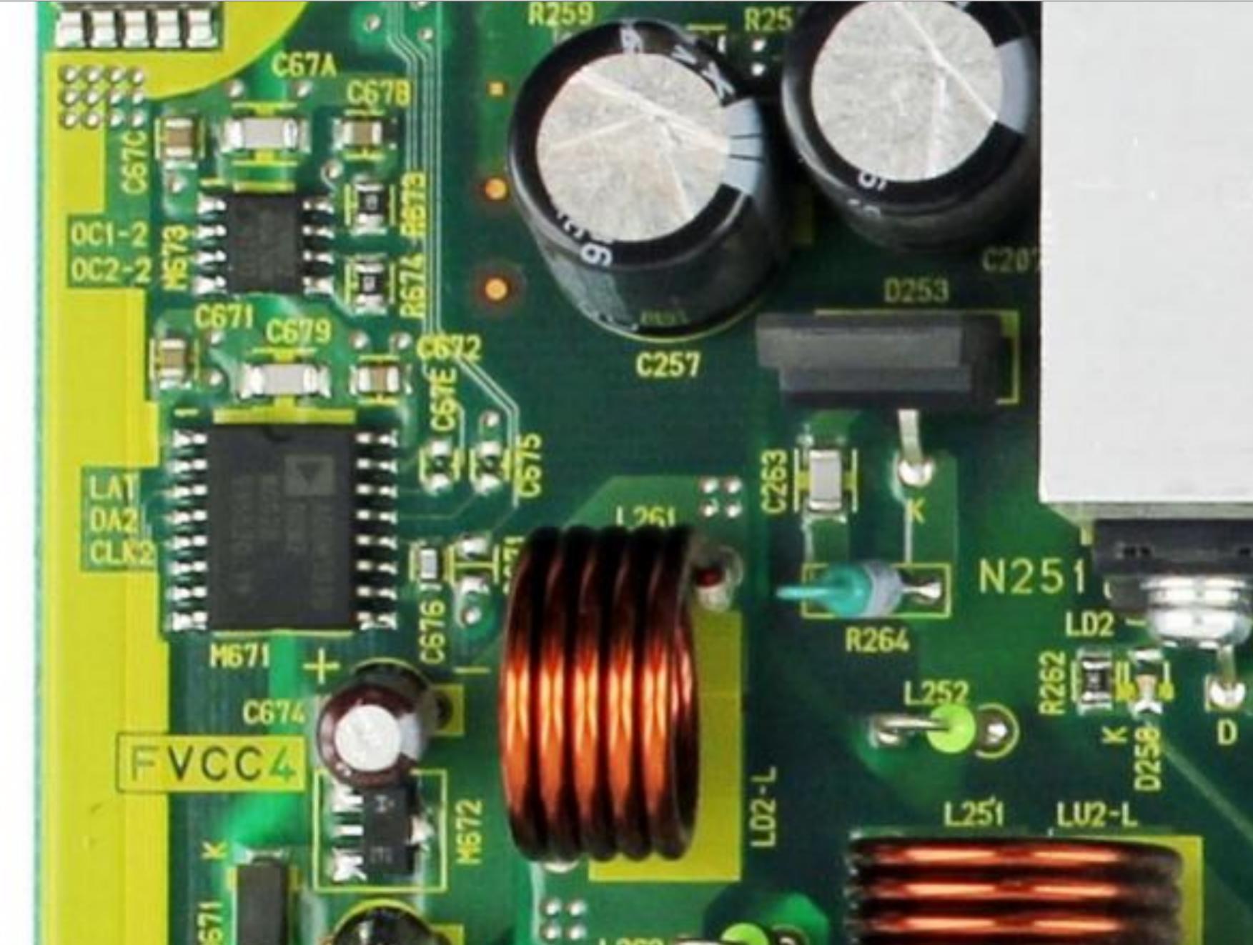

                                Well, here is a synopsis of how the Hitachi P50H401 finally got up and running:
                                The DA1 traced back to a processor that was on the upper section of the board (see pic). The DA2, to one that was on the lower section (see pic). I reasoned that they (the processors themselves) were both working correctly due to the fact that I was able to get correct DA1 and DA2 voltages out of the upper YSUS connector that leads in to the upper SDR buffer board.
                                So, I connected the upper SDR buffer board only at first, and got the desired picture across the top half of the screen.

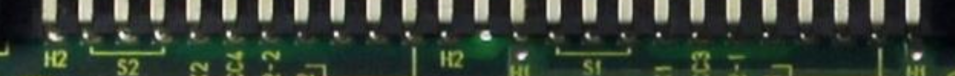

                                Connecting the lower buffer board was a little more risky. But, the risk was mitigated by the fact that I was actually able to find voltages on the pins underneath the top pins on the connector. In other words, I was reminded that there are not really 25 pins on each connector leading out of the left side of the YSUS ..... there are 50 on each connector. The top 25 are obvious, but there are also another 25 that rest underneath the top 25 (see the third pic).
                                When I tested these "underneath pins" on the bottom YSUS connector, they read voltages on DA1 and DA2 that were in line with what I had expected to find all along.
                                So, with that fact in hand, I went ahead and risked connecting the lower SDR board. I figured that it would probably go into protection mode, rather than frying out the IC chips on the lower SDR, based on the notion that I was getting voltage on the underneath pins.
                                It worked, and the full picture came to life. I have been running it off and on for the last couple of days now, and can safely say that the fix was a success.
                                So, if anyone out there is finding 0.00 voltages on the DA1 and/or DA2 pins (at least on the lower connector and on the upper, more obvious, pins of that lower connector), you can safely go ahead and hook up the SDR without reservation. I can't speak for the rest of the pins, but would venture to guess that the same might be true for several of the others.
                                Hope this helps someone out there. These older Hitachi plasmas are quite aesthetically pleasing and have a very good picture considering they are about 10 years old now.
