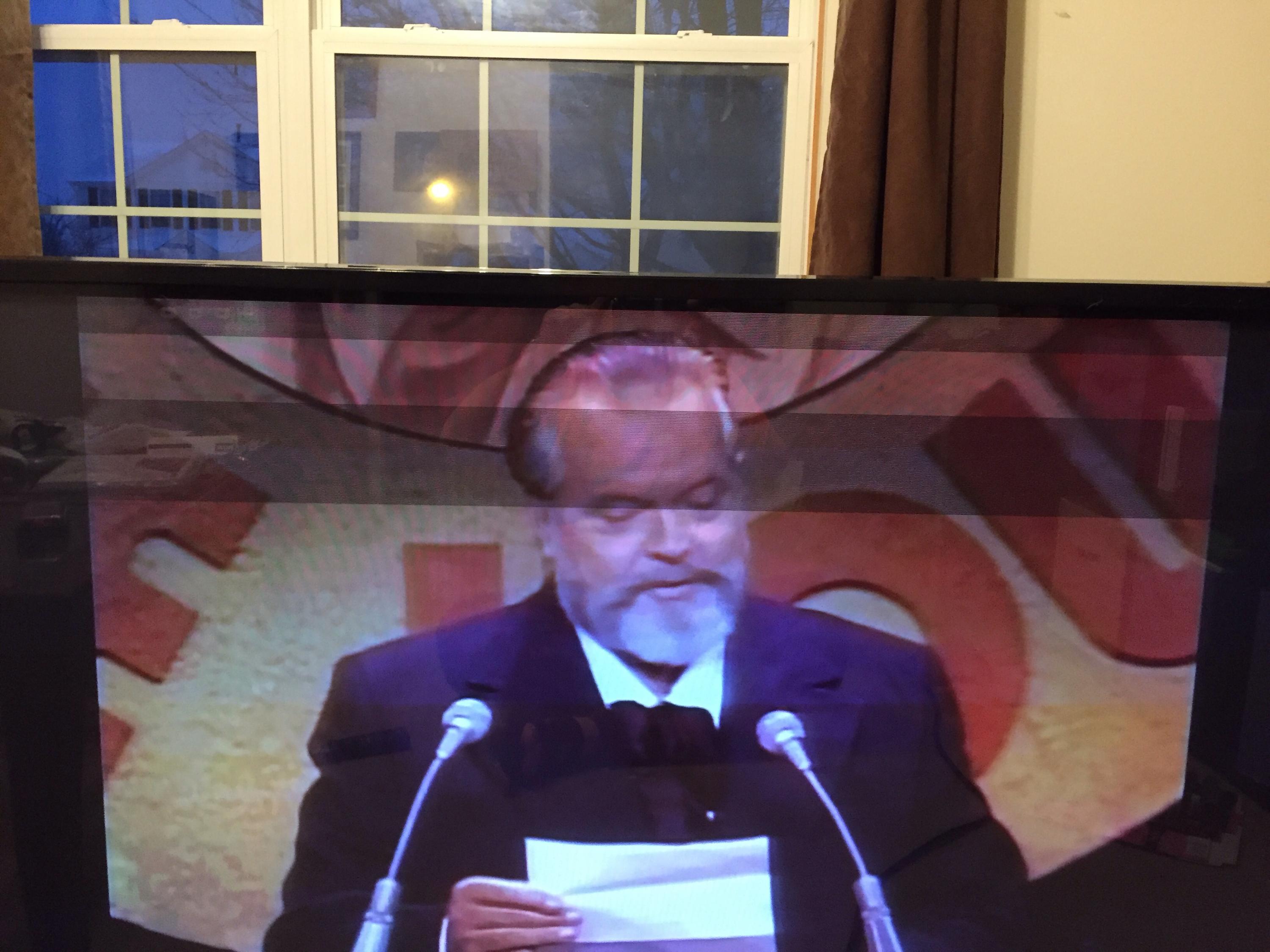

    I purchased an lg 50pm6700 for $20 that was new but with a cracked screen.
    I did my research and by the panel number I found it is the same as the 50pa6500.
    I found one on Craigslist that I traded some stuff for. Seller said the display was perfect up till the time it wouldn't turn on.
    I brought it home, took the back off and found the only difference between the two is the A board or video board, not sure exactly what it is called.
    I swapped them out, still wouldn't turn on.
    I took the power supply out of my new, cracked screen tv, and put it in the other one.
    The TV turns on but there are 2 bands at the top of the screen. Can anyone give me any advise?
    I also changed a board from the top left, I think it's called the buffer board but no change.
    I have extra of every part except for the psu.

    Re: Lg 50pm6700 horizontal bands.
    Change the Ysus board from the smashed one.
        If not run the test patterns, by removing Lvds cable (flat cable from mobo to control) and jumper the two pins on it and turn the Tv on.
          Originally posted by Malachi
          Lol which one is that?
          Its the one that the buffers plug into.
              I changed the Ysus board, now I have no picture at all.

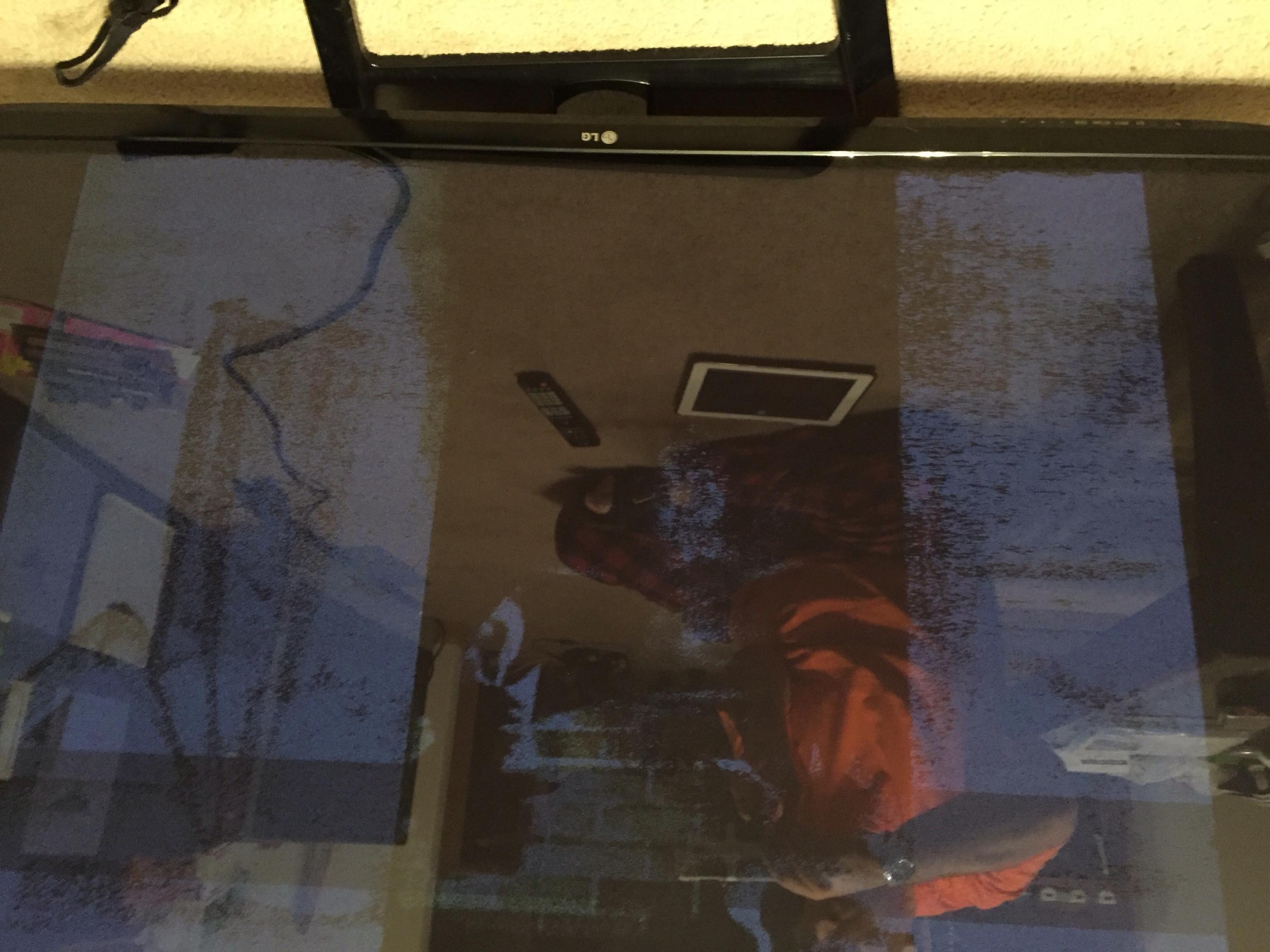

                          Put the old Ysus board in, now it's worse.
                          • Malachi
                            • Dec 2015
                            • 1077
                            • Usa
                            Put the original Ysus board in, the one from the first picture with the band across the top, now it looks like the bottom one.
                            Tried it all again. Ysus from smashed board, no picture just sound.
                            Original Ysus, the last picture I uploaded.
                            Changed the buffers, no change with eithe Ysus board.
                            Do I need another Ysus board?
                            The smashed screen tv would power on with sound and no picture, I figured due to that cracked screen but I guess it could have also had a bad Ysus board?
