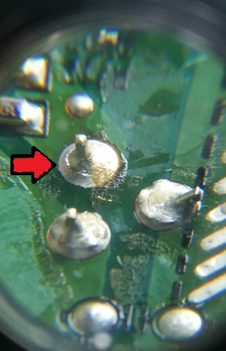

    I have Bad and Good experience to this similar problem. After searching and found shorted 30F124 and change both 30F124 in he neighborhood, and check that no other short, I power up the panel, fail again, and found another 30J124 short. Waiting for the spare to arrive, I check all of the solder side, and found alot of solder joint are bad. So, if you found some shorted MOSFET or IGBT, check also the solder joints for Thermal crack.
