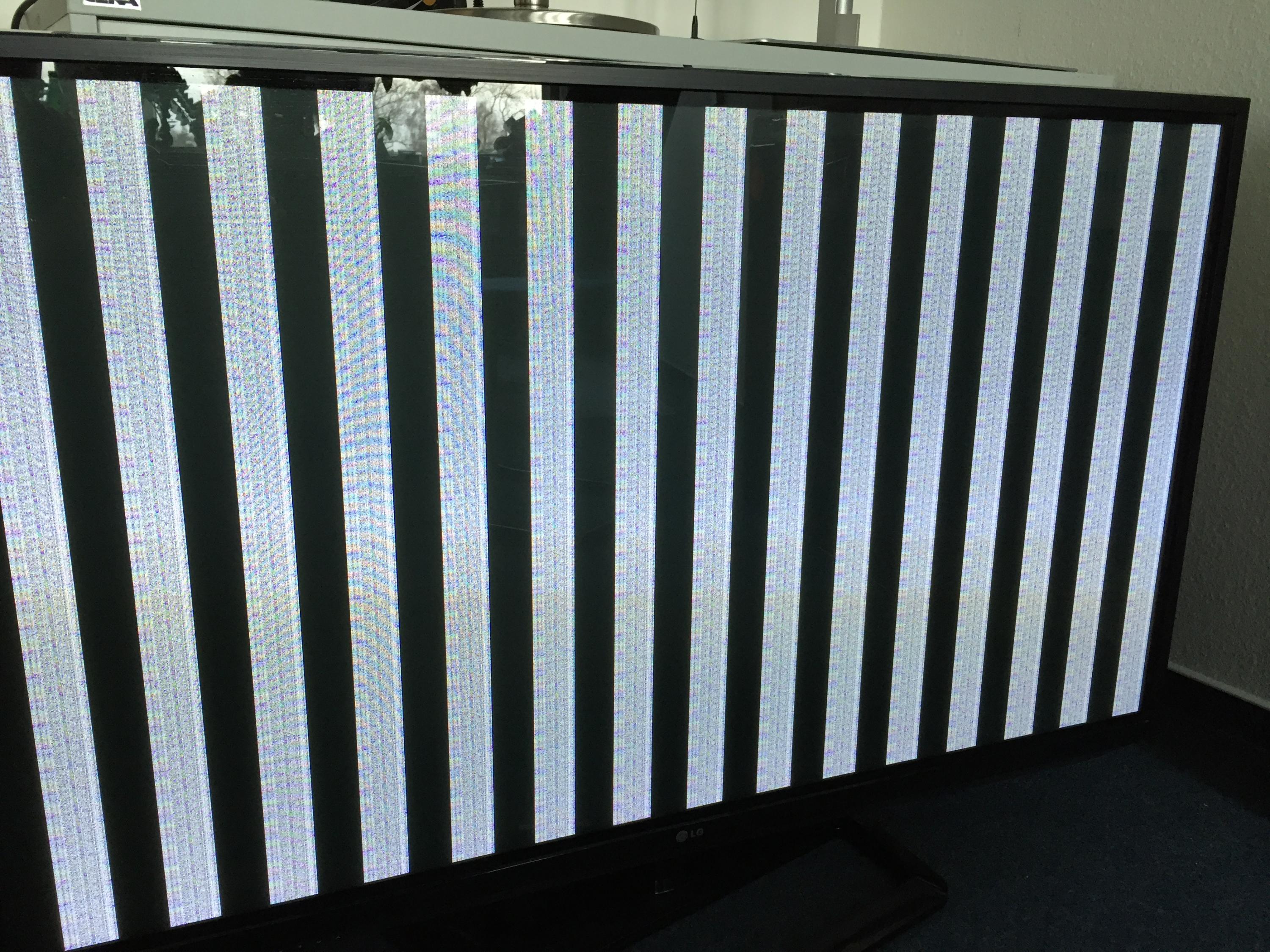

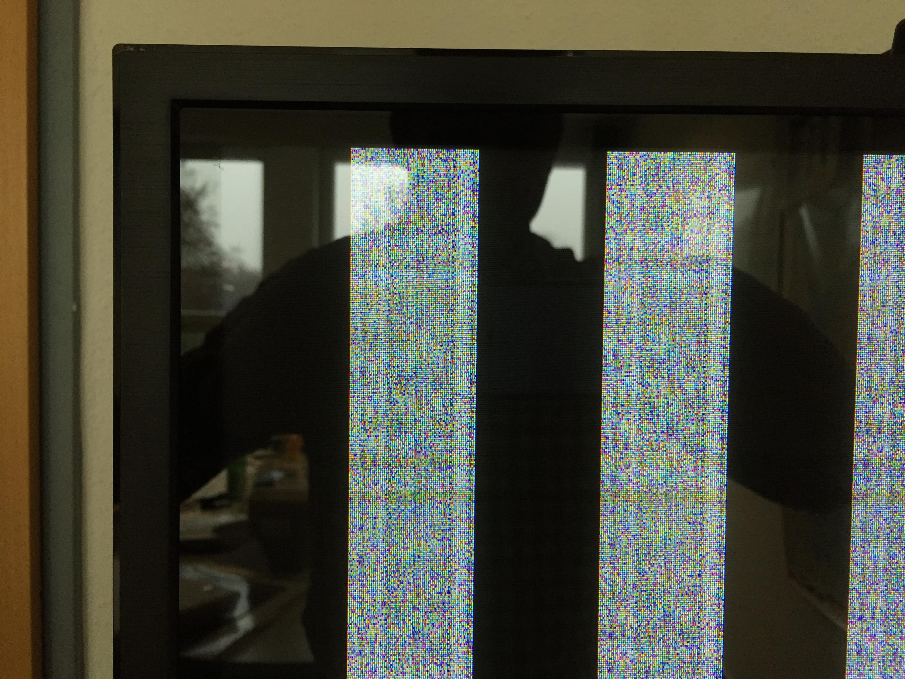

    Hello Guys,
    i have a TV that has max 40h of usage (Office Monitor).
    The next day, it has well defined vertical lines.
    I doubt, it's the logic board (or T-con).
    Can anybody confirm this ?
    Sound comes nicely, and channels are switchable, only the lines remain.
    Even entering the menu doesn't change the picture.
    Please find attached some pictures.
    Any help is highly appreciated.
    Thanks, Jan
    PS: In case... can i use a Rev. 1.1 board instead of the mounted Rev. 1.0 ? (same LG part no. for both)

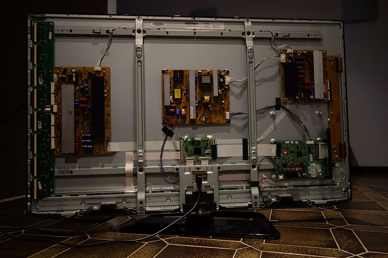

    Can you take the back off and take some pictures of the boards for us?

        Re: LG Plasma TV 50PA6500 vertical lines
        Ok, with a little delay, here's the picture.
        IThe logoc board is the small one in the middle.
        For LG spare parts, what is the relevant number, EBR or EAX ?
        Thanks, Jan
            Look up on how to run the test patterns on Lg plasmas. I would say mobo at fault here.
                I disconnected the Mainboard and shortened the ext_auto_gen pins on the logic board.
                The stripes remain, or better appear, when the pins are shortened.
                So i suspect, the Mainboard is OK.
                What about the Y-SUS ?
                Regards, Jan
                  Control-board fault.
                  TELEFIX
                  • tw2005
                    • Oct 2011
                    • 6458
                    Ditto, I'd be thinking logic ctrl board especially if it remains with the mainboard isolated and the auto-gen enabled
                      Ok, i think i'll replace it.
                      I have an EAX, an EBR and a revision on the board.
                      Do all three have to match ?
                      Thanks.
                      • tw2005
                        • Oct 2011
                        • 6458
                        most likely the EBR number, the EAX could be just the PCB number, the white sticker would be the one I'd go with.
                        • Jever2000
                          • Feb 2016
                          • 10
                          Ok, guys!
                          I finally ordered a new logic board for .... 6$ (18$ postage to Germany), and ......
                          IT WORKED
                          The pattern is still a bit visably when the screen is black, but i hope this will disappear over time.
                          THX to all supporting!
                          Jan
