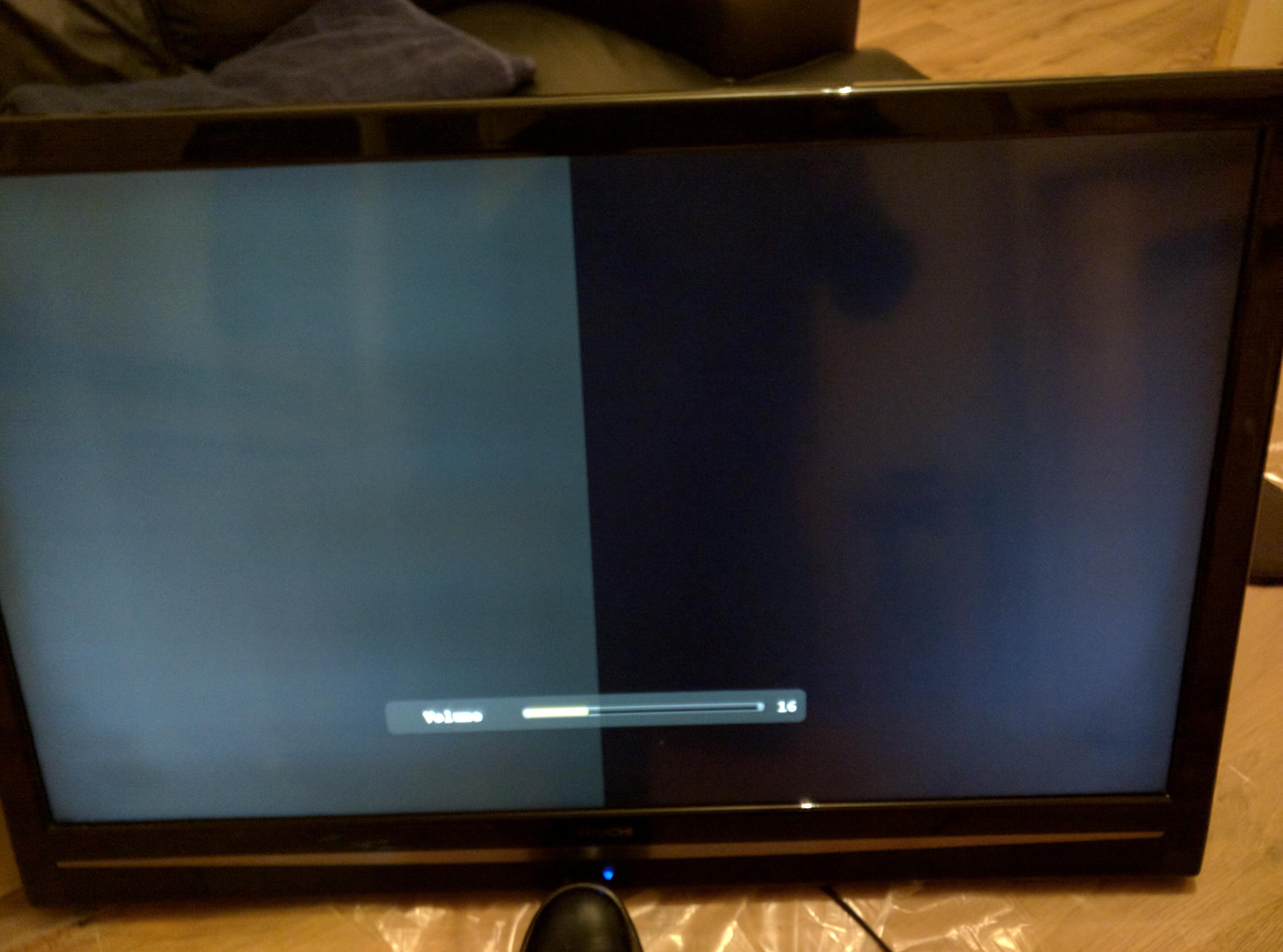

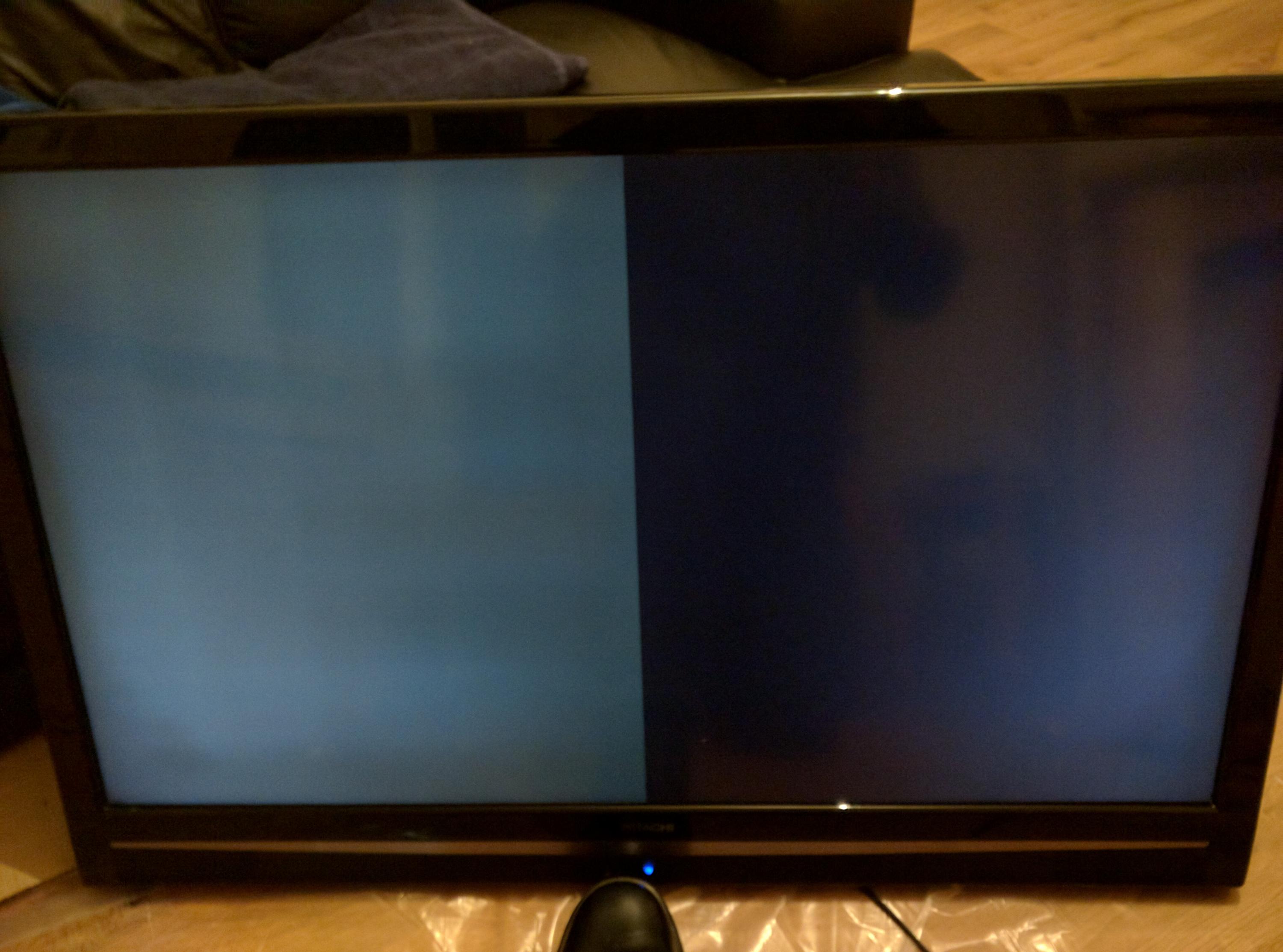

    Could this possibly be a tcon issue or panel? The screen works but one side the darker than the other.

    Panel failure Think I did a Sanyo 42" with that Lg panel the Top left hand corner tab bond was the cause applying pressure fixed it.
      Re: Hitachi L42VC04UJ
      Thank. I'll give it a shot and report tomorrow.
