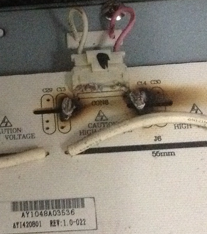

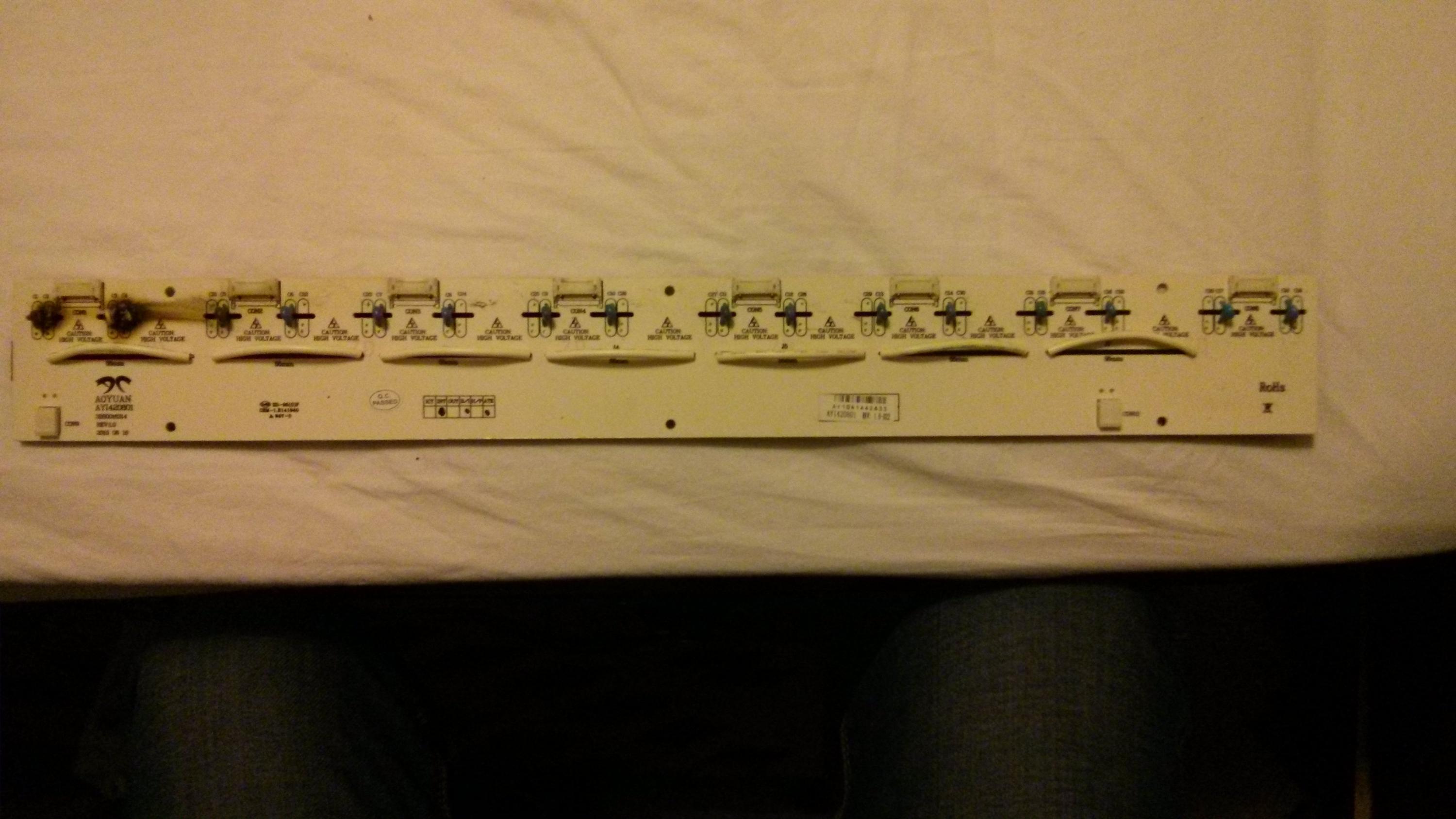

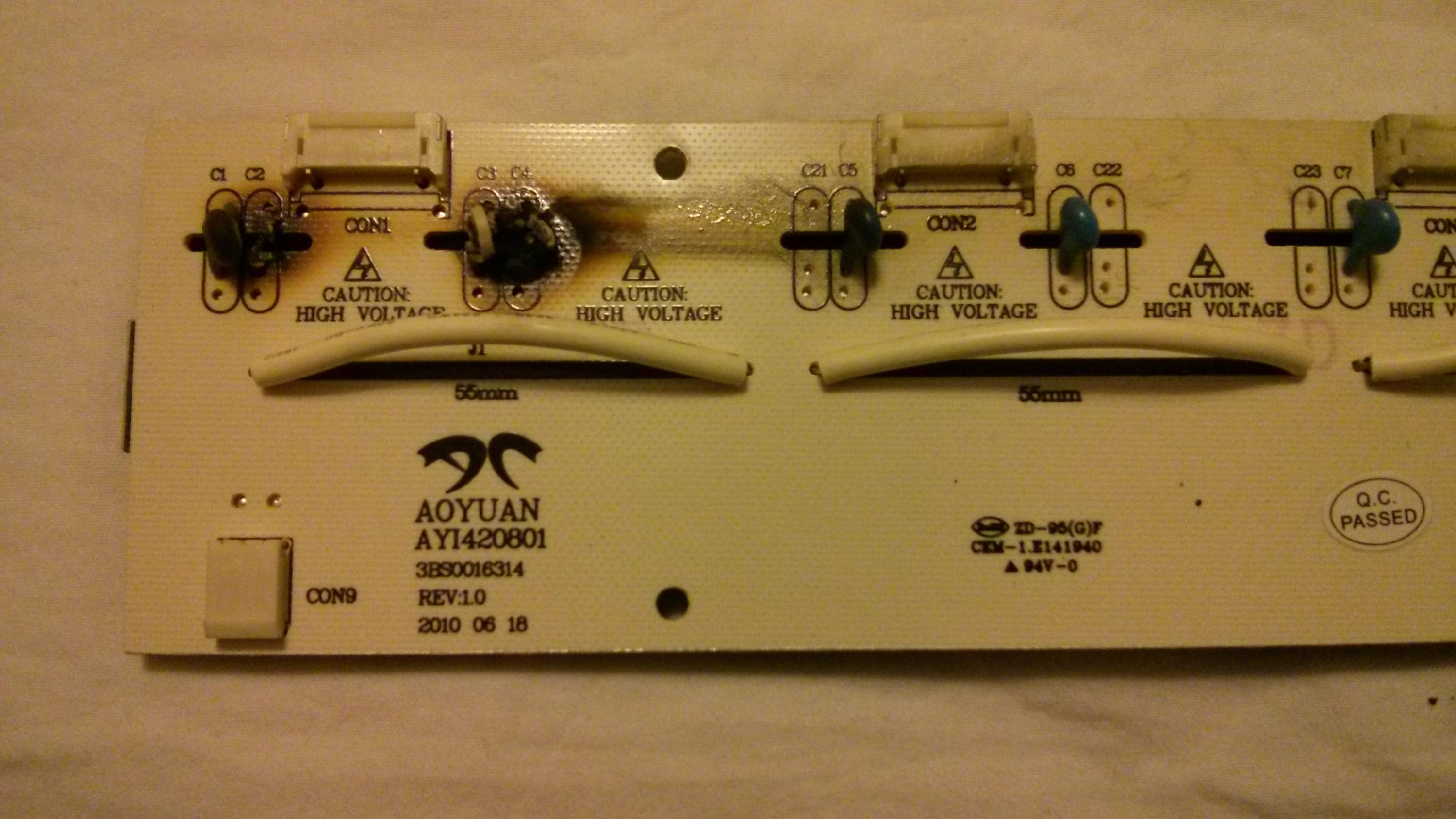

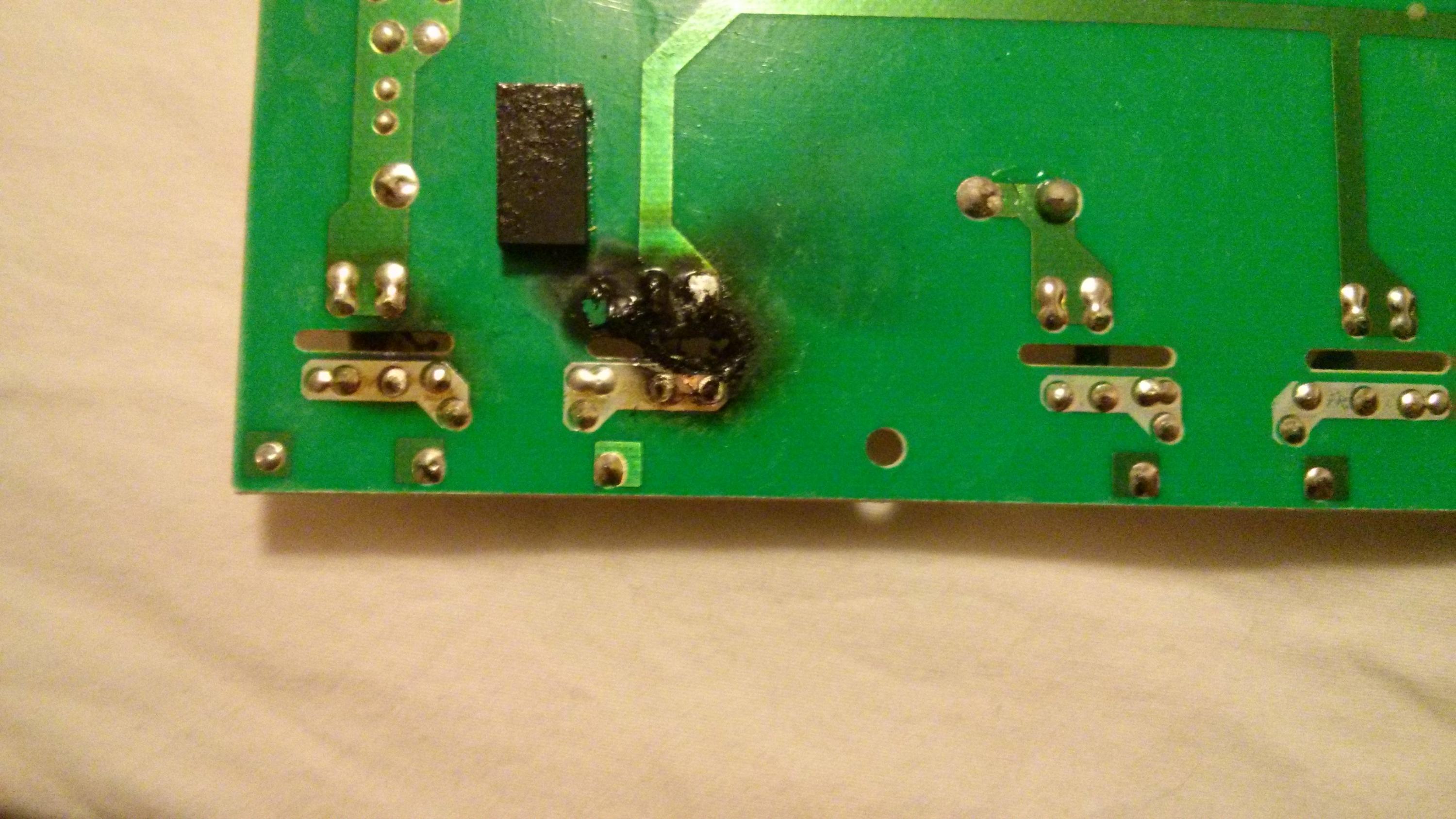

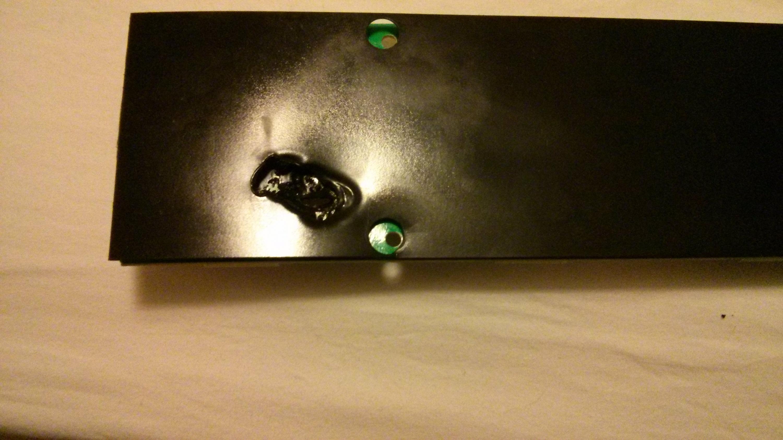

    Hi Guys I have a bit of an issue my T.V's backlight recently got very dim but the bottom was still well lit. I played around in setting trying to fix it and then I could smell burning plastic coming from the T.V I shut it off and took it apart. After taking back cover off right away I noticed were it was burning and it was the Backlight inverter from my understanding. However after searching online for a replacement part I did not find any and was wondering if I could just repalce the capacitors even though the board is slightly burned as shown in the pictures.Model Number is
    AY1420801
    3BS0016314
    Thank you for you input
    -Anton
    Re: RCA 42LA45RQ Backlight inverter board
    You have burnt out ballast caps (current limiter for the CCFL) which probably failed shorted or has leakage resistance.

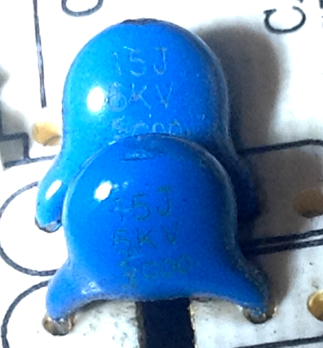

    What are the text printed on the caps that are not damaged? I usually replace them all at the same time. You may also may have worn out lamps that are drawing too much current.
      What was your solution for this?
      I have the exact same board with blown caps on CON6...
      The markings on the other caps are 15J 6KV... I don't even know where to begin looking for replacements... or if I need a new board.
      Any help is greatly appreciated.
        http://www.digikey.com/product-detai...001-ND/4457598
