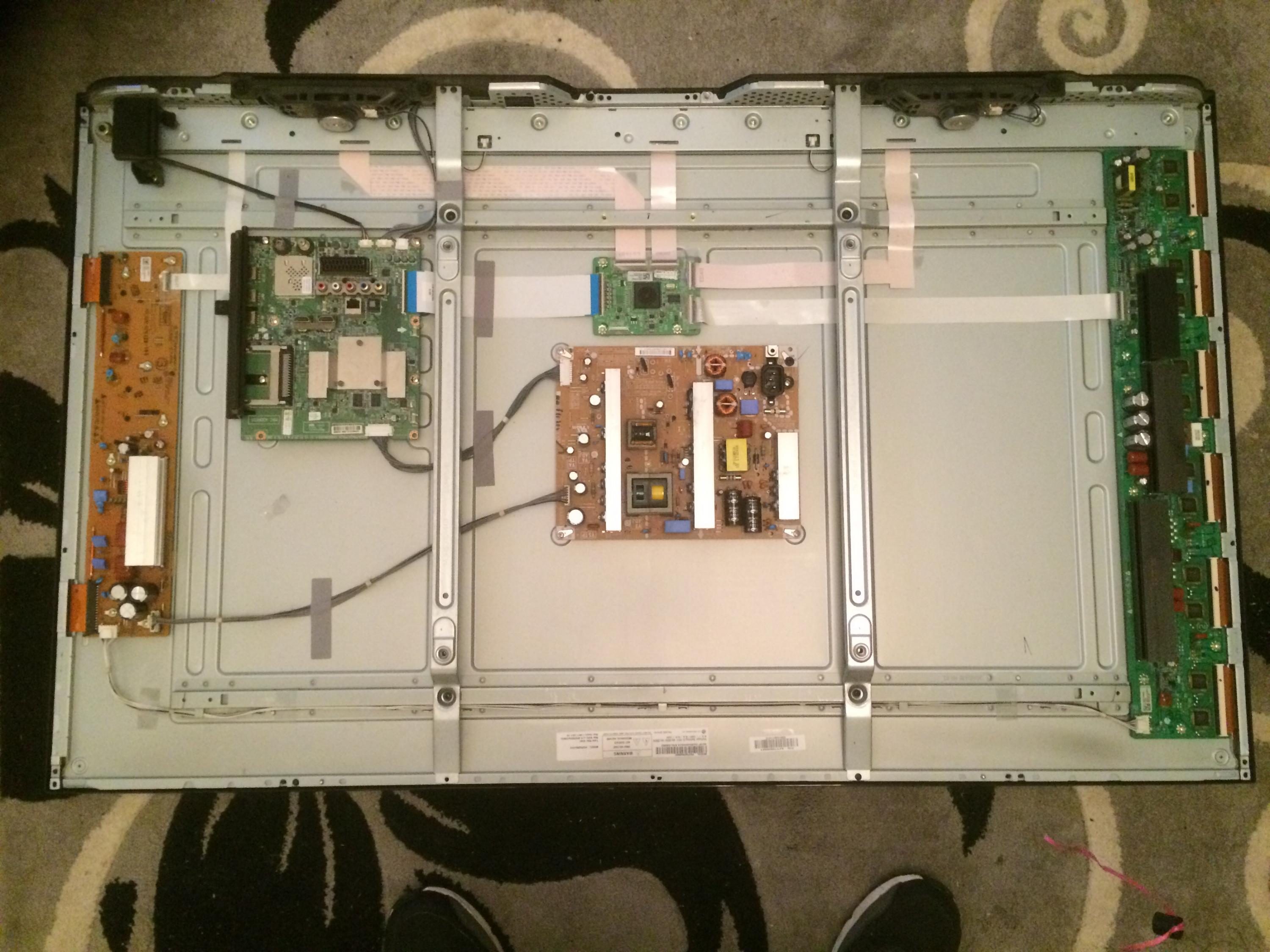

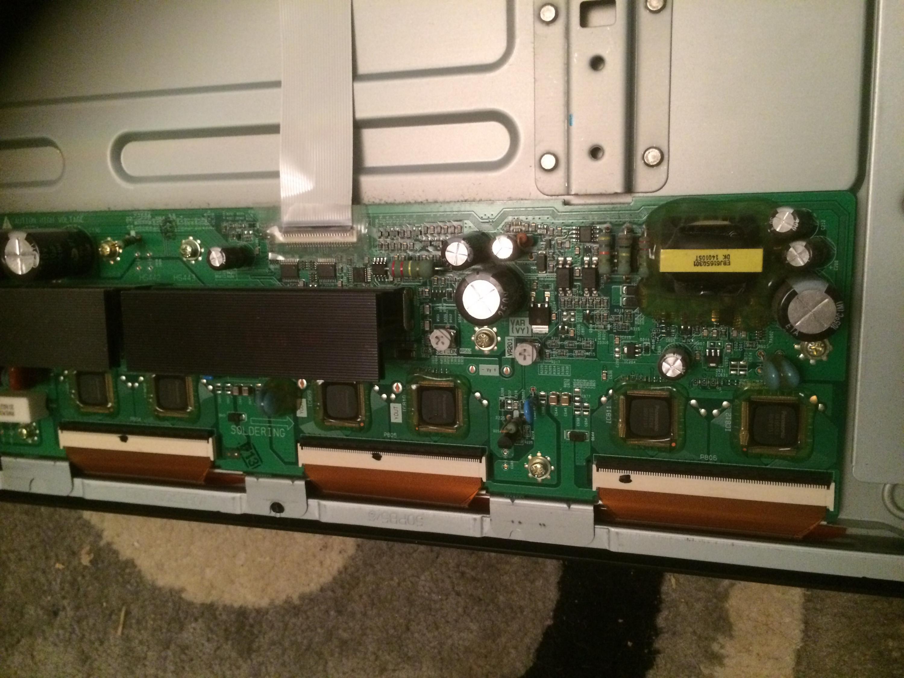

    Hi everyone got a 50" lg plasma here which powers up but no picture i have sound ive checked all boltages coming from psu and they seem fine. On the zsus the 18v is only measuring 3 volts and same with ysus disconnected the board is eax65335001 can anyone help narrow down where the 18v has gone thanks

      Take a picture of the y-sustain please.
        Re: Lg 50" plasma no picture but sound
        Probably shorted Ipm but we need images.

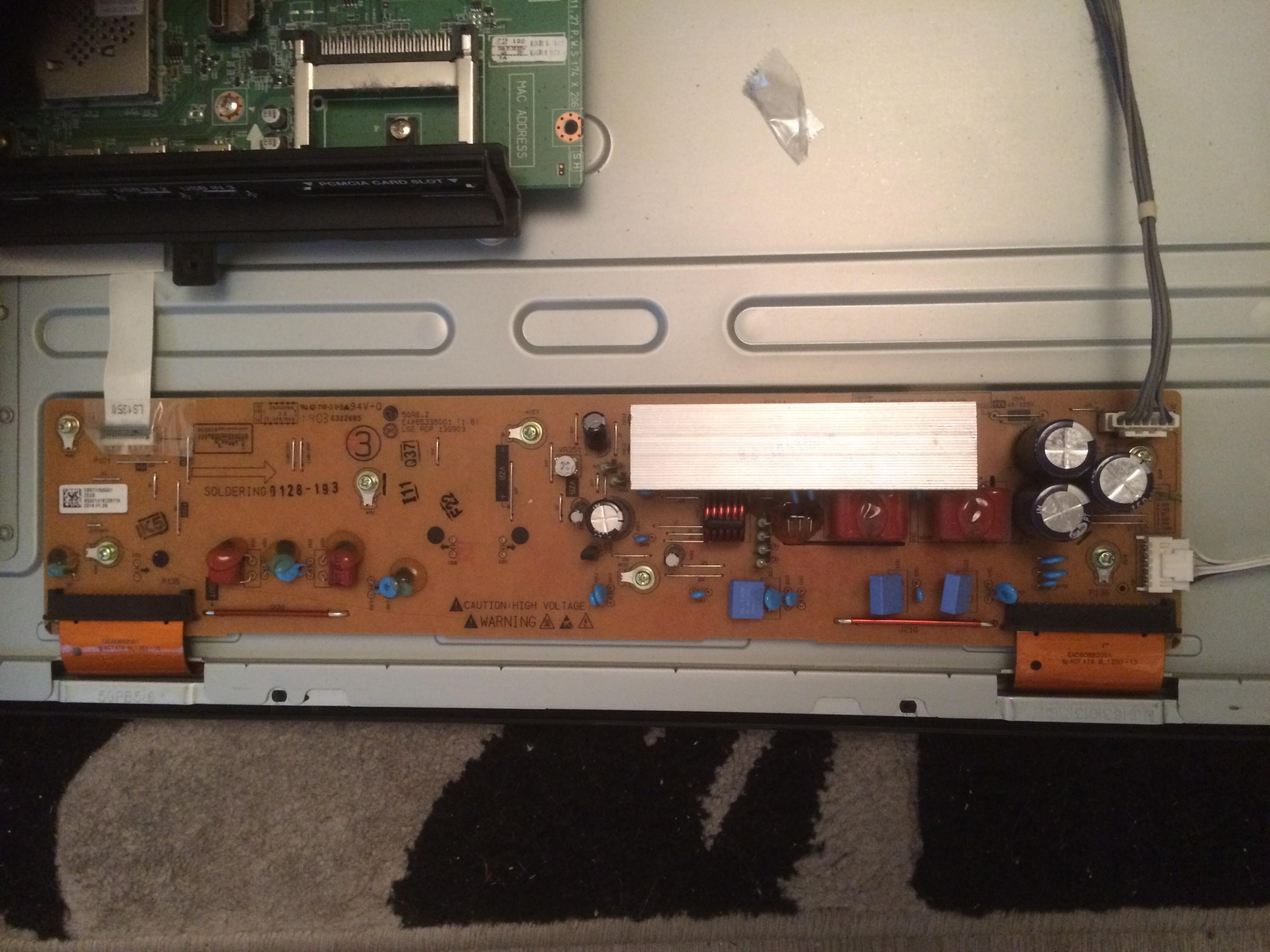

          All the voltages are fine going from psu to zsus but the power cable that connects the ysus the 18v is only goving me 3v with or without the ysus plugged in
            This is zsus

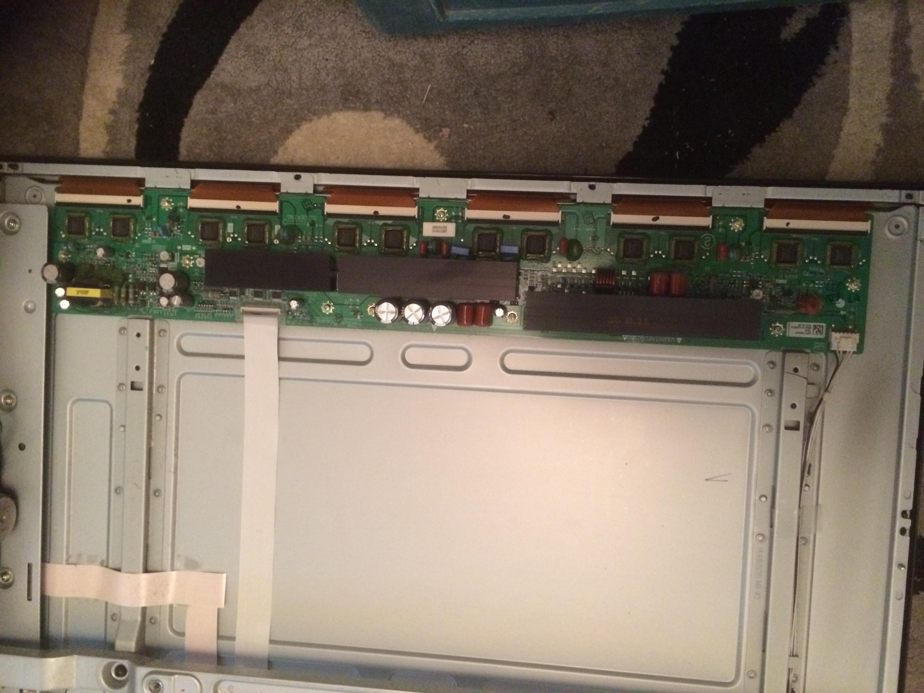

              This is ysus

                I bought brand new zsus as thats the board i wasnt getting the 18v from but new board is doing same thing is there a signal that has to come from logic board or somewhere to switch on 18v to power ysus?

                    You have a faulty y-sustain.
                    This TV is quite difficult to troubleshoot because a failed y-sustain pulls down all the other voltages.

                        Nope, everything has to be working perfectly for this TV to show perfect voltages. It's a pain in the arse.
                        It's almost certainly a failed y-sus.
                        Don't know why LG decided to leave their trusted y-sustain and buffer layout and copy the more recent Panasonic SC boards.

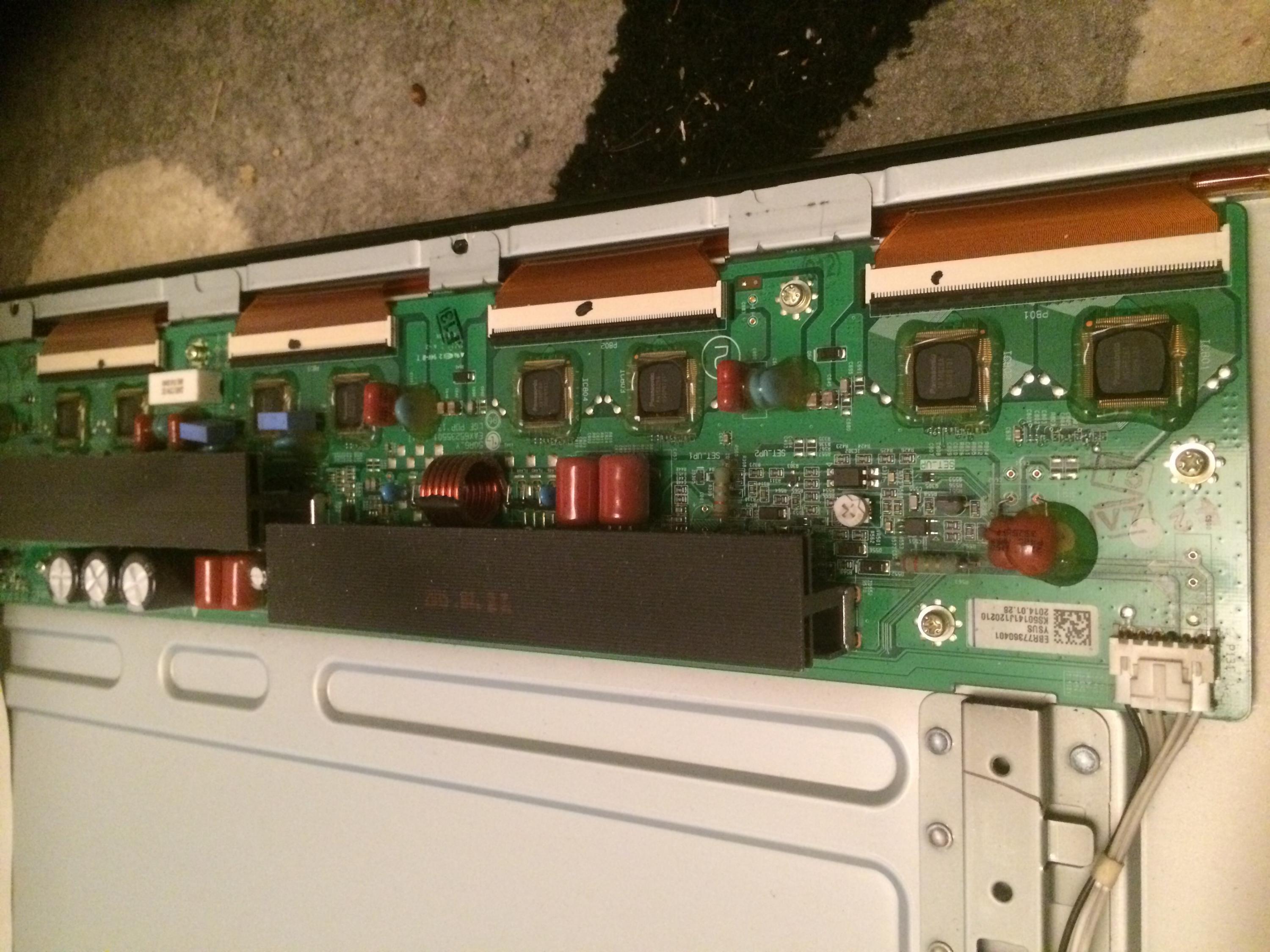

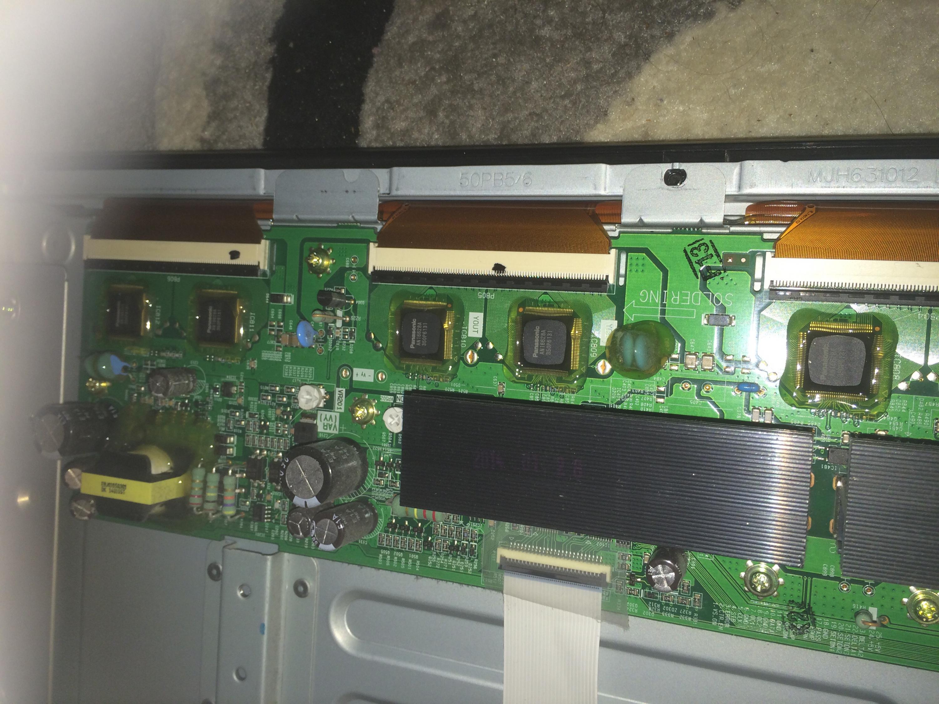

                        Take a close up picture of the lower half of the y-sustain, I probably know what's failed.
                          Lower half
                            Top half

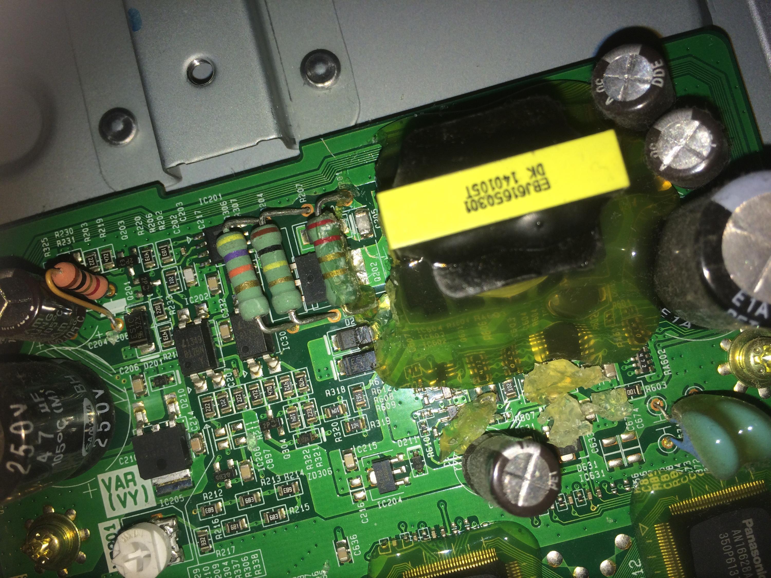

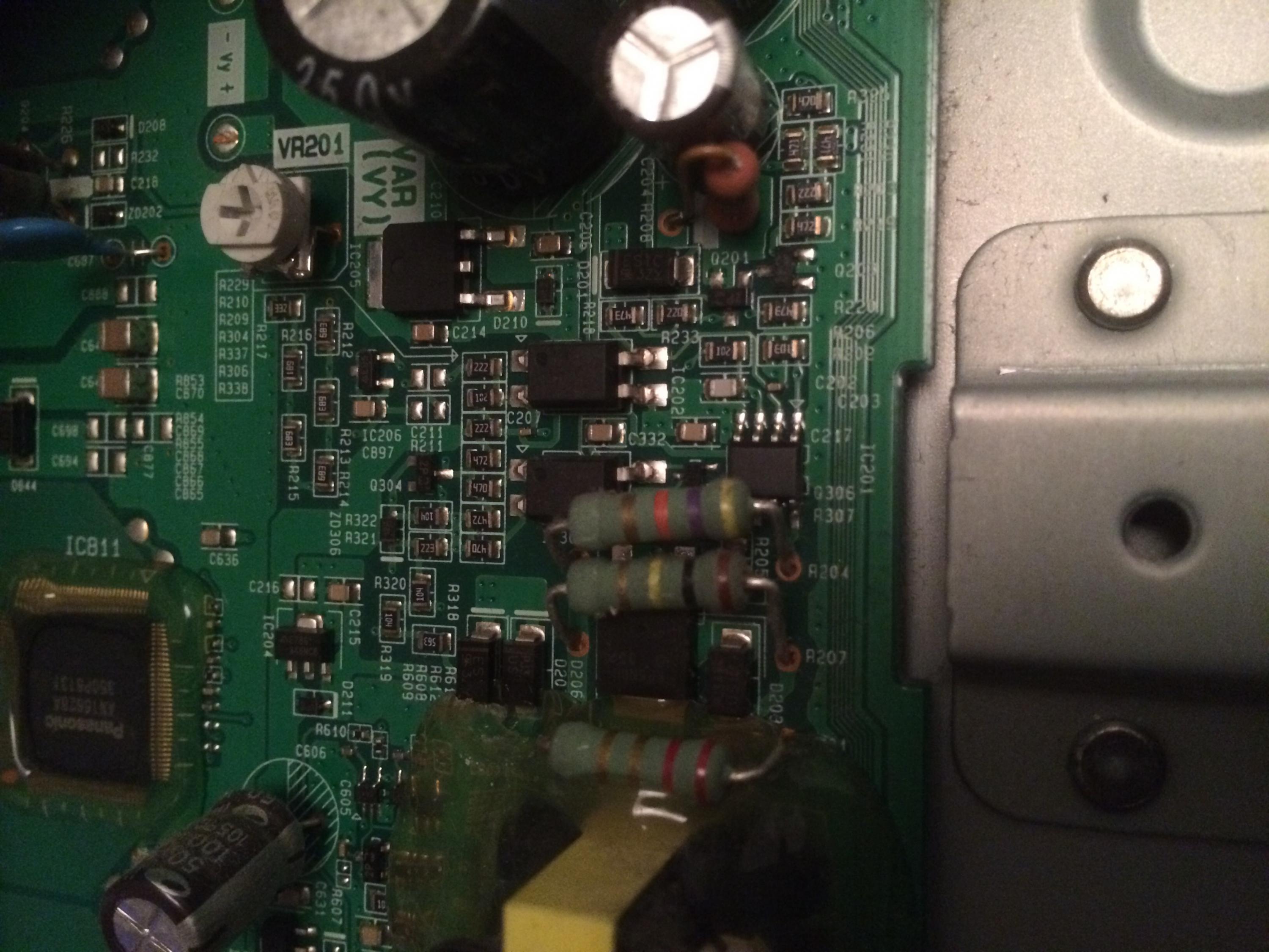

                              OK you see the 3 resistors.
                              First one is 2.2 ohm (red red gold gold)
                              Bend them up towards the capacitors and take a photo of the surface mount components below.

                                Better pic of lower half ysus
                                  Like this?
                                    Yeah there should be a surface mount capacitor under the 2.2 ohm one, it will be under the glue. Scrape the glue away.
                                      Yeh there is
                                        Put your meter in ohm range and measure across it.
