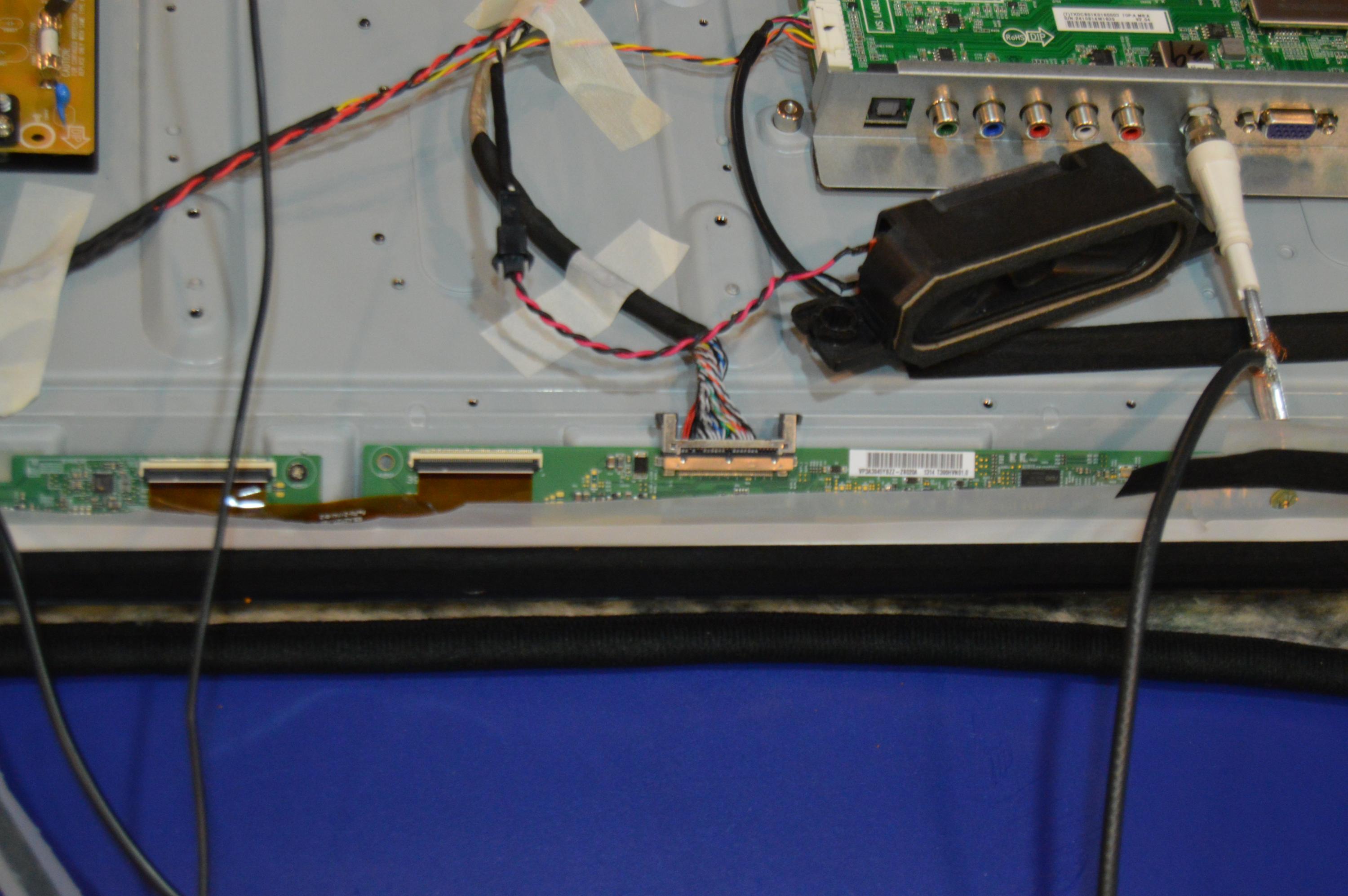

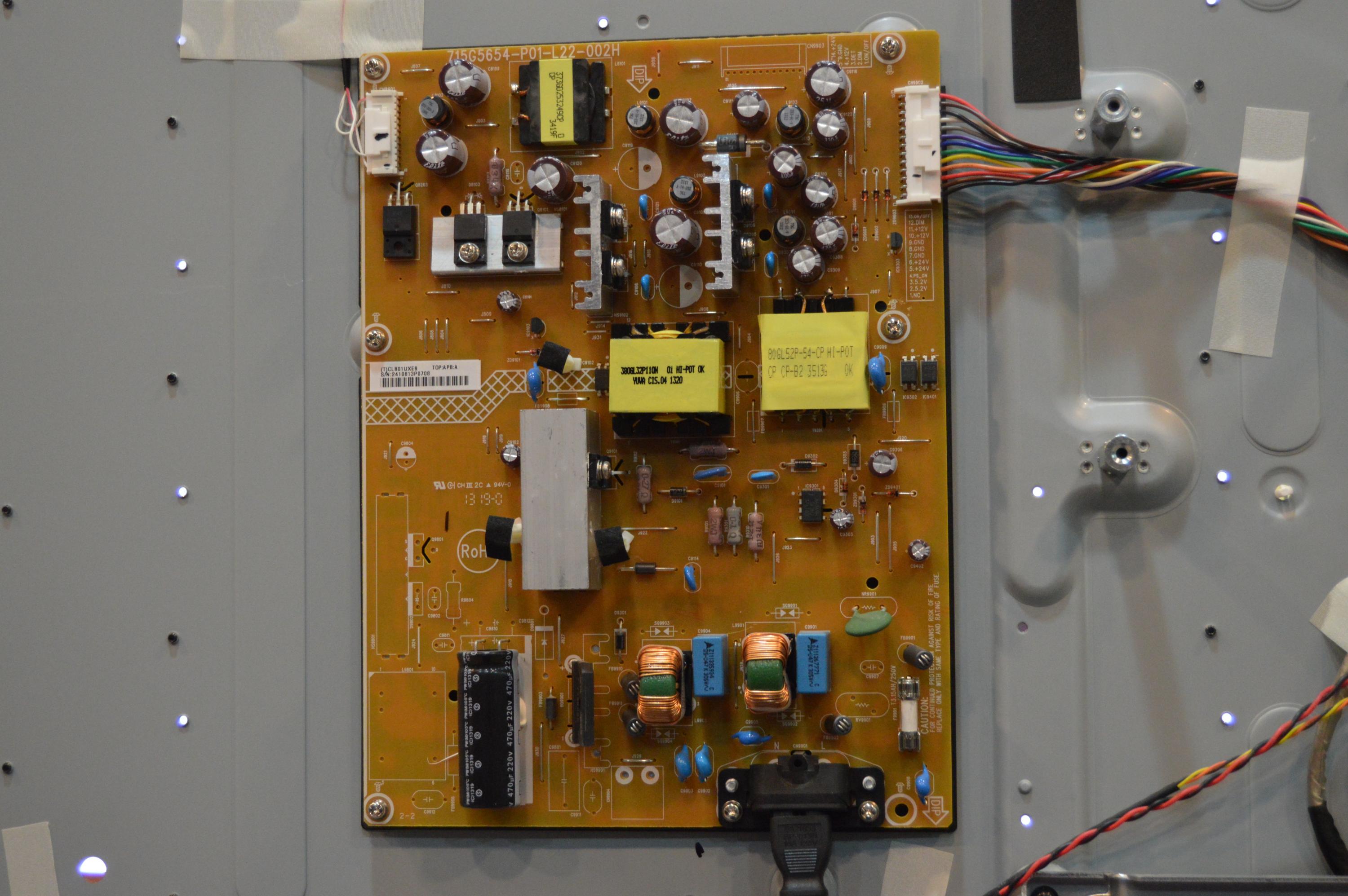

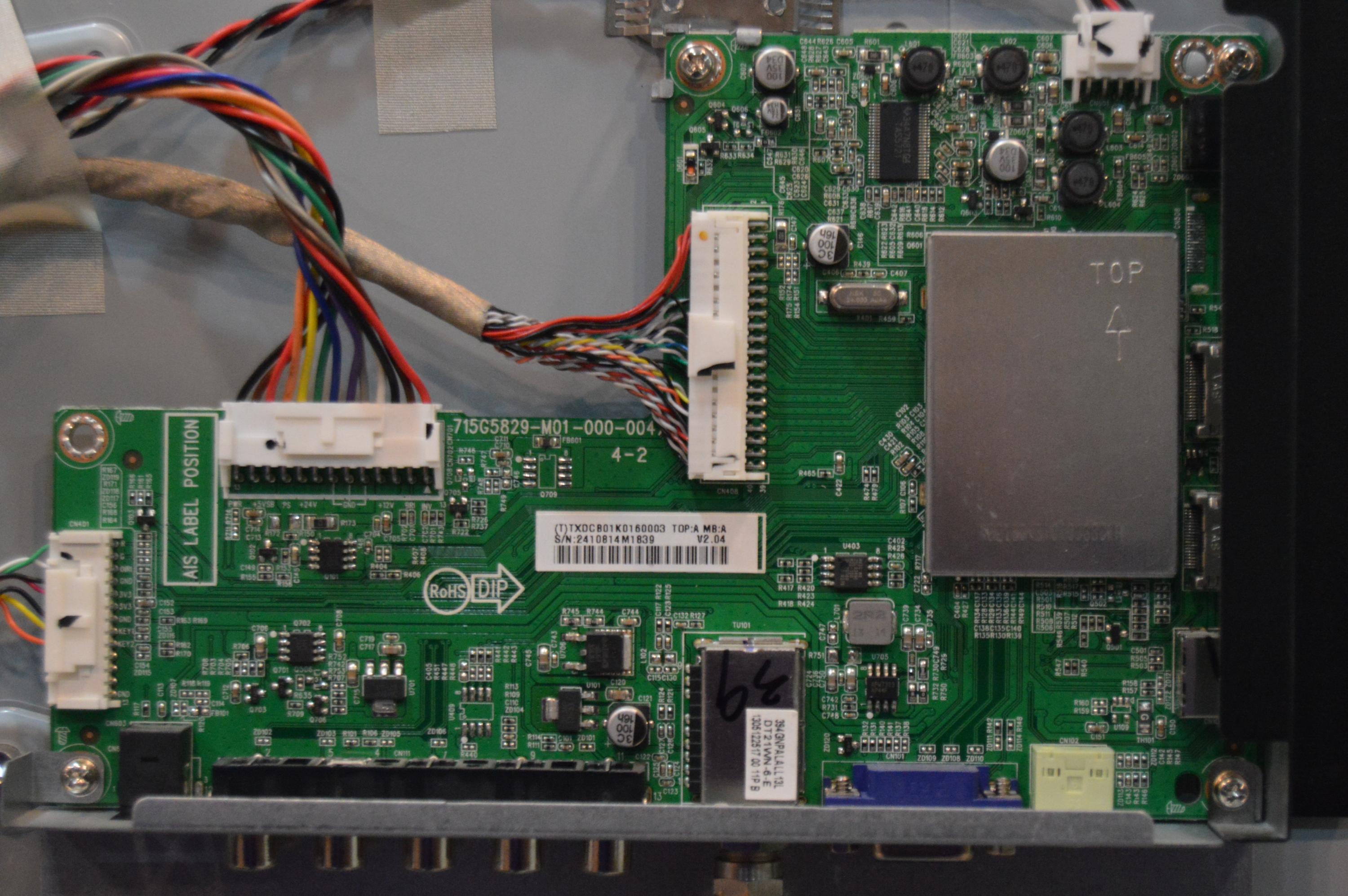

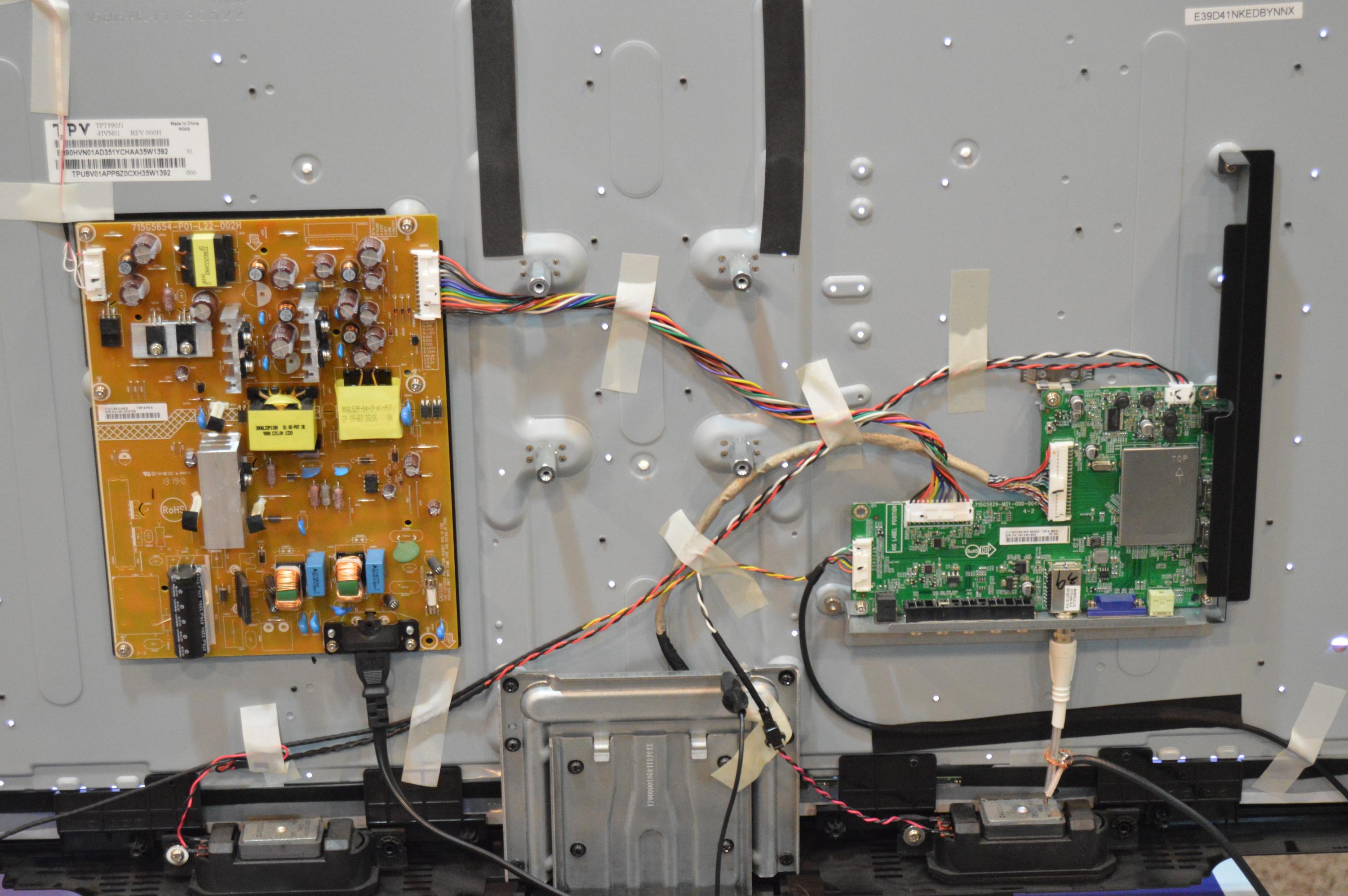

    I have a insignia ns-39d400na14. I turn it on and there is only audio but no video. The back light comes on. If you push the menu,volume, and channel button nothing shows up on the screen. But it will change the channel and the volume will change. I guess at this point I'm not sure how to diagnose it any further. I attached a couple pictures if you need more let me know.

    so you have audio, but no video? Check the T-Con board

      Is the t-con board part of the main board ? Maybe I should have taken some better pics

        Re: insignia has audio but no sound
        no. It is underneath that metal shield bottom middle. follow that cable from the main board.

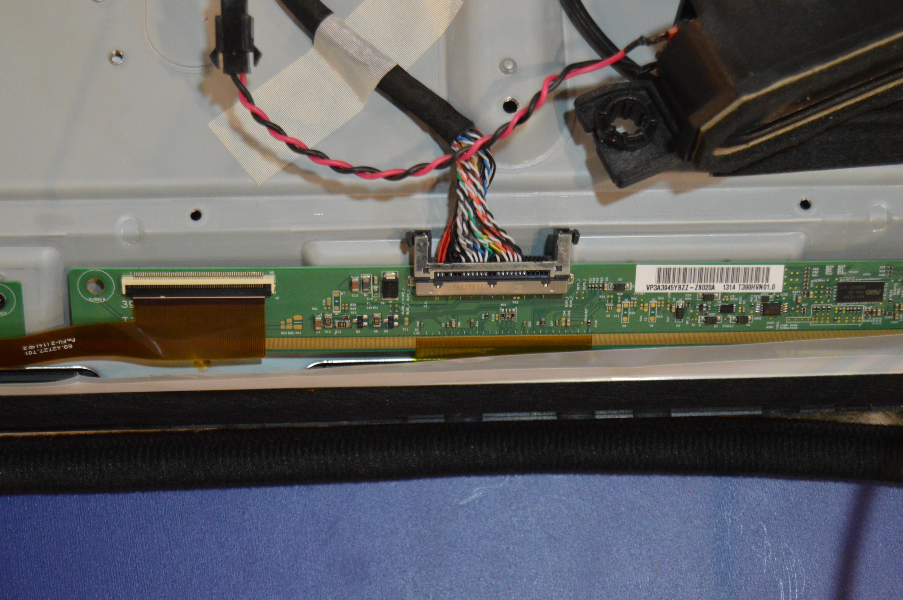

          Ok how in the world is a guy supposed to change out this board with all the ribbon cables intertwined everywhere? Or am I making a bigger deal out of it than it really is? Here is more pics
            It is integrated T-CON to the panel, not replaceable. Do you see that very small green fuse F1 with 'O'? printed on top right next to the big black diode on the left of the connector? Check to see what DCV you have at both ends with ref to the chassis GND.
              Fuse is good. 12v on each side of fuse
                well... that thing is screwed. Only thing you could do now is to check the LVDS cable with the oscilloscope, while turning on and off the menu all the time. You should find the video signal and see if it changes. Then you know for sure the main board is good.
                  Yes sir. It had a video sig. So I guess I'll give up on this one and move on to the next. Wanted to comment on the new site. Very nice. Thanks for the help guys.
