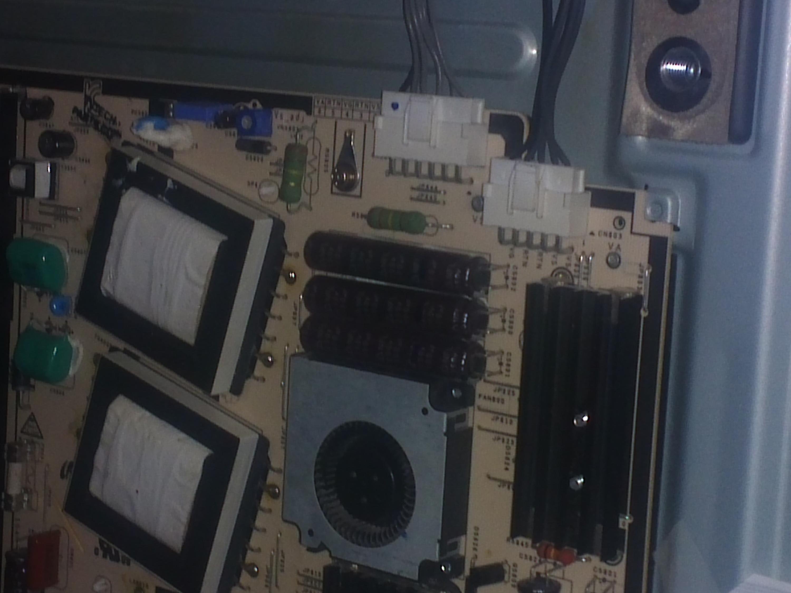

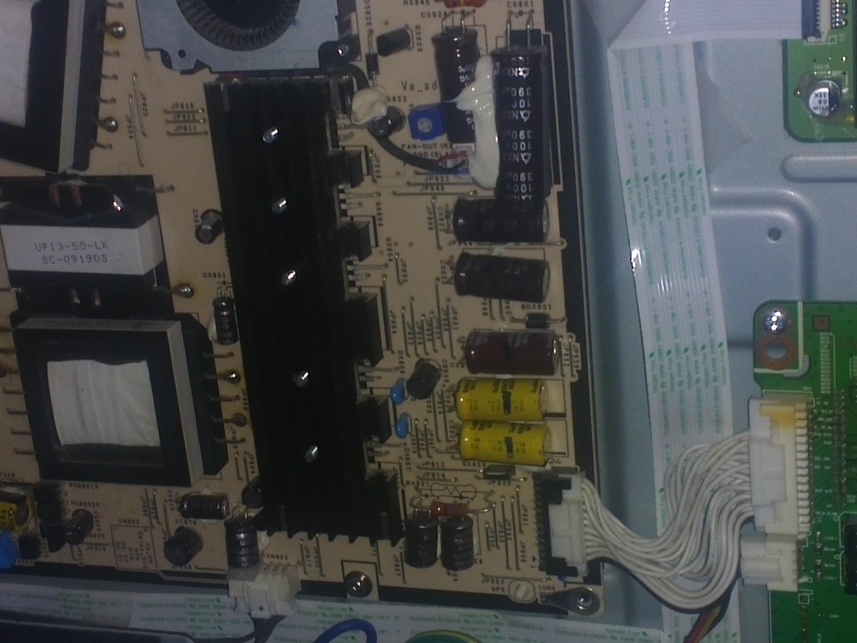

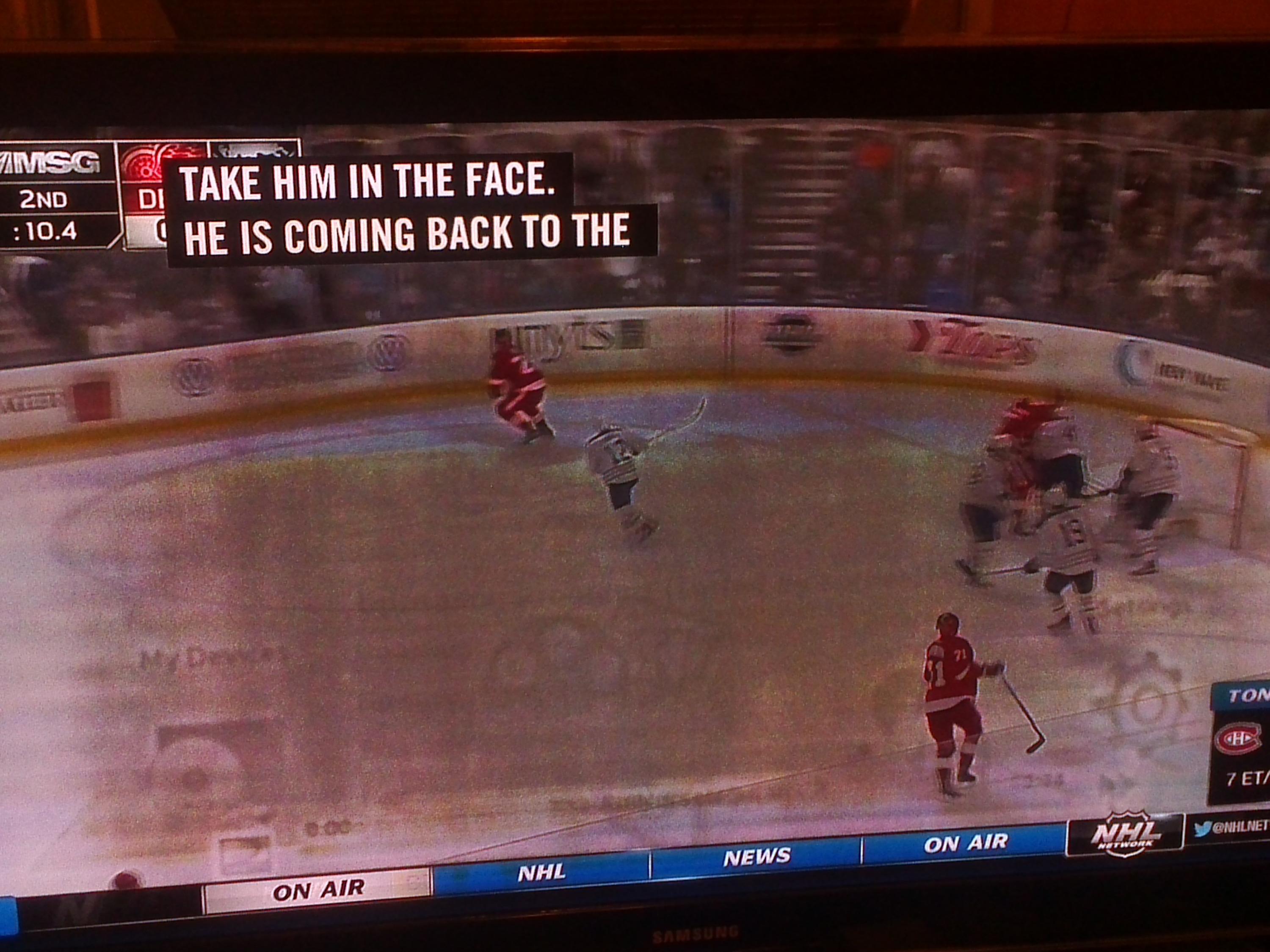

    I have a Samsung pn50b860y2f plasma TV that runs perfectly until the smps board (part # bn44-00277a) warms up. All voltages are dialed in as per the label and are stable until the smps warms up (roughly 5 to 10 minutes after power up) Vs and Va measure a stable 207v and 56v respectively. Once the smps is warm however, the two voltages drop to 182v and 50v and the screen become darker and has temporary ghosting/image retetion issues. I assume this is from the drop in Vs and Va voltages. See images for screen shots of image problems. If left on, the TV will display ever darkening/smuged images and will shutdown after 10 to 15 minutes of operation. If left to cool off, the entire process repeats. X, Y and both buffers have been swapped out with verified working boards and I've eliminated them as possible faults. I have a verified logic board as well but am reluctant to install it for fear of firmware issues and because its location makes swapping it out a ridiculously difficult task. However, I will swap it out if advised to do so. I've checked temperatures of caps, transformers, heatsinks, and pretty much all of the obvious components and nothing rises above 85-90 degrees Fahrenheit. I've also removed all heatsinks and reinstalled them, verifying proper contact with each component. Whatever is "overheacting" is doing so at what appears to be sub 90ish degrees Fahrenheit.
    If I leave the back cover of the TV off and use ridiculously high cfm 120mm fans to cool the area around heatsink 3 ( see attached schematic) , I can keep the issue from occurring if the ambient room temperature is under 72ish degrees Fahrenheit. I've checked the transistors and caps in this area and all appear OK with no line voltage applied to the smps. As far as tools for diagnostics, I have a DMM and a m12864 LCR-T4 ESR tester at my disposal. Unfortunately, I haven't taken the plunge and purchased an oscilloscope yet. Any and all advice is welcomed.

    Possibly a X/Polly cap failure these become heat intermittent, got images of the board ?

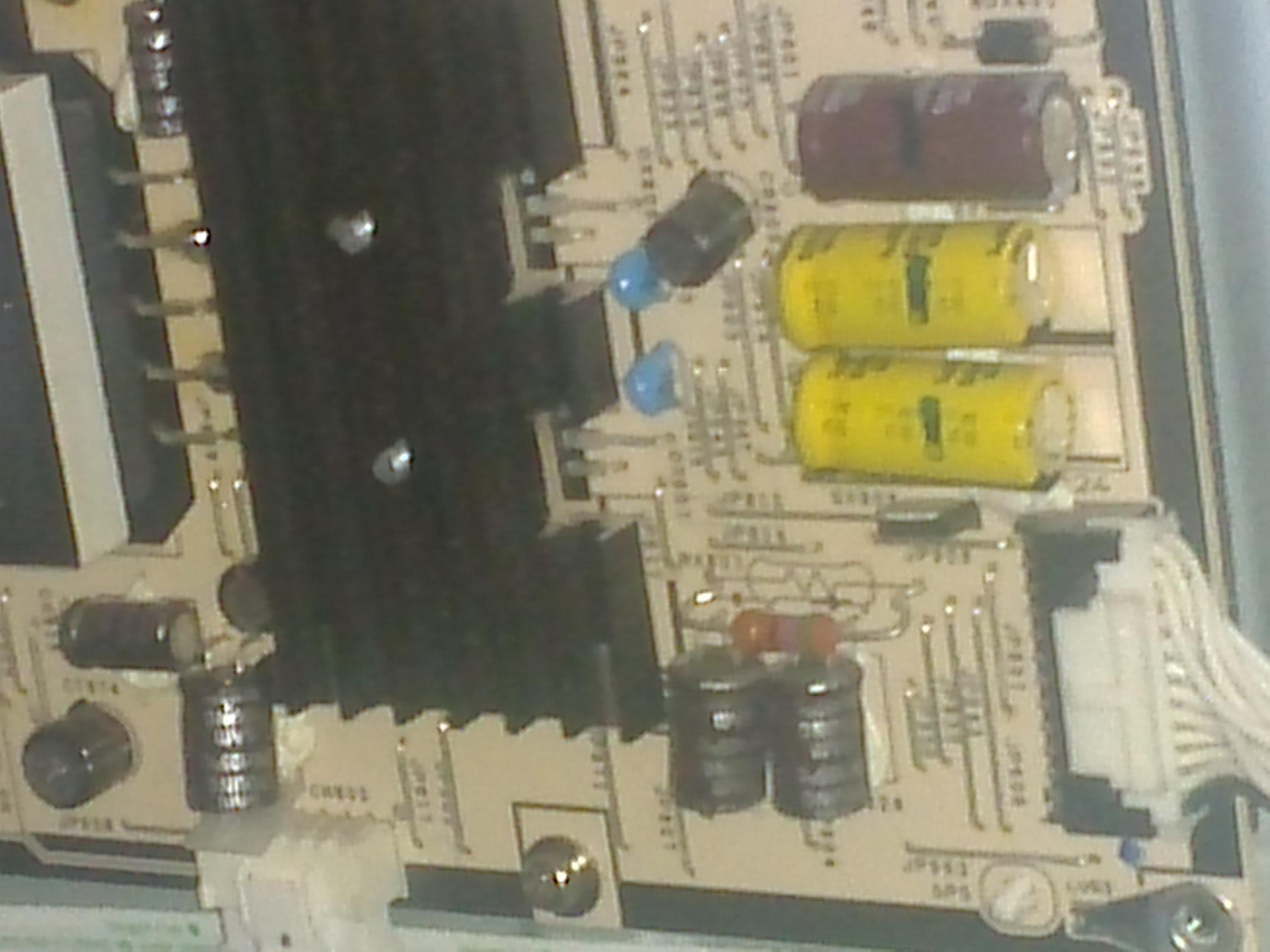

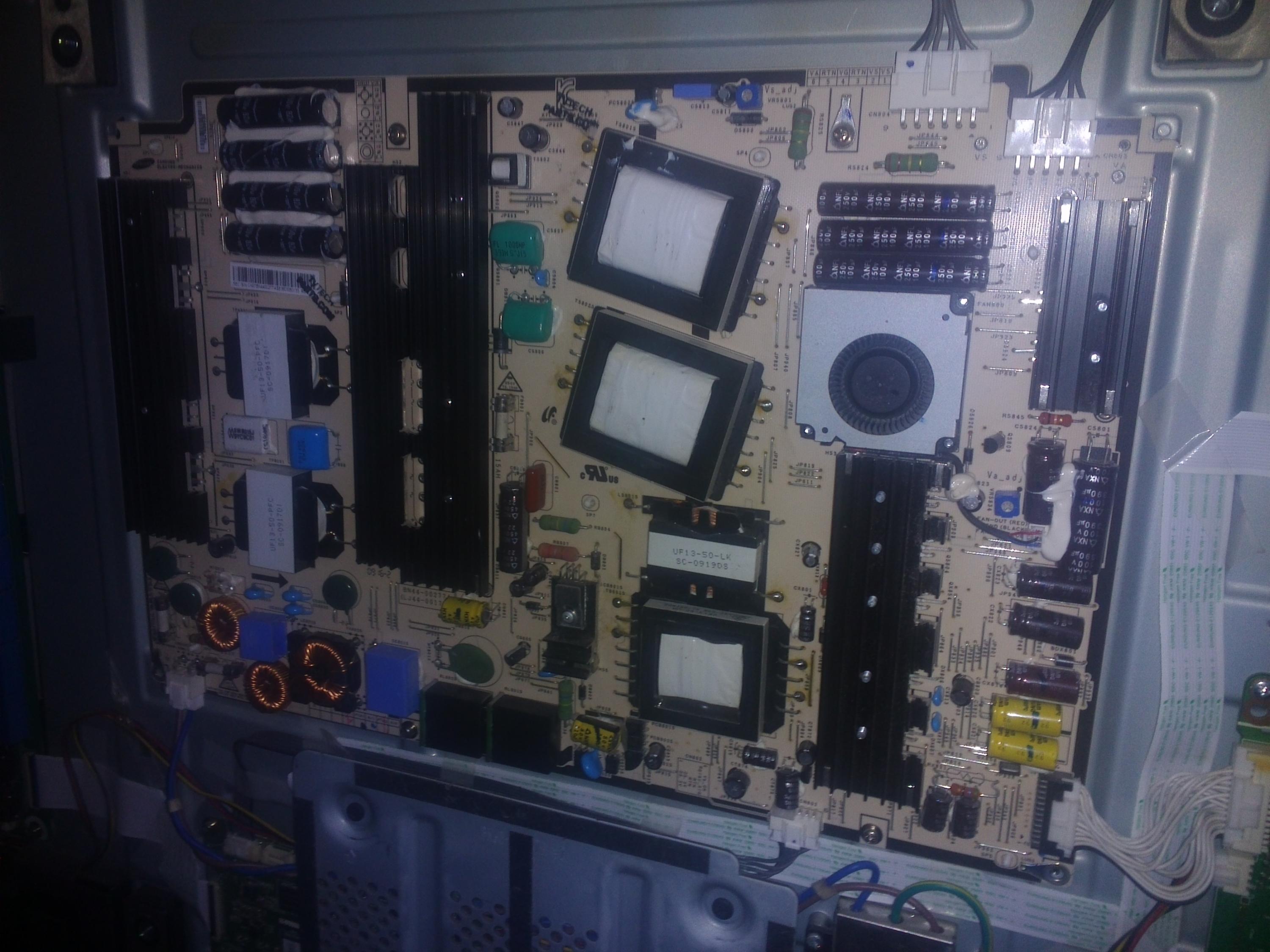

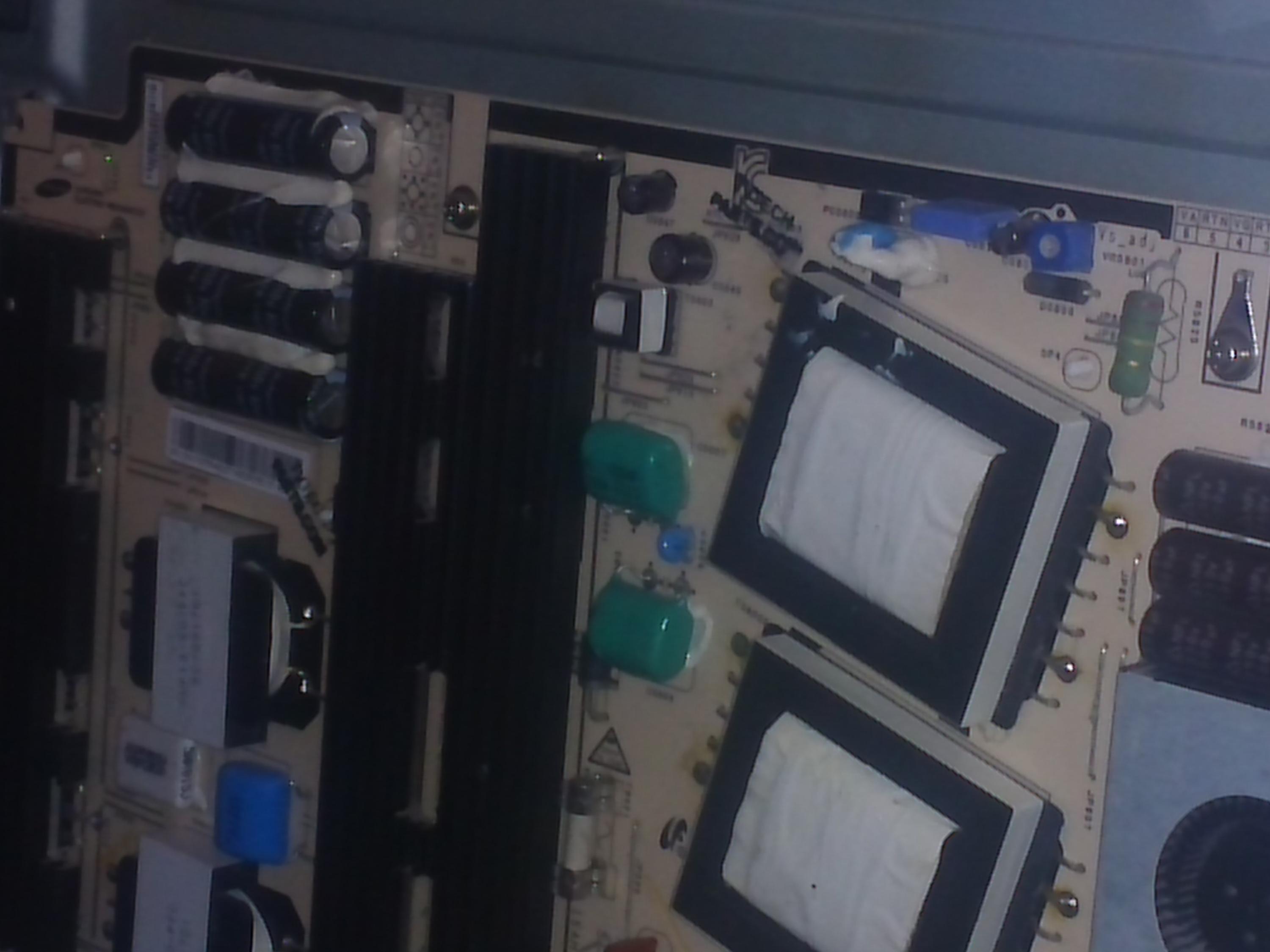

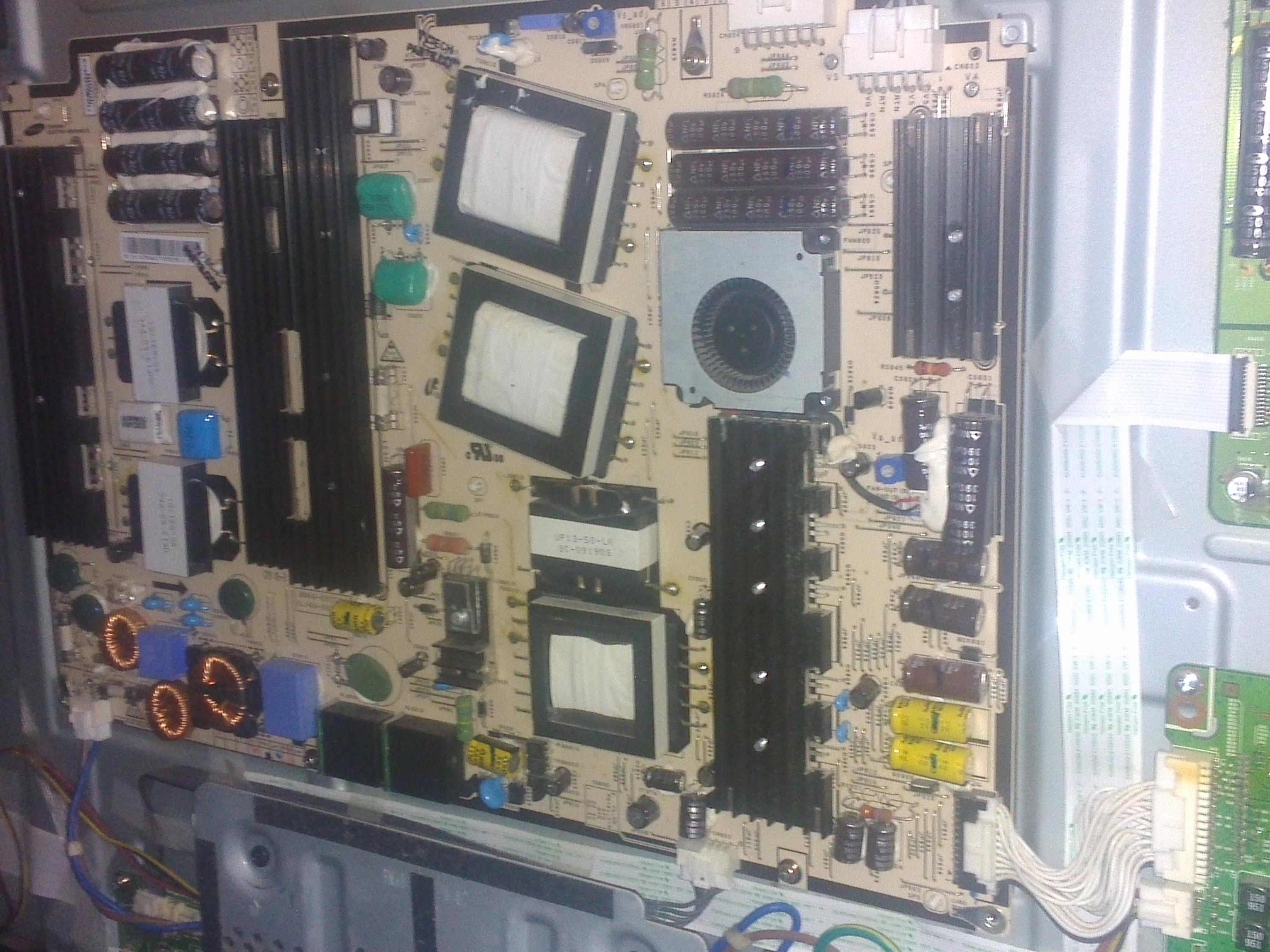

      Here are some images of the board.

                I finally had some free time to troubleshoot this further. I've found that mosfet QS801 is overheating. If I keep it cool by a fan or by freezing it, VS and VA are stable and the picture is wonderful. If cooling is removed, VS and VA begin dropping within a minute or two and my picture quickly turns into the examples in my original post. I've cleaned and reapplied new thermal pads and have tried artic silver thermal paste ( without the pads or course) , neither solves the problem. I've also changed out the MOSFET and the new one overheats as well. I'm at a complete loss here. I've attached the schematic and have circled the MOSFET that is overheating. It is on page two, titled VS BLOCK. Any and all help is greatly appreciated.
