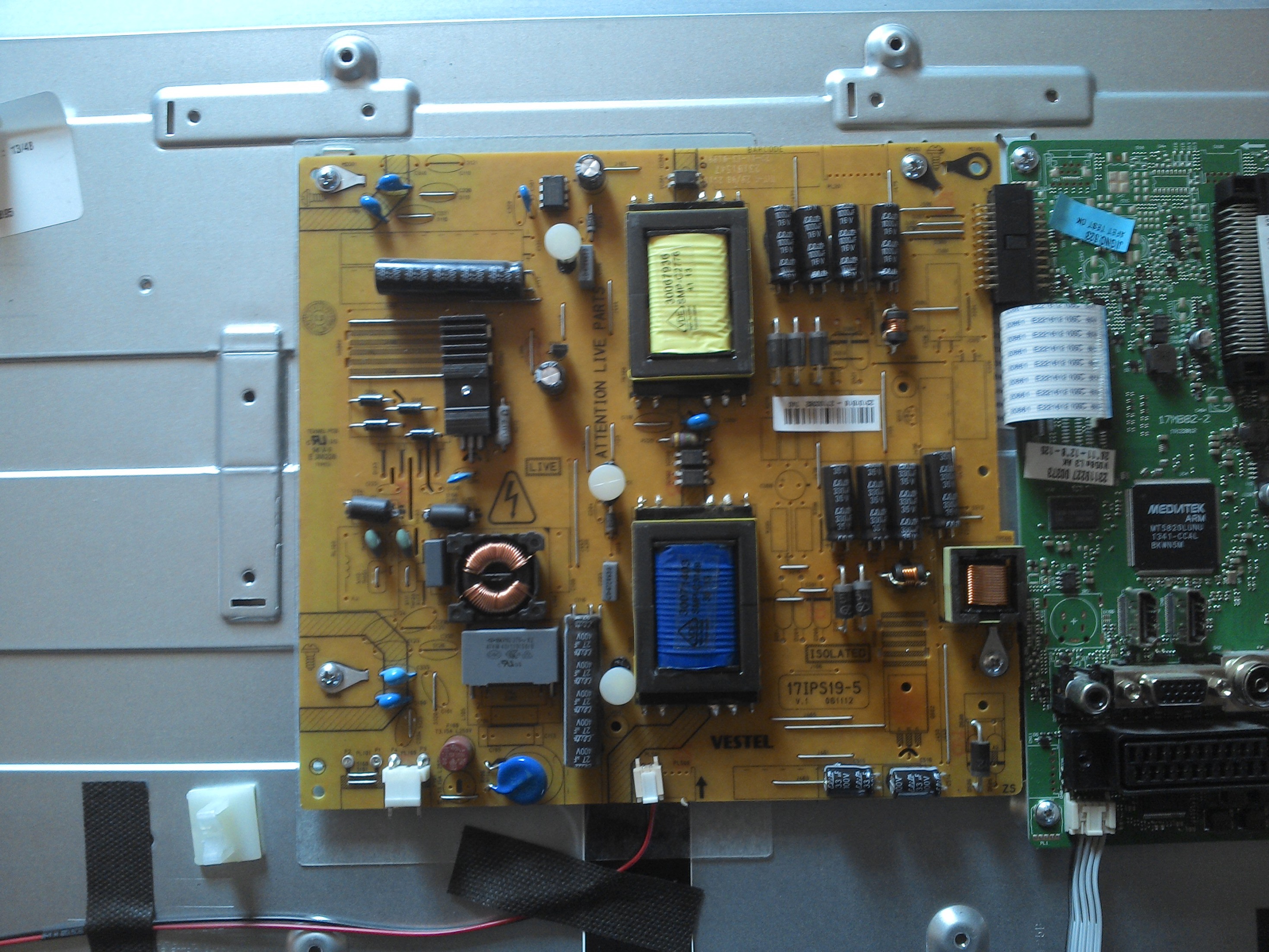

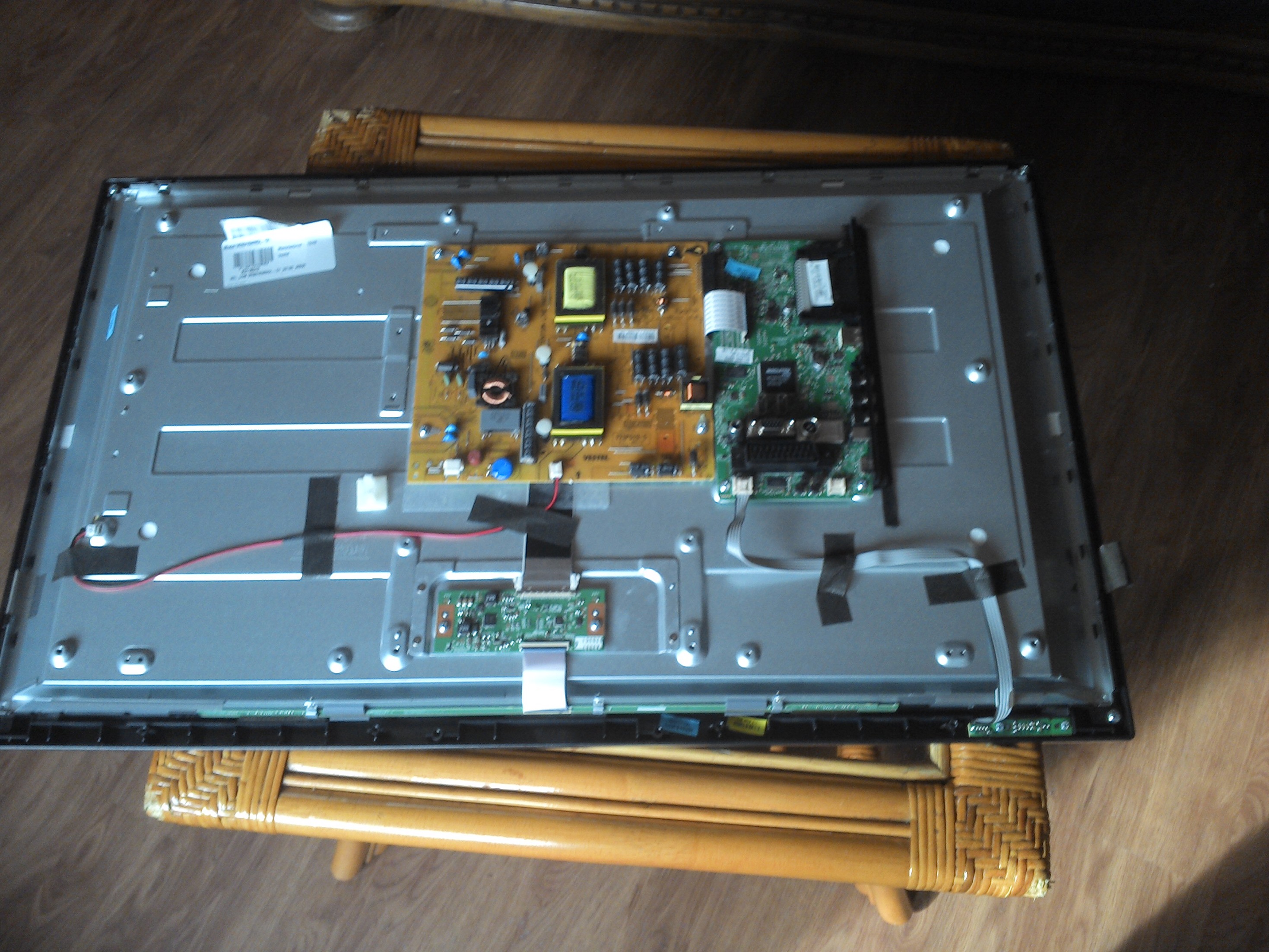

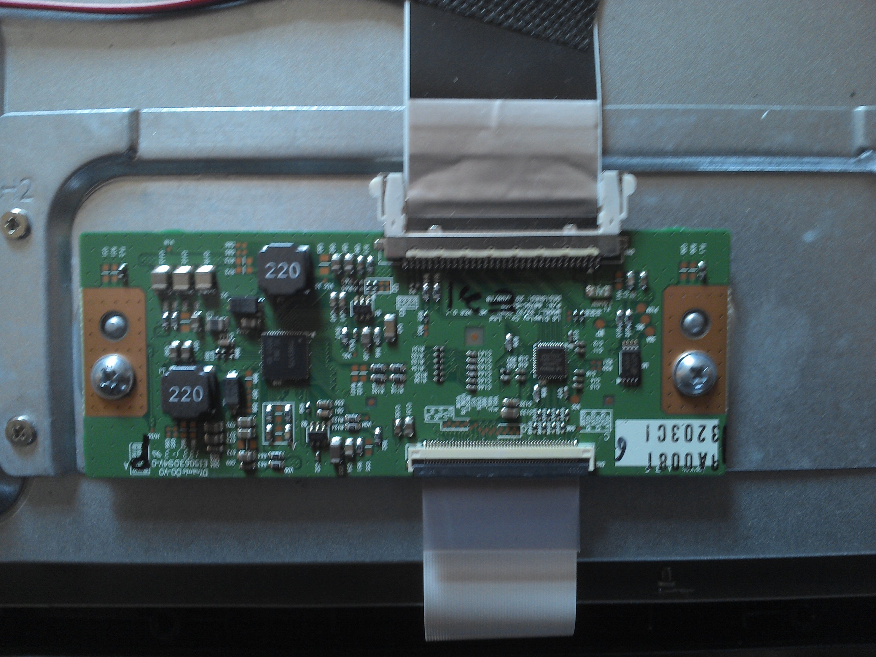

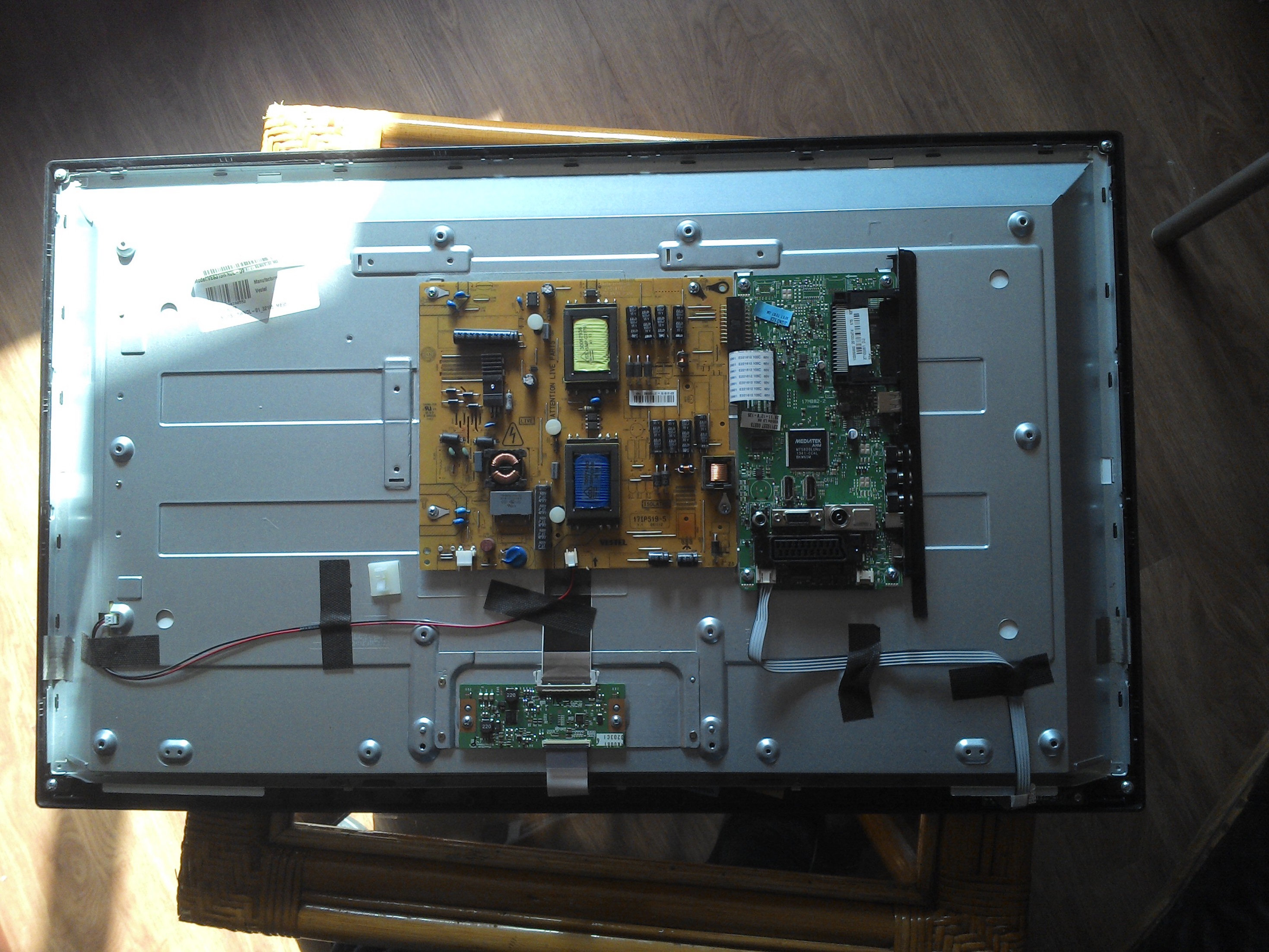

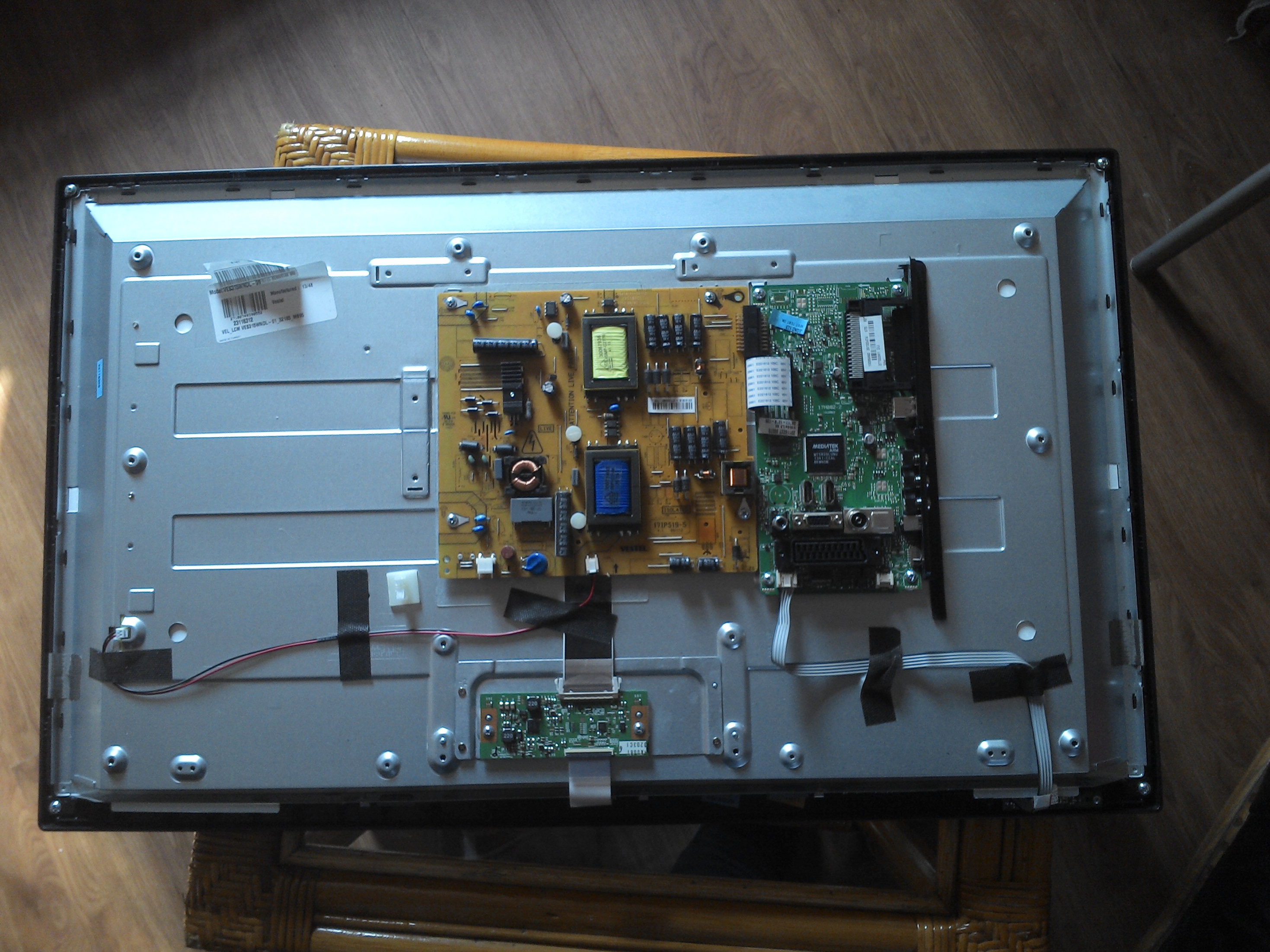

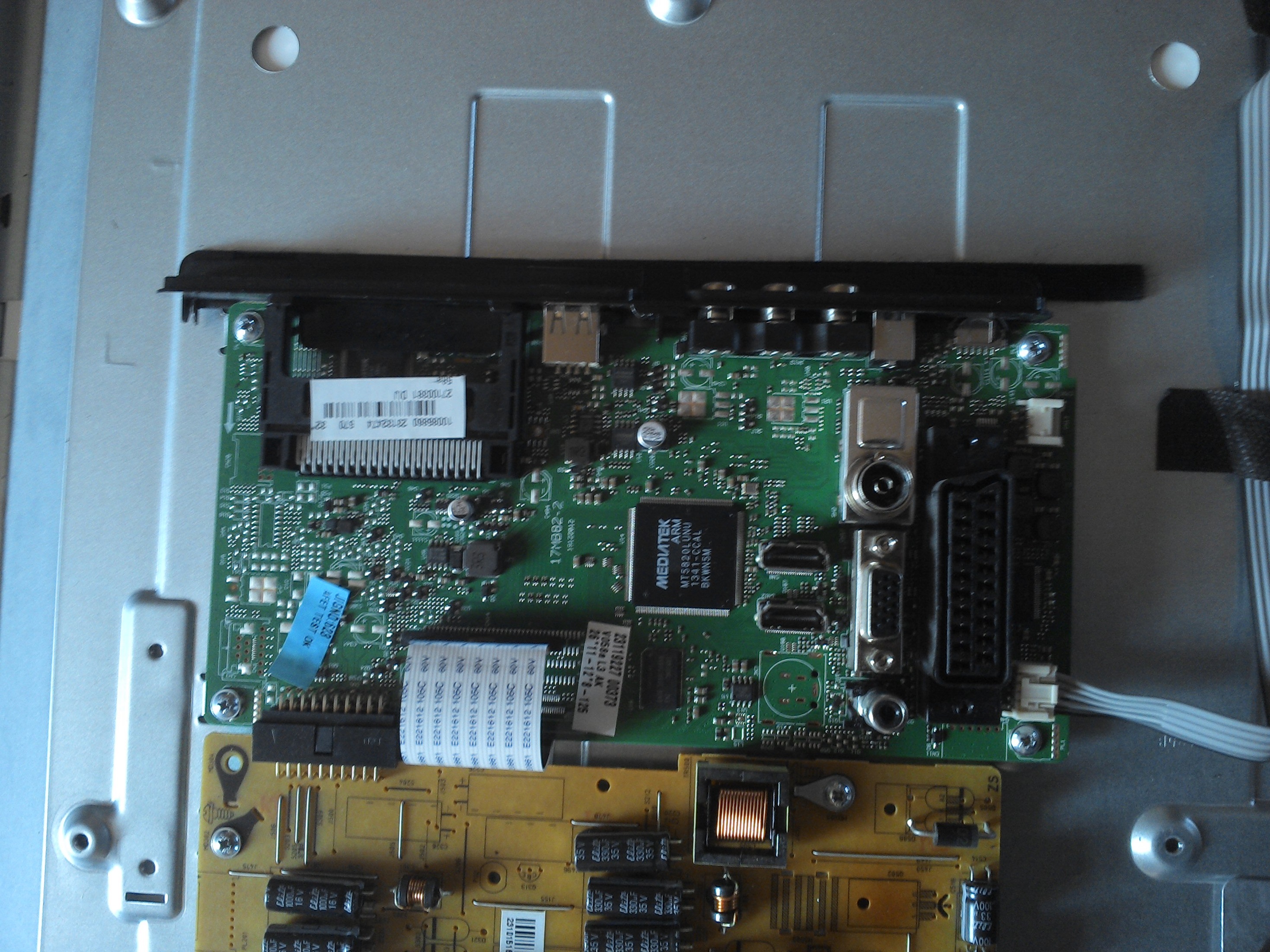

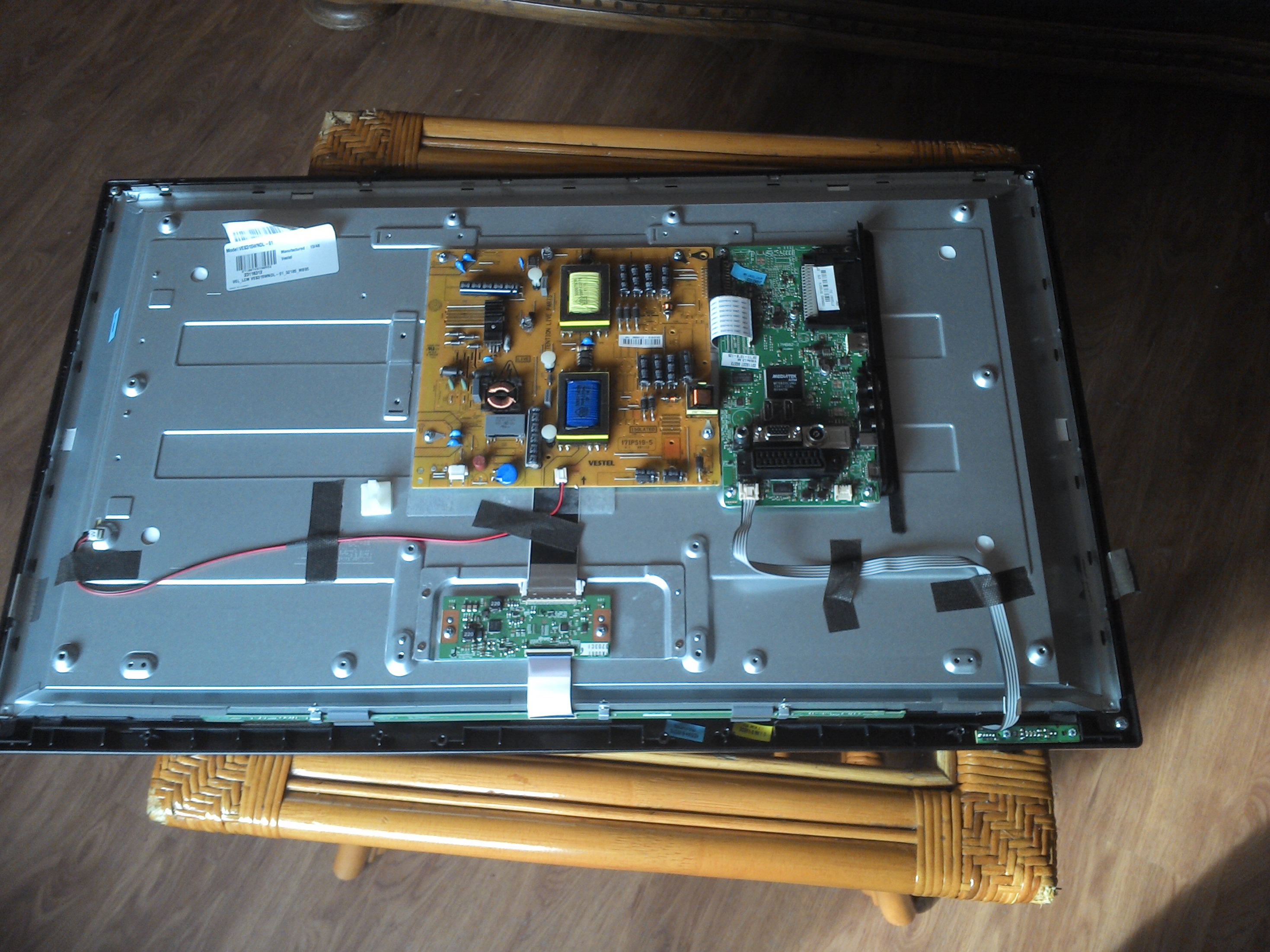

    I need some help to fix this tv, when you turn it on the backlight comes on for a split second then goes off and stays off. When I shine a light you can see the picture and the sound works too. I fixed 2 tvs before with help from this forum but they were both to do with the psu and involved soldering a couple new caps in. Seems like this is the inverter board? but im not sure where it is. ive taken some pics and im wondering if its that small board under the psu?

    not sure if you have read any of these threads but some have some voltage test points so maybe worth taking some and going from there
    https://www.badcaps.net/forum/search...archid=5804621
      Re: Hitachi 32HXC01U A backlight problem
      Possibly and open Led or Psu fault. Check out what Vince linked.
