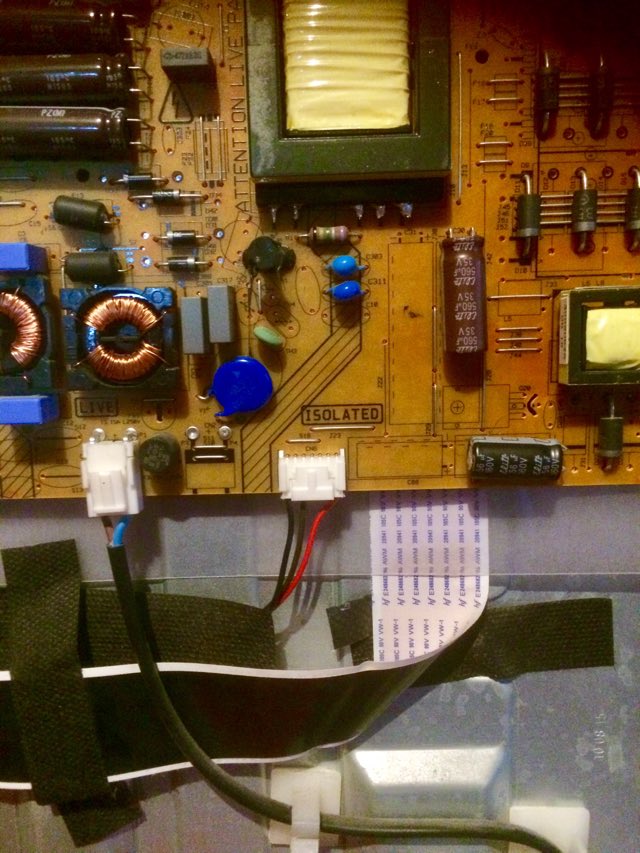

              Picture 1 is showing cn6 - the brown is the third pin from the left

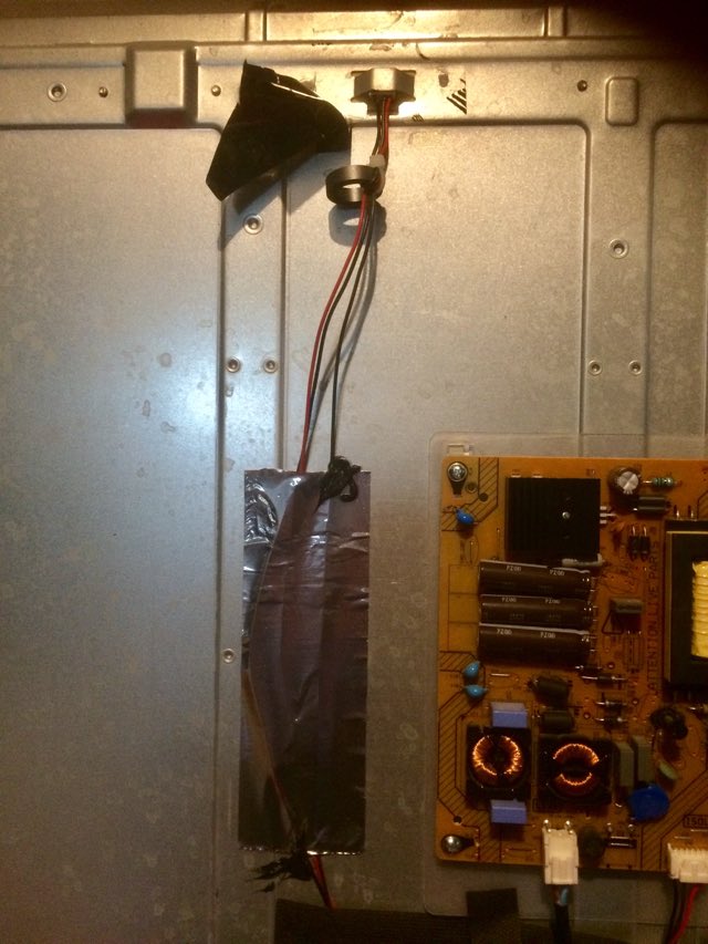

              picture 2 shows where it runs

                The black wire (pin1) is the led supply voltage to both strings (V_led+), the brown (pin3) is the return for one string (LED2_S), the red (pin7) is the return for the other string (LED4_S).
                Check the voltage on the brown wire.

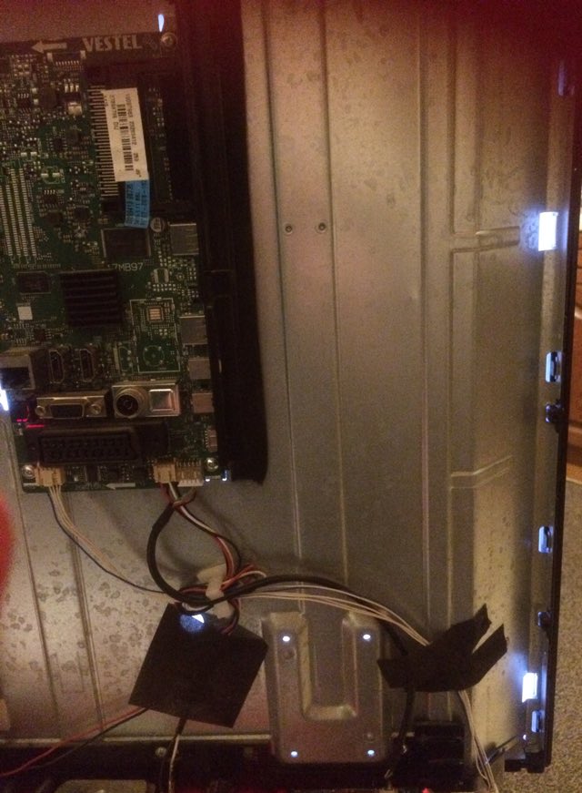

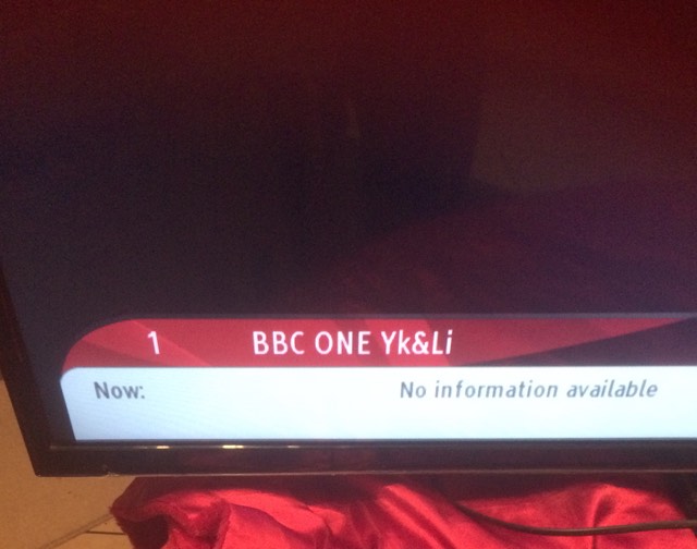

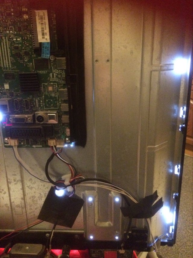

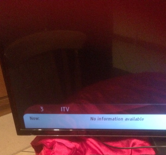

                  The brown wire reads zero - dim or bright
                  Have attached some pics of how dim/bright it goes
                  Stayed bright for alot longer tonight - maybe because it was from cold ?
