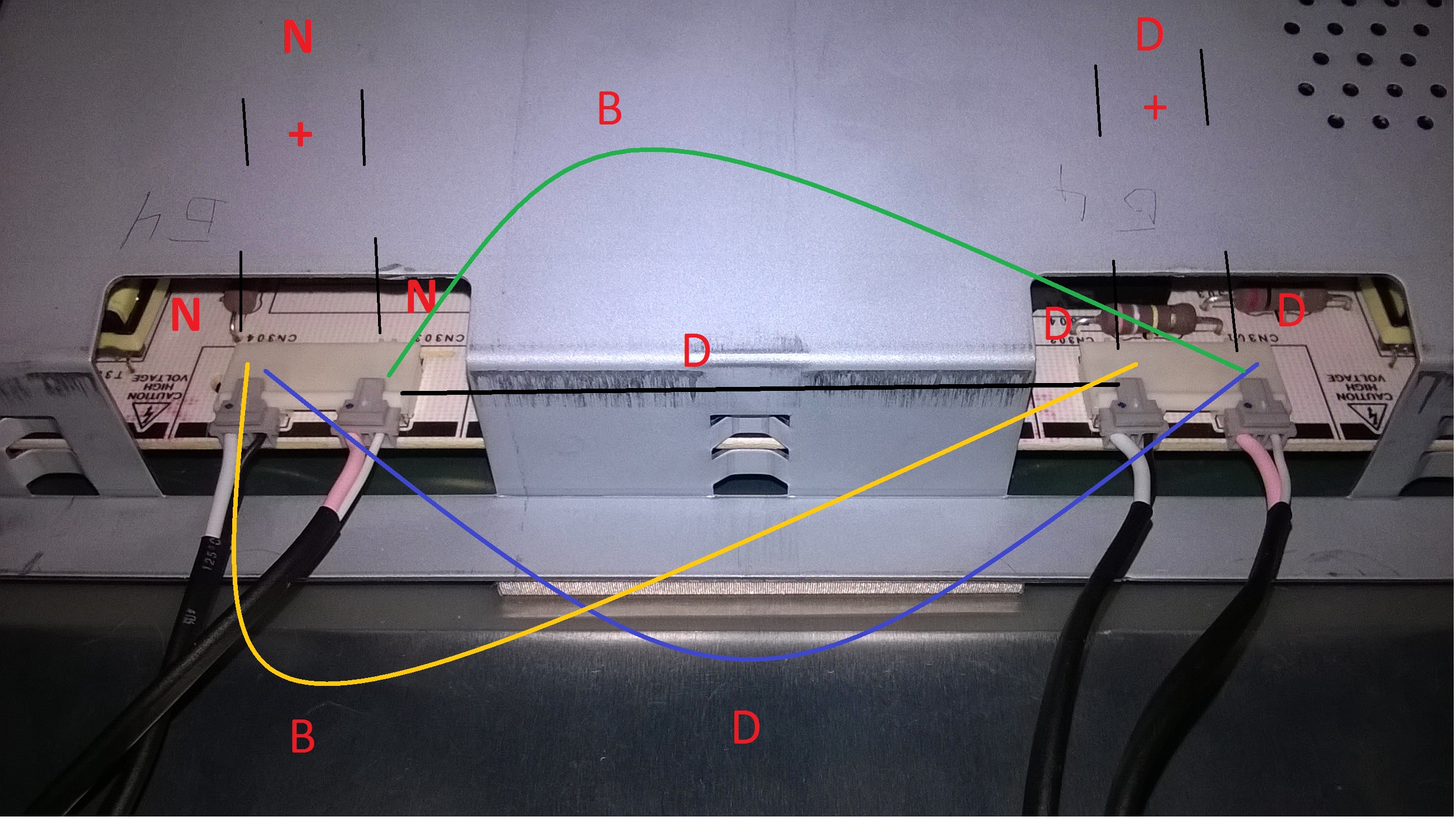

        After some further investigation I decided to take some measurements of the power board and try to diagnose if one of the power trails to the ccfl lamps is not providing sufficient power. I tried to connect 2 connections at a time and all the results are in the picture, lines indicating the connector that were connected and the letters indicating the brightness of the display the second it boots up (after which it turns off as I previously explained). Abbreviations for the letters: N-none (no backlight at all) ; D - Dim backlight ; B - Bright backlight (same level of brightness as when all of the connectors are in). I believe this is probably not enough of troubleshooting, so please inform me if further testing is needed and what exactly. Thanks!
          Re: Samsung P2470HD Turns off
          The issue was in the CCFL lamp. Will replace it soon and report again :P
            Ok keep us updated.
              Replacing CCFL fixed the issue indeed!

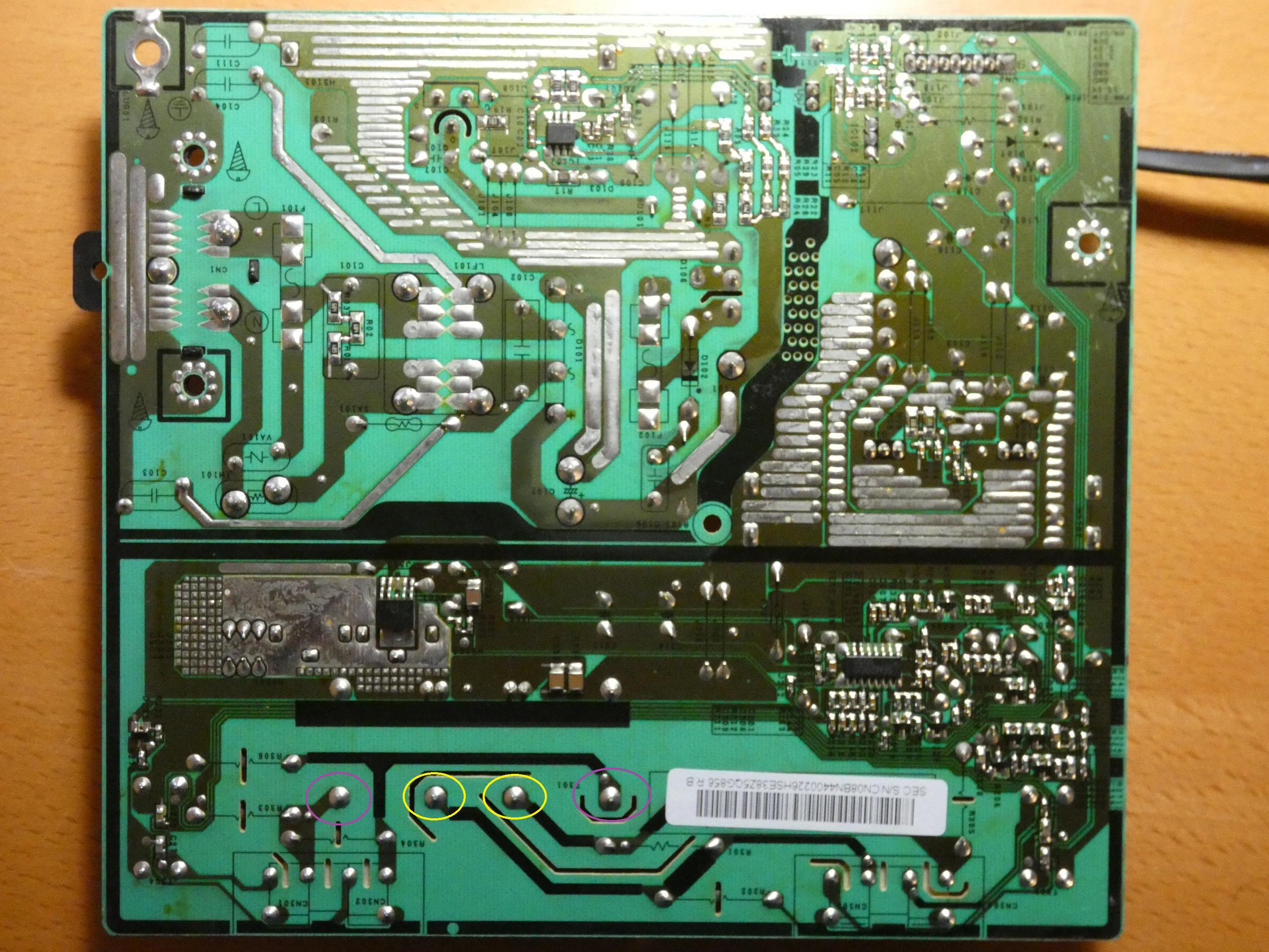

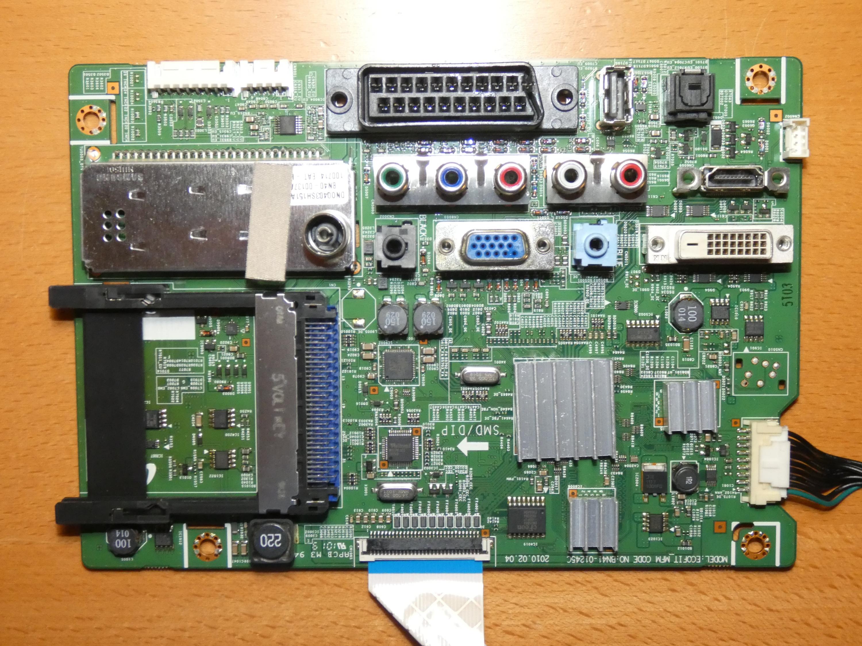

                    thank you for you interest, my problem is that the screen going off after about 2 seconds, if i change channel on TV i continue to hear the sounds but the screen is completely black. If i turn off the screen and turn on again the picture appear again for 2 seconds that disappear but as before the sound still here!
                    thank you

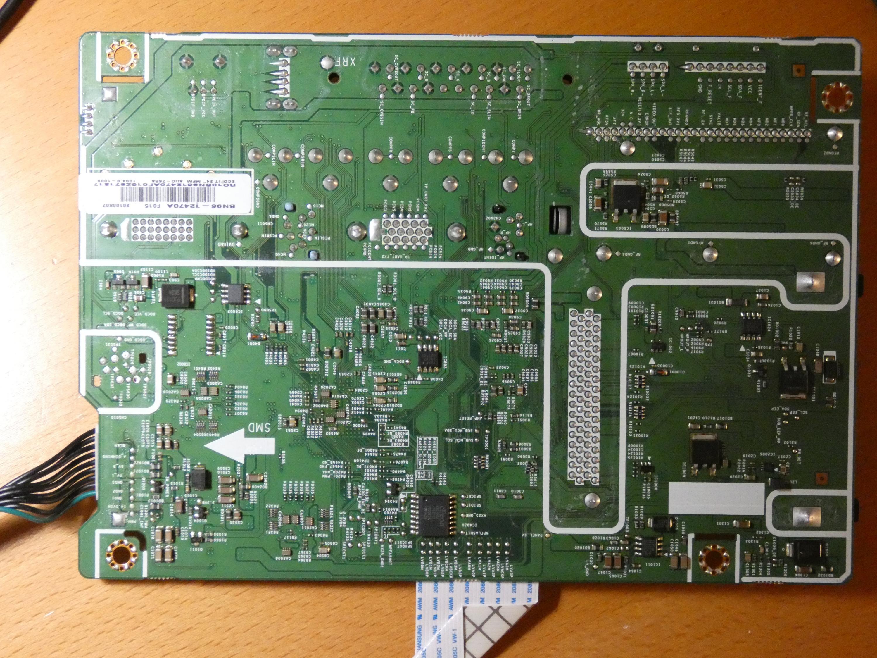

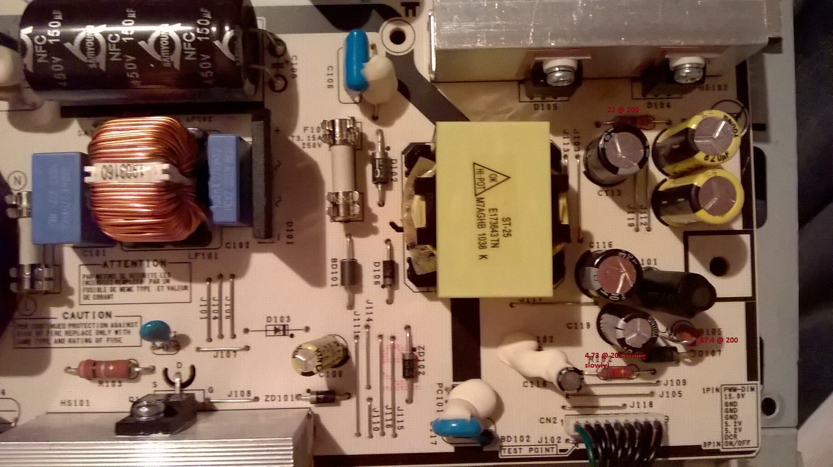

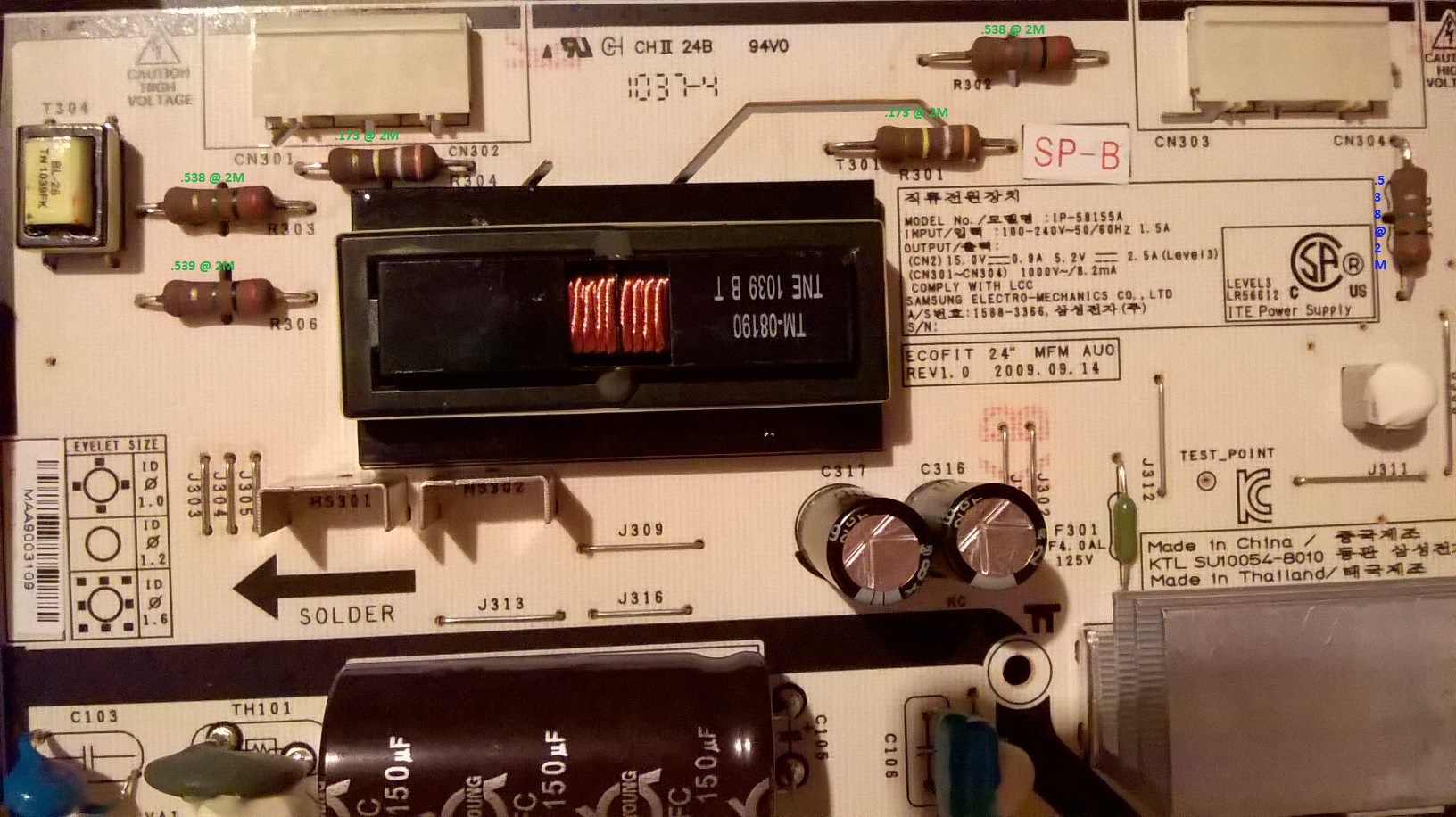

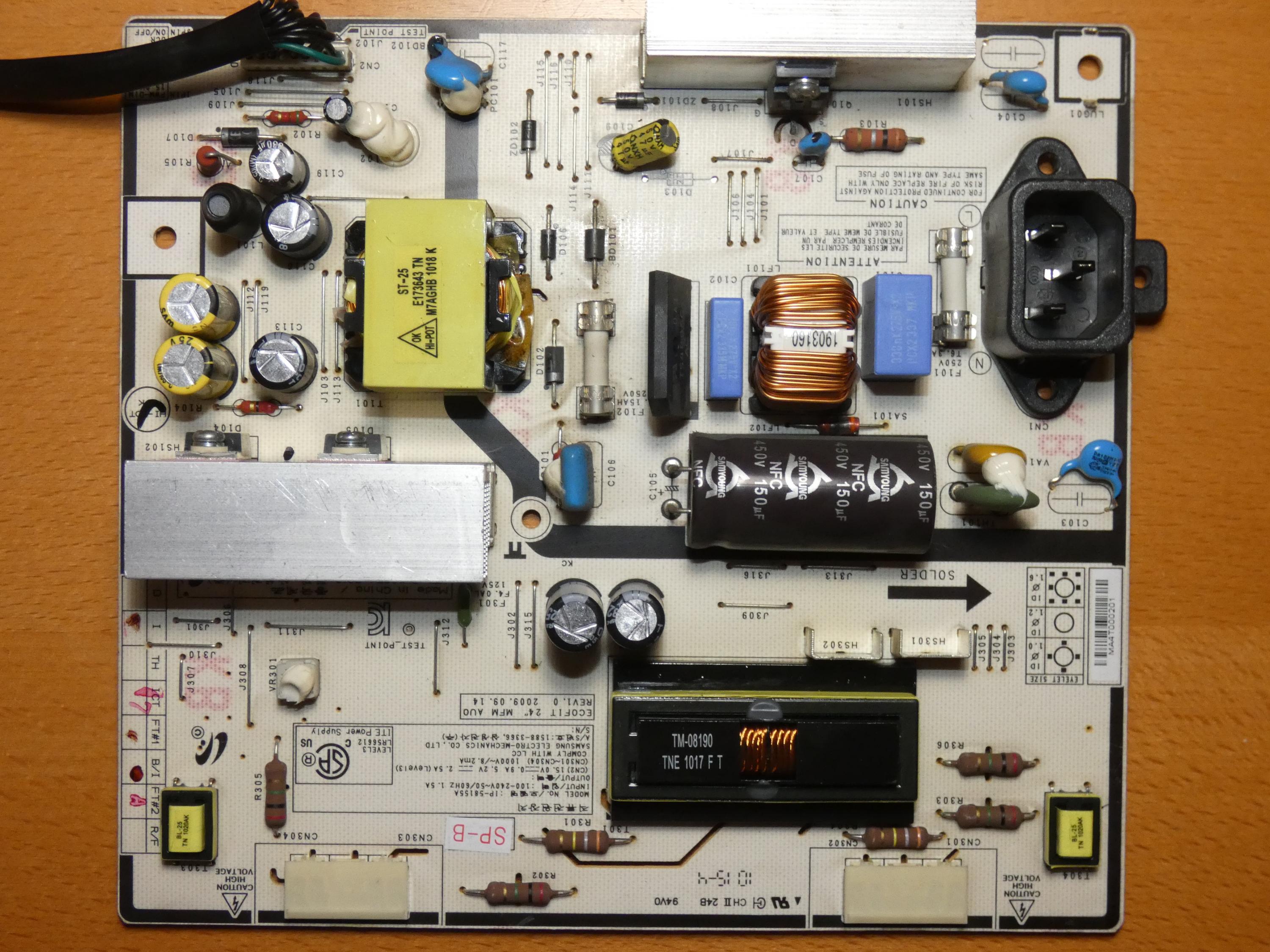

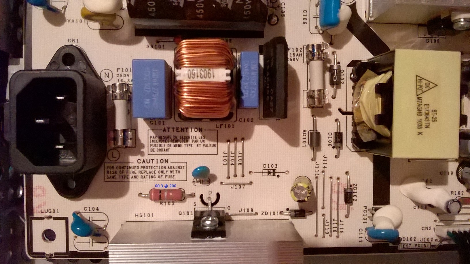

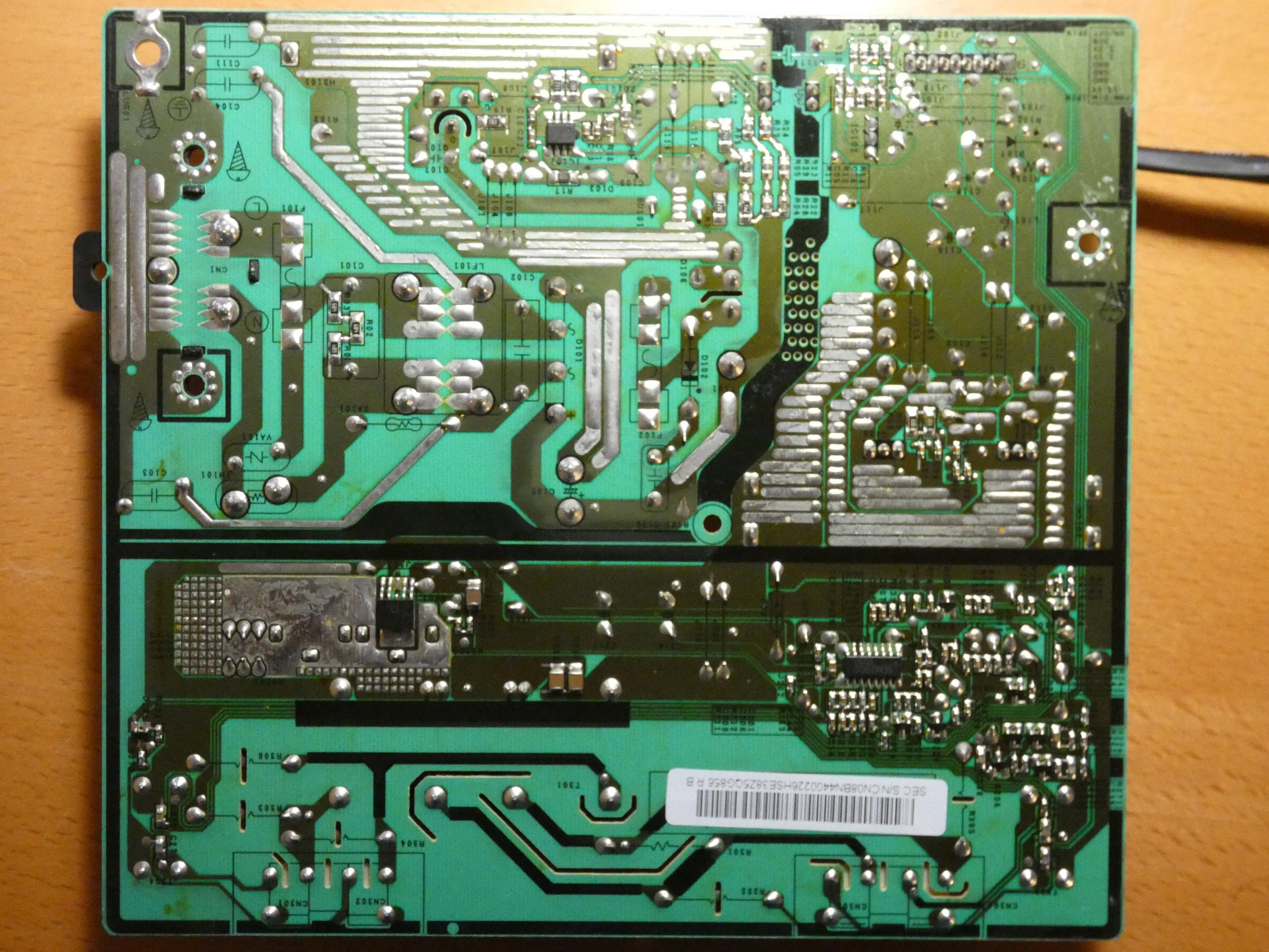

                      Hi, please find attached images as your request, i hope that this can be useful for helping me to diagnose the problem.
                      thank you very much!
                        a pic with all of the boards in the tv would of been good, but we can start from here.
                        i have marked out two sets of pins on the backlight transformer.
                        can you measure between each set of legs, (ohm. set meter to 20k, if it can't read it, increase the measurement till it registers on your meter), compare the two readings and let us know what they are.
                        it has odd output windings on it, normally it would be two left pins v's two right pins. so i hope that i got it right.

                          I just measured the points and for both set I read 175.9K ohm

                              unfortunately not i'm not a "real" repairer.. only an hobbyist guy with electronic skill :P this is a friend of mine monitor that yesterday evening suddenly stop working..
                              There are other measures that i can do to find the problem?
                              In the mean time i see that on the back of power board there is a SEM-2005 that is an inverter driver IC (check here here for schematics).
                              There is something that i can measure here? i don't have device schematics so i don't know what i can check.. I Read around the net that on pin 10 of SEM i must find 15V and on pin 11 something arount 2 volts. Measuring this point i find that with TV swiched OFF (the board outside the TV) i find 3 volts on pin 11 and 0 on pin 10

                                just to be sure.. as ccfl you mean the entire board with the TM-08190 or only the transformer? because the transformer itself cost only 10 bucks so i can buy one to test it..

                                  your transformer is good. i keep several spare sets of backlights to quickly test if the lights in the set, or relevant connections are any good.
                                  there will be a feed back circuit that will tell the ps to turn off, but unfortunately, i havn't had time to look over it that thoroughly.
                                  i'm not the biggest fan at trying to work out combo boards (ps with inverter), but i will try to see if i can give you any leads to go on, and others will chime in, i'm sure.
