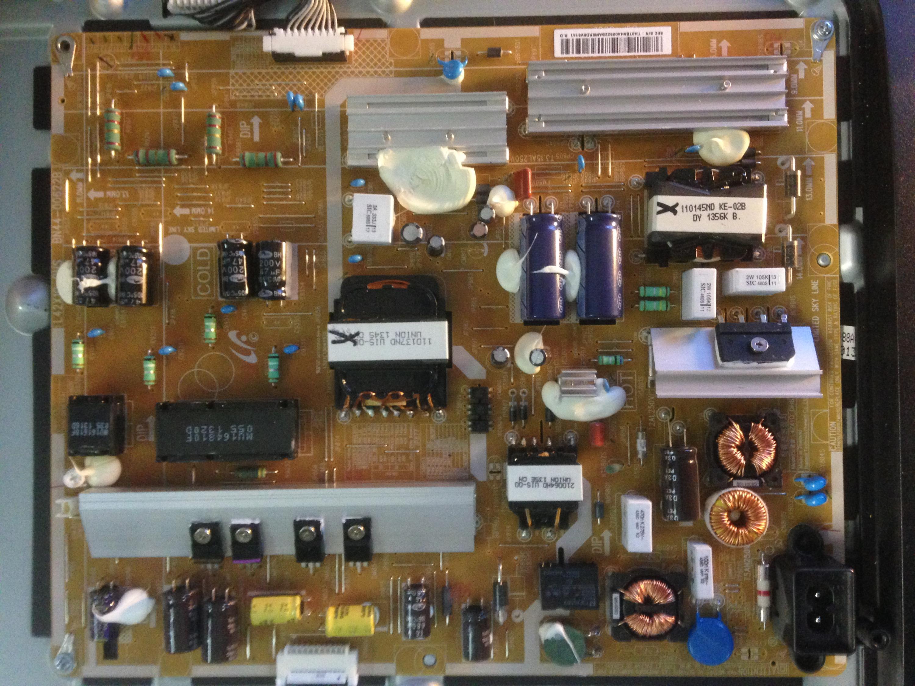

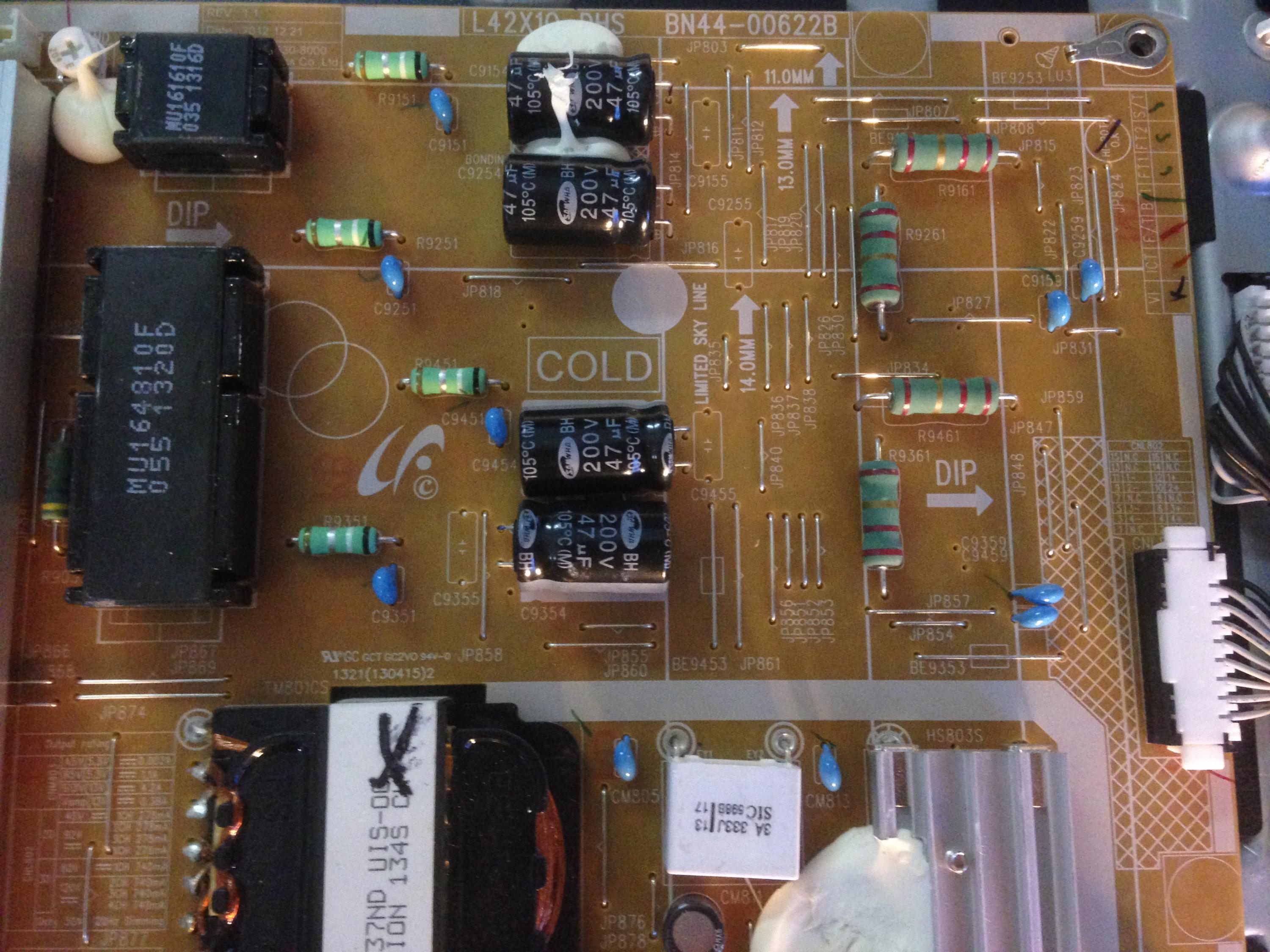

    probably a bad LED. Can we see a clear straight shot picture from your PSU?
      Re: Samsung UE40F6500 No video, has audio
      Power supply/LED driver board P/N BN44-??????

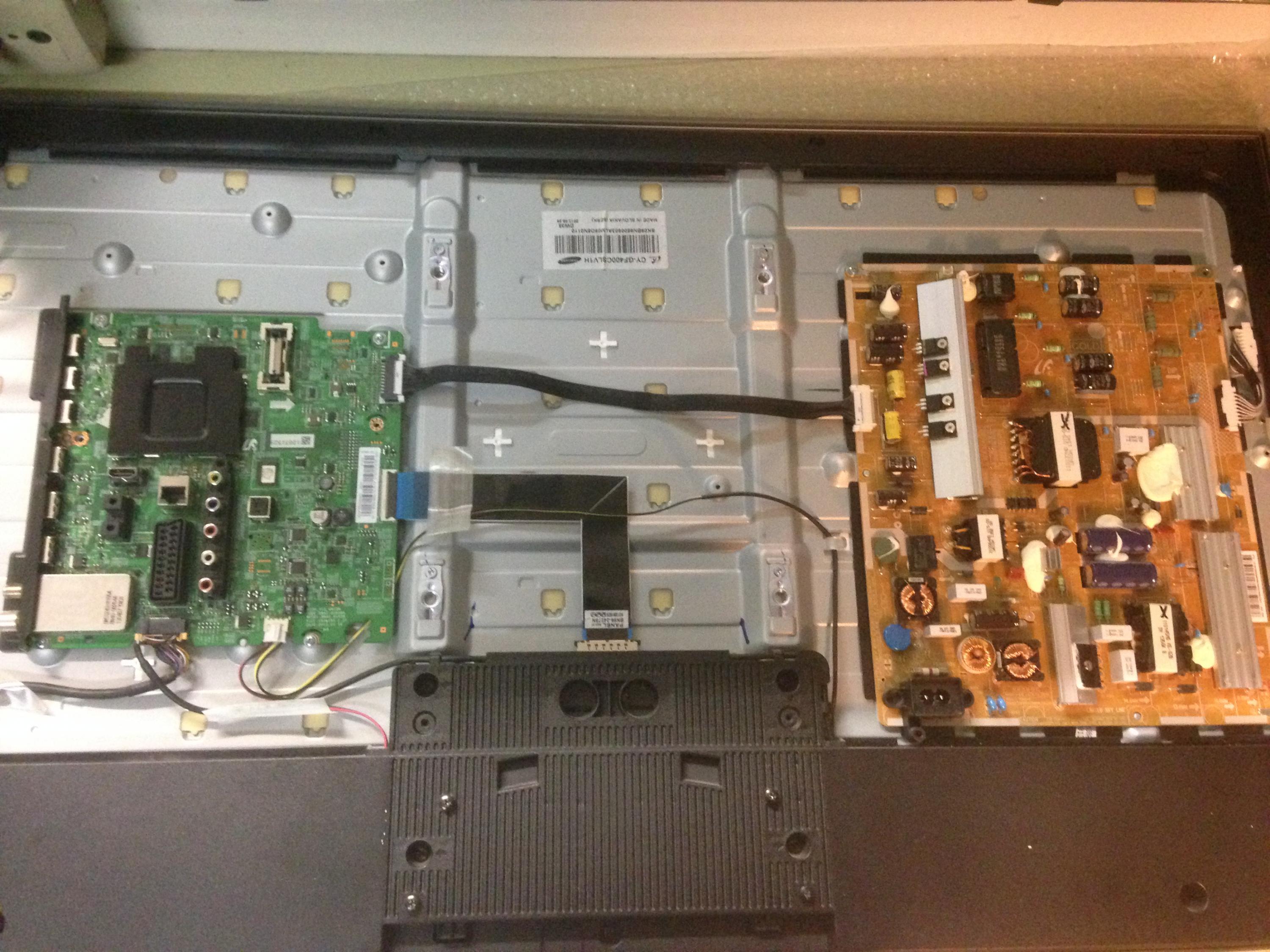

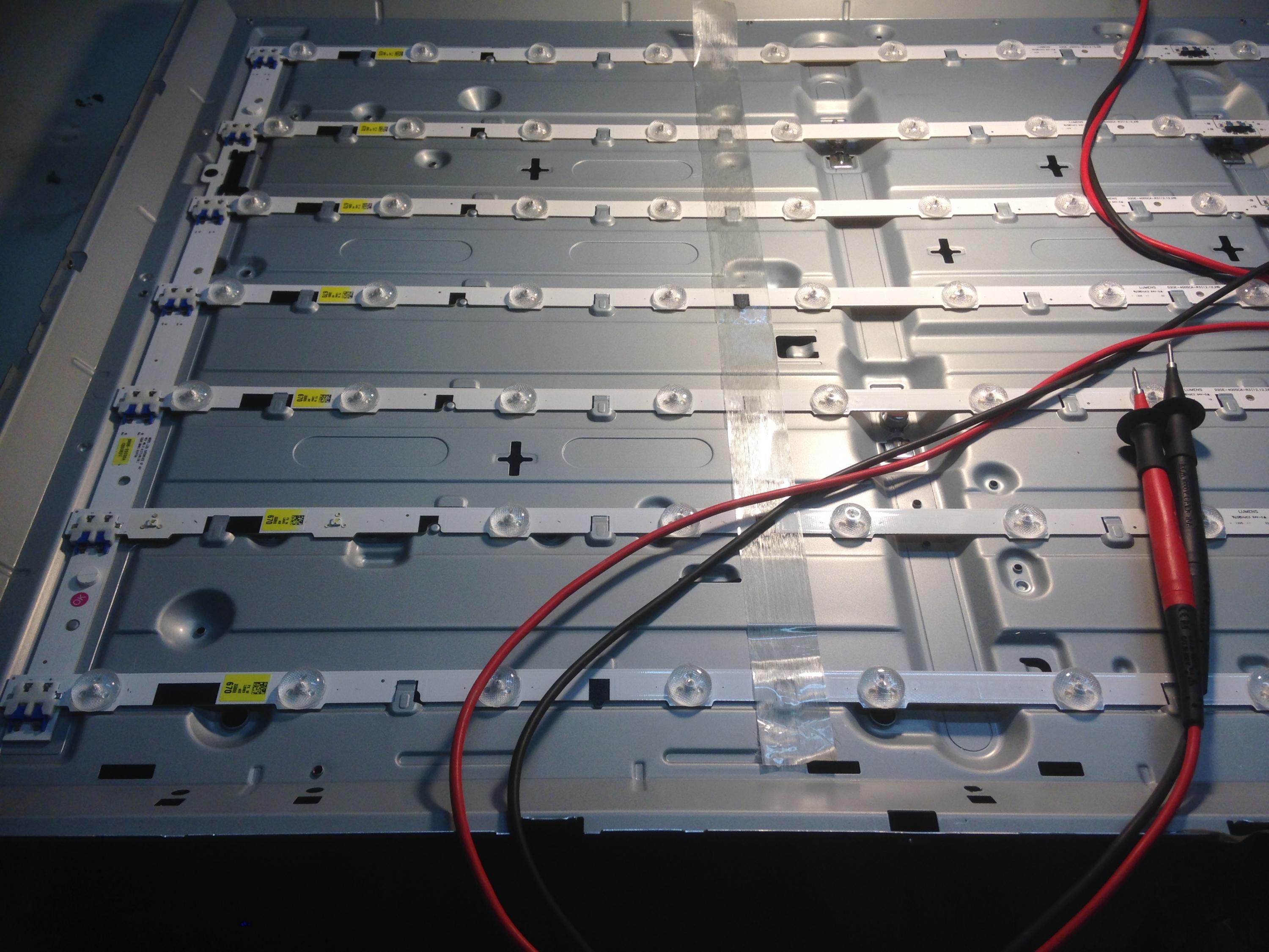

          So i checked the backlight LED's and some are bad....
          but i dont can buy the LED Interface (BN96-25336A)
          have anyone a source to buy the LED's individually
          thankssss

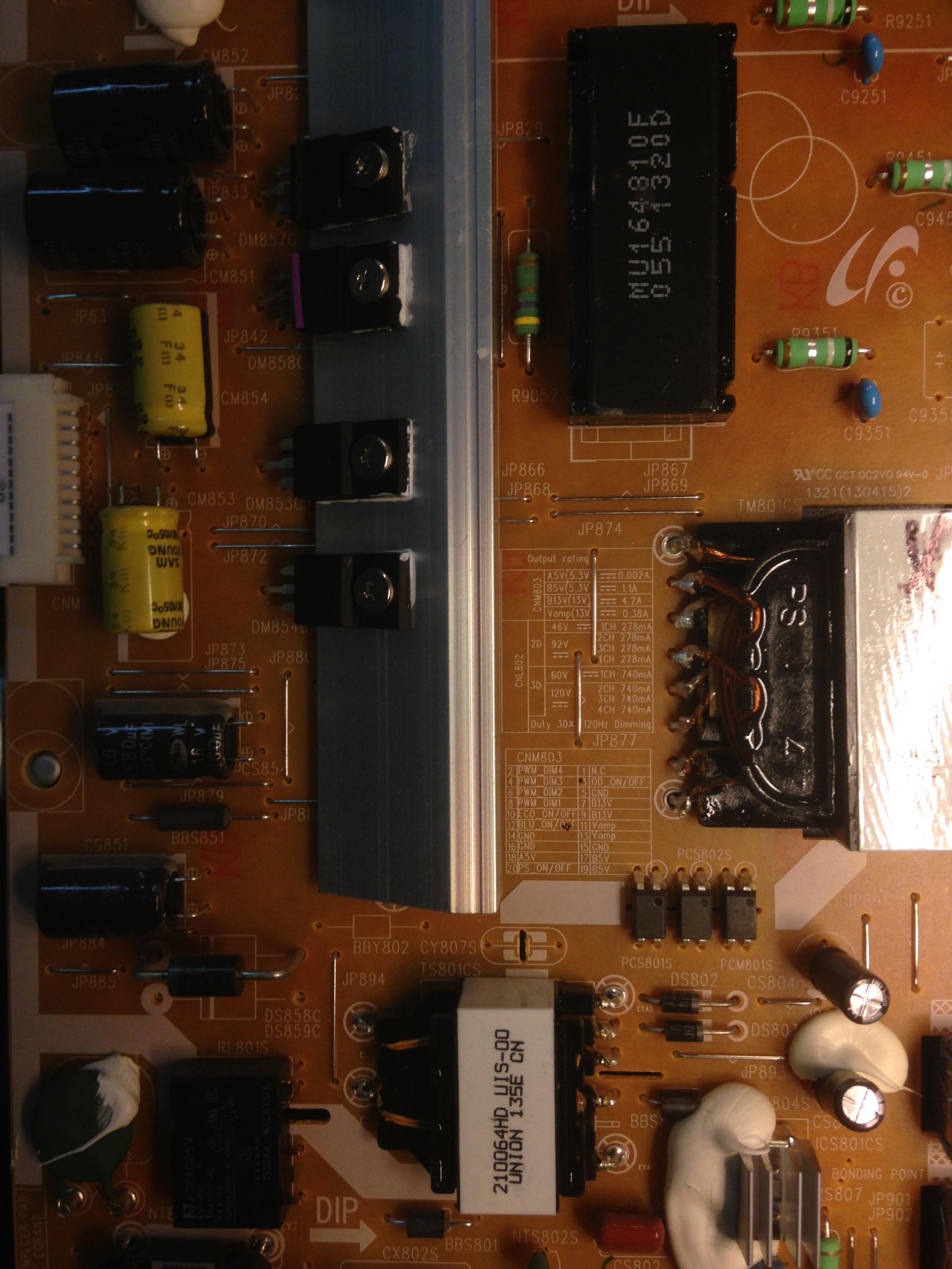

            Picture from my LED Interface...
            so when i change the broken LED with (used) LED's (from other Samsung TV),
            then i think the other (good) LED's would broken also from time to time?
