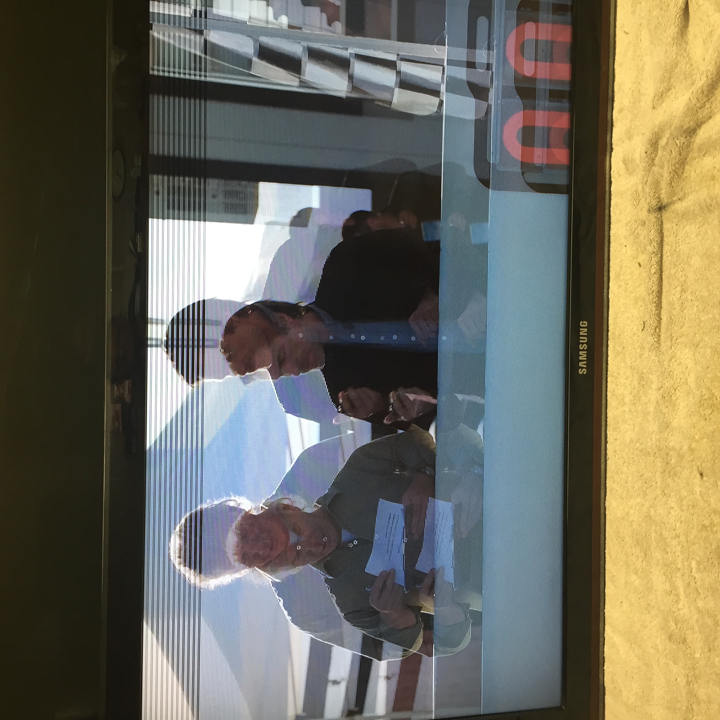

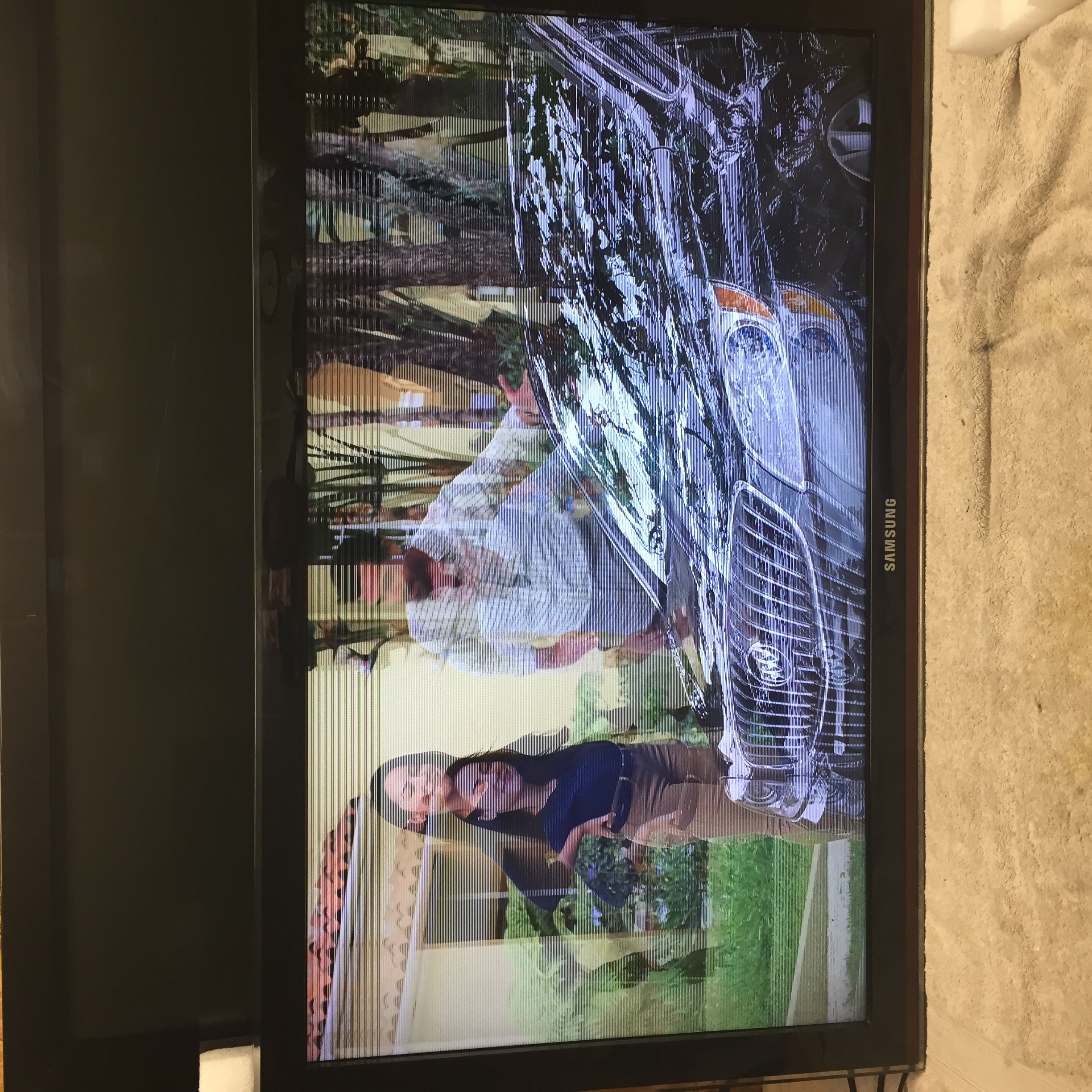

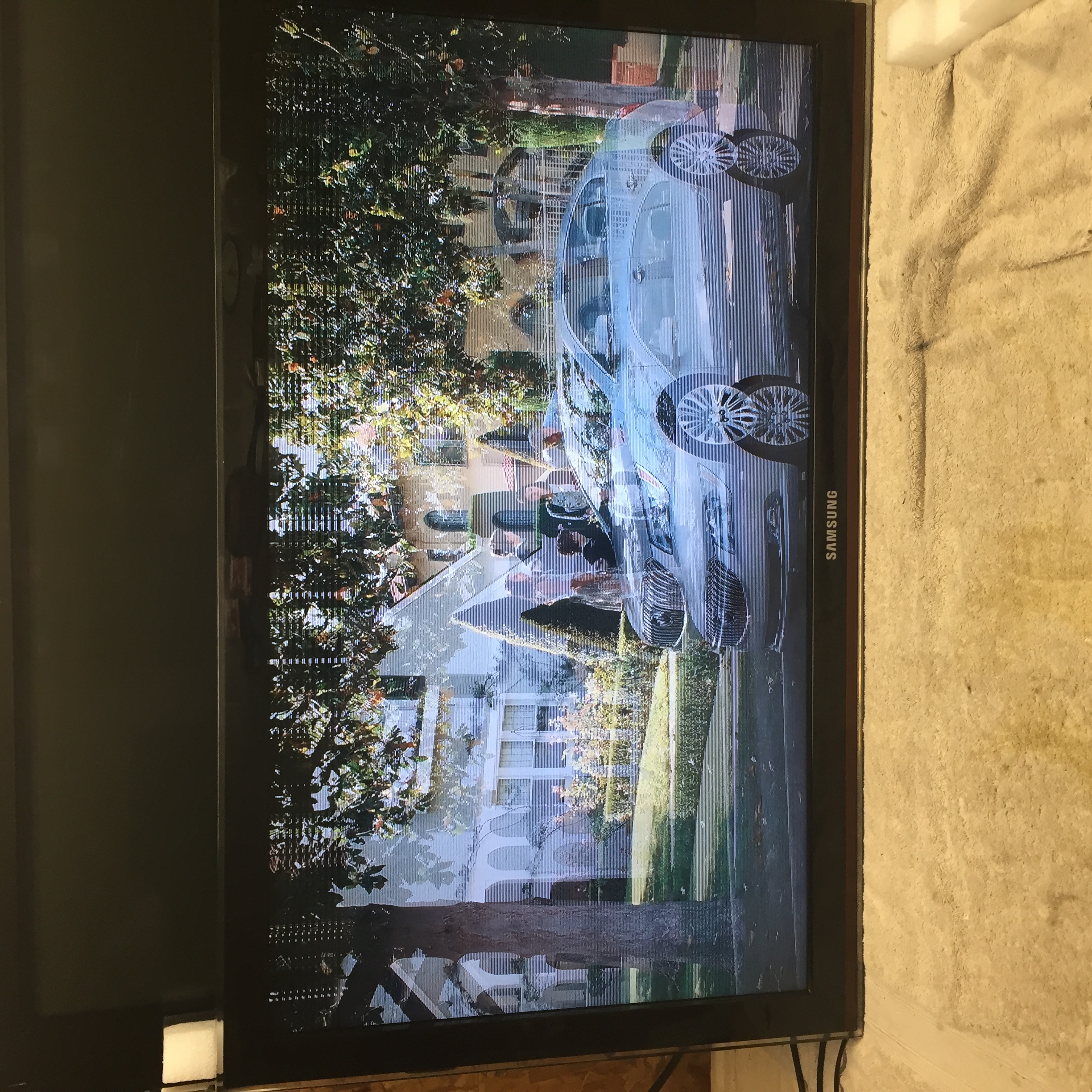

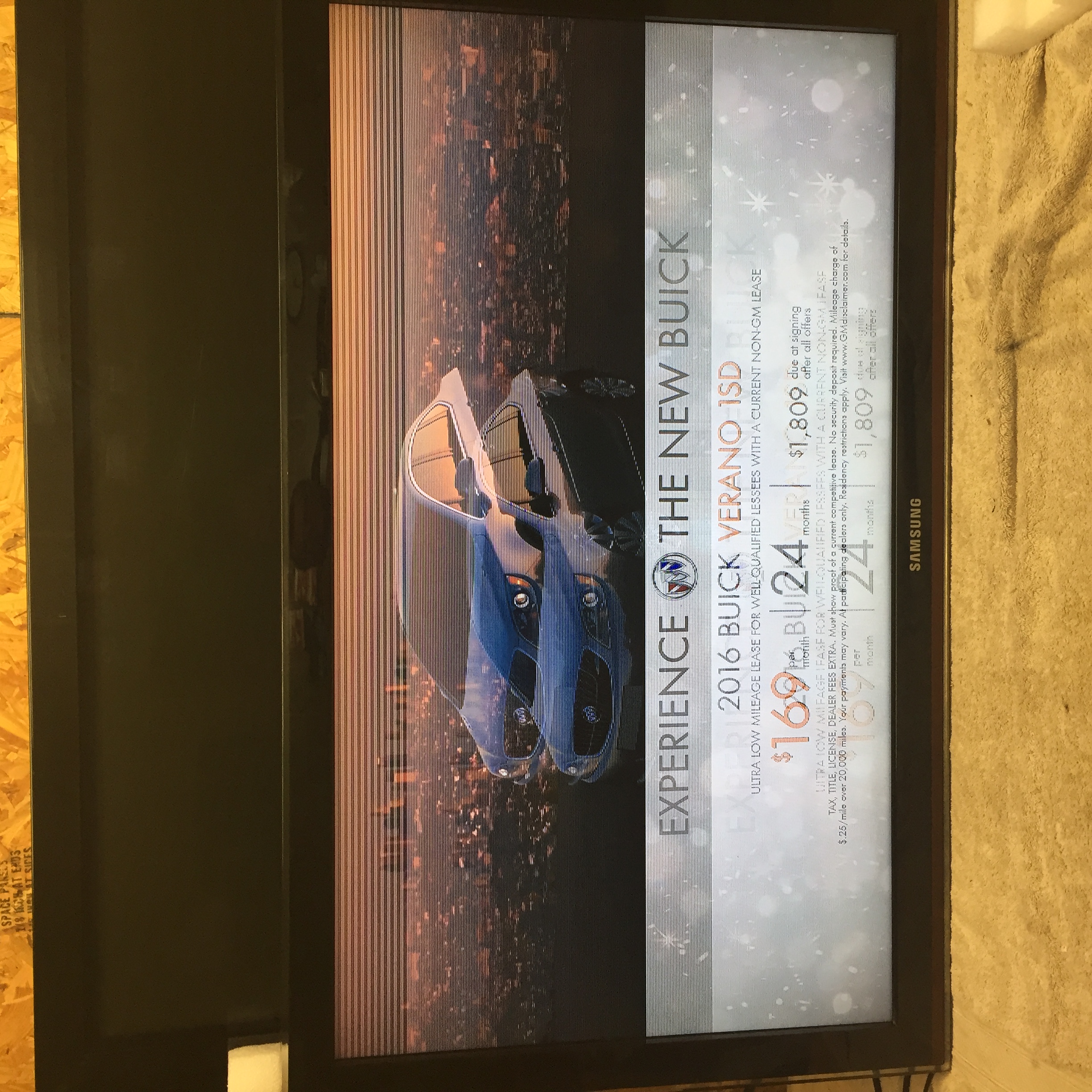

    Samsung 40D630 blurry
    I have a 40" Samsung set that has a double vision picture with some thin horizontal lines. Although when the left side TCON ribbon cable is removed from the TCON board and the right side remains connected the half picture on the right side is perfect. TCON has been replaced with a new one. Can this be a main board problem or tab bond issue maybe?
  • CapLeaker
    Leaking Member
    • Dec 2014
    • 8352
    Re: Samsung 40D630 blurry
    my bet is on the panel. Is the picture slow to respond, or does it just have double vision?
