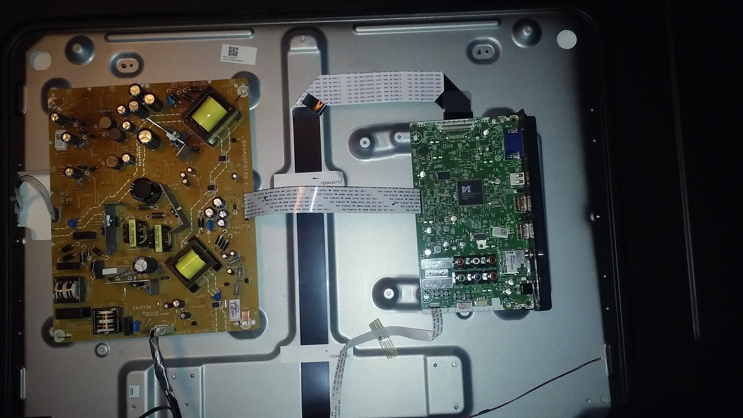

    emerson lf501em4 turns on when plugged in then turns off

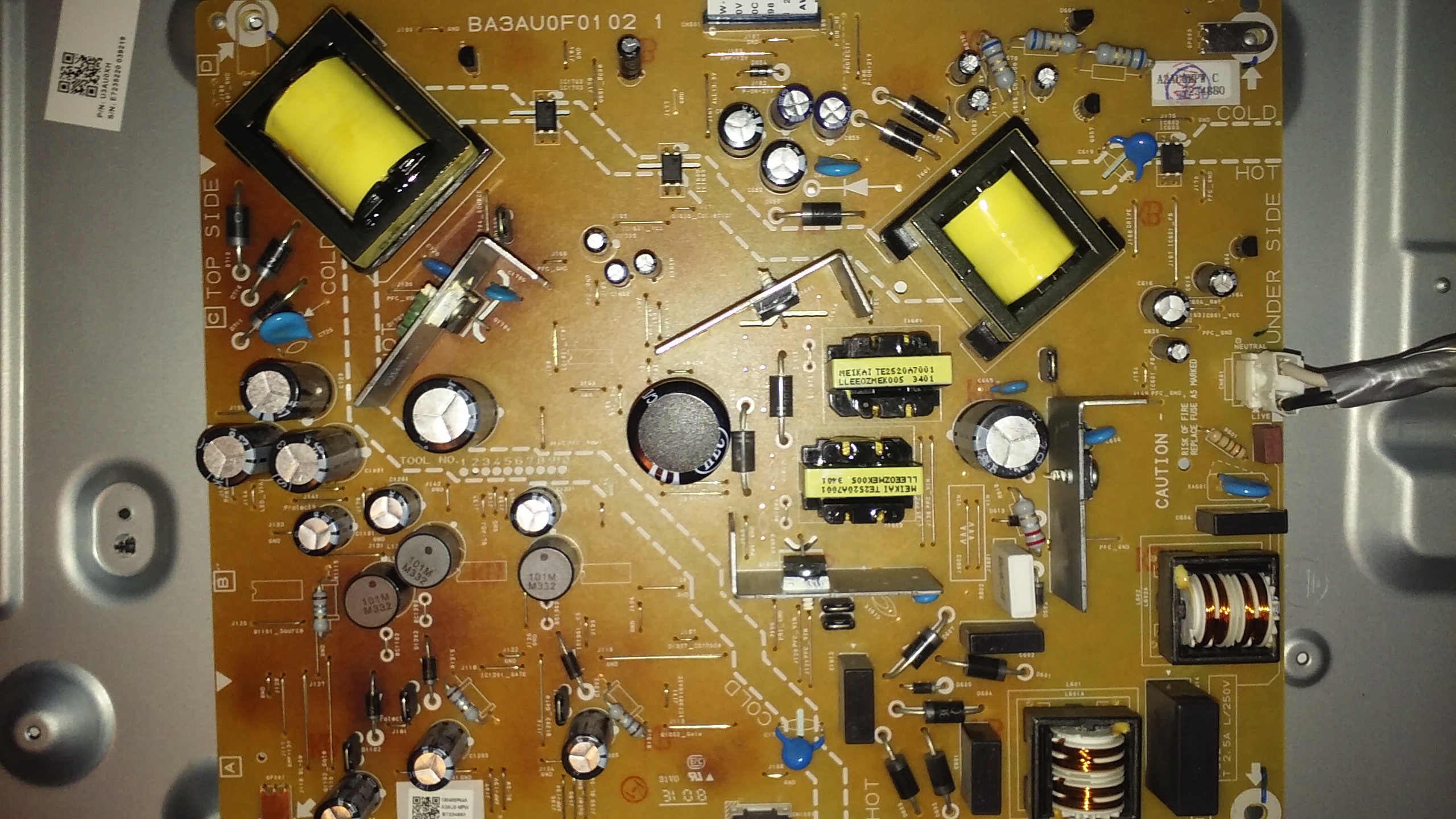

    hello i came across this tv and am trying to get it to work i plug it in it turns on and the splash screen comes up (it says emerson) and then it kinda clicks and shuts off as soon as the tv should be displaying i can see the channel box right before it shuts off iv looked at power supply and all caps look good although there is some white crusty stuff on the big one that is below the 2 smaller transformers toward the bottom of the board. i have unplugged the ldvs cable with no change just looking for the next place to go there is some discoloration on the powersupply board on the top left and top right (where it says "top side"

    When the picture goes dark, is the backlight still on?

      no the whole set shuts off which is why i am kind of at a loss on what to do nextbecause it all powers off if i hold the power button again it will come back on go through the splash screen again and then it shuts off when it does you hear a click and thump through the speakers

        The discoloration may be normal, components that dissipate more heat will cause this.
        We need to find out if the PSU turns off by itself or if it is commanded by the mainboard.

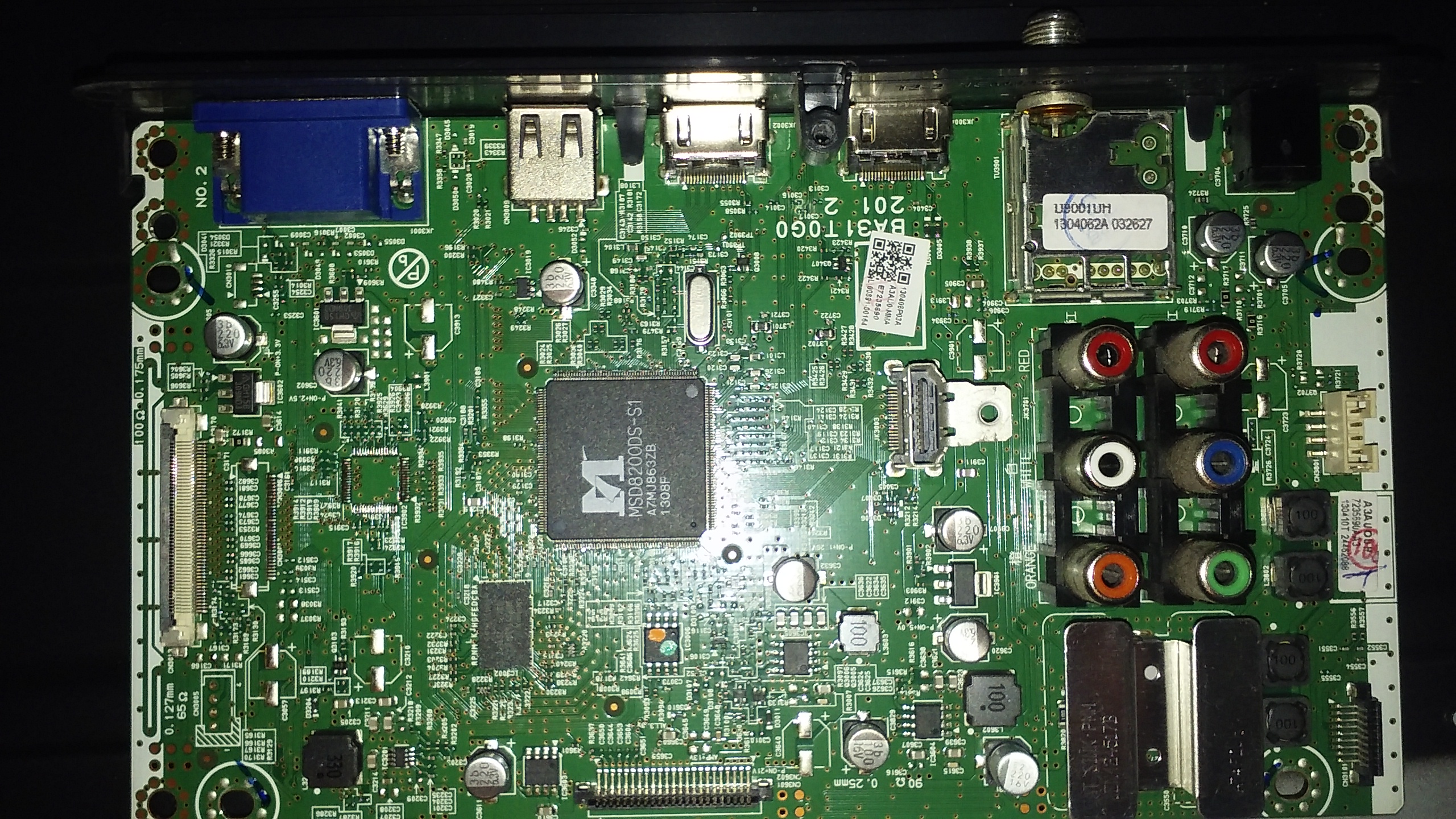

        If nothing is indicated on the boards you will need to measure all signals on the white flat cable connecting mainboard and PSU when 1. in initial standby, 2. ON (screen on), 3. after it clicked and turned itself off. Post the results here.

              starting with the top pin as being pin #1 i will put 2 columns with left being off and right with bl on
              1 ground
              2 0 not common to ground and no volts on or off
              3 0 off; .2 after pushing power button .1 when backlights come on and seems to flash .2 right before backlights go off and tv shuts off
              4 2.9 ; 2.9
              5 0; 3.0 as soon as push power
              6 0; 3.2 as soon as push power
              7 0 ; .1 after pushing power then jumps to 2.2 with backlights on split second before backlights go off and tv shuts off, i see 2.4
              8 3.3; 3.3
              9-13 ground
              14 0; 0
              15-18 6.3 off 12.4 on
              19-22 11.4 off 21.2 on
              i tested these with the lvds cable plugged in and also un plugged it makes no difference
