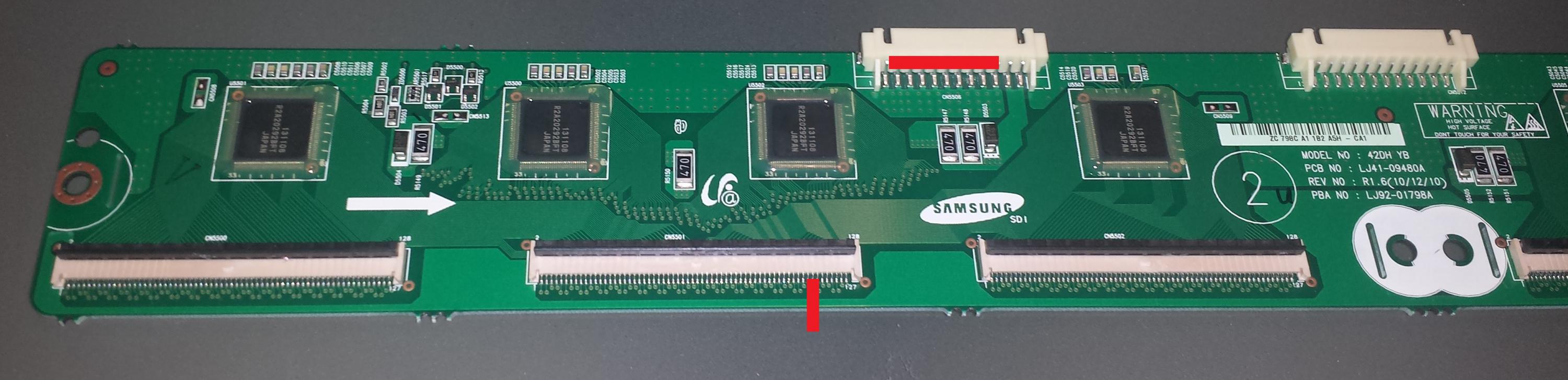

    Hi, this plasma TV flashes the front red LED 6 times at plug-in and then nothing (it does not repeat) however the LED does flicker in response to the remote but the set never powers up, no sound or picture. The relay clicks in on the first flash and on the second flash the screen briefly flashes random white lines.
    The green LED on the control board flashes 5 seconds on & 2 off and repeats which seems to indicate X or Y-main failure (or both) from what I have read in other threads but the symptom is exactly the same if I disconnect X-main or both (except the screen does not flash). Shouldn't the unit power up with sound but no picture?
    VA,VS & Vscan are all spot on (58,207,-185 as marked on panel) as screen flashes but then quickly drift down to <1v as control board sets VS_ON back to 0v
    I have removed both X-main and Y-main to check and there are no shorts on either (VA to GND, VS to GND or any FETs, SMD or through -hole)
    If I disconnect main board and short PS_ON to ground and jump pin 3&4 on control board for test pattern, no result, just 5-2 flash on control board as before.
    If only the main board is connected, it still flashes the front red LED 6 times.
    If I got sound but no picture with X & Y-main disconnected I would look at replacing them but should I be considering the control board first?
    Any help appreciated, thanks.

        With original control board back in I get the 5sec on - 2sec off again but as it was silent today I could hear a noticeable buzz from the Y-main at the same time the screen flickered before the control board shut the HV side down. I powered up the TV with the Y-buffer disconnected and there was a pop and now the Y-main is shorted (test points, several FETs and diodes)... X-main still "seems" OK (no shorts). Anyway, tested buffer (that wasn't connected when Y-main blew) and there are shorts between the 2 red markers on the picture below, all <10ohms, so it seems buffer was already dead... Wish i'd checked this before...
        Whether I killed the Y-main by powering it up without it's buffer board (although i'm certain I had already tried that the other week) or it had already been damaged by the fault on the buffer board, I don't know. but I have ordered both and hopefully that will solve the problem.

          Before you fit the replacement boards--Check Them for shorts first, particularly the IGBT's and FETS of Y-SUS and All the buffer-chips.
          Most TV parts suppliers Do Not Test in any way shape or form--Even though they Claim they do....
