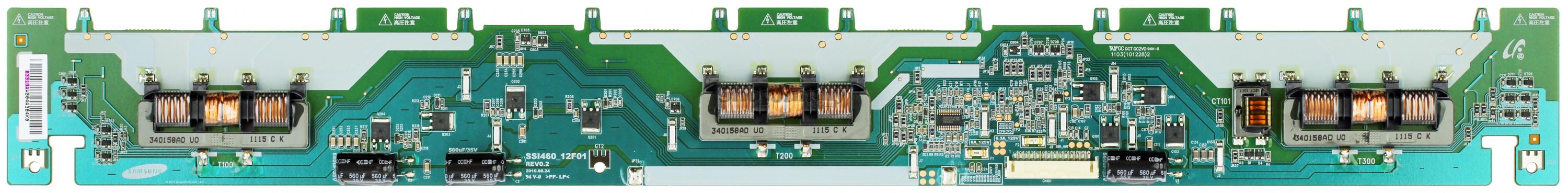

    After doing a bunch of research and troubleshooting I finally grabbed a flashlight and I can see the menu screen and have sound. So my backlights are shutting off after a second.
    I have unplugged the Tcon board and the backlights did the same thing.
    So testing everything I am thinking either I have a bad bulb or bad inverter. but I am not sure how to test the inverter.

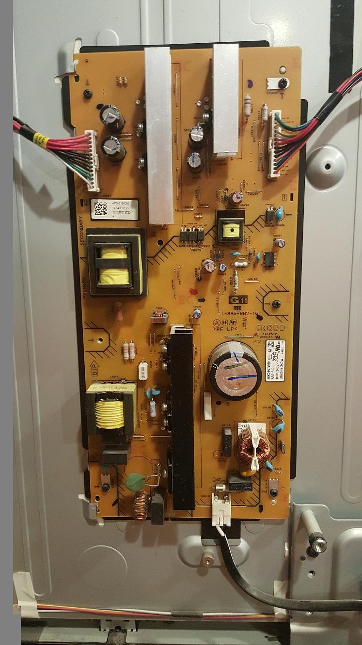

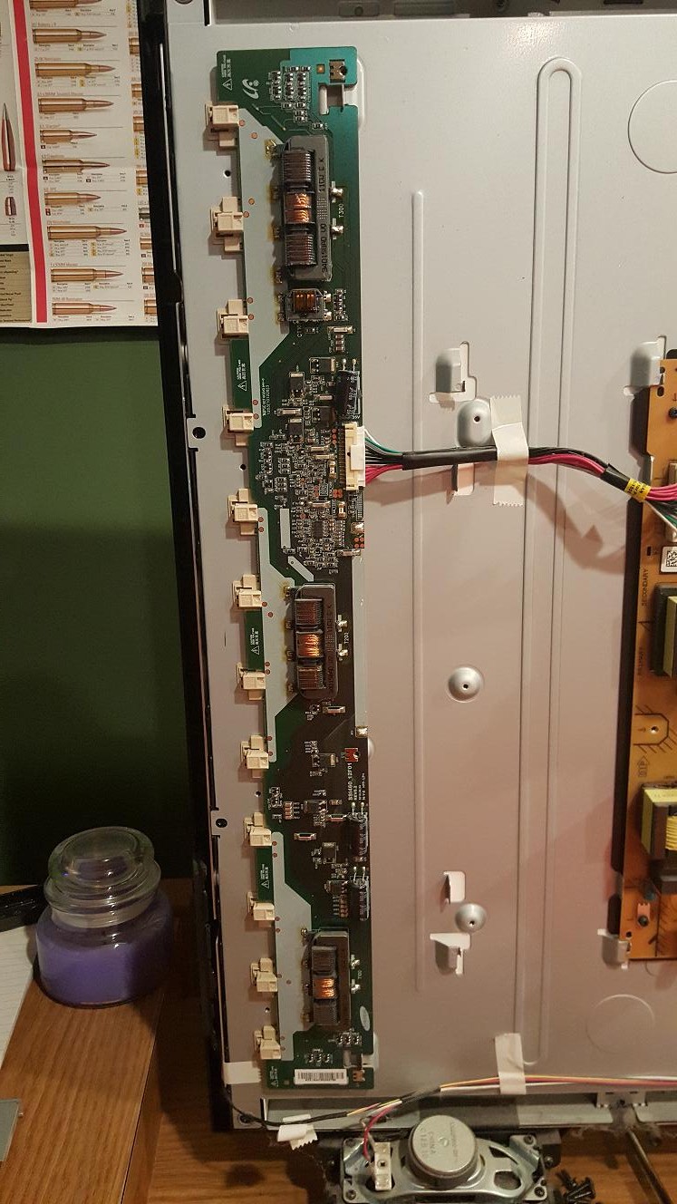

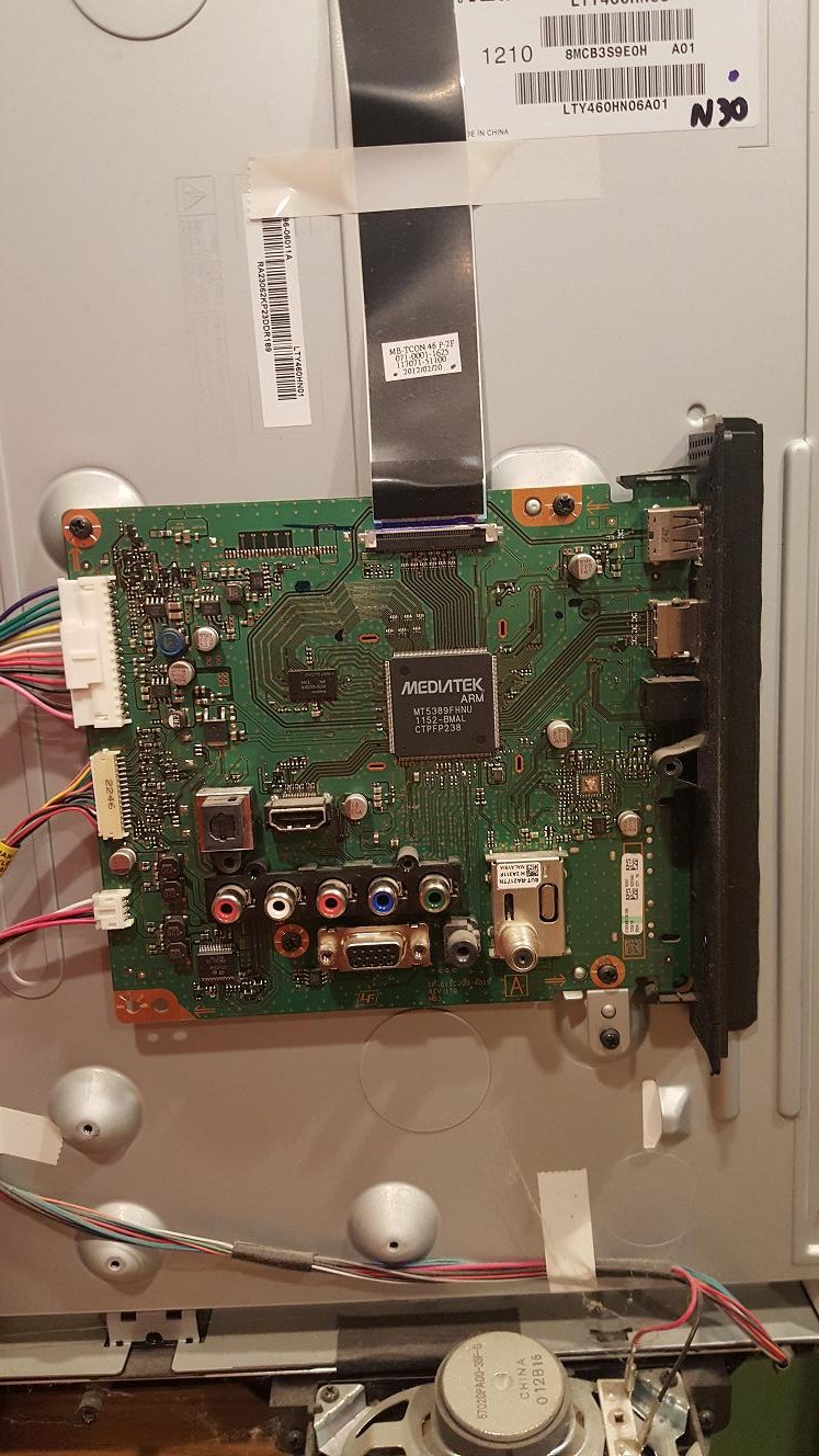

      Here are the 3 boards. I didnt want to take the cover off the Tcon unless I have to.
        Re: Sony KDL-46Bx450 Backlight problems
        That Inverter board looks familiar.
        What is the P/N on that inverter board?
        This one? Samsung LJ97-03319A Backlight Inverter (Sony 1-857-986-11)
        http://www.shopjimmy.com/samsung-lj9...-inverter.htm#
        Pictures provided by shopjimmy.
        There are many threads about this board and has bad transformer.
        https://www.badcaps.net/forum/search...archid=5691709

              How do I test the transformers?
                If you look at the picture, the four terminals on the bottom row of the transformer, make left most pin as pin 1, so you have pin 1~4.
                You will check the resistance of the first winding which is pin 1 & pin 2, then check the second winding which will be pin 3 & pin 4.
                Report the readings of each transformer, the resistance should be within 3% from each others. Look real close at the transformer and the bottom side of the board to see if any one of them show a sign of over heat.

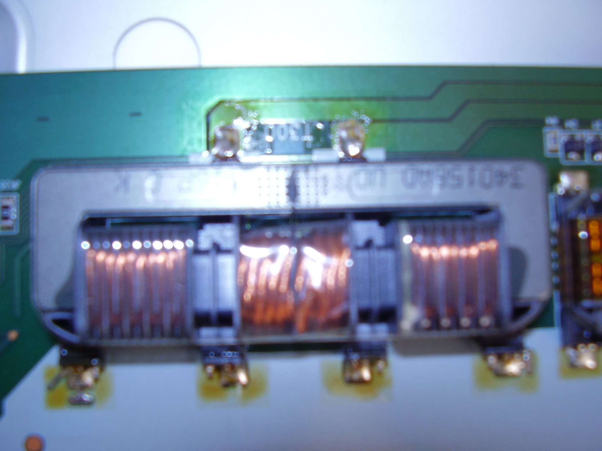

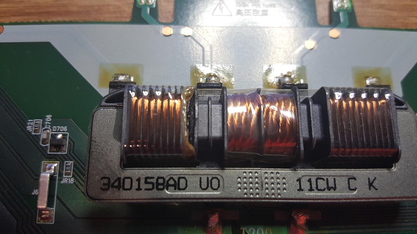

                  I think I fount the problem. See picture.
                  Tranformer readings
                  1 - 1308
                  2 - 1314
                  3 - 1154 - the one in the picture
                  4 - 1316
                  5 - 1349
                  6 - 1343
                    You may want to contact this person to see if he still has the broken board that you take one of the transformer out to use in your board:
                    https://www.badcaps.net/forum/showth...19A#post612126

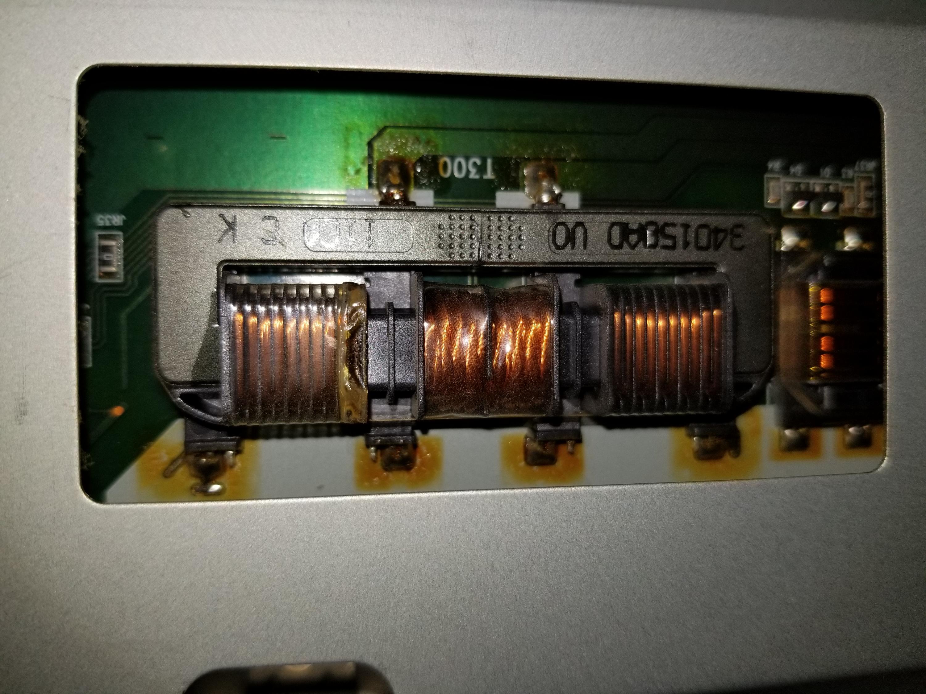

                          Hey all,
                          Posting this here as it's super applicable.
                          I definitely think this tv I have has the bad transformer issue.
                          I'm concerned about the audio and video issue though. Does it seem like mainboard problems also or could this all be caused by the bad transformer.
                          Really not interested in investing much on this lol
                          Cheers,!
