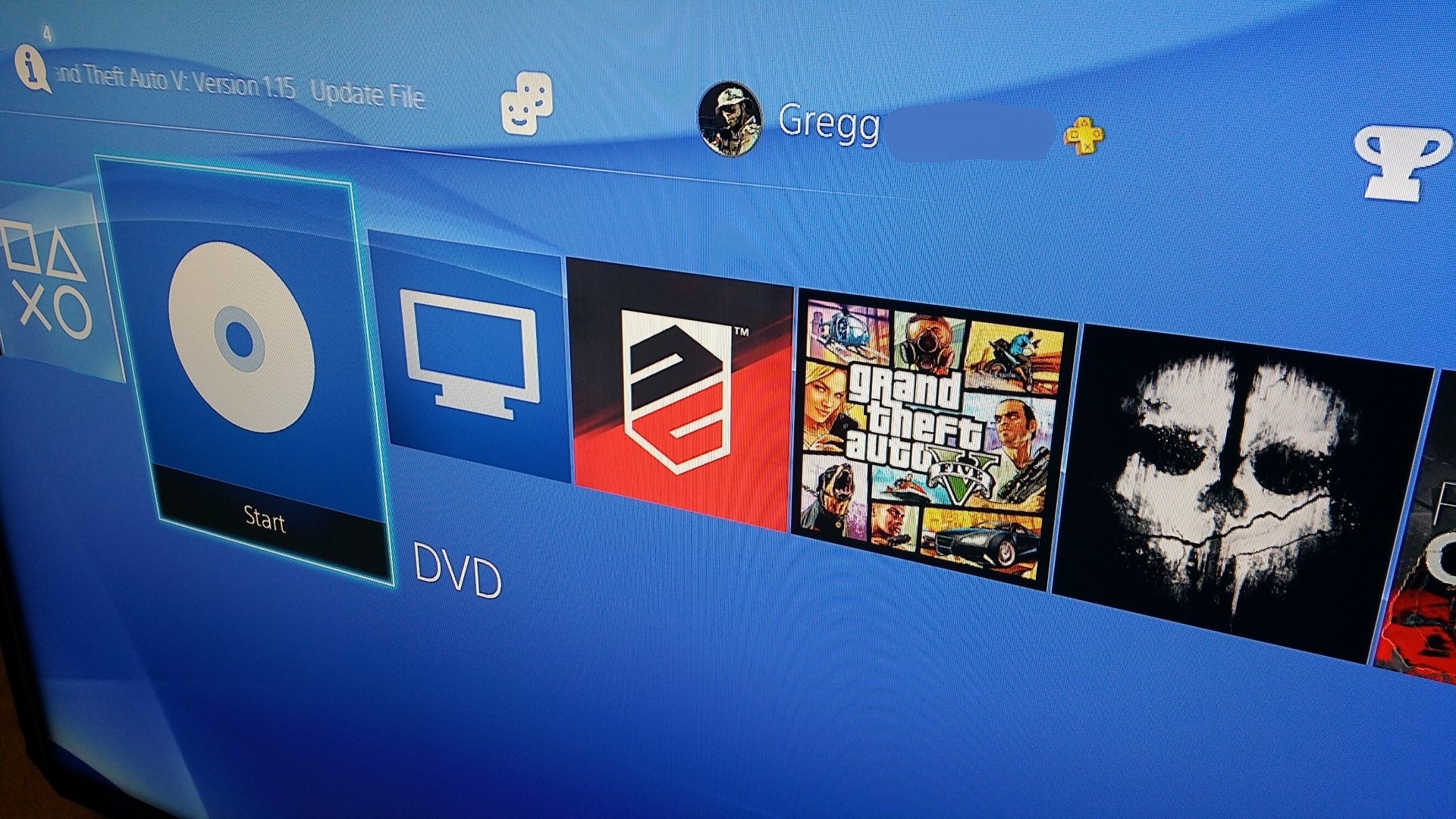

    Tried out the PS4 this morning, and noticed there is a rather severe 'lagging' or 'ghostling' affect across the screen... as if the unit is trying to work in real cold temperatures.
    The 'million dollar' question here is... is it the panel, or possibly (and hopefully) the T-con board? From my limited knowledge and research, it seems like this board is the one that 'drives' the panel. Gut feeling is that it's the board and not the panel... but I guess that is what I am asking here. Any opinions or advice would be greatly appreciated.
    If it is indeed the panel, I can at least part out the set on Ebay... as I know the other boards are somewhat desirable. Seems like this set was quite problematic back in 2008 when they first came out... having some kind of 'tab bonding' issue or something, which a lot of people were upset about, having spent $4,000 (MSRP) on a TV that only lasted 3 years. I'd be pissed too!
    Anyways, I can post pics of the ghosting... but I don't know if that would help. I'll check Youtube for videos of the symptom too. If anyone has any knowledge to share on this, please do so. I'd love to get this TV fixed.

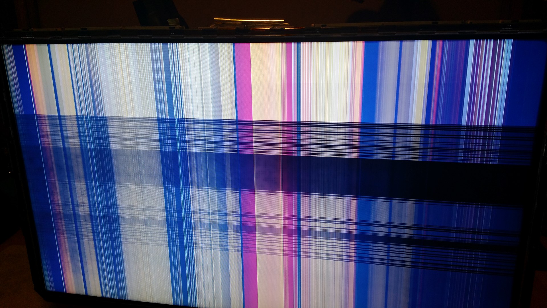

                Sorry for the delay, I had hoped to post pics with my original post... but didn't have time to grab them off my phone.
                See link below for what my Sony KDL-52XBR4 is currently doing. The 'ghosting' may not be too clear to see... but the center 'fading' and the vertical lines on the right are rather apparent.
                https://flic.kr/s/aHskr3T9o9
                Hoping it's a tab bond issue, and according to some YT vids, I have the same issue... which seems 'fixable'!

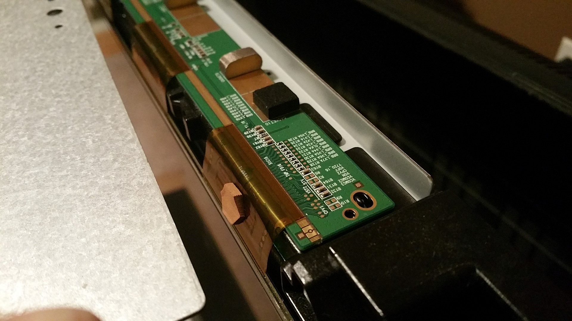

                  Update: 12-22-2015
                  Well, I finally had a chance to take 'er apart yesterday (without my 4 year old around)... and discovered that it IS definitely a tab bond issue causing the faded center of the screen and vertical lines, lagging.
                  It's the upper right flex (which seems like the culprit in every video/write-up I've seen). I was ready to give up, but then 'pushed' somewhat hard in the center of the flex... and BOOM, the picture got nice and bright and crystal clear!! YAY!
                  Now... the tricky part, finding a way/method to fix it and keep it in place. I used some smaller foam cabinet door bumpers in between the frame and flex, but the issue came back after a while. So there's not enough pressure on the flex from both 'front' and the 'top'.
                  I'm going to try a few other things when I get home today, but does anyone have any suggestions on a 'good' fix for this issue? I've heard electrical tape mentioned, but don't know where I'd apply the tape. The narrow control PCB on top wants to "lift up" and that adds to the cause of the problem.
                  I'll try to post some pics... but I guess most folks reading this already know about the tab bond issue. I just need a solid fix for it, that won't fail when I re-assemble and move the set to the location I am going to use it. Last thing I want to do is have to disassemble this beast again! Although, it is kind of fun!

                      Re: KDL-52XBR4 Ghosting Issue - Panel or Board???
                      So, here are a few pics... now that I can attach photos easy. Whew.
                      The checkerboard pattern happens if I press incorrectly on that flex with the issue. But, when I press the 'center'... viola!
                      Those are the foam bumpers I used, but I think I have some solid rubber ones that I am going to try... a bit more rigid. I found a thicker foam piece here at work to put above the flex, to keep the PCB down as well.

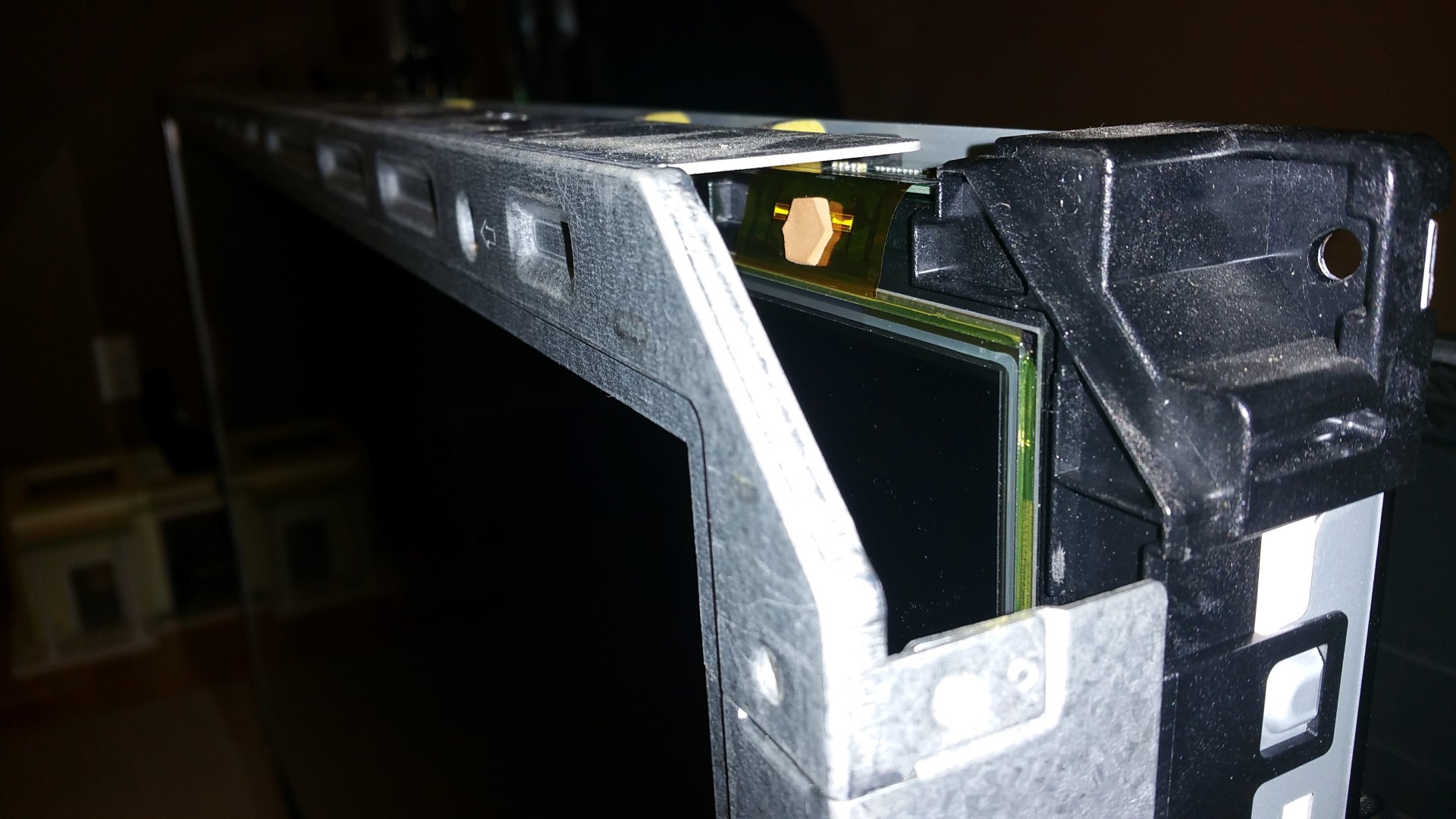

                        So I tried putting a 3/8"x 3/8" x 2" long piece of rather 'solid' foam (with sticky back to the frame) in between the frame and the flex, and it worked immediately. Yay! Sort of.
                        Now... the very unfortunate issue is, when I put the outer frame back on, the issue comes back. Very frustrating. This thing is extremely finicky... wow.
                        I can apply a slight pressure to the outside corner of the set (with the frame on) and the issue then goes away.
                        Any suggestions? I may try a thicker piece of foam to try to apply more pressure to the flex, but I can have too much pressure in between or I won't be able to put the inner frame screws back in.
                        How are folks resolving this flex issue? Maybe mine is worse than others that I have seen videos on. One guy used the small rubber bumpers... but unless you get them in the exact correct position... the issue is going to come back.
