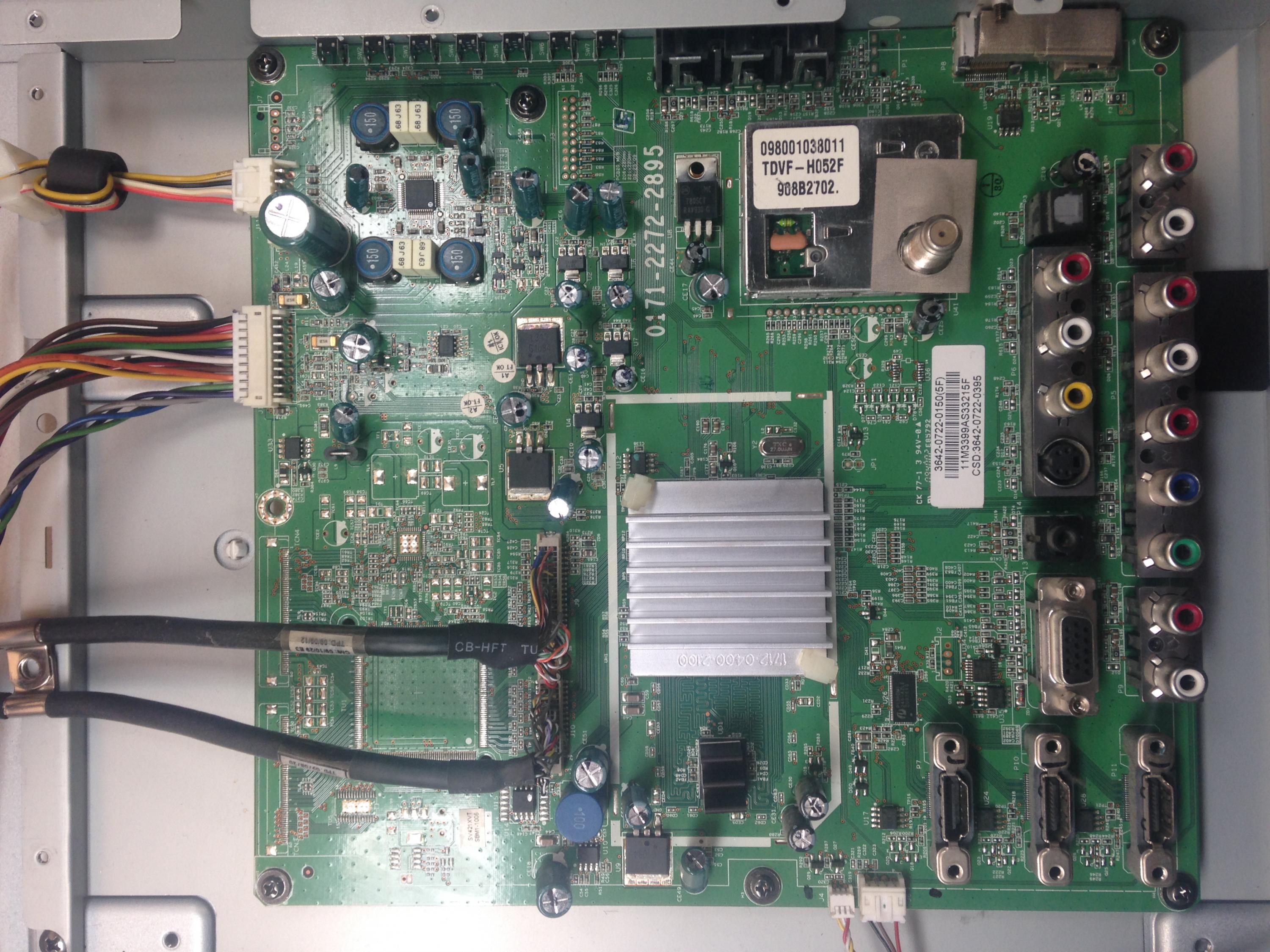

    I have this Vizio Tv SV421XVT that does not turn on. Front orange light is on and does not change to white after pressing power button as vizio tv's usually do.
    Power supply and backlight tested good. I used jump on PS-ON and BL-ON. My next step is the main board. I looked for bad voltage regulators but I'm not sure if they are good or bad. Here are the reading:
    U4 (L213 G9117)
    IN: 3.3v
    OUT:1.2v
    ADJ: 0v
    U7 (L213 G9117)
    IN: 5.1v
    OUT: 3.3v
    ADJ: 2.0v
    U2 (L213 G9117)
    IN: 5.1v
    OUT: 3.3v
    ADJ: 2.0v
    U6 (L213 G9117)
    IN: 12v
    OUT: 8.1v
    ADJ: 6.9v
    Thank you for your help.

            Re: Vizio SV421XVT Not turning on
            Yes. Backlight works after applying jumps on BL-ON. Replaced EPROM, it didn't work.
              I tried the trouble shooting performed on the link below and i get backlight, front orange light remains same color and no display or picture at all.
              https://www.badcaps.net/forum/showthread.php?t=34303
              Any suggestion?
