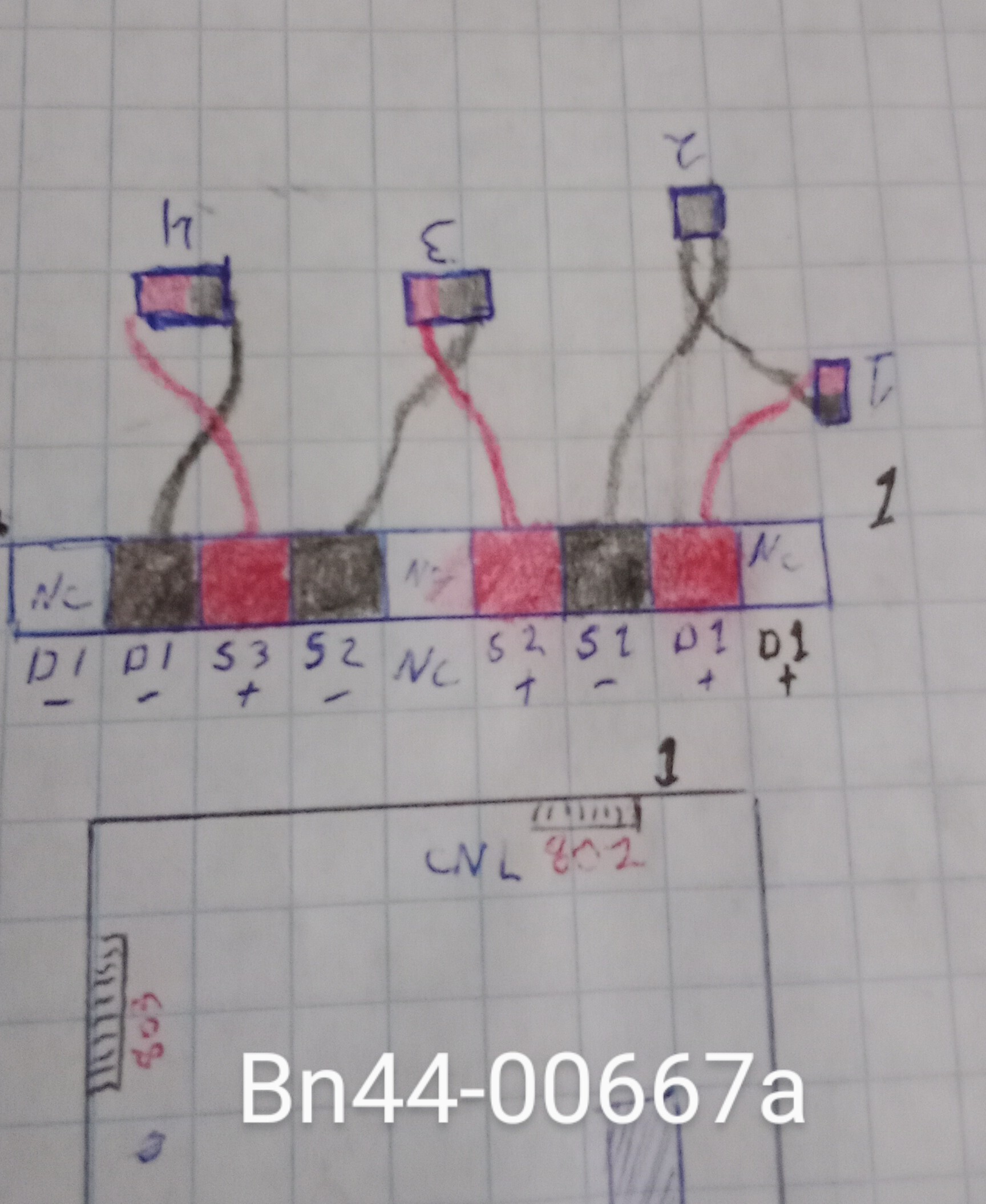

      and the powersupply shows no sign of burn marks , but the arangement of the leds has me a little confused, the connector is designated
      D1+. S1-. S2+. nc. S2-. S3+. D1-. and the way the copper traces
      are on the bottom of the board it looks like all three led circuits are in series
      Right ?

        We need Pictures of the whole back side of the TV, and the power supply board both top and bottom side, closed up pictures around the connector.
        S?, are the sensing pins.
        Power supply board P/N BN44-?????
        'yes i get over 200 volts at D1+' at this point, you have open circuit in the LED strings some where.

          here is a closeup of the connector i'll try to get a few better ones tonight
          the power supply is BN44-00667A

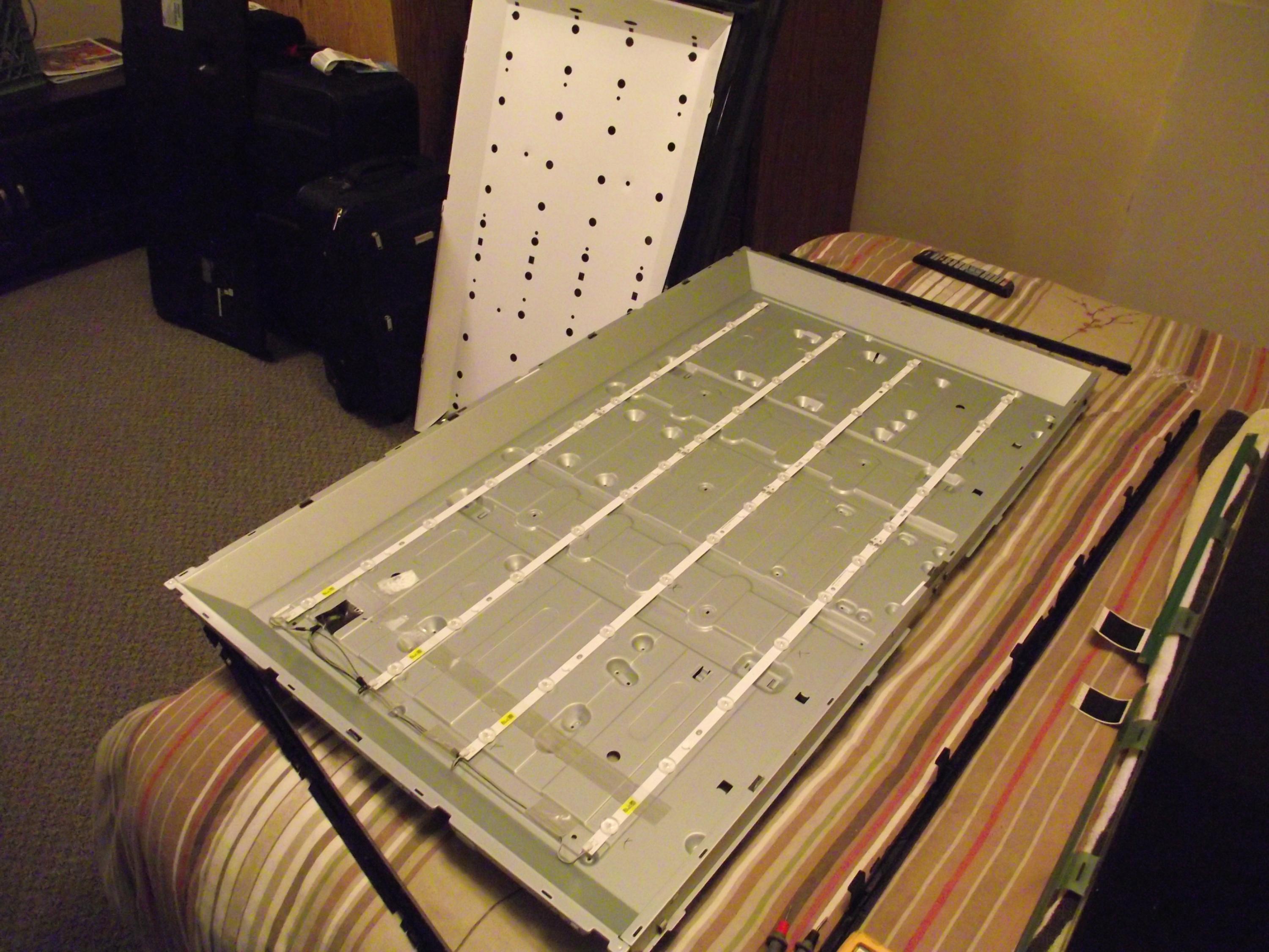

              well i took the plunge and cracked the tv wide open
              to get to the leds .this is what i found
              there are four strings of leds.
              each string is made of two smaller strings
              the left section has 6 leds
              the right section has 5 leds
              the power supply has 3 pairs of wires going to the leds
              i guess that the power supply is used in other models of tv
              the top two led strips is wired in series to one pair of wires
              the next two led strips each are fed by one pair of wires
              all the led strips ore wired in series at the connector on the power supply
              thats 44 leds all in series
              i tested the strings using 2 9v batteries in series
              i tested the right section by connecting at the junction of the strips
              i tested the left section by connecting at the connector and shorting
              the strips at the junction
              the result ..
              8 leds with little or no light and one open strip ( top left )
              this tv is done !

                  You can try getting a new set of the LED strips.
                    That's not done, here is the same strip
