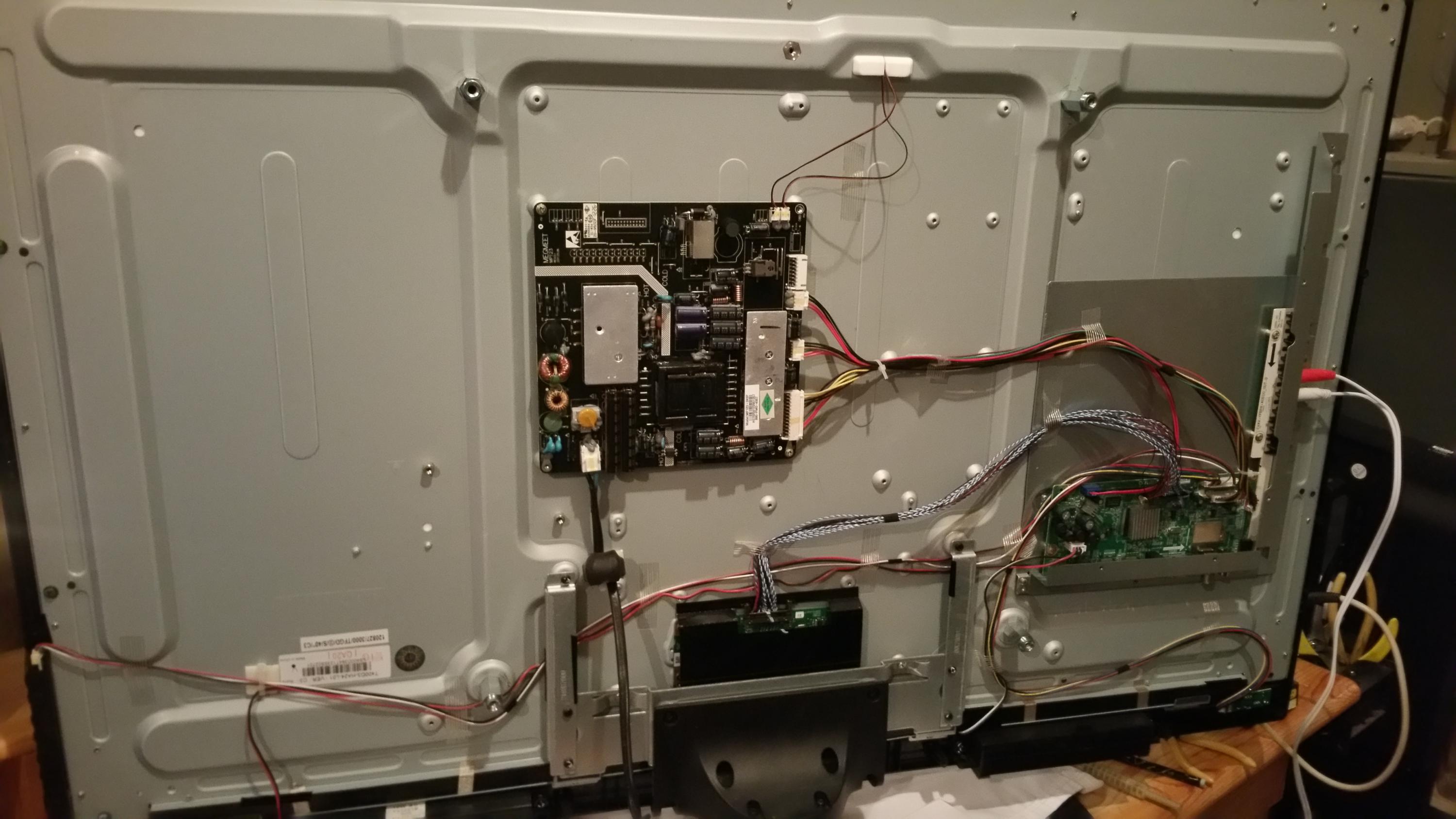

    How about the pictures of the whole back side of the TV so we can see how all the boards are connected together?
      Re: Sharp LC40LE431U No picture or sound
      Here it is

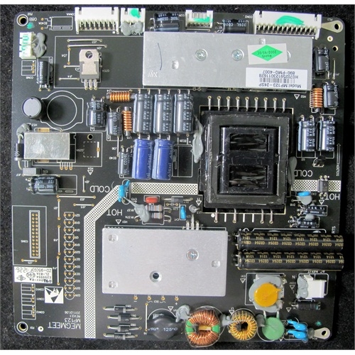

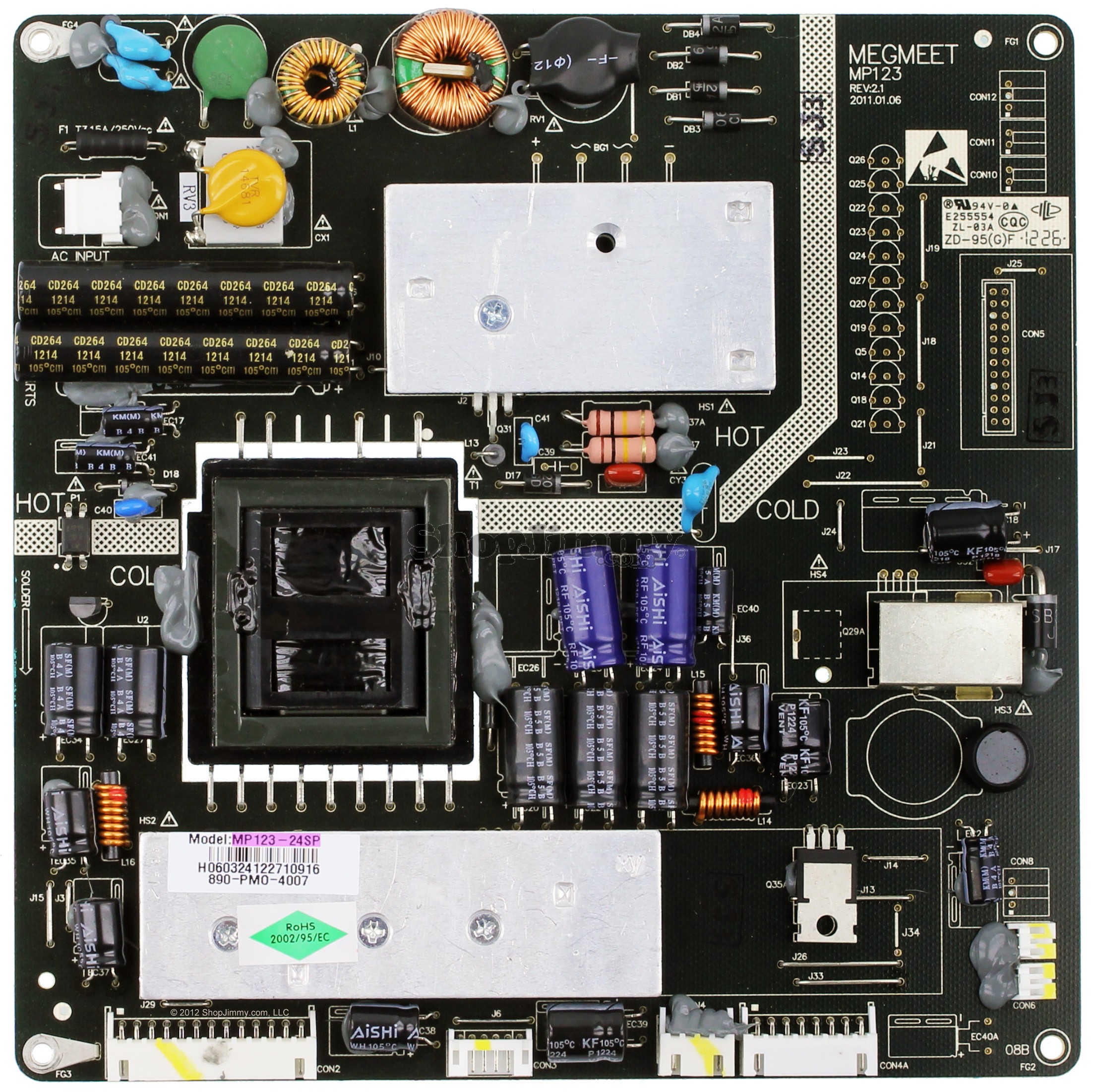

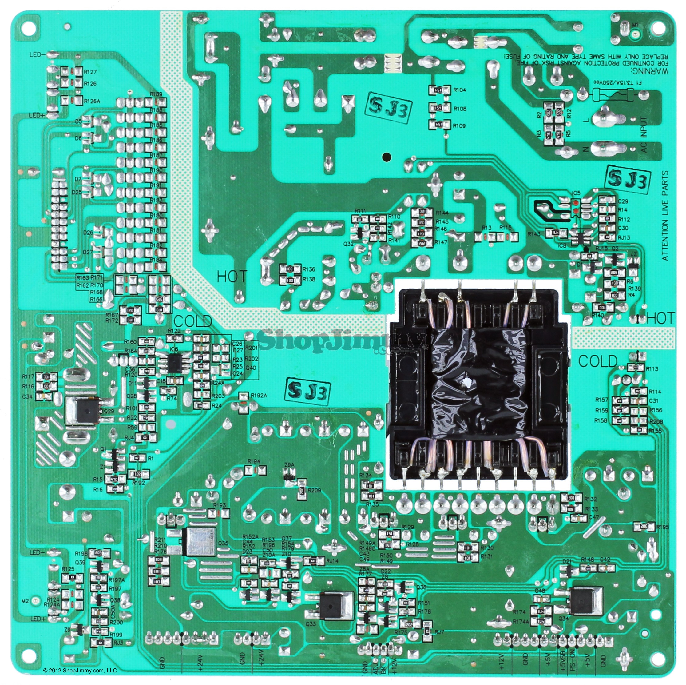

            There are two LED strings (2 connectors), the two strings are connected in series to form one big long string. If you look at the bottom side you will see how they are connected in series.
            What is the rating of the electrolytic cap laying on it side next to the LED connectors?
            http://www.shopjimmy.com/megmeet-mp1...pply-unit.htm#
            Sharp MP123-24SP Power Supply for LC-40LE431U / LC-40LE433U.
            pictures provided by shopjimmy.
