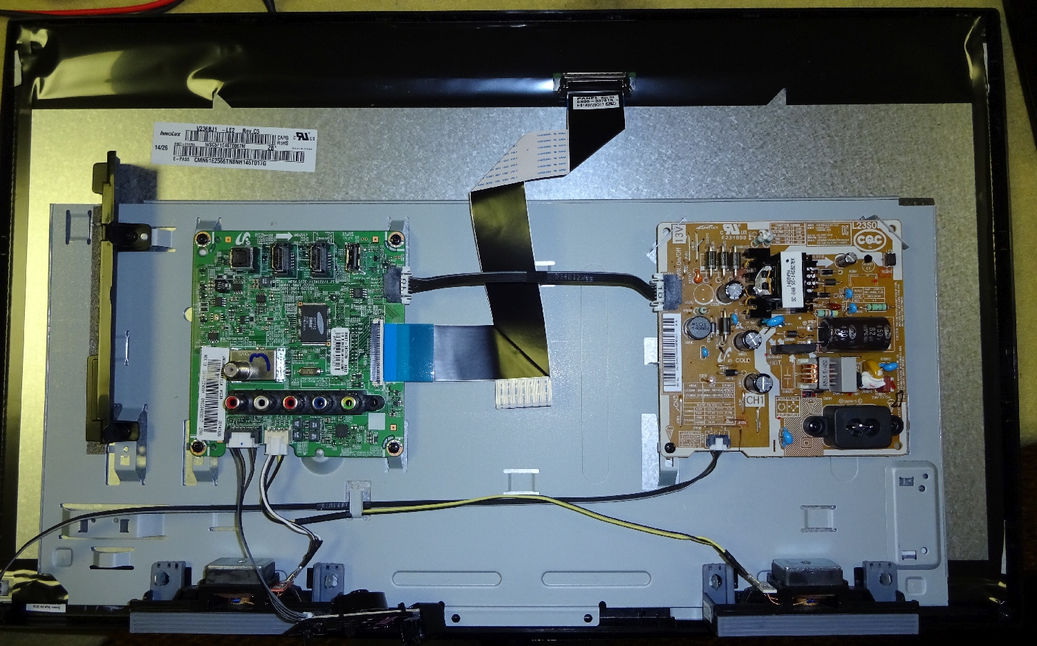

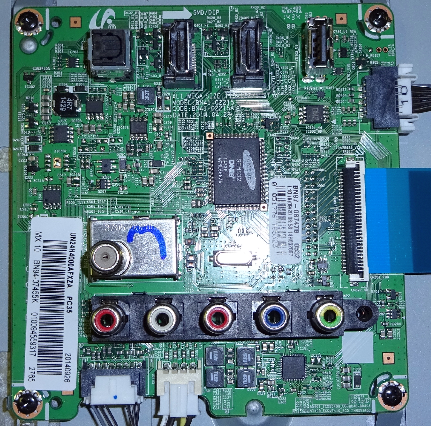

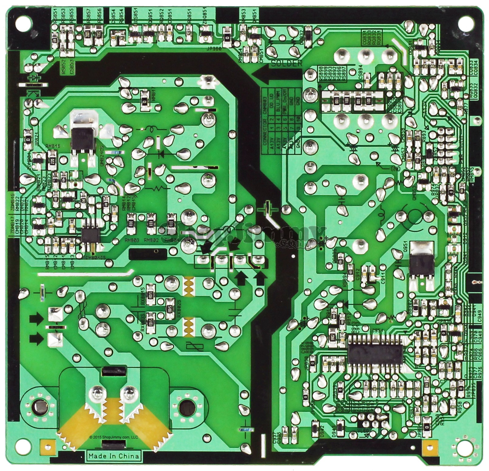

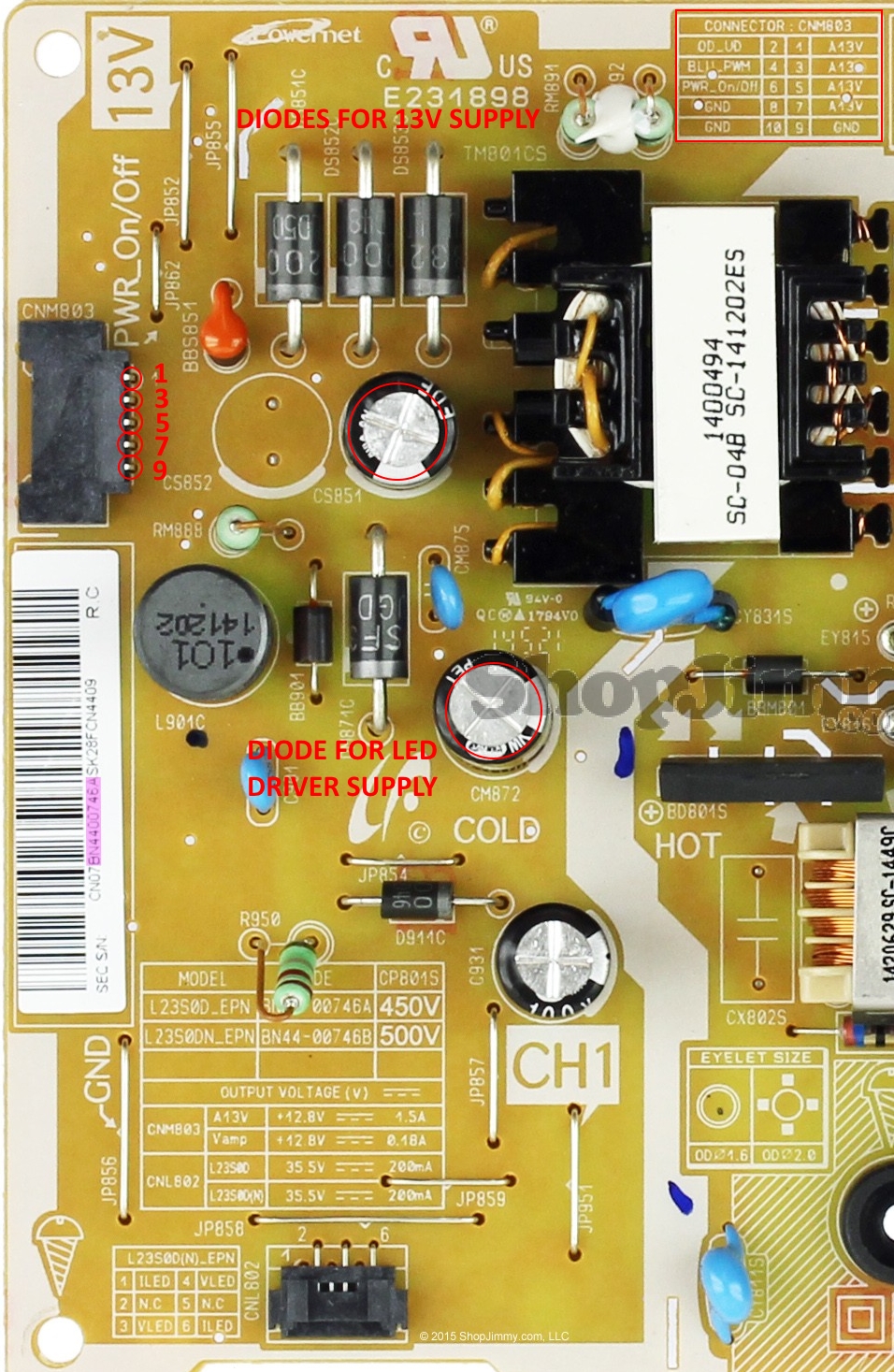

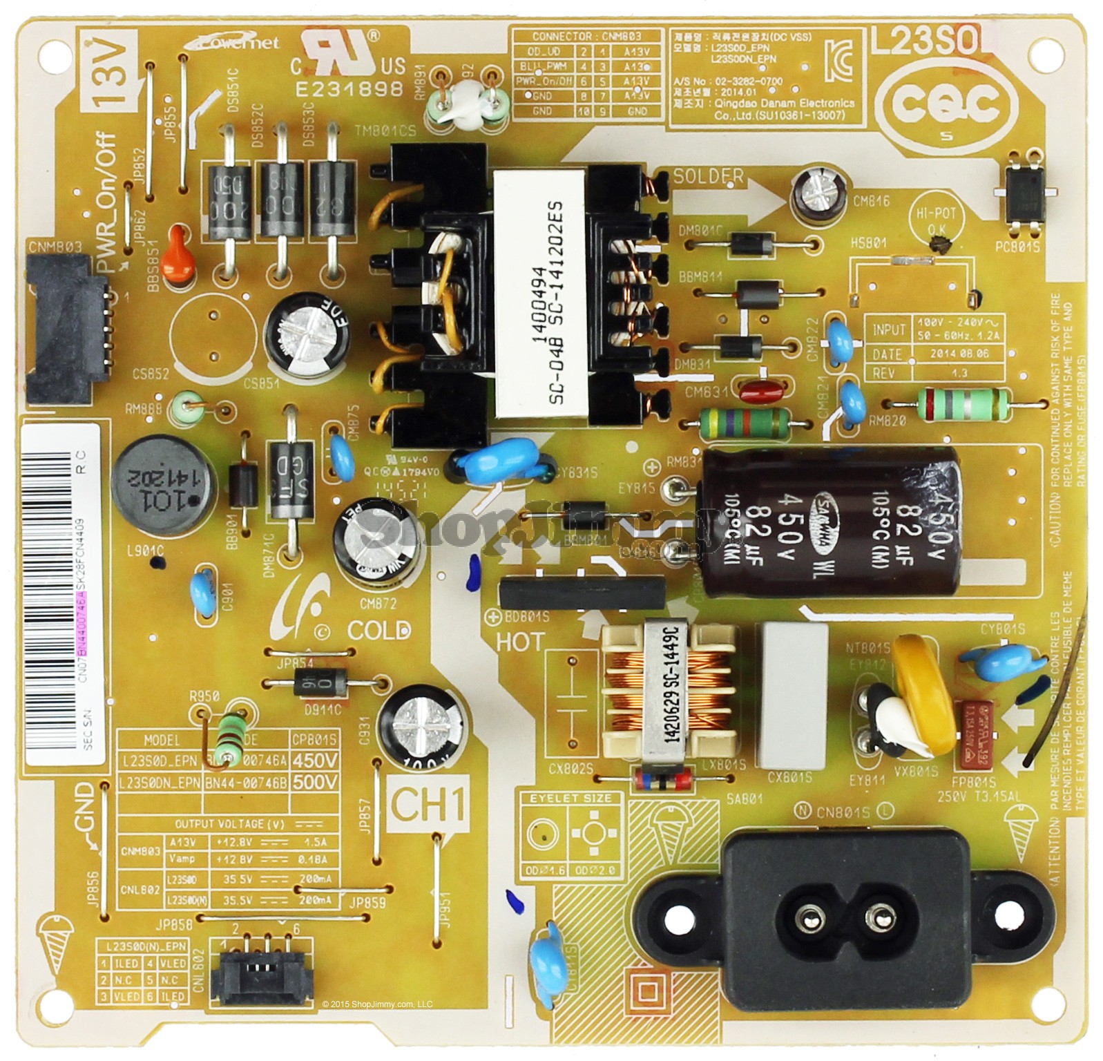

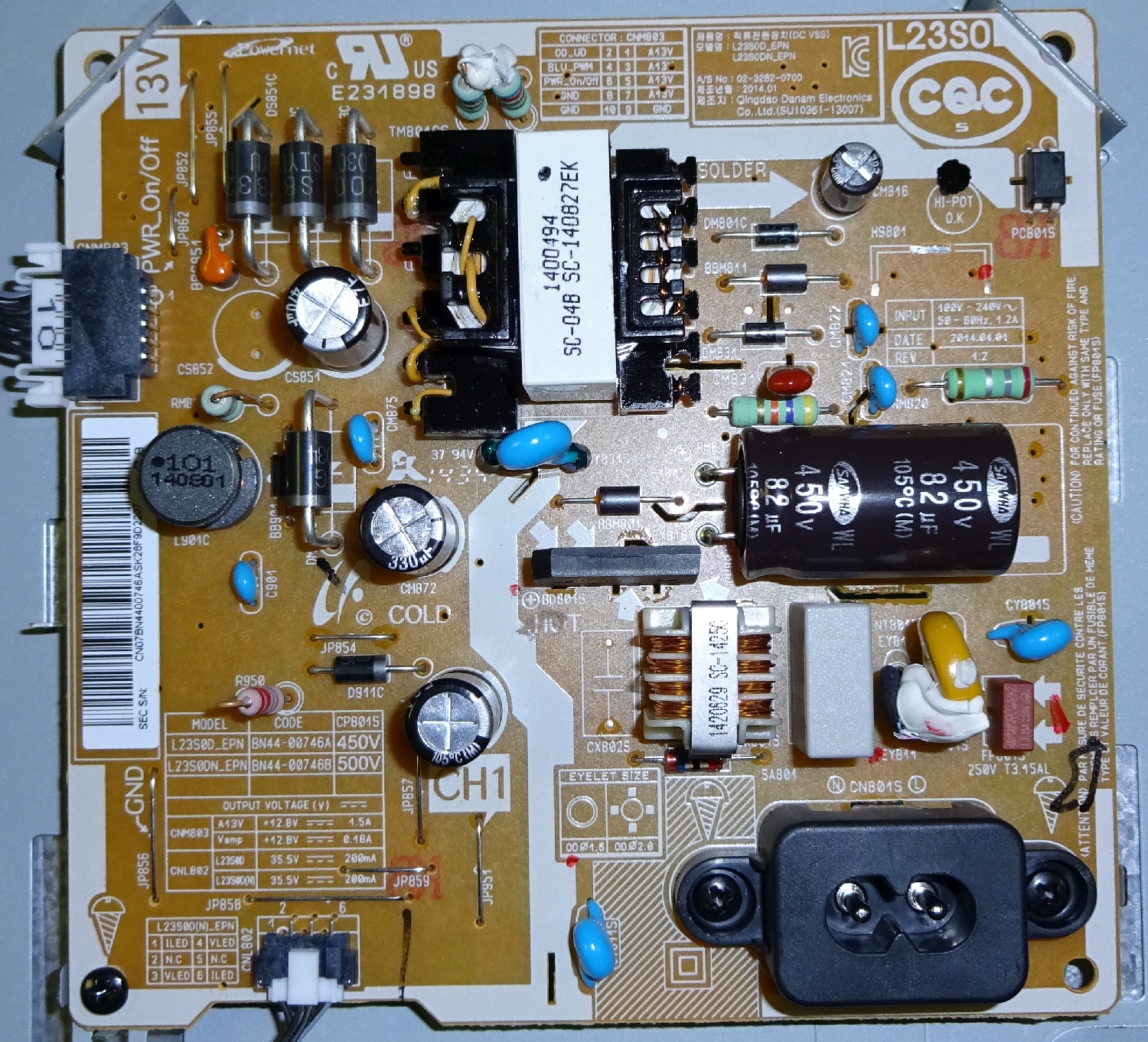

Samsung UN24H4000AF red blinking
  • CraigR
    • Dec 2013
    • 969
    Samsung UN24H4000AF red blinking
    Samsung UN24H4000AF LED tv whn turned on the front light either stays on steady and pushing the power blinks a few times then goes out. Never any backlight and nother ever on screeen using flashlight. I get 165v constant at the big cap and the 5 wire cord from the power to main I get 12.3v on 4 and ground on the other and does not matter if red light is on or off in front. I was thinking the main but am not sure what to test next. Thanks in advance for any help!
  • CapLeaker
    Leaking Member
    • Dec 2014
    • 8351
    Re: Samsung UN24H4000AF red blinking
    Measure on the PSU the CNM803 connector all pins and post them. Then disconnect the main board and plug the TV in, the backlights should come on.
    • CraigR
      • Dec 2013
      • 969
      Re: Samsung UN24H4000AF red blinking
      Yes that's the connector I was talking about it's actually 12.9volts pin 1-4 then 5 is nothing. Unplugging that connector then powering the board still no backlight so Power board shot?
      • CapLeaker
        Leaking Member
        • Dec 2014
        • 8351
        Re: Samsung UN24H4000AF red blinking
        O.k. maybe the PSU doesn't have a pull up resistor to fire up the backlights. I haven't seen a schematic for it.
        You wont see more than 170V on the main filter cap, as the PSU is not getting turned on (no PSon) and thus the PFC isn't working. With the PFC working, voltage on the main filter cap is >360V DC.
        Nothing on pin5 is bad. That defiantly indicates a bad main board. I guess you need a new replacement board. You could try to trace back the PSon signal on the main board, but I had not much luck fixing an issue like that as mostly the main IC was bad.
        You can try to unplug the PSon pin from the connector and jump 13V DC through a 1k resistor on it and force the PSU on?
        Last edited by CapLeaker; 12-02-2015, 04:53 PM.
          Re: Samsung UN24H4000AF red blinking
          You need to report the readings of all 10 pins and follow each pin with pin names per chart as printed on the board: CONNECTOR:CNM803.
          Per chart:
          PIN 1, 3, 5, 7 are A13V (Always on 13V)
          PIN 8, 9, 10 are GND
          PIN 2: OD_UD
          PIN4: BLU_PWM
          PIN 6:PWR ON/OFF
          The ODD pins can be access form the top side of the board.
          The EVEN pins are accessed from the bottom side of the board.
          This power supply does not have PFC Voltage booster due to low power and it only has only one transformer and it is always running.
          Pictures provided by SHOPJIMMY.
          Last edited by budm; 12-02-2015, 05:36 PM.
          • CraigR
            • Dec 2013
            • 969
            Re: Samsung UN24H4000AF red blinking
            Well CapLeaker bad guess. Got the new main today and same thing. Even went as far as taling the LED's out and testing them. Wish I would have seen budm's post before I ordered it. Out $25
            • CraigR
              • Dec 2013
              • 969
              Re: Samsung UN24H4000AF red blinking
              1,3,5,7 are all 12.9v
              2=3.2v
              4=1.5v
              6=5.4v
              8,9,10 are good ground.
                Re: Samsung UN24H4000AF red blinking
                Originally posted by CraigR
                1,3,5,7 are all 12.9v
                2=3.2v
                4=1.5v
                6=5.4v
                8,9,10 are good ground.
                So 2, 4, and 6 change state when the power switch is toggle ON and OFF?
                  Re: Samsung UN24H4000AF red blinking
                  Samsung BN44-00746A
                  BTW, you need to check the DCV of the LED connector CNL802 pins with and without the connector in place when TV is ON. I have a feeling you have bad LEDS.
                  Last edited by budm; 12-10-2015, 02:44 PM.
                  • CraigR
                    • Dec 2013
                    • 969
                    Re: Samsung UN24H4000AF red blinking
                    No change in voltage when on/off button toggled in 2,4 and 6
                    I have 18V on the LED connector. I removed the LED's and tested each bulb with a bench power source and all of them lit. I also noticed the led in the digital audio connector always stays on when toggling the on/off switch.
                    • vankbg
                      • Dec 2013
                      • 4
                      • Bulgaria
                      Re: Samsung UN24H4000AF red blinking
                      Can I check the power without other boards?
                      What to include on the PowerOn?
                      • nomoresonys
                        • Jan 2013
                        • 12328
                        • U.S.
                        Re: Samsung UN24H4000AF red blinking
                        In what way is your tv malfunctioning vankbg? be as specific as you can.
                        • vankbg
                          • Dec 2013
                          • 4
                          • Bulgaria
                          Re: Samsung UN24H4000AF red blinking
                          No power. Red LED is not illuminated.
                          Board power supply - checked, MOS, Diode ,.
                          There are 375 V input capacitor.
                          There is no output voltage.
                          I measure when the power circuit is disconnected from the TV.
                          • nomoresonys
                            • Jan 2013
                            • 12328
                            • U.S.
                            Re: Samsung UN24H4000AF red blinking
                            Don't understand "I measure when the power circuit is disconnected from tv". Did you try disconnect cable from powerboard to mainboard leave it out, then plug power cord into powerboard, do backlights come on and stay on?
                            • vankbg
                              • Dec 2013
                              • 4
                              • Bulgaria
                              Re: Samsung UN24H4000AF red blinking
                              I measure when the power board is disconnected from tv(Mother board and LED) Only Power 220V
                              • vankbg
                                • Dec 2013
                                • 4
                                • Bulgaria
                                Re: Samsung UN24H4000AF red blinking
                                Power suppay works without you plug to Mother board?
                                • nomoresonys
                                  • Jan 2013
                                  • 12328
                                  • U.S.
                                  Re: Samsung UN24H4000AF red blinking
                                  It's a test to try to verify powerboard and backlights, don't be afraid no harm if done as instructed.
                                  Last edited by nomoresonys; 11-12-2019, 09:40 AM.
                                  • vank
                                    • Feb 2012
                                    • 11
                                    • Bulgaria
                                    Re: Samsung UN24H4000AF red blinking
                                    Many thanks for your attention @nomoresonys !!!
                                    I repaired the power supply.
                                    The problem was PHOTOCOUPLER LTV-817B.
                                    I changed and everything is fine!
                                    Once again many thanks and all good!
                                    • nomoresonys
                                      • Jan 2013
                                      • 12328
                                      • U.S.
                                      Re: Samsung UN24H4000AF red blinking
                                      Good to hear, thanks for the feedback.
                                      • jurkozako
                                        • Feb 2020
                                        • 2
                                        • Slovakia
                                        Re: Samsung UN24H4000AF red blinking
                                        Dear budm, can you help me?
                                        My TV(Samsung UE40JU6400W) still illuminated RED standby LED on front. The voltages on powersupply are:
                                        when mainboard is unplugged - connector CNM803 (then the LED backlight is switched on)
                                        1. F/C 0,26V
                                        2. A/D 2,67V
                                        3. A13V 12,7V
                                        4. OD_UD 3,53V
                                        5. A13V 12,7V
                                        6. BLU_PWM 3,11V
                                        7. A13V 12,7V
                                        8. POWER ON/OFF 3,86V
                                        9. A13V 12,7V
                                        10. GND 0V
                                        11. GND 0V
                                        12. GND 0V
                                        If I connect mainboard then the backlight is turned off and there are those voltages:
                                        1. F/C 3,20V
                                        2. A/D 3,26V
                                        3. A13V 9,28V
                                        4. OD_UD 0,0V
                                        5. A13V 9,28V
                                        6. BLU_PWM 0,0V
                                        7. A13V 9,28V
                                        8. POWER ON/OFF 0,9V
                                        9. A13V 9,28V
                                        10. GND 0V
                                        11. GND 0V
                                        12. GND 0V
                                        Is it bad mainboard, inst it?
                                        Thank you,
                                        Juraj
                                          09-07-2024, 05:50 AM
                                        • Asraf Atb
                                          by Asraf Atb
                                          Hi everyone,
                                          01-27-2025, 05:02 PM
                                        • JSin21
                                          Compatibility of main boards between different variations of samsung MU6100
                                          by JSin21
                                          Hoping someone here could possibly help. I have a few questions in regards to compatibility with main boards. But I'll give a quick short run down on what's going on first;
                                          I have Samsung Smart TV UA65MU6100WXXY version DA01
                                          Now years ago it started intermittently playing up after a lighting strike. Lighting hit the block of units i was living in at the time. Ever since that night the TV started having a mind of its own, It would randomly turn itself off or on, and all inputs stopped responding like HDMI, aerial, but USB still worked. Anyway, over the next few months...
                                          11-27-2023, 04:54 AM
                                        • mrautom8
                                          Samsung TV UN75H6350AFXZC main board schematics?
                                          by mrautom8
                                          Schematics for the main board needed please. Sticker on board states BN94-07517A but the silkscreen says BN41-02157B. Cant find here or anywhere on the web.
                                          Backlights work when main boards disconnected. When connected and power button switched, the relay on the PSU board turns on for one second then back off.
                                          While relay is on, all voltage rails are present and steady (scoped) on main board.
                                          I love a good logic puzzle but getting lost without any schematics.
                                          No shorts on ANY capacitor main board.
                                          Thermal camera shows 3.3V inductor getting warm instantly but...
                                          10-19-2025, 06:32 PM
                                        • Yanleb
                                          Compatibility of Samsung Y Main boards LJ92-01732A no rev vs rev AA2
                                          by Yanleb
                                          Hi, I did look everywhere to know if Samsung Y Main boards LJ92-01732A without rev marking is compatible with LJ92-01732A rev AA2.
                                          If they are not compatible why did Samsung give them the same part number to begin with?
                                          08-04-2025, 11:35 PM
